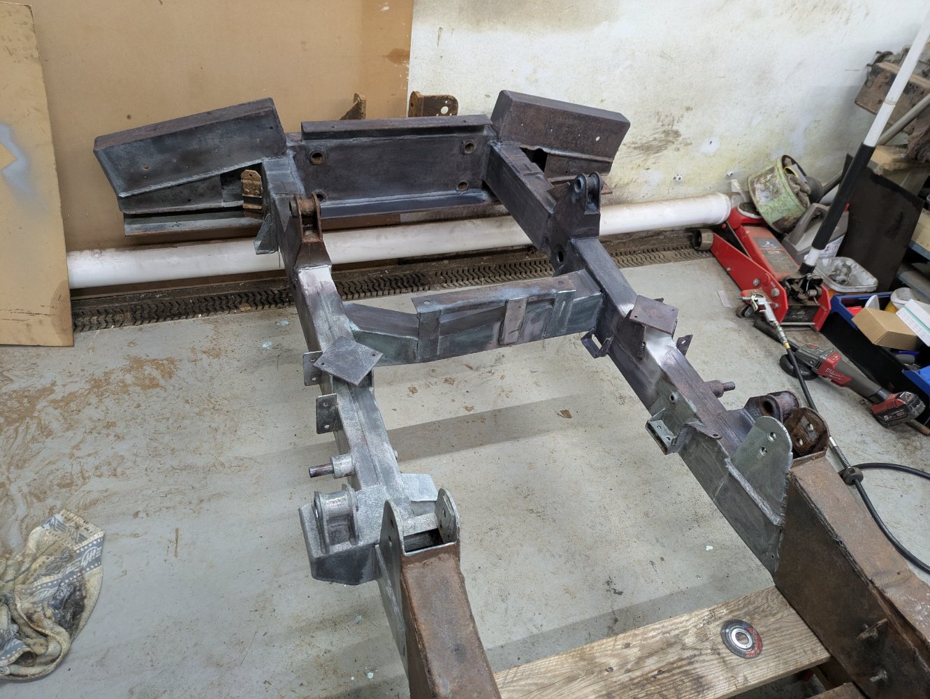

After a minor distraction with a PTO table saw bench I got back on the 6x6 this afternoon.
First thing was slap some weld over the previously prepared patch.
Now that side of the chassis was supported it was time to cut into the other side. A little bracket was tacked on to help with alignment of the bump stop mount.
Much much hoovering ensued as you can probably see by how much carp is on the floor being blown out of various other holes with the airline.
Then some rust converter treatment, trying hydrate 80 now rather than the Deox gel as you don't need to wash it off.
Then covering it over with some wood some tidying up was done on the other side.
Then a patch was started for the other side.
Needs some fettling but I'm going to dress down the chassis in certain areas in preference to the patch so I'll wait until tomorrow when the rust converter has had some time to work.
Hopefully finish all this tomorrow, flip the chassis over and finish the welding on the other side as well. Then it'll be a case of starting to burn the rubber bushes out and replace the kaput ones.
