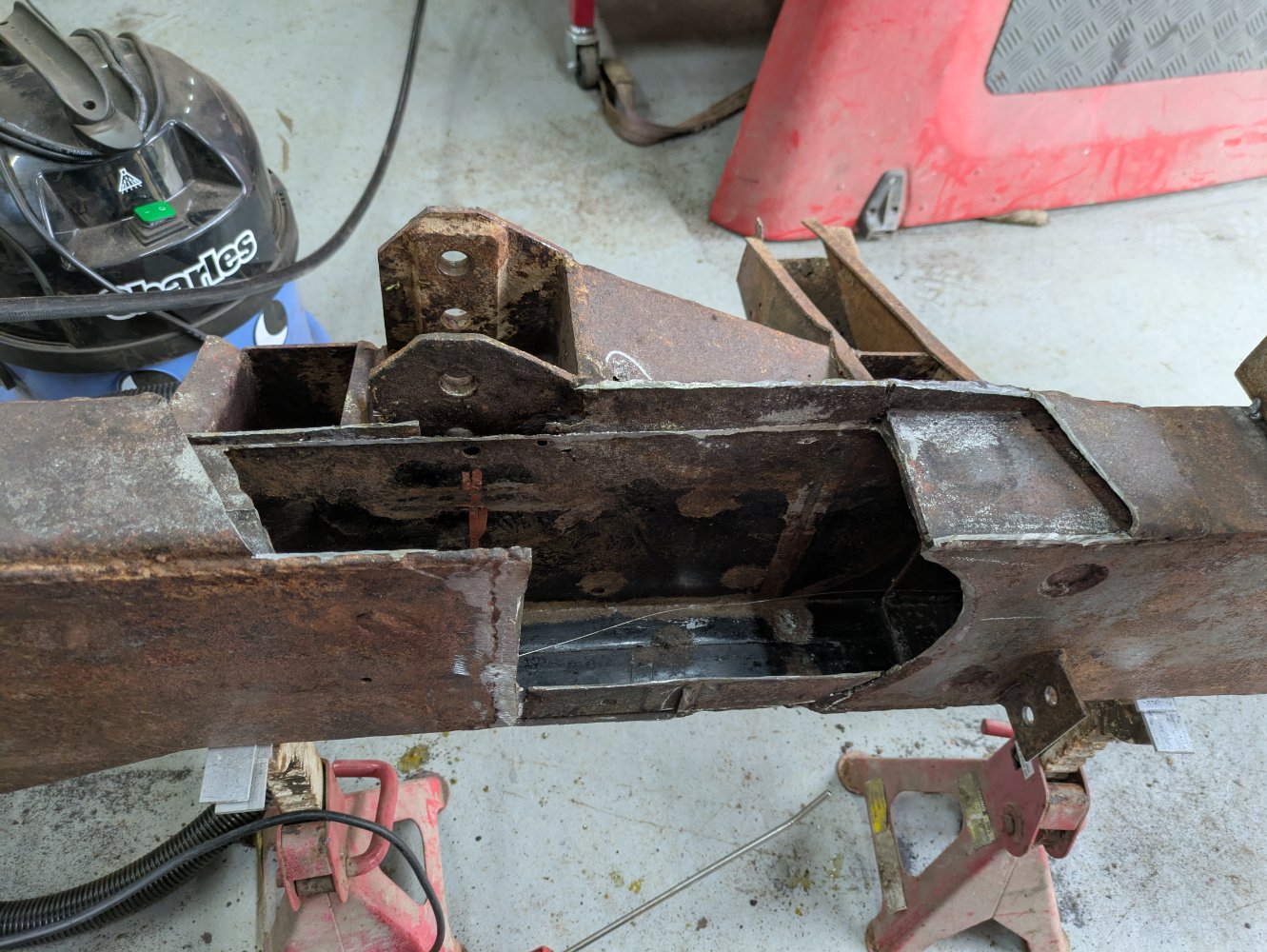

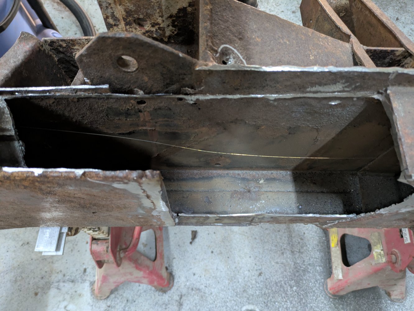

Did you say this August?A bigger hole has been made... Cut the reinforcing bracket off and then cut out the bottom rail of the chassis.

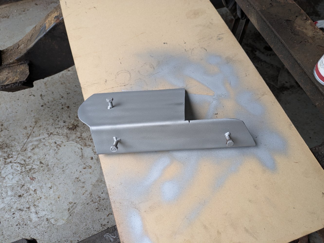

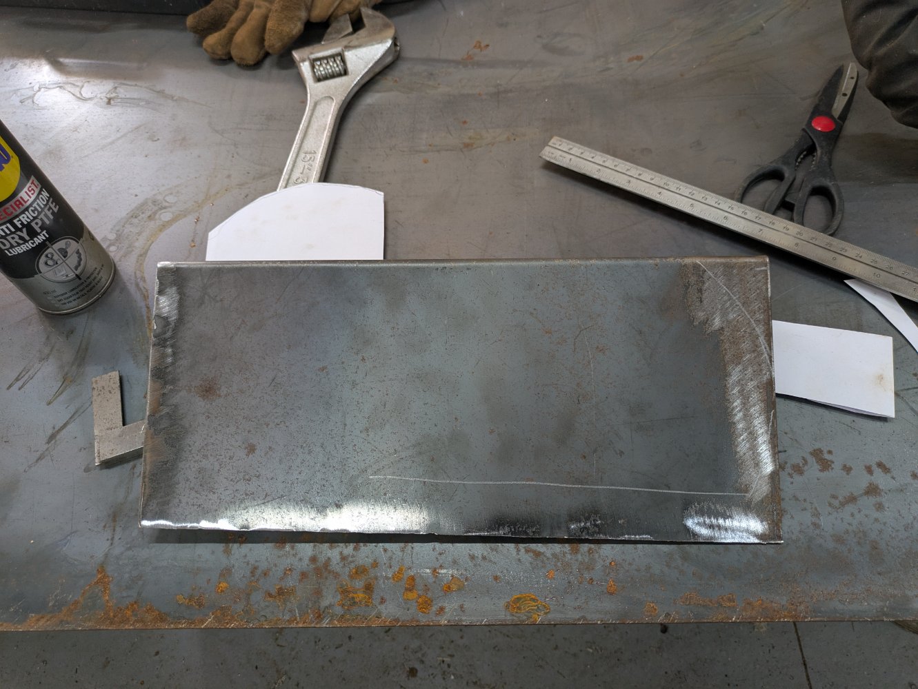

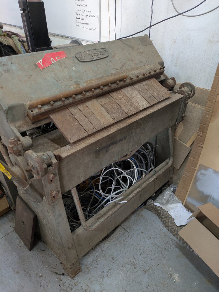

Some more plasma action on the sheet of 2mm but before I could bend it I needed to reinstall some fingers in the bender after @fizzy took them out to do his trailer wheel arches.

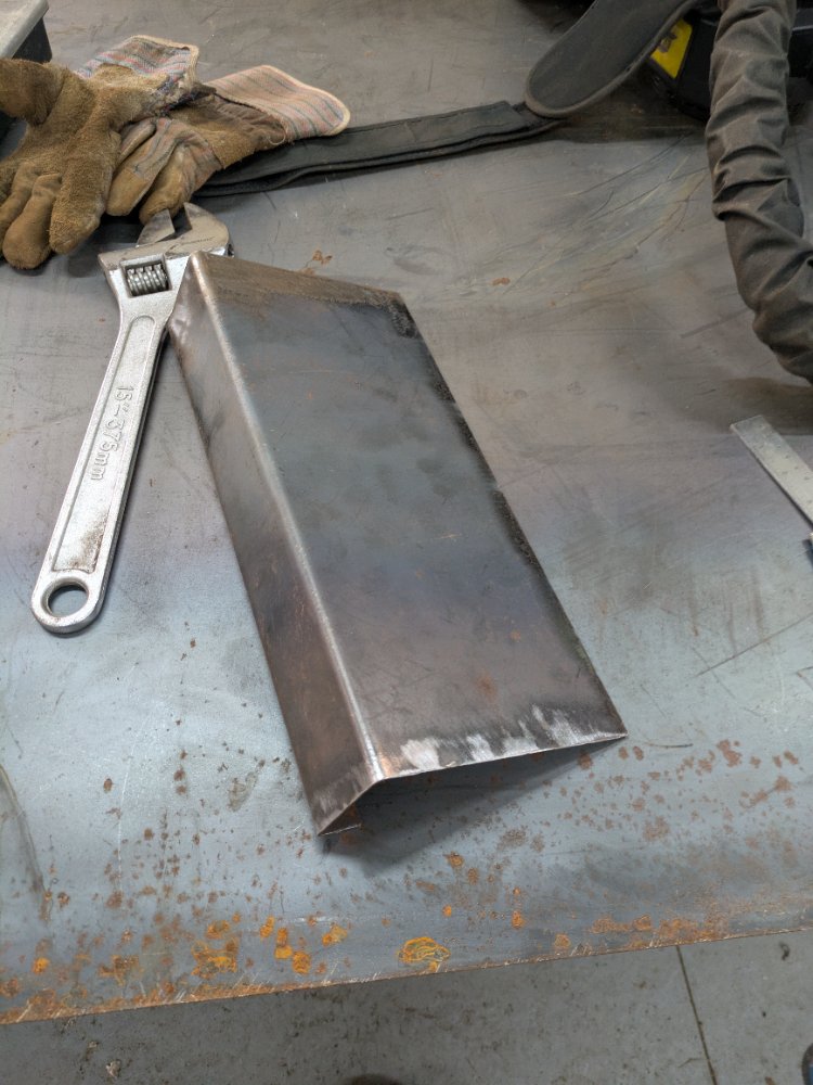

That's better and folded 2mm nicely

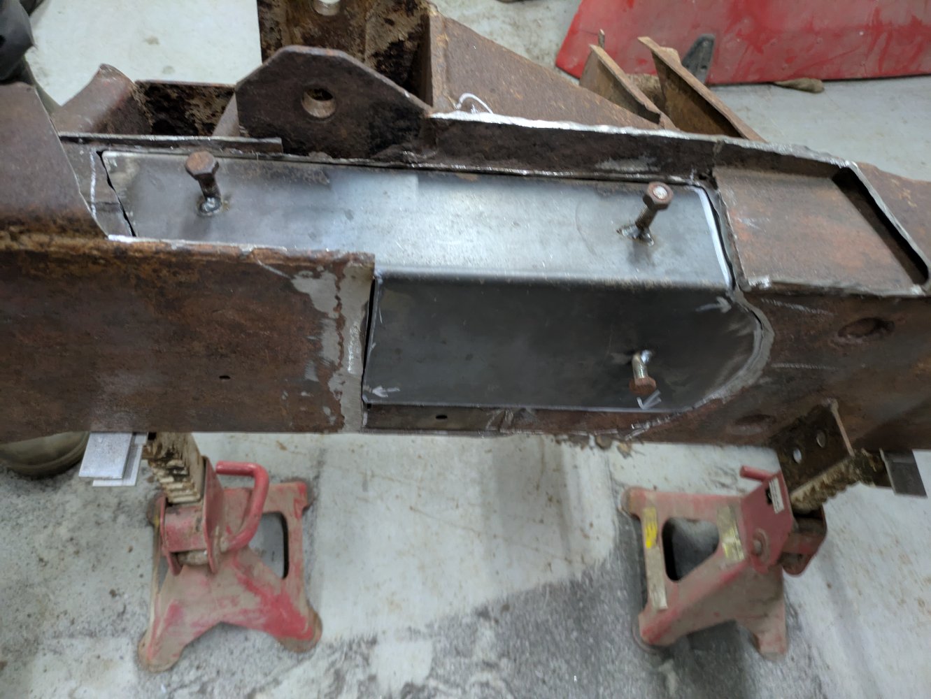

So now there's going to be a lot of marking and nibbling away to make a nice fitting repair panel
