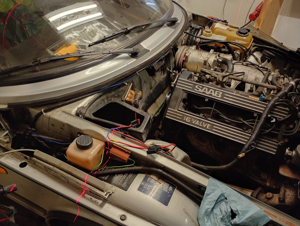

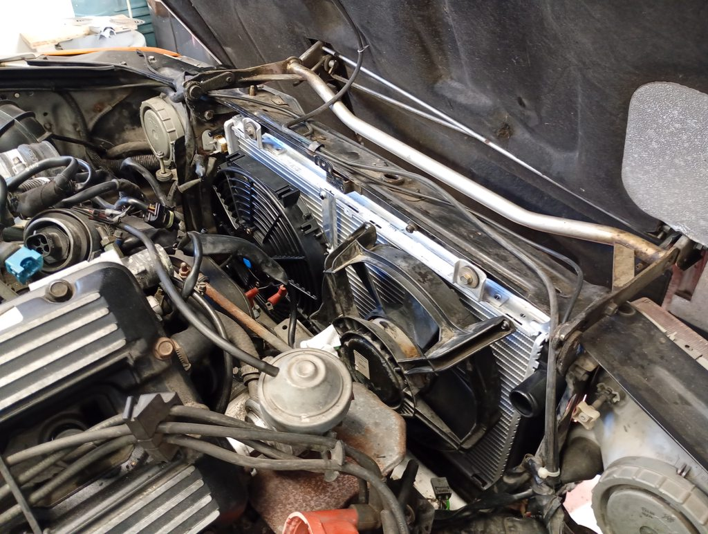

Last week I installed the evaporator into the car, finally. Then I was attempting to install the anti-frost or cycling switch for the AC system. Digging around the right speaker I found a buncha wires for the anti-frost switch and for the re-circulation flap (I won't be installing that). But I can't see how I am supposed to mount the switch or where the capillary tube can enter the fresh air intake and go into the evaporator core.
Photos of this are not existent. I found some old forums posts dated to 2005-2008 but the image links were dead, of course. I found one pretty detailed text explanation and based on that, my car didn't get any mount holes drilled nor any hole for the capillary tube into the fresh air intake.
I can probably fab some DIY bracket to mount it though, but I wold really like photos of a factory install. I have asked around and am waiting. Yes I could just drill a hole somewhere but I want to try and keep it factory looking.

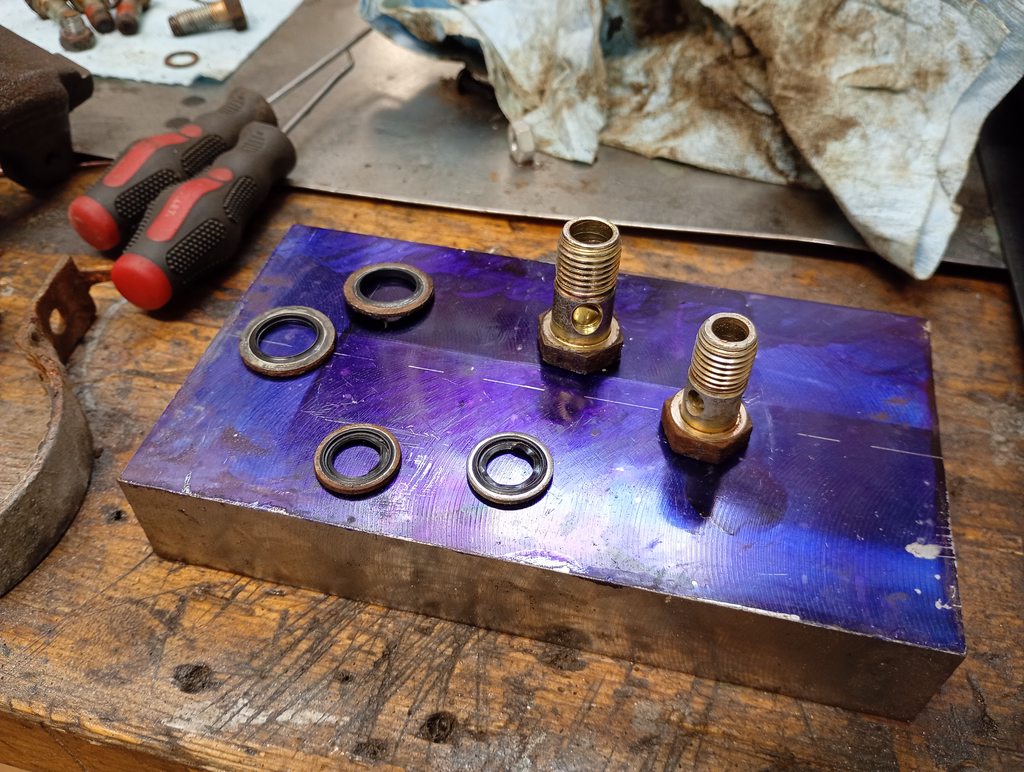

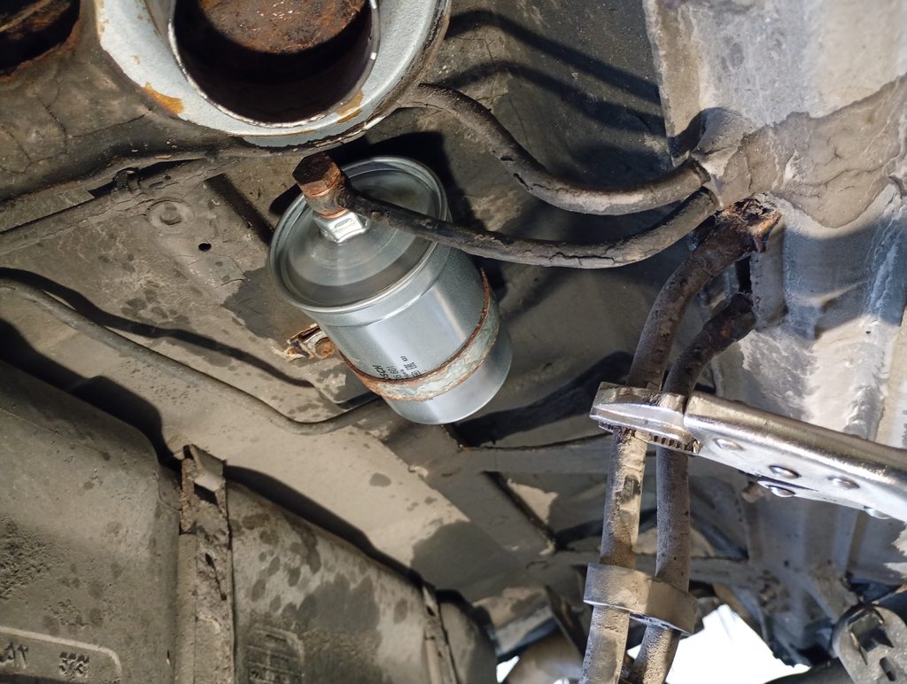

Meanwhile, I swapped the fuel filter, even reused the old banjo bolts. It really wasn't stuck very hard, I had been expecting a battle.
Only thing I got hung up on was the old washers had a rubber inside, never seen that (called a bonded seal, apparently). The new filter had regular copper washers and I suppose they will work as well.

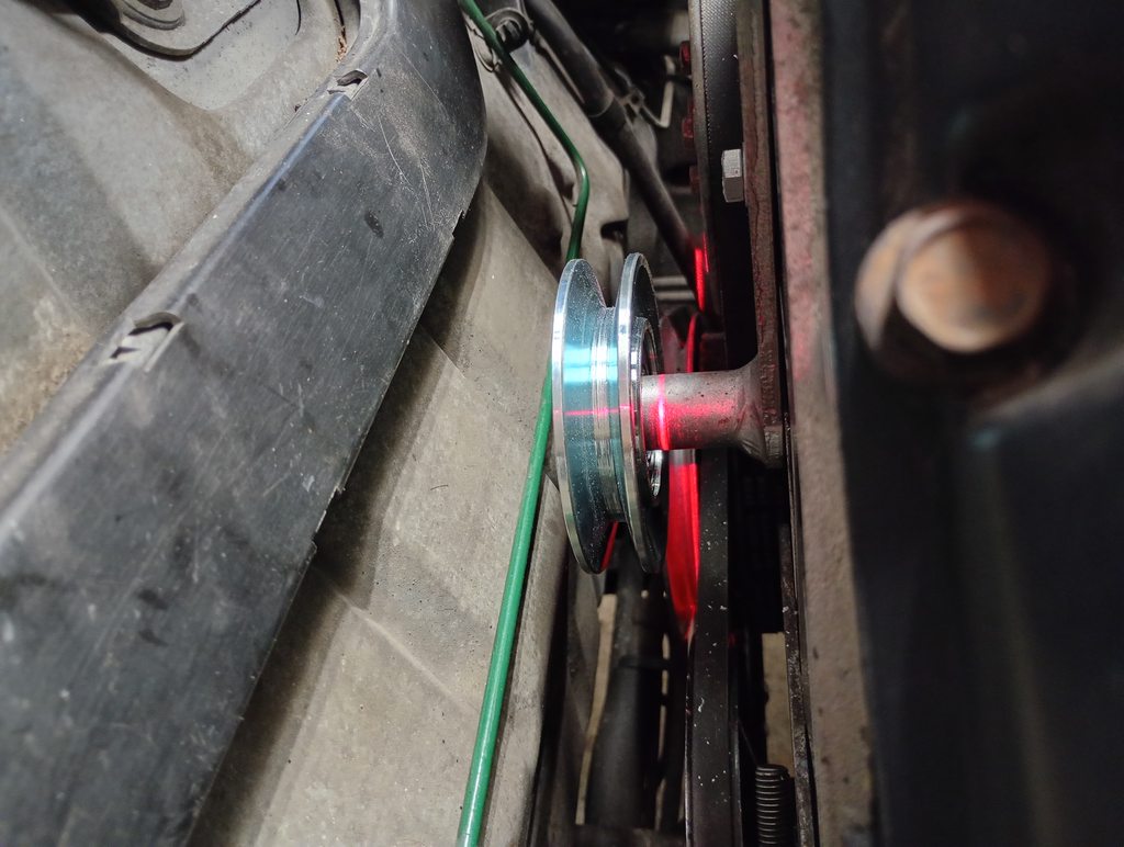

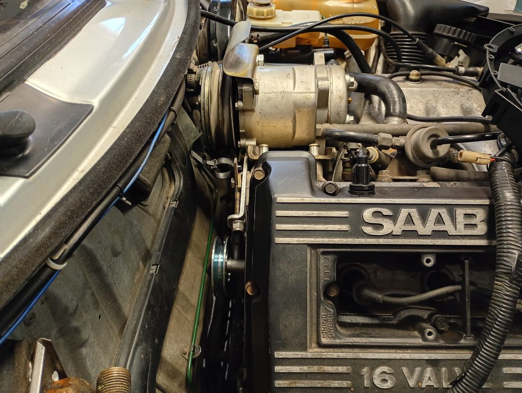

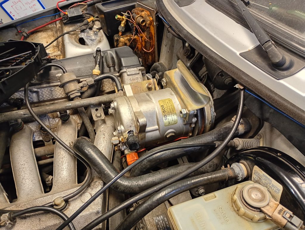

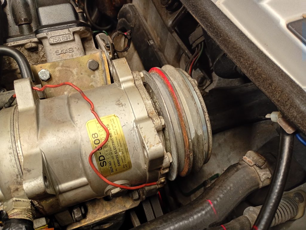

I have assembled the AC pulley and the tensioner as well. Bolted on the compressor temporarily too to check. It looked to my eyes like the tensioner pulley wasn't aligning properly with the crankshaft pulley.
So I used my laser level to verify it. It's hard to photo but here's what I got.
The compressor pulley aligns with the crankshaft pulley, but not the tensioner.
The laser line comes in the center of the tensioner pulley instead
If I align the beam to the forward face of the pulleys it goes off the pulley itself
However it turned out to be a false alarm with the laser after all. I first realized the belt is supposed to go on the outer groove. Then I went out again and noticed that the compressor mount was slightly loose, so I tightened it and adjusted it. I also turned off the laser’s automatic leveling and adjusted it manually so it followed the pulley more precisely in the vertical direction. The car isn’t perfectly level either so that threw me off.
Now I can get all three wheels to line up quite decently with the outer groove of the compressor pulley instead.

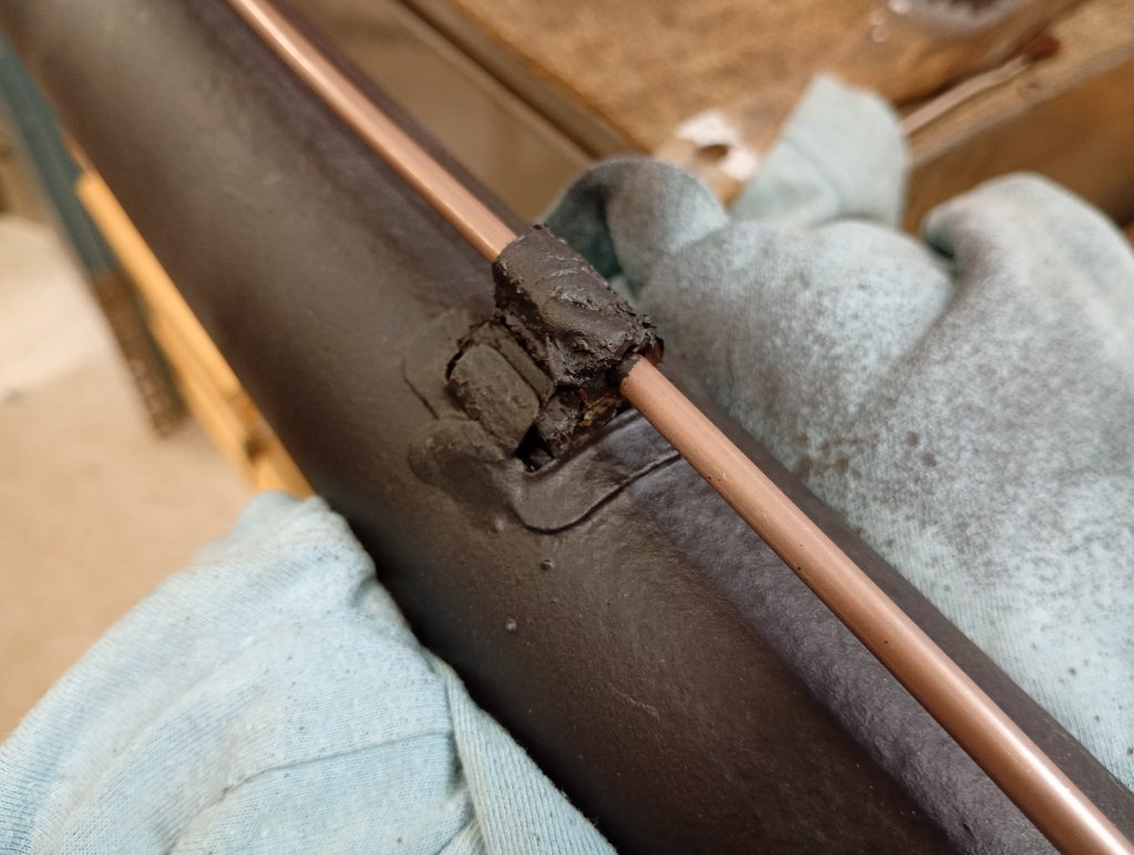

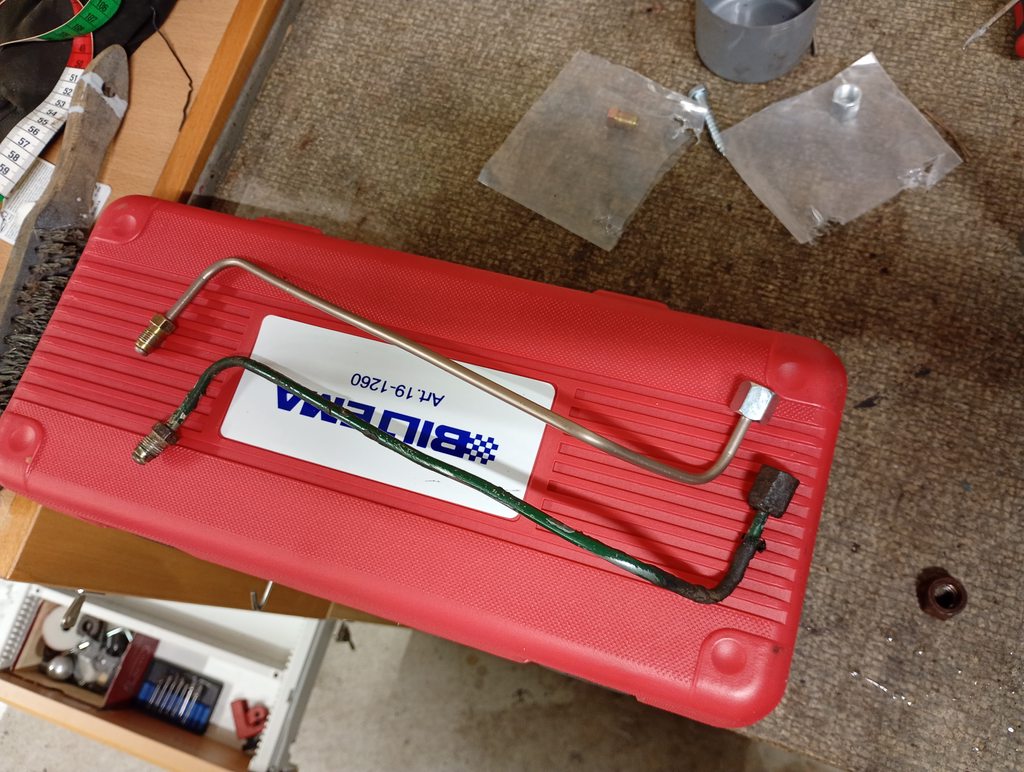

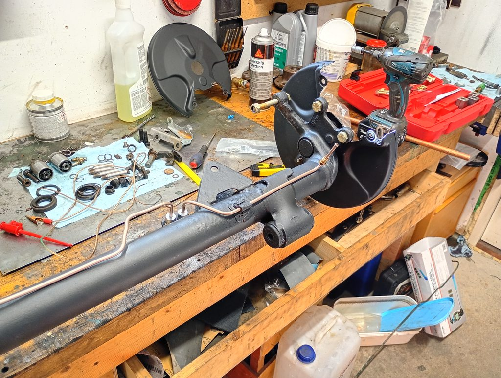

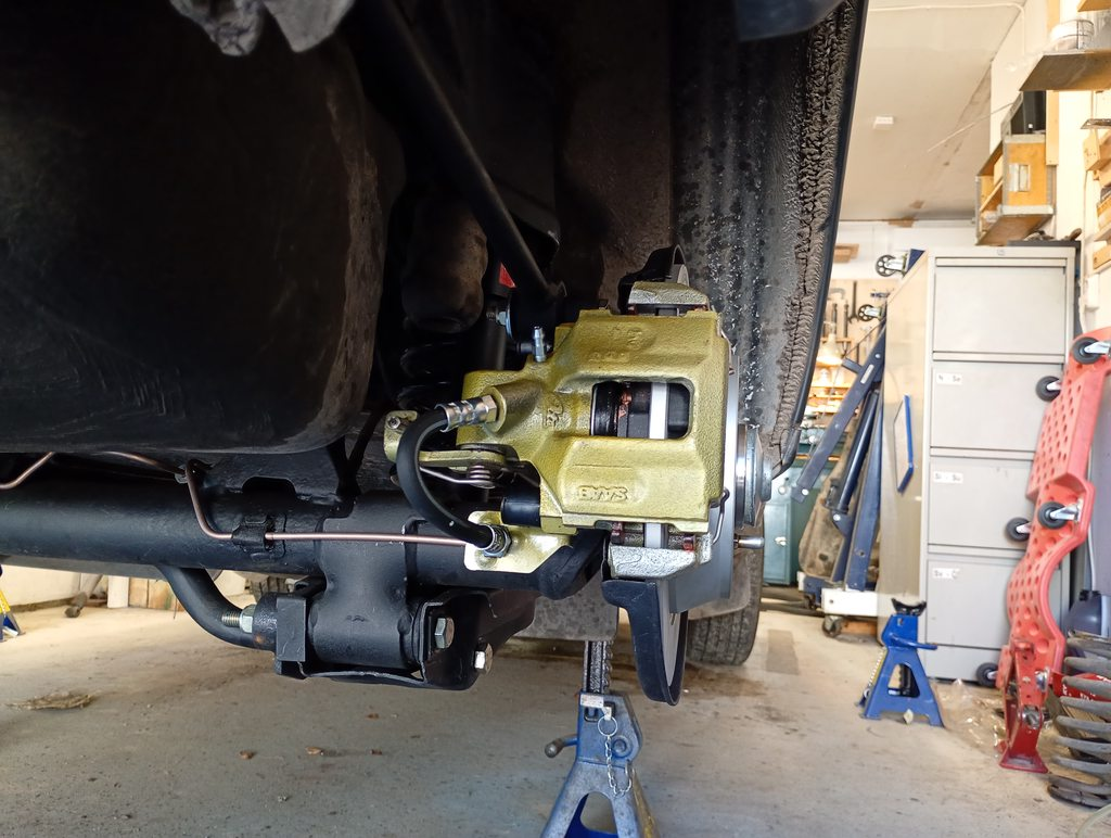

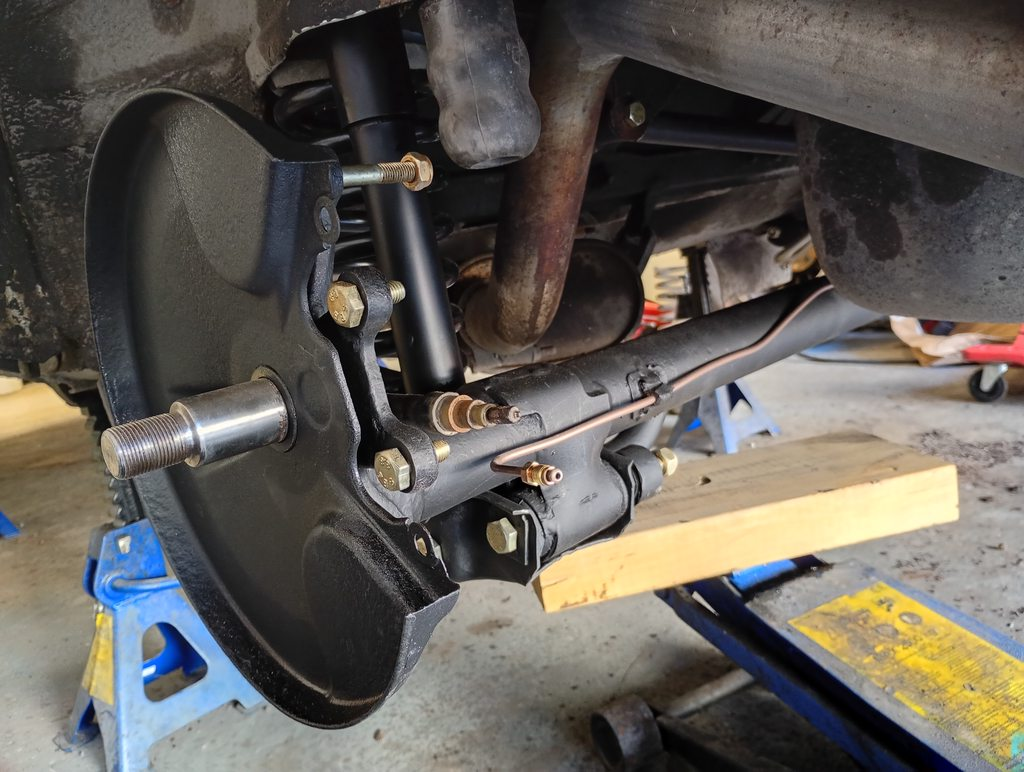

Made my first brake line:

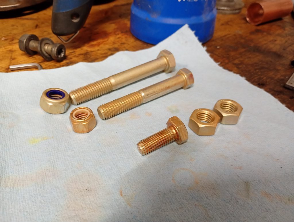

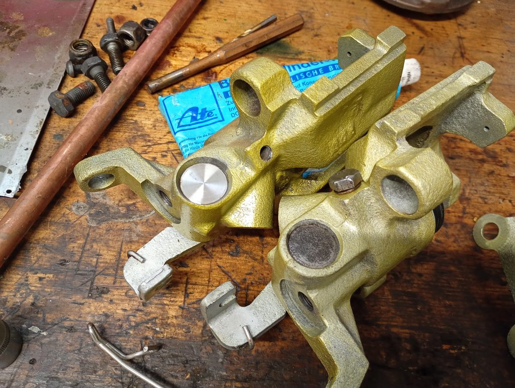

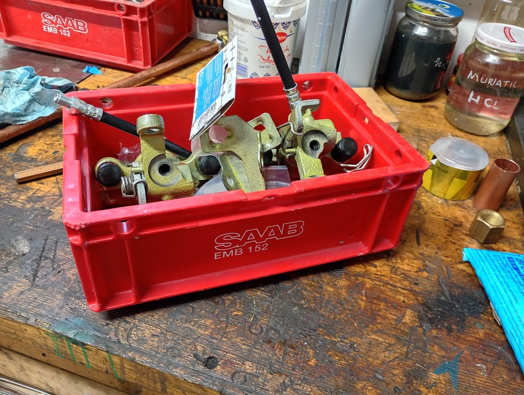

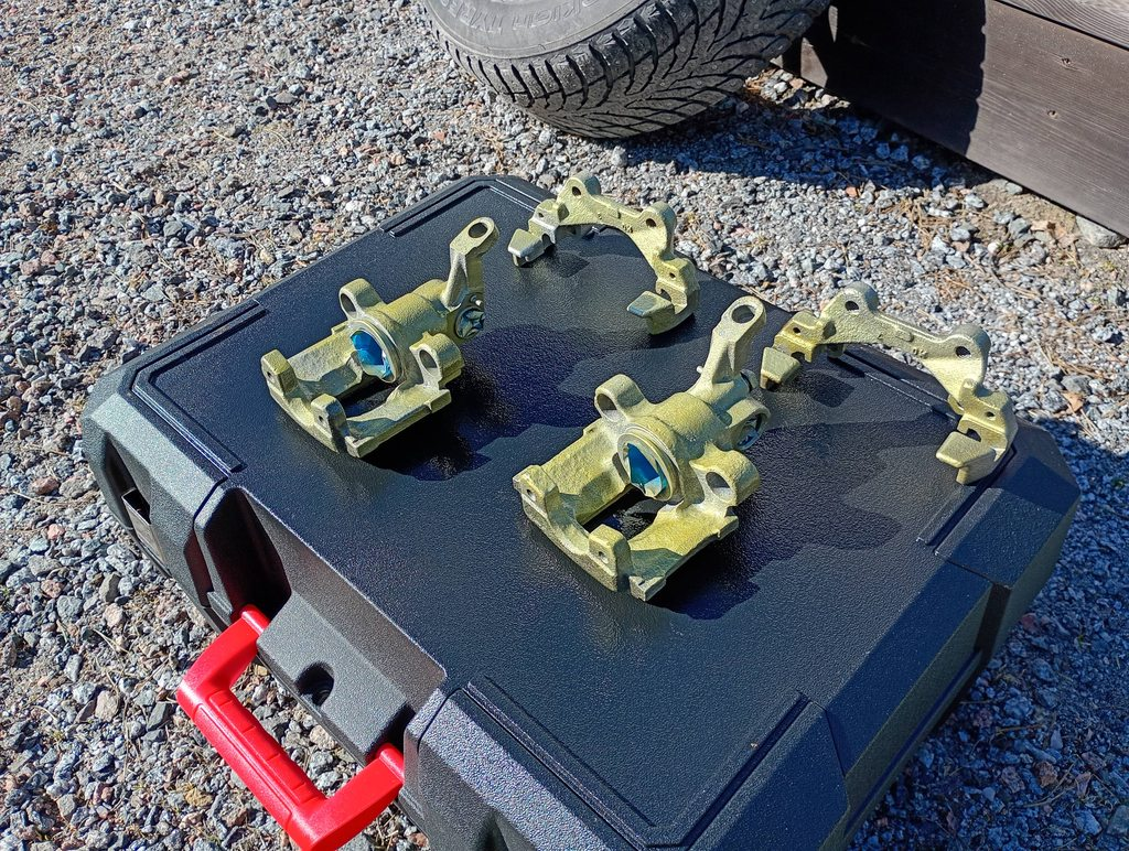

And got some yellow chromate passivation fluid
It's the trivalent chrome based fluid and not the Erin Brockovich stuff.
