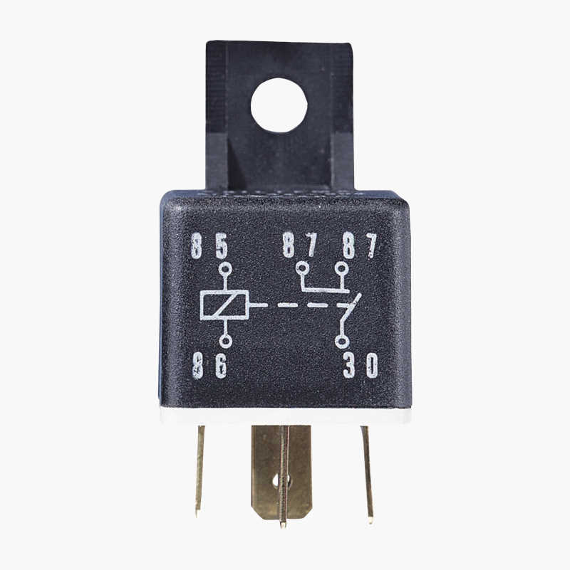

Two relays also needed for compressor and fan but I looked at the pinouts and two generic 30A relays of this style should be compatible.
