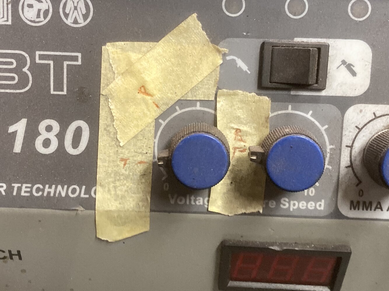

For reference, these are the settings I'm using on my RTech 180 for rust repair on my MX5:
'T' is for tacking / welding thin (0.8mm) panels.
'P' is for plug (puddle) welds.
I use somewhere between T and P on voltage for welding 1.2mm or 1.5mm panels with wire speed around P. (Needs to be a bit higher if welding upside down).
(Note that I'm using 0.8mm wire, so your speed settings will be different if you're using 0.6mm).
Keep practicing - the RTech 180 welds lovely (IMHO).
(ETA: Wire speed - if it's burning back and you just get a hissing, molten ball hovering in space, it's too slow. If it's stubbing into the workpiece all the time it's too fast. Between the two is the sweet spot.)
