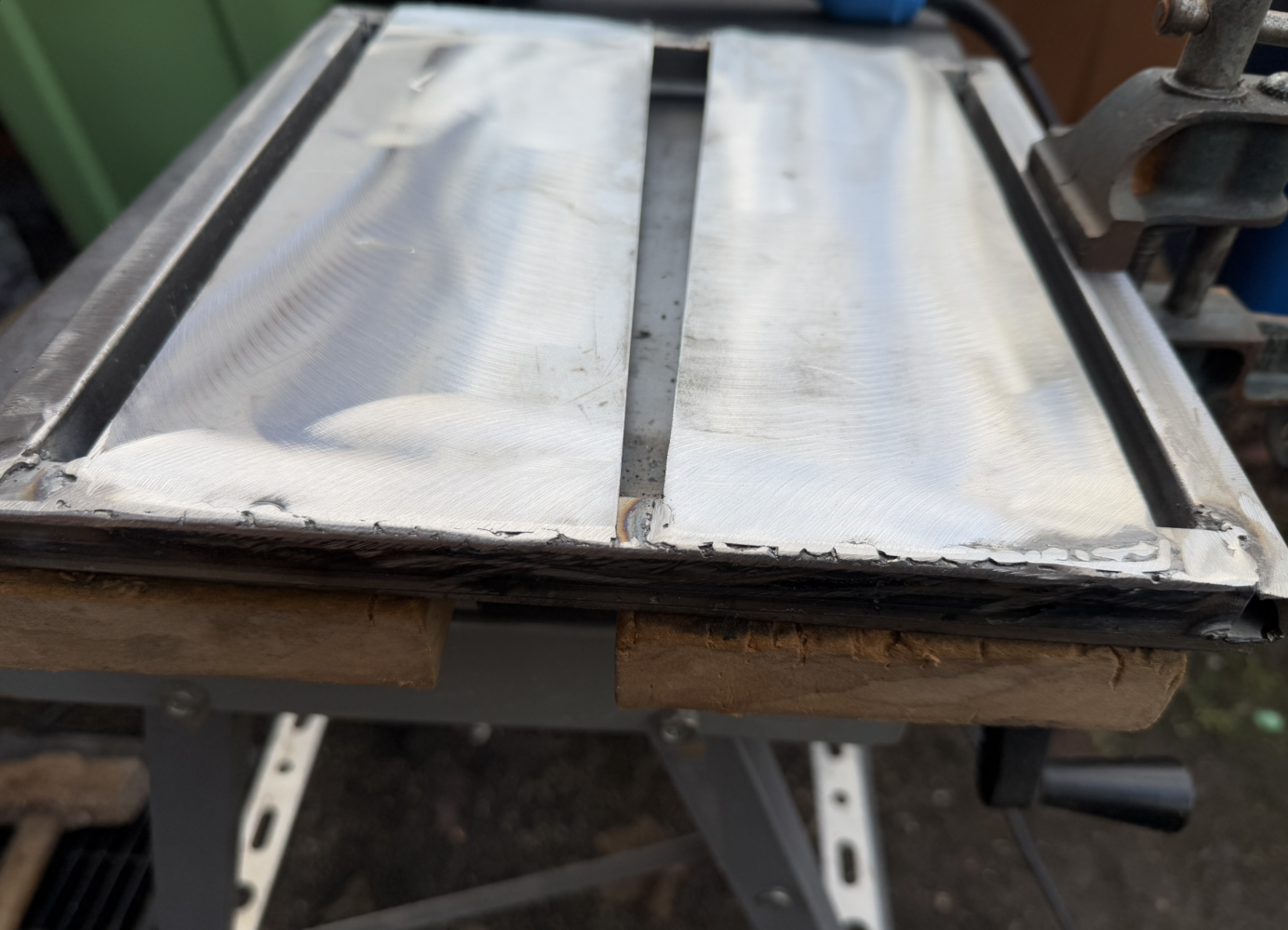

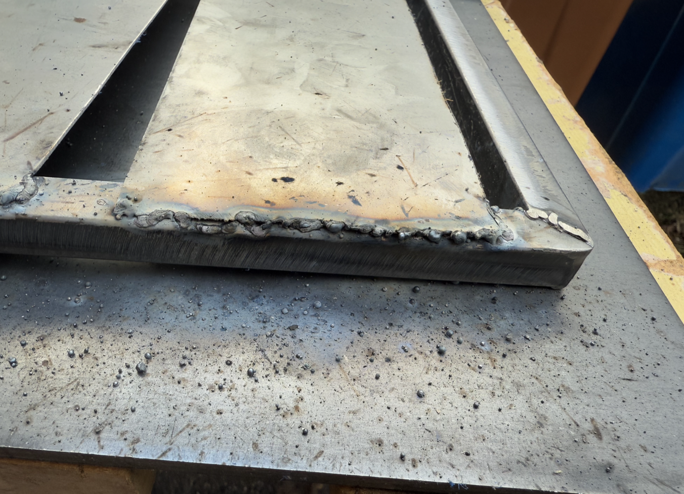

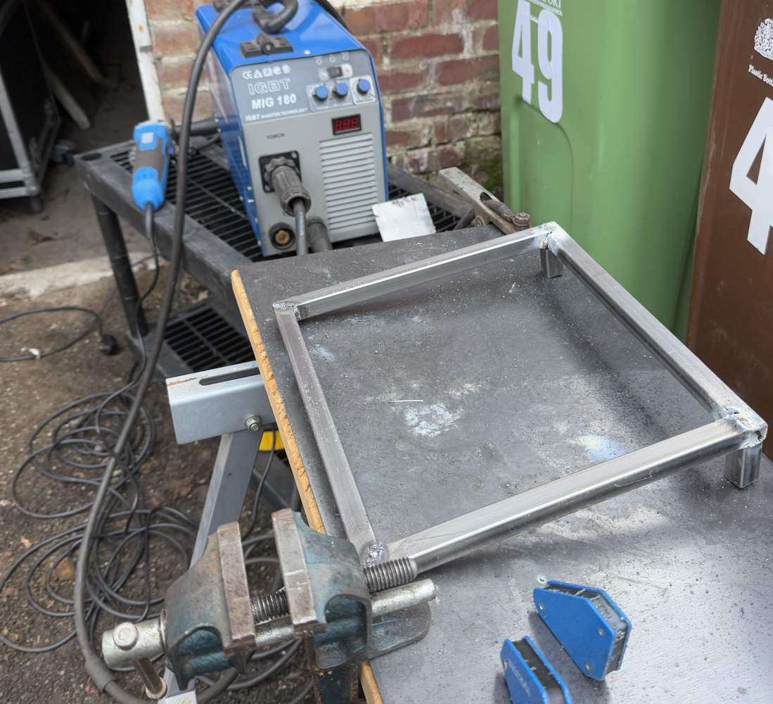

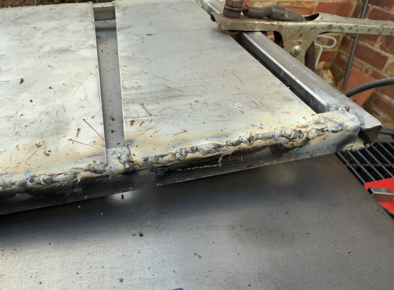

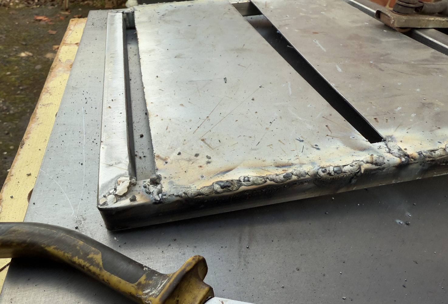

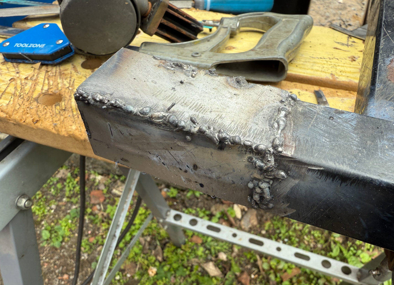

I’m no expert, but from what I saw on the video.
I’d try and find a position where you can sit and rest your right elbow on something steady. It will give you a much more consistent speed of movement. It would also get your head closer to the weld so you can see the weld pool better.
With flux core you need to have a smooth pulling motion with the torch angled slightly.
I tend to steady the swan neck with my left hand and keep it at a consistent angle while I move my right wrist and slide my right elbow to move the torch.
Not always achievable in a confined space but in an open area like in the video may help in controlling the speed and position of the arc.
If you don’t have consistent movement then changing power or wires speed will not improve a weld.
