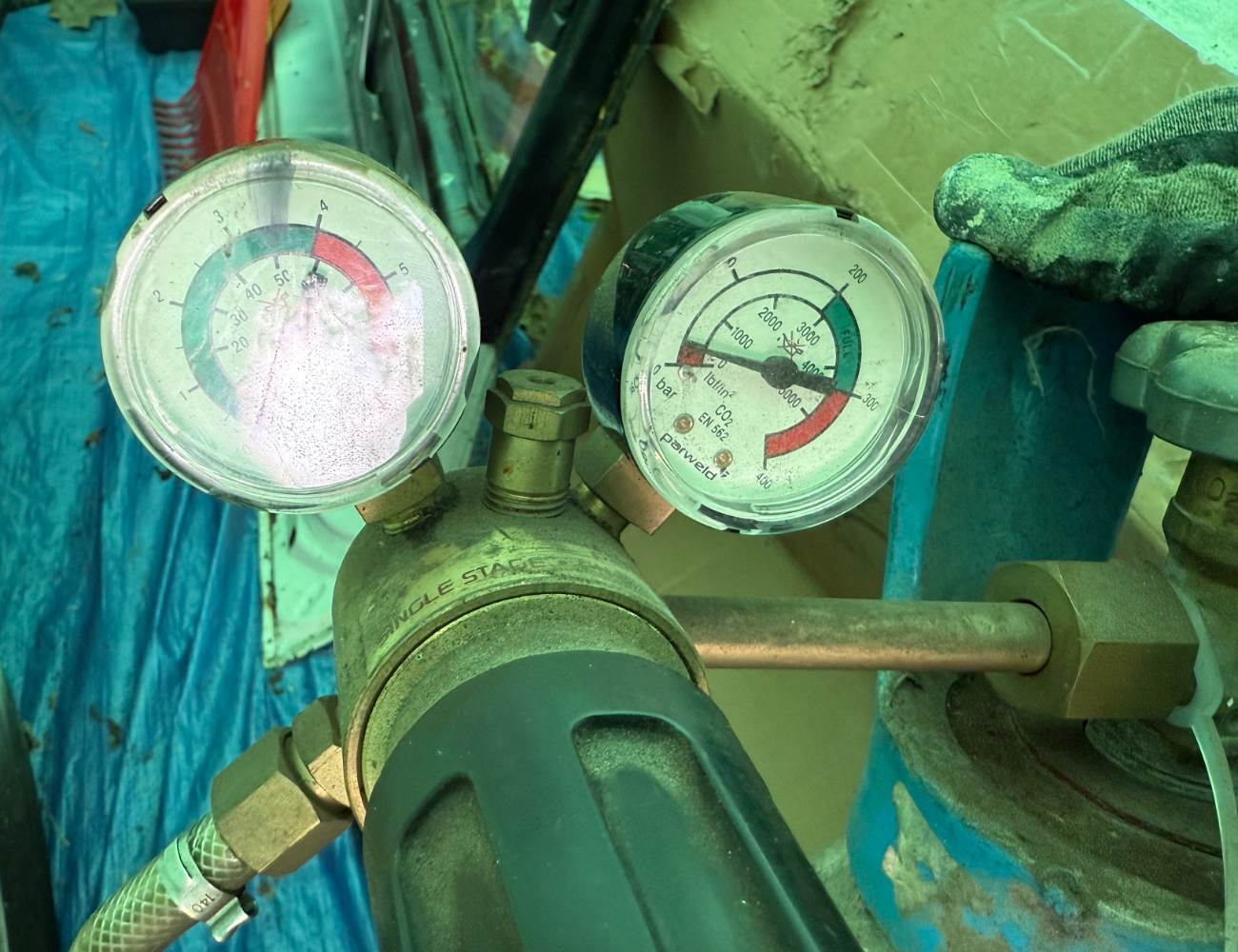

screw the black knob all the way out anti clockwise and it should shut off the gas flow, then screw it in a little to give a small flow, a flow meter is advisable but not absolutely essential if your welding tomorrow, look at getting one if you do choose to use gas longer term.
