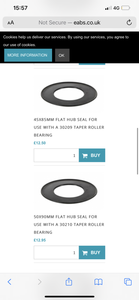

'big ball bearing'? go on then, please telli am goign to be "that guy" and say will a bit of innertube, craft knife and big ball bearing trick not work?
You've just given me an idea.Grind the teeth off a hole saw to make a knife edge, and press it out. A bit of WD40 helps lube it up
I did think innertube but I need the rubber to be fairly flat.i am goign to be "that guy" and say will a bit of innertube, craft knife and big ball bearing trick not work?
I've got some tape cutters, hardened steel round blocks. I'd just need to make a die like you say.Could you turn up a die if it’s only thin?
Piece of round stock with a short round hollow section that’s got an edge turned on it and use a piece of wood to cut on?
Edit - just seen holesaw idea.
For cutting the center out of comething like this, craft knife for the outside then you lay the rubber/gasket material over what ever you need place a big ball bearing over it and give it a decent wallop with a hammer/mallet and it will cut the inside circle out perfectly by nipping it between the 2.'big ball bearing'? go on then, please tell
How critical is it Brad?
