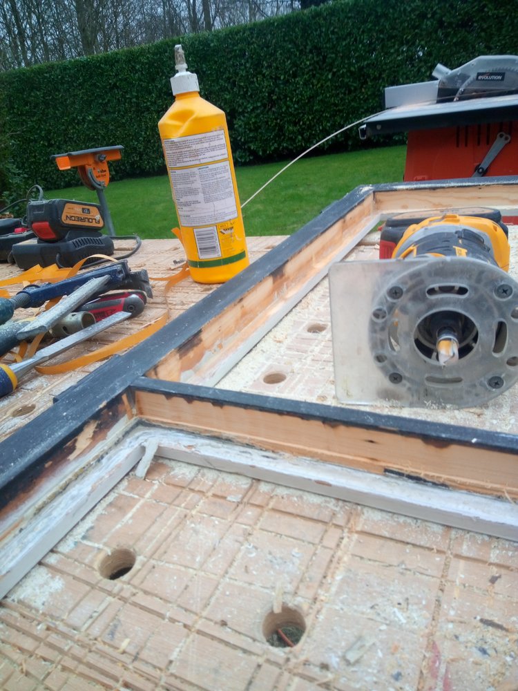

Tracksaw everytime for trimming top/bottom of door. Or a homemade track for a skillyAfter seeing a router being used for trimming a door bottom I thought I'd try it so clamped a straight edge across the door to run the router against, halfway across I realised the straight edge was slipping and I was cutting a nice taper going up the door![]()
