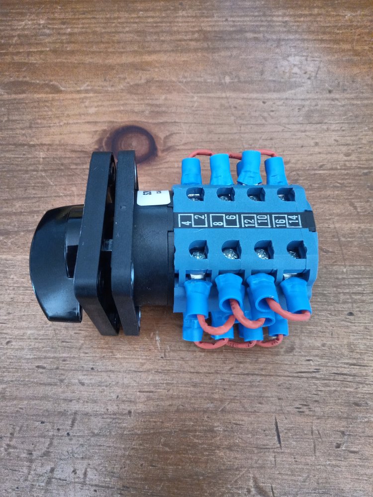

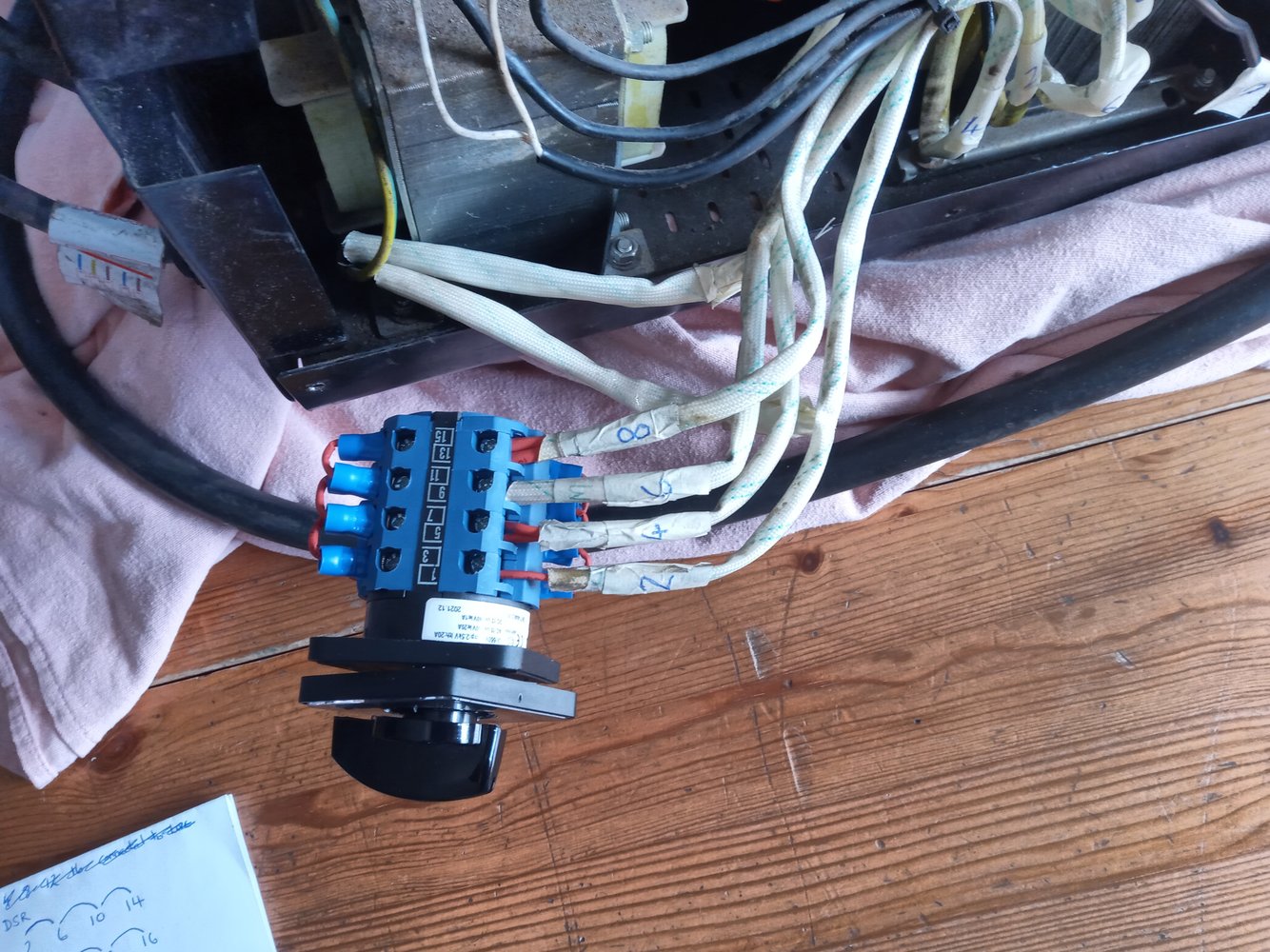

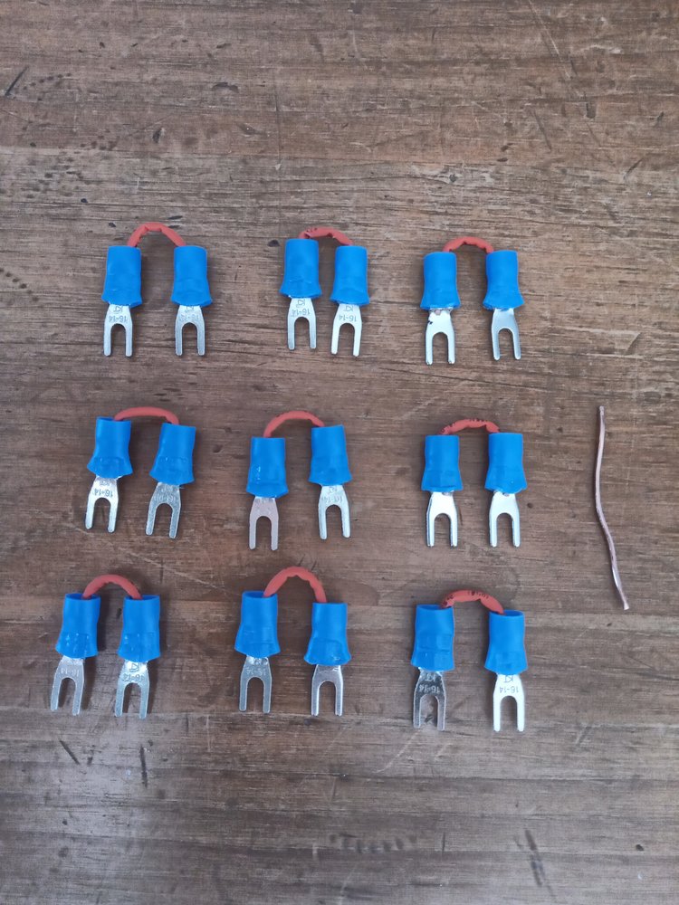

Thanks,A similar gauge to that used for the connections to the transformer should do. Ideally, the wire should be insulated. The jumpers in the original Kende cam switch were made from stamped sheet, and not insulated, so would expose live surfaces inside the welder.

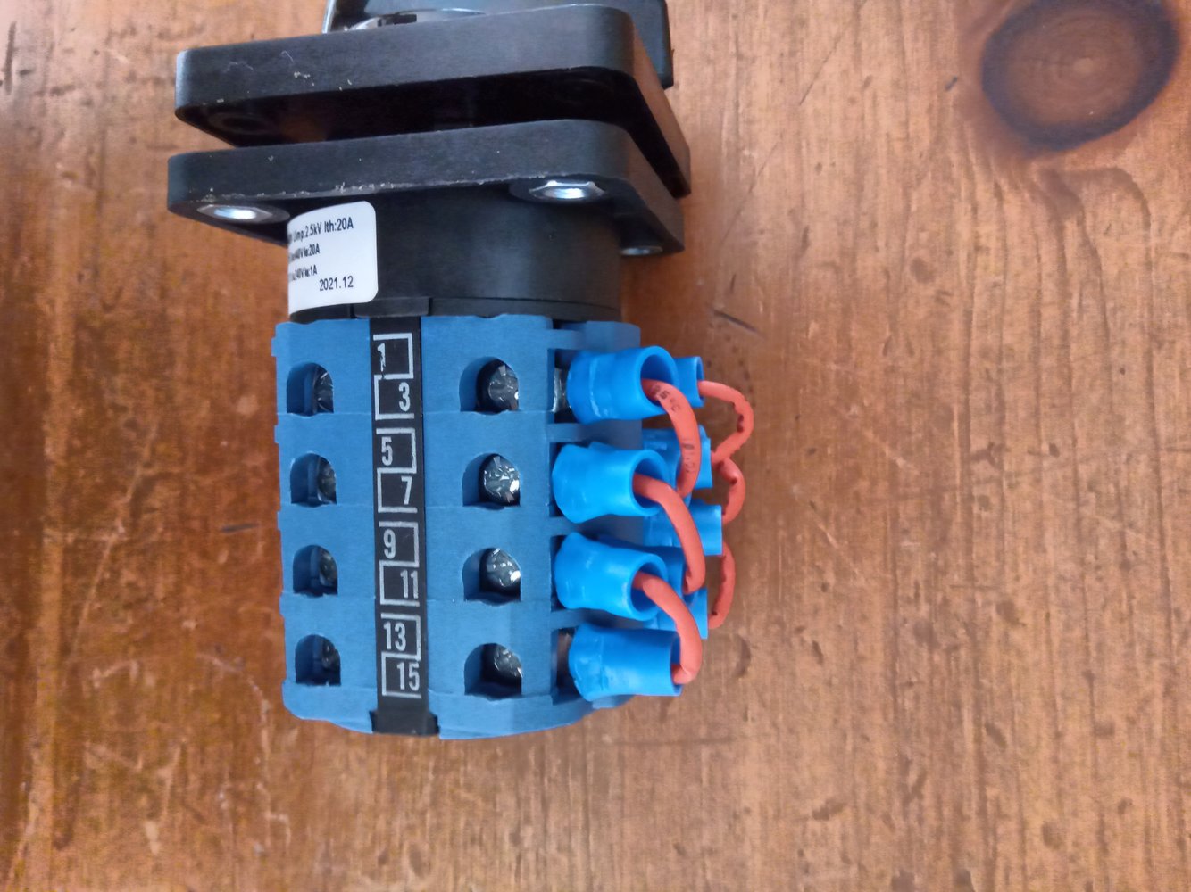

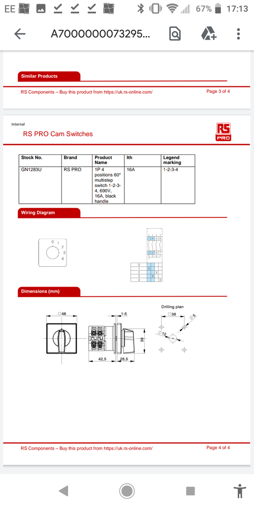

Yes, the new switch has two on/off switches at every active position ( other than "0" ), so one of these two is used as the main switch, with no need for a separate power switch. The jumpering-together of switch terminals 4, 8, 12, and 16 and connecting them to Live provides this main switch.In post #34 could you explain what I need to do for that please? (does it mean, no need for separate switch?)
Thanks Eddie.Yes, the new switch has two on/off switches at every active position ( other than "0" ), so one of these two is used as the main switch, with no need for a separate power switch. The jumpering-together of switch terminals 4, 8, 12, and 16 and connecting them to Live provides this main switch.
Live ( was Pin 7) Brown - any one of 4,8,12,16
Neutral (was pin 11) any one of 2,6,10,14
Wires (was pin 10) go to joined terminals 3,7,11,15.
Wires (was ping 12) go to either pin 13 OR joined pins 2,6,10,14.
I'd try Pin 12 to pin 13 first and see if it works OK on all ranges, if it does, then leave it there. If the relay won't click in on the lowest setting, move what was pin 12 to any of 2,6,10,14.
See post #39 (this is for future readers - post #39 says "10,6,10,14" - it should be be 2,6,10,14)

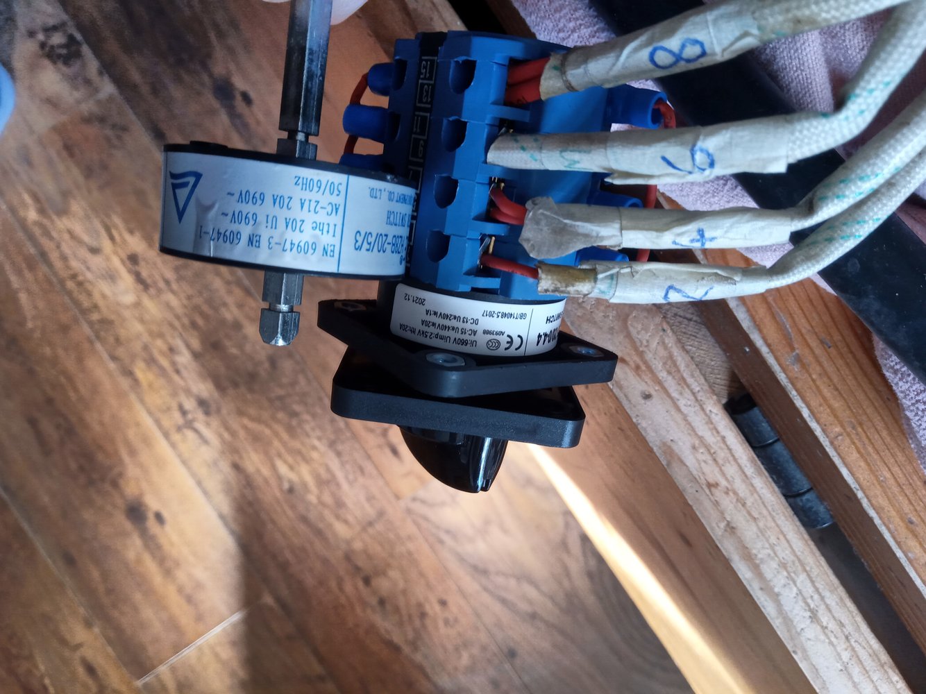

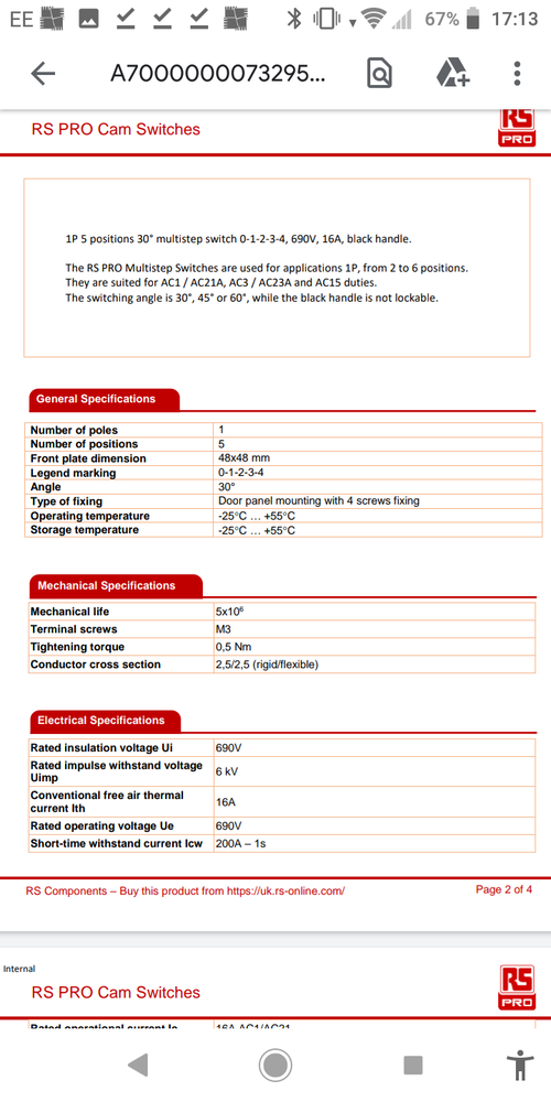

Can't thank you enough, you're a star. Is the 660V 20A instead of 690V 20A any issue?
Thanks.I wouldn't worry about it, it's well above the supply voltage (240ish volts) in GB, and the current is the same and that's more important, breaking higher currents wears the contacts quicker but that will only happen if you are turning the welder on and off by this switch a lot while you are actually welding Max primary current is well within the limits of the switch and the wear will really be in the 30A relay as that's what switches the transformer on and off when you press/release the torch trigger.

Don't give up yet - when you say just clicking from relay, which relay is this?Oh well, sorry guys, I gave it my best shot but obviously, I'm not up to the job.
Firstly tried wire 12 to terminal 13 and 1st position Power light on + fan, I thought for a couple of seconds then pressed trigger and just clicking from relay but nothing else on any of 4 settings.
So transferred wire 12 to terminal 14 (2,6,10,14) and just the same as using terminal 13.
