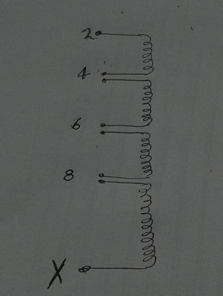

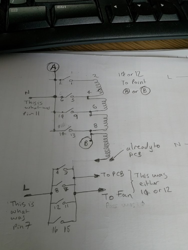

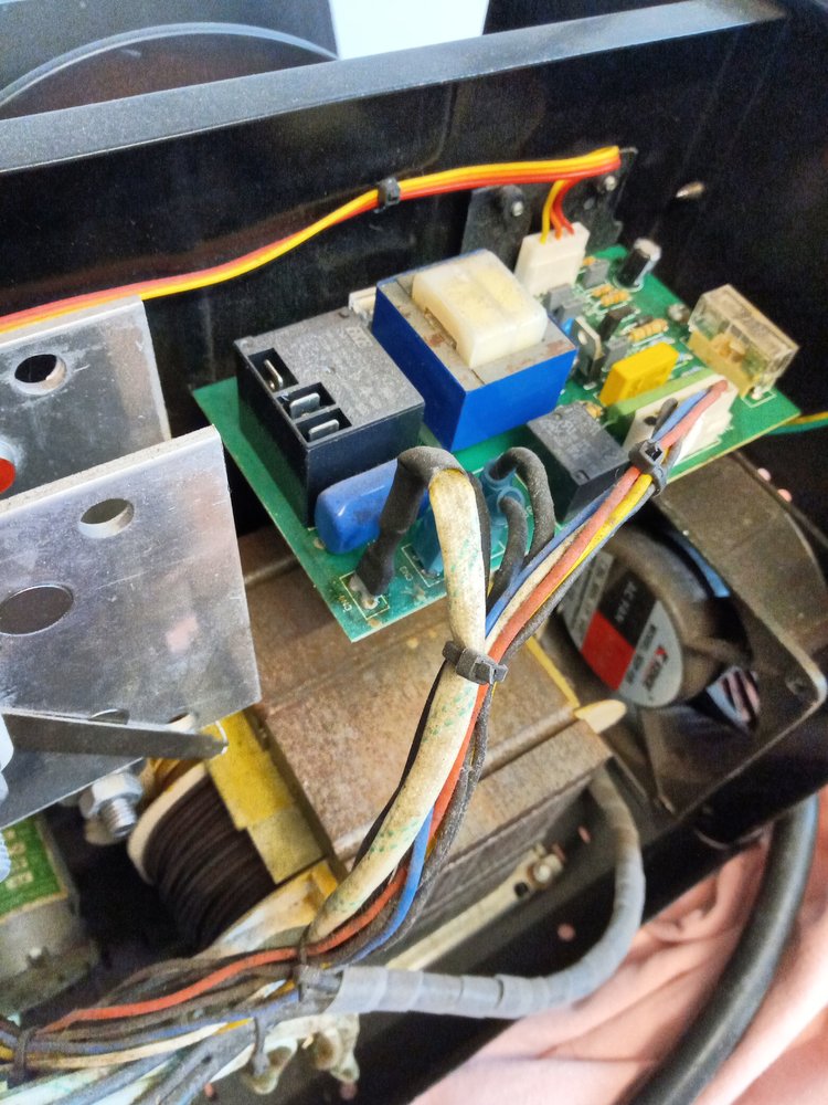

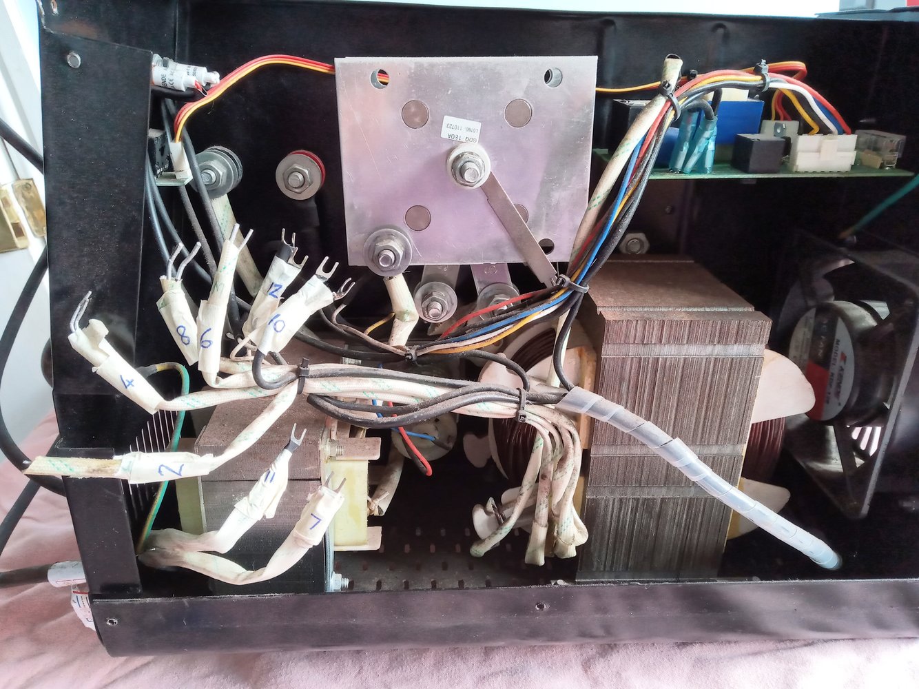

Thanks to everyone for all your help.

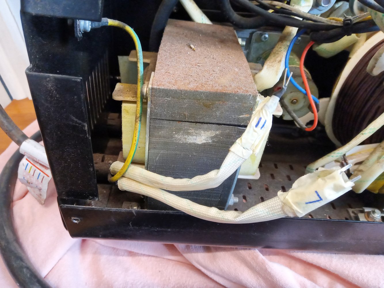

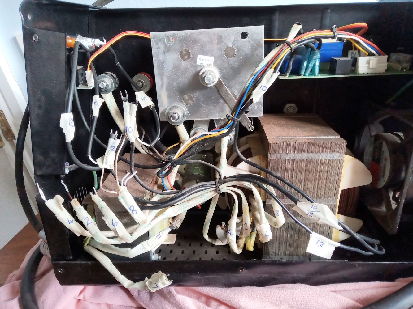

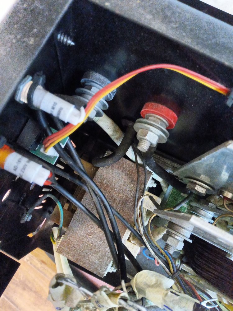

As I struggle getting my head around things and understanding, I've now brought the welder in and took photo of wires with the terminal numbers they went to on on the original "KENDE" switch. Hoping that this will make it easier for me to understand if someone can possibly kindly advise on where to position each numbered wires to what terminal on new switch please.
Genuinely appreciate all you guys for your help and patience.
