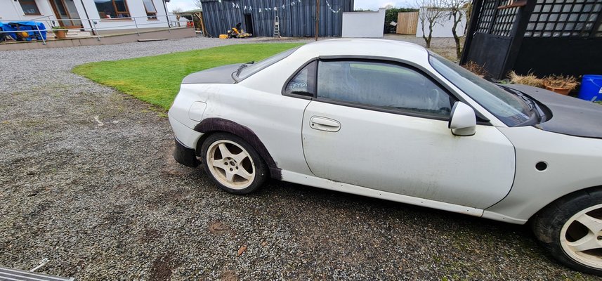

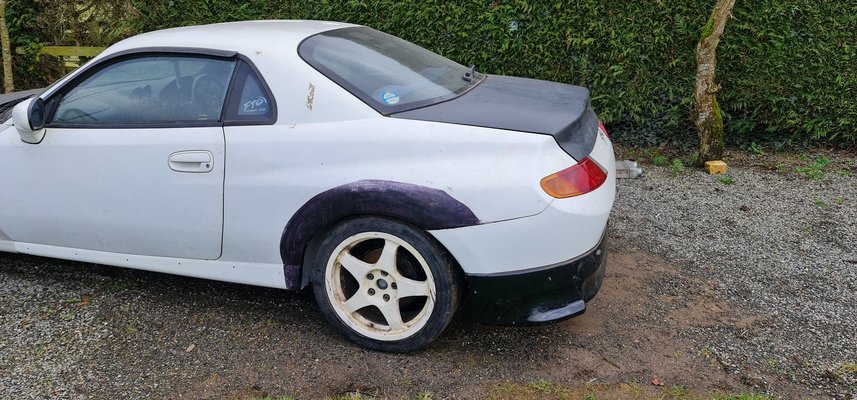

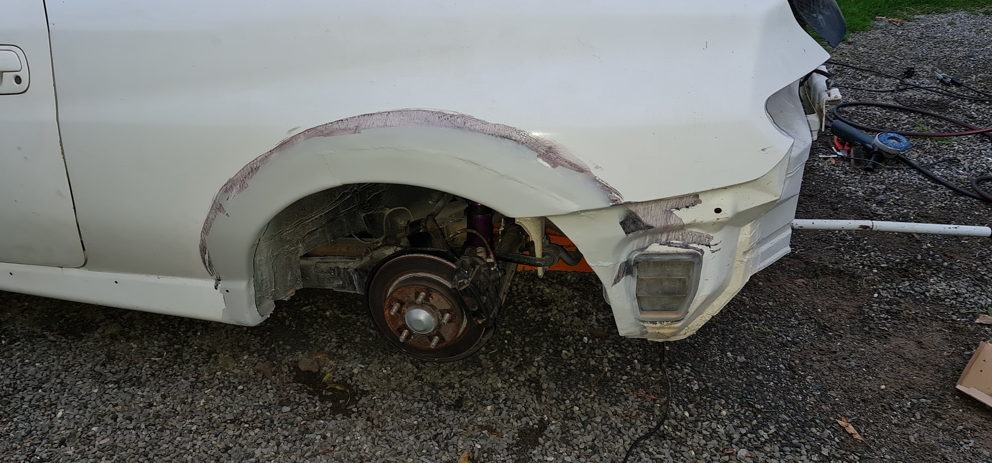

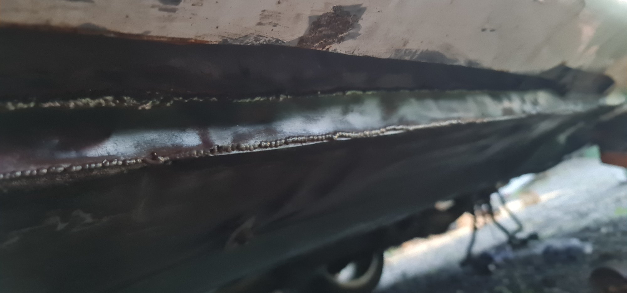

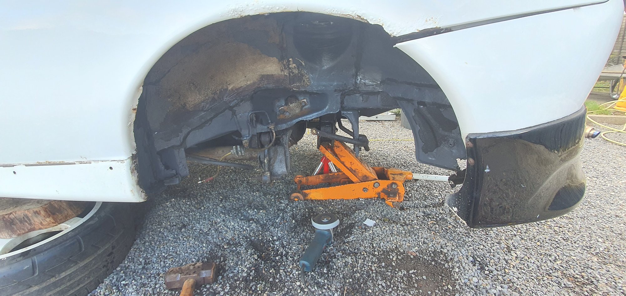

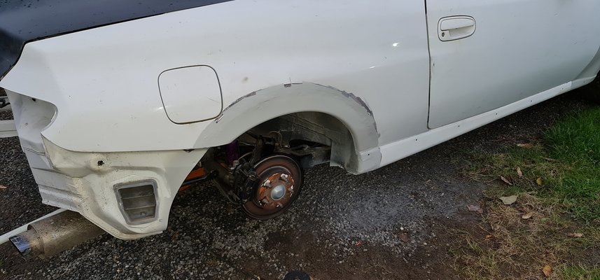

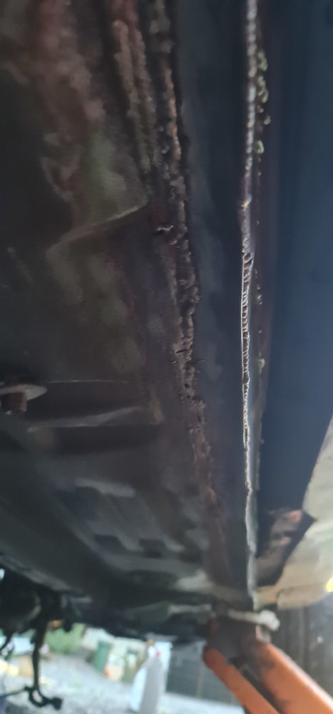

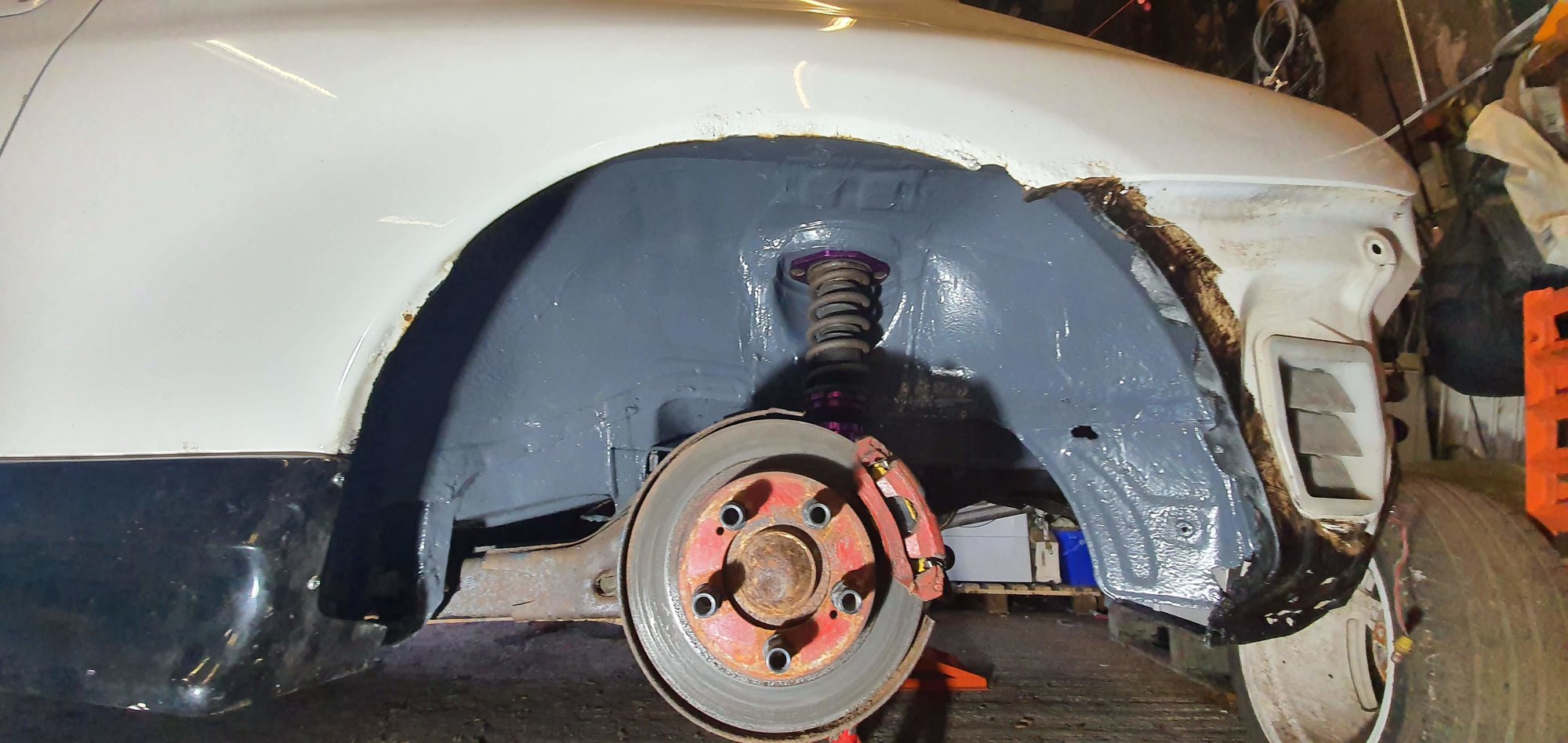

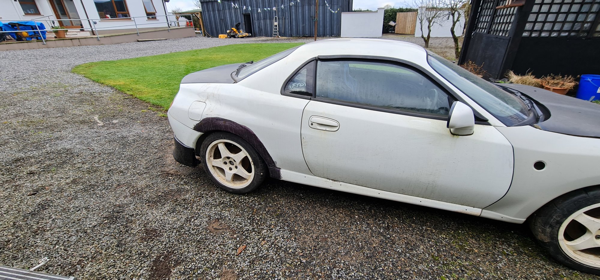

I now have rear arches WOO!!!
They still need some filler and to be made pretty but I wanted to get epoxy primer onto them asap to prevent rust setting in or moisture getting into the seams.
I'm thinking the process now is filler, the. Another coat of epoxy primer (filler is porus) the filler primer and then paint
