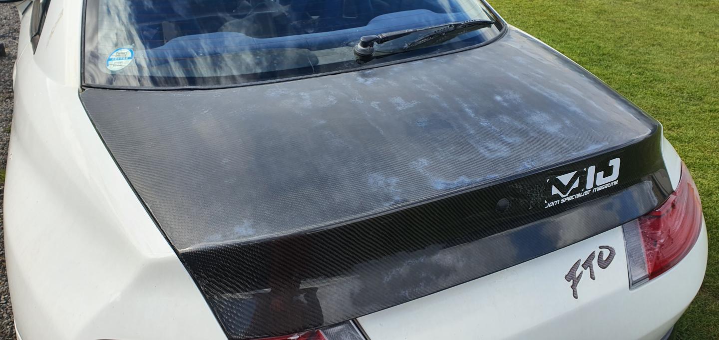

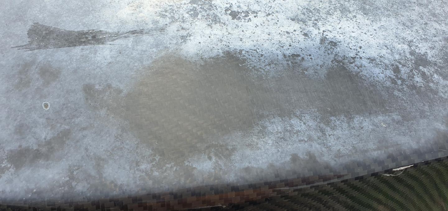

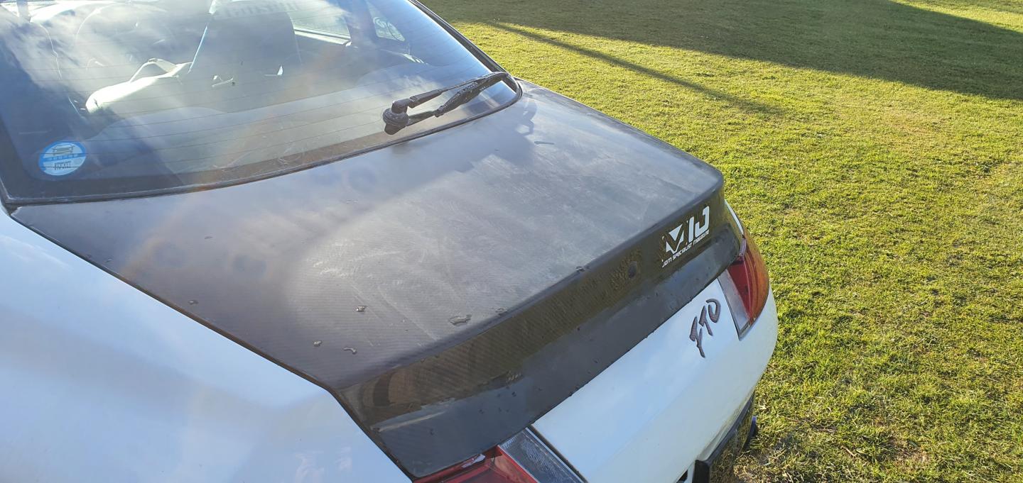

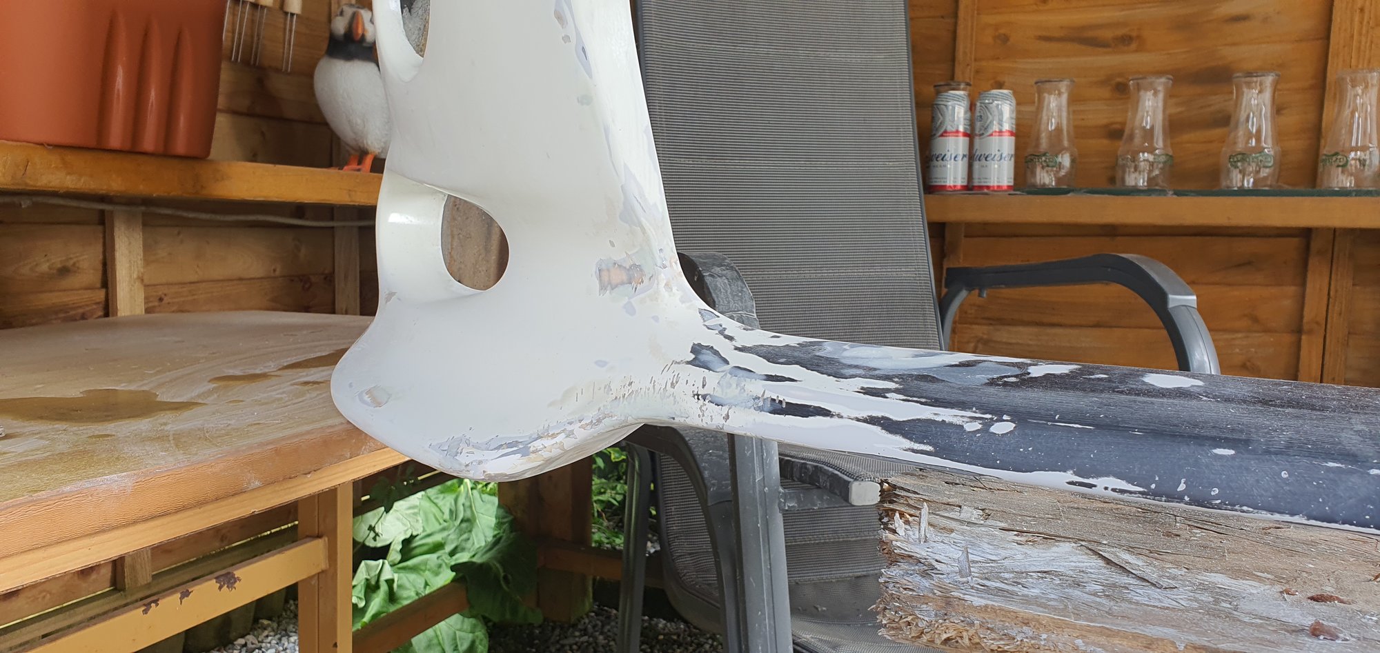

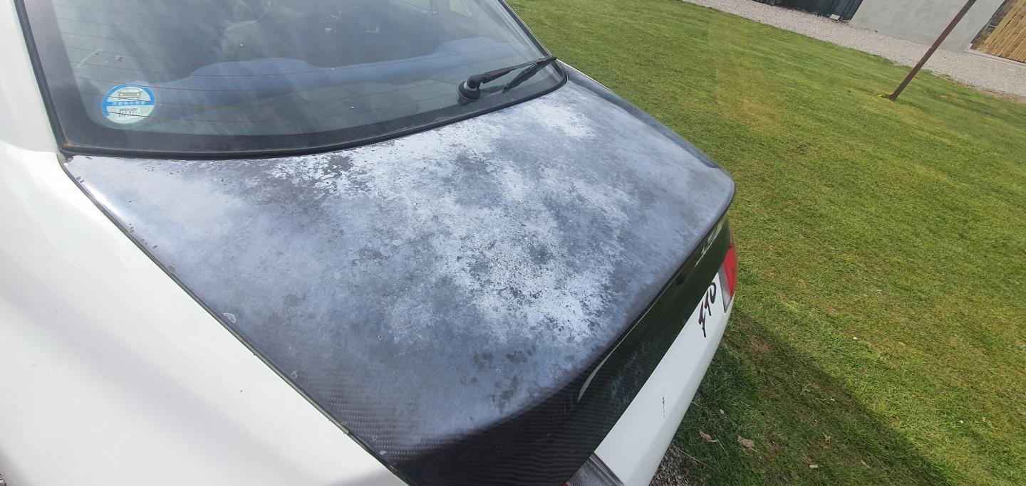

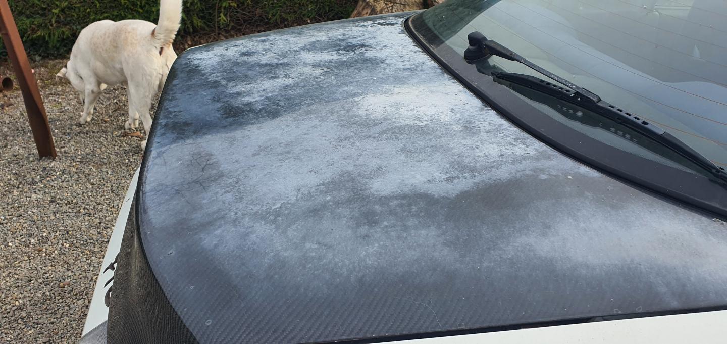

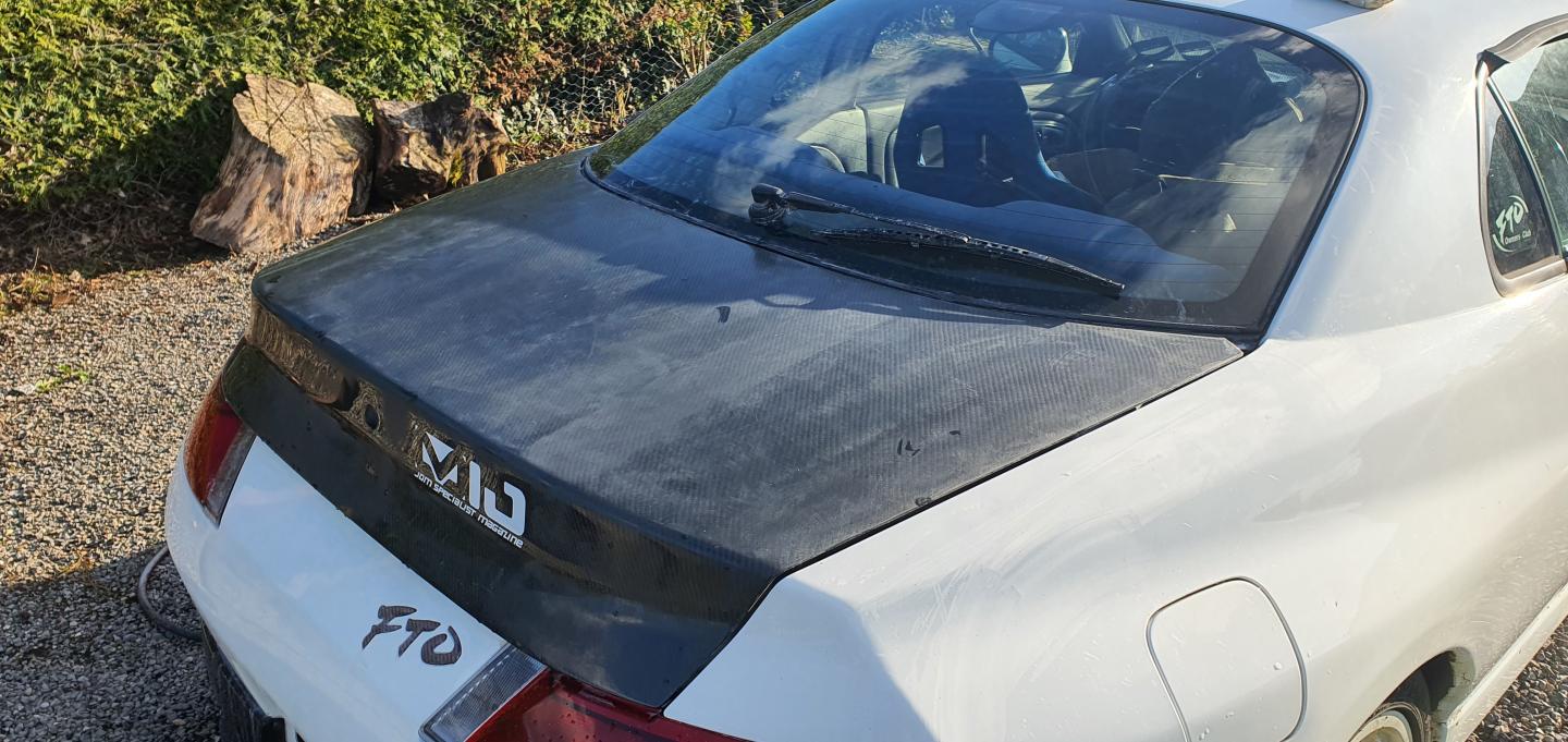

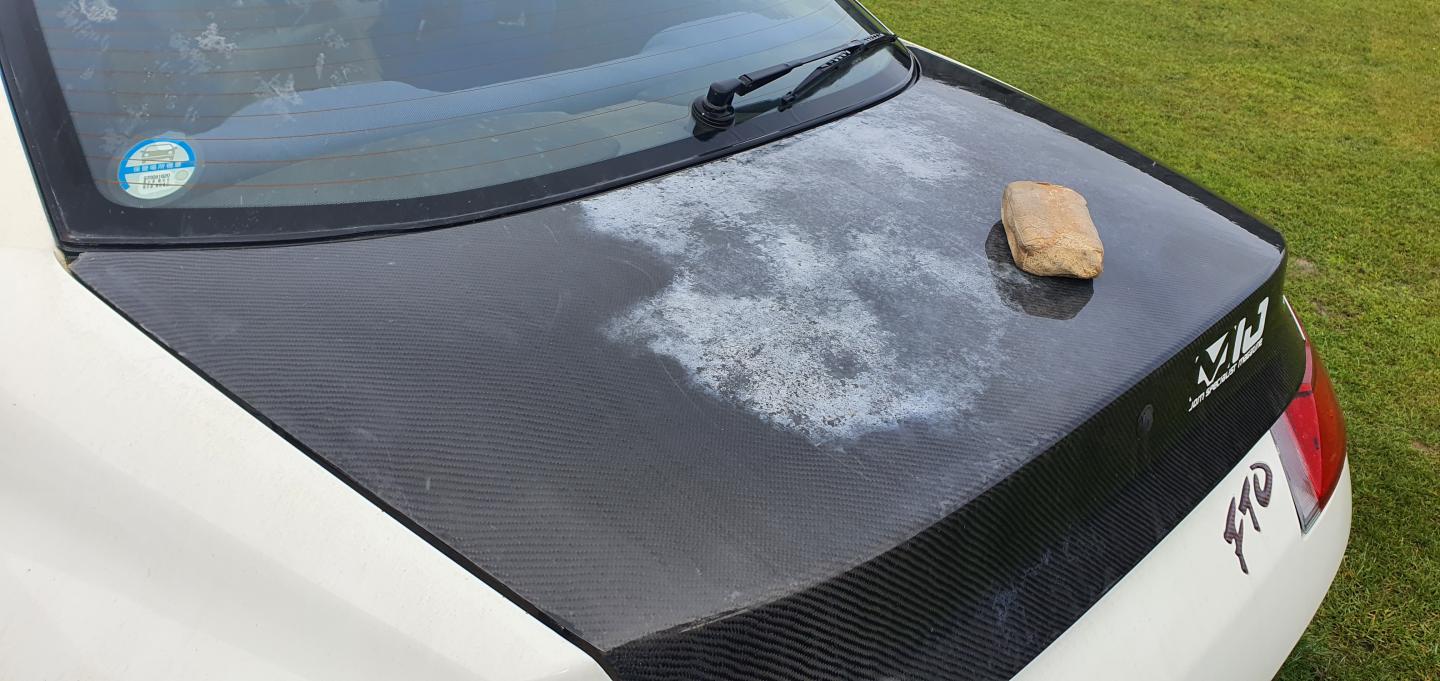

I had a little free time today so decided to tackle my heavily oxidised carbon fiber bootlid.
BEFORE

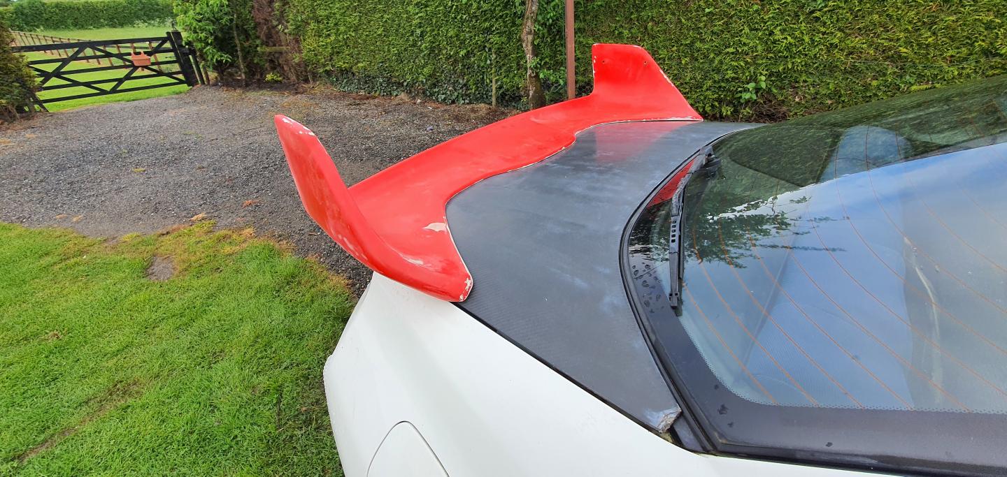

Did a little patch test with 1000 grit and looked promising.
Decided to go down to 600 grit and was looking very promising.
First pass done.
Second pass
I'm going to go at it again with 480-600 grit and take down the clear coat right down and then I'll reclear it with 3-4 coats of new clear.
