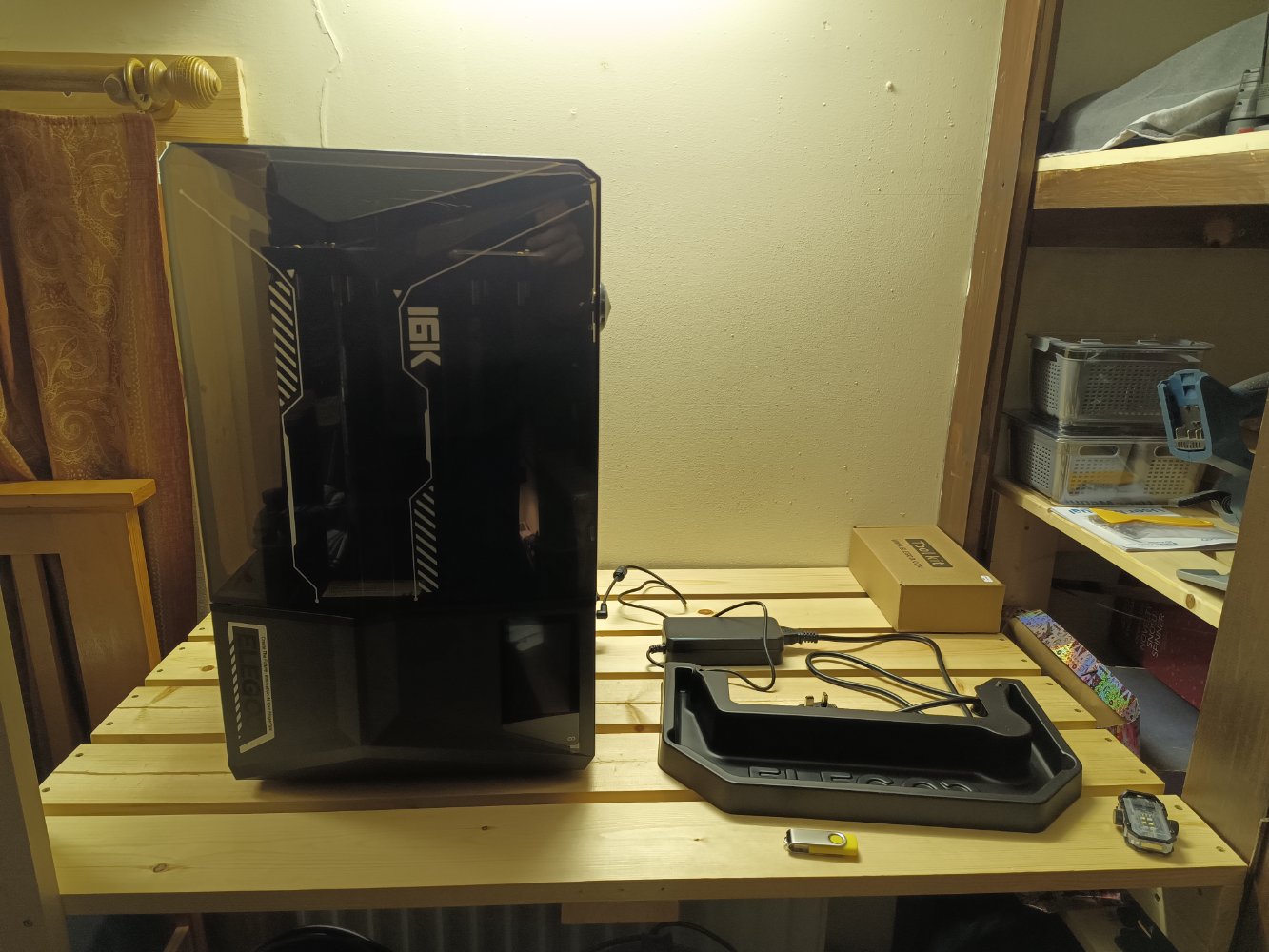

Have they improved the drip tray or is it still flimsy?It's out of the box.
I've still not yet received any resin or Isopropyl though. I'm thinking this'll be a next weekend play session now.
I'm going to stiffen that bench it's on, a bit, as that was part of a larger setup. It's lost a tad of rigidity now I've removed the rest of it.

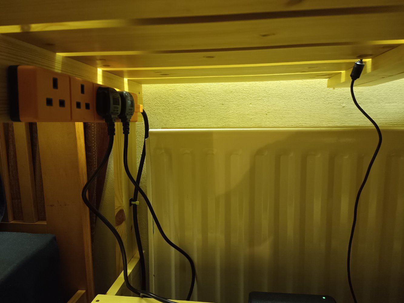

Also wired up a permanent four socket extension for that bench, today, as there's no power socket in that corner. 1.5mm rubber flex. That stuff's like battling a snake when you're trying to wire up.

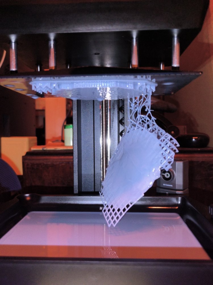

Has the room temperature dropped...are you printing at night rather than during the day when heating may be on?Question. I've started having issues with the print detaching. This is the same fairy house file I printed the other day, in order to print a known & tested print.
Which is the most likely suspect there; The film in the bottom of the vat or the resin?
