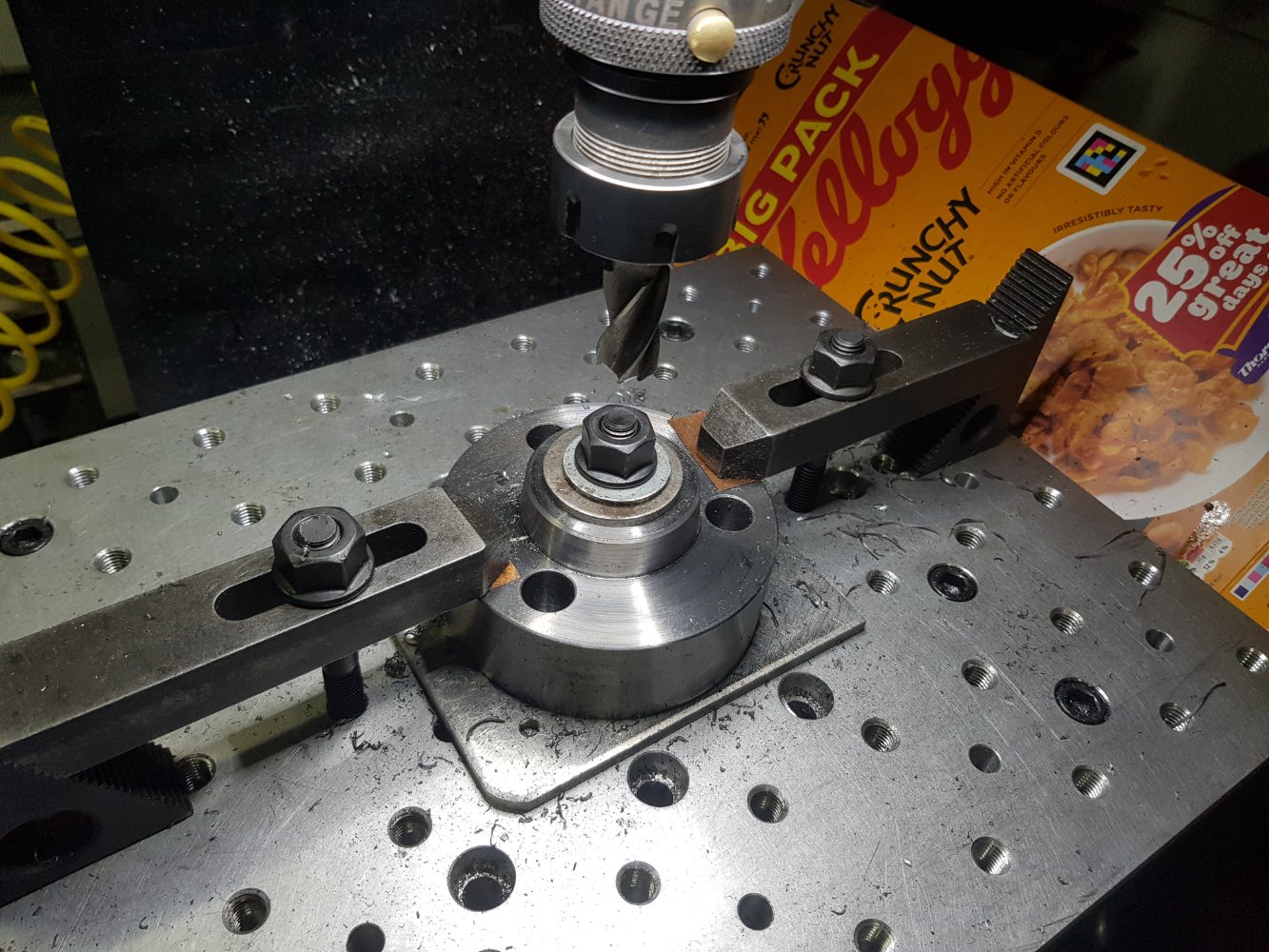

Finished machining the holes for the spindle adapter tonight , just need to work out a way to secure it now . Its a bayonet fitting on the lathe the studs and nuts pass through the nose then you rotate a ring so that you can tighten the nuts down on a narrower slot . I'm thinking of machining a pocket at the bottom of the adapter where i can slide in a U shaped washer and tighten down the nuts . Not ideal but at the moment the only way I think of.
