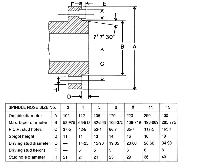

My lathe has a nose similar to D1-4 but is called DIN 55027 and uses a bayonet type hold down retainer with studs
The angle of the nose fitting I always thought was odd but 7'7'30" equates to 7.125 degrees and using the handy FSWizard app on my phone found out this means its a 1 in 4 taper

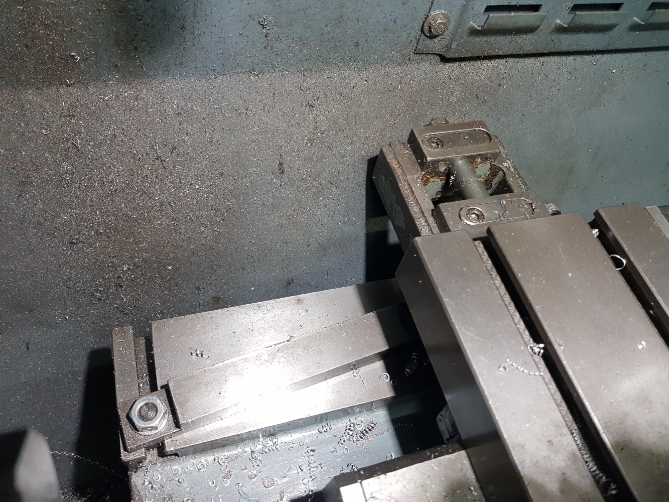

This is my taper attachment I have about 300mm of travel but ultimately I only need 11mm for this job

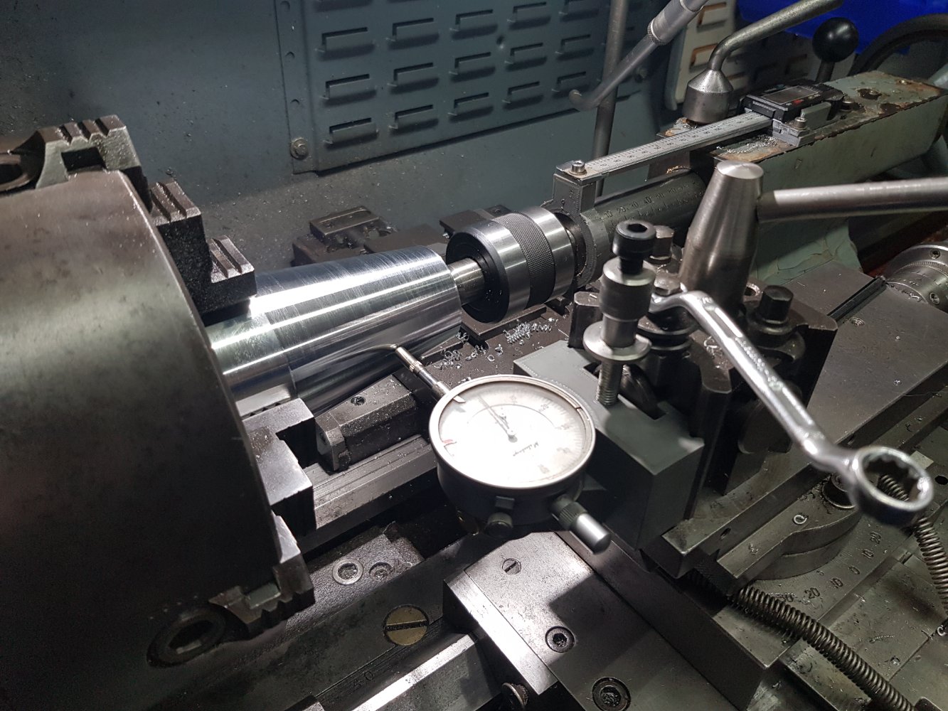

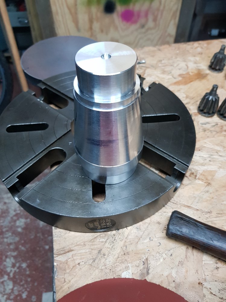

The adjuster has some play and the markings are not the best so in a moment of rare inspiration I thought the best thing to do is to machine a 40mm + taper onto some aluminium bar stock then I can adjust until I get it right
Consequently after some very fine adjustment and swearing I achieved as closed as I could get without going insane
The advantage of cutting a test piece is also that i can set it up in the lathe at any point afterwards and use it either way round to set the correct taper up on the attachment
It is center drilled each end and has surfaces each end for a dial gauge to check its cantered in chuck

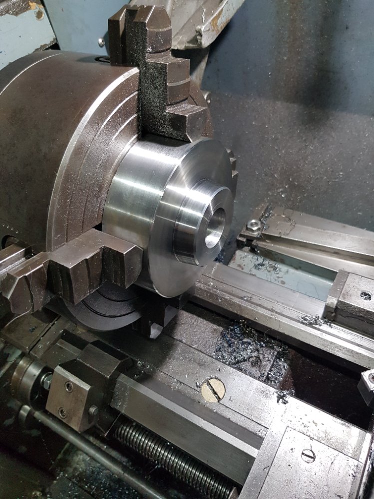

Final result is a copy of the chuck nose I blued two back plates and the taper is perfect , I couldn't get a 5thou feeler in-between face and the back plate and im happy with that

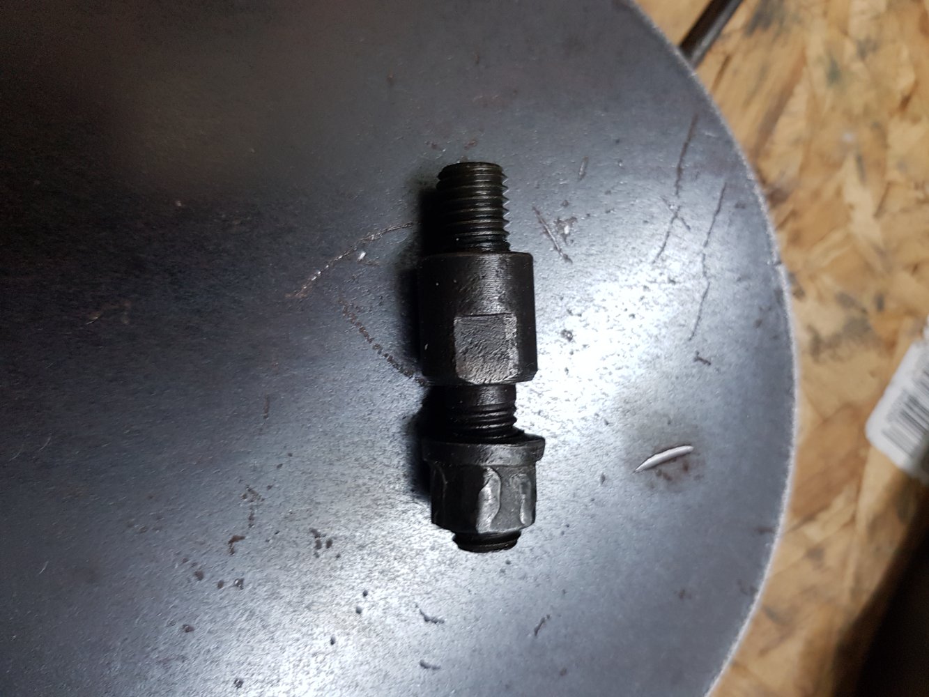

I just have to machine the holes for the studs and the pocket for the drive stud

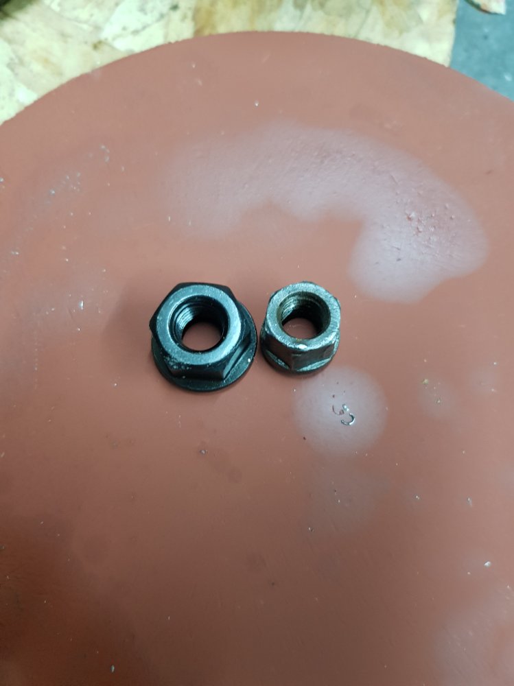

Next issue is where to get some M10 nuts like these but with 14mm flats not 17mm as they wont pass through the holes in the spindle , Ive looked everywhere but i think i am going to be forced to make some
