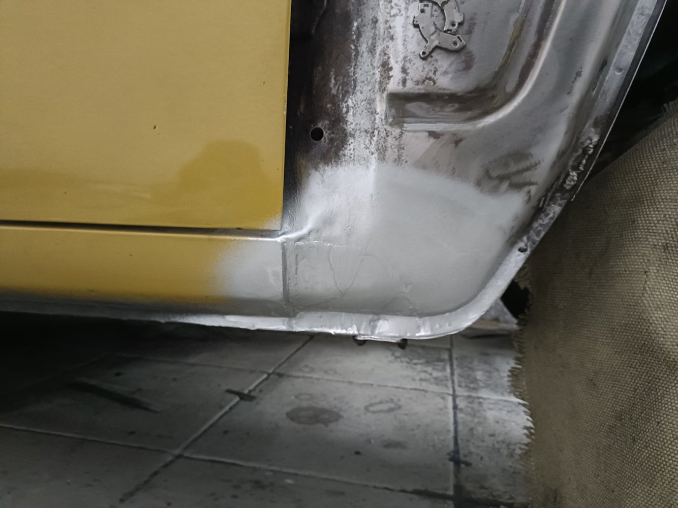

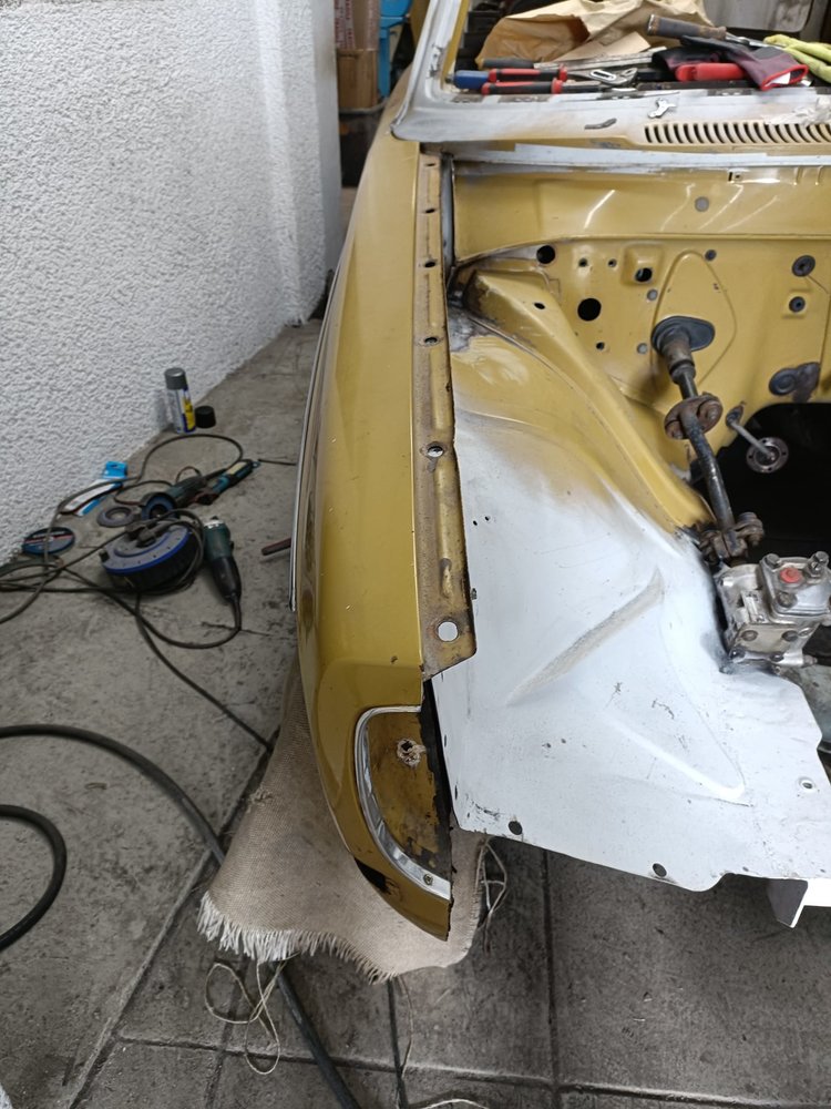

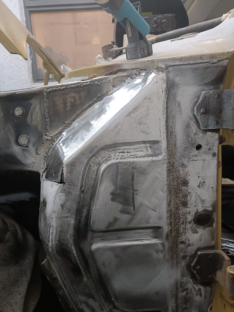

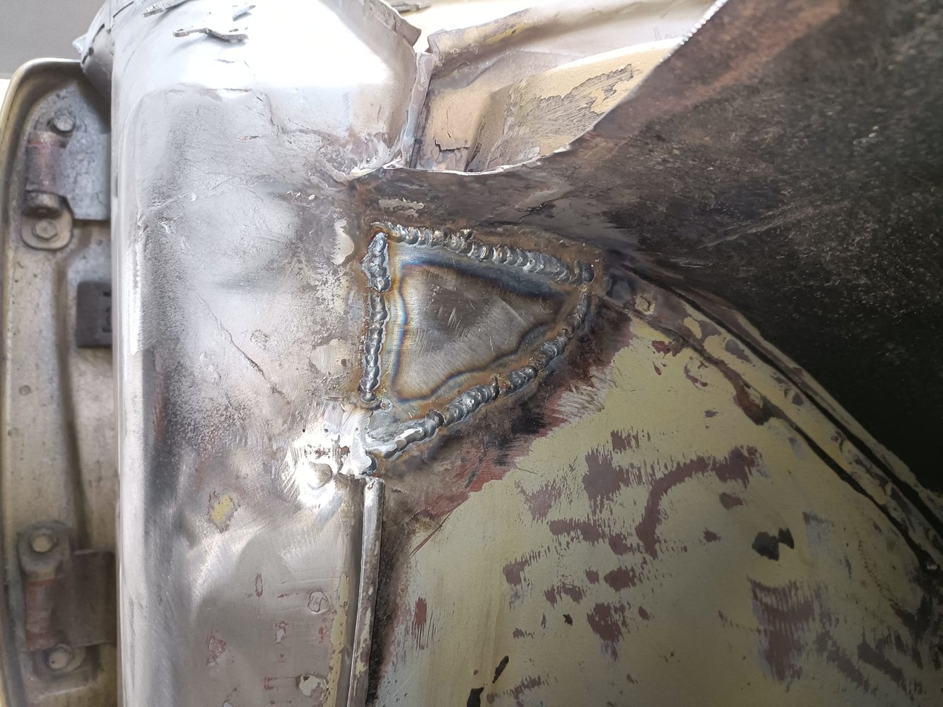

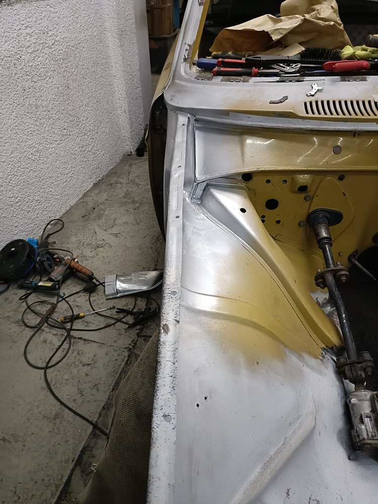

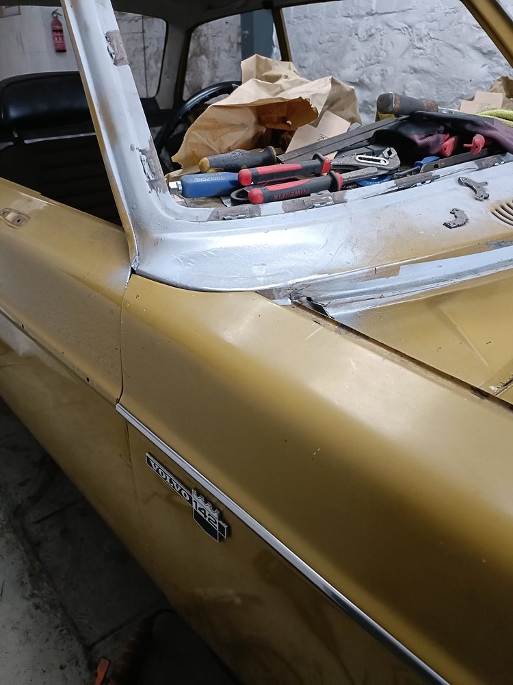

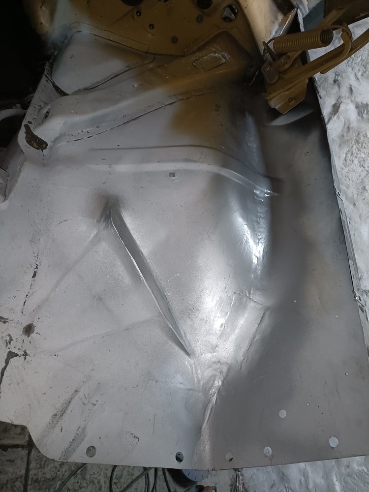

The last of the welding thankfull.Coming on really well, now come on, paint!![]()
Joking aside, you must be pretty close now, no?Coming on really well, now come on, paint!![]()
Yep just this area to finish.Joking aside, you must be pretty close now, no?
Thanks.More nice work there Mitch.

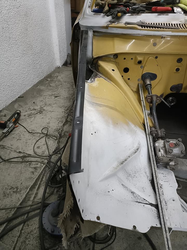

Have you had the bonnet on recently, just as an alignment check?
Considering what you've done so far that'll be the least of your problems!Thanks.

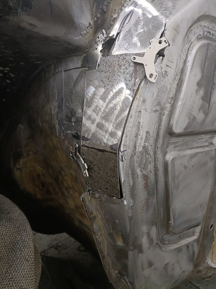

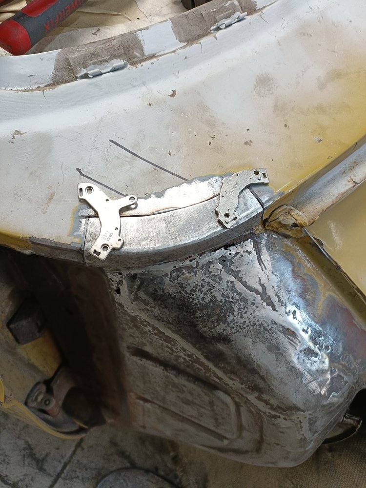

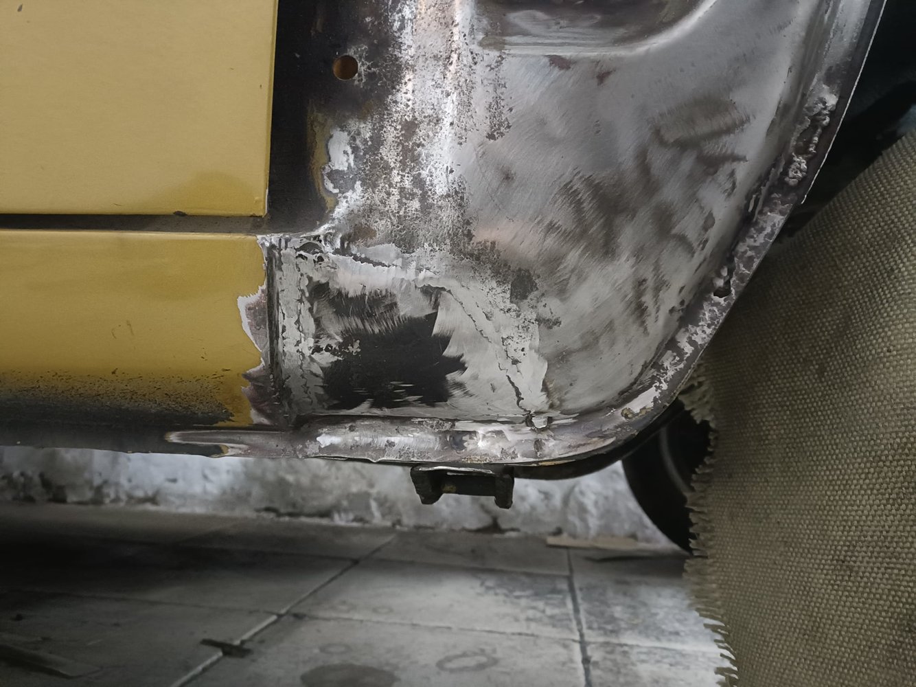

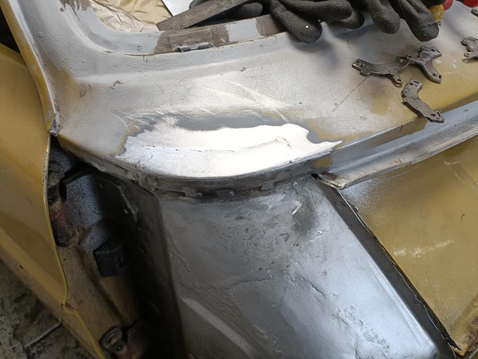

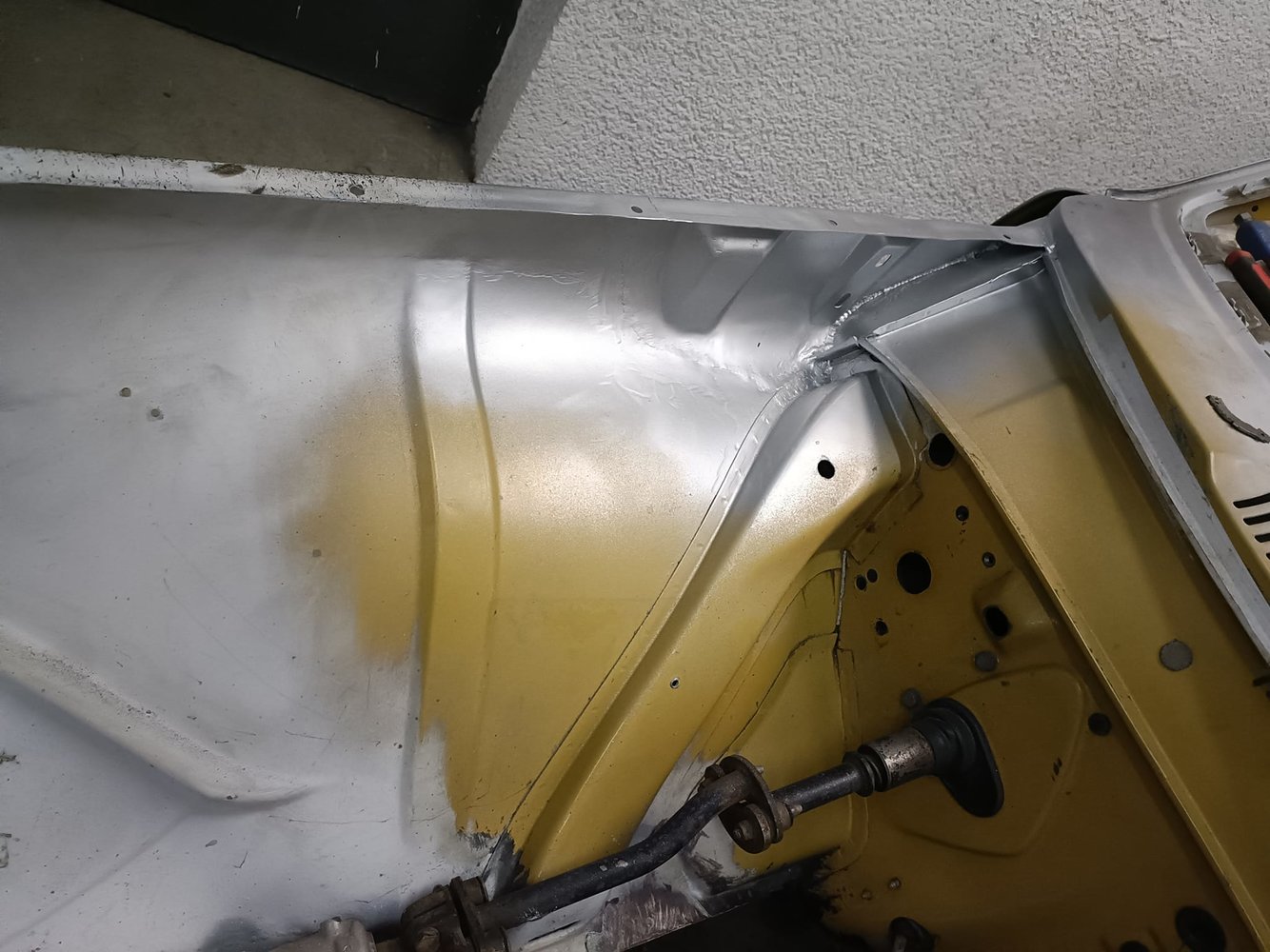

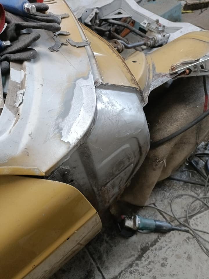

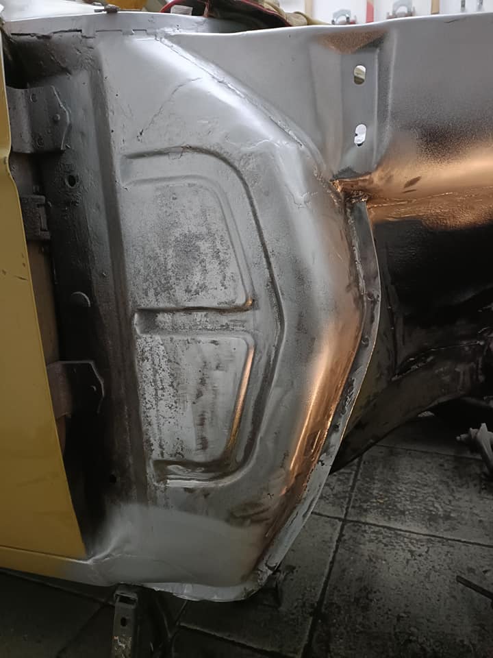

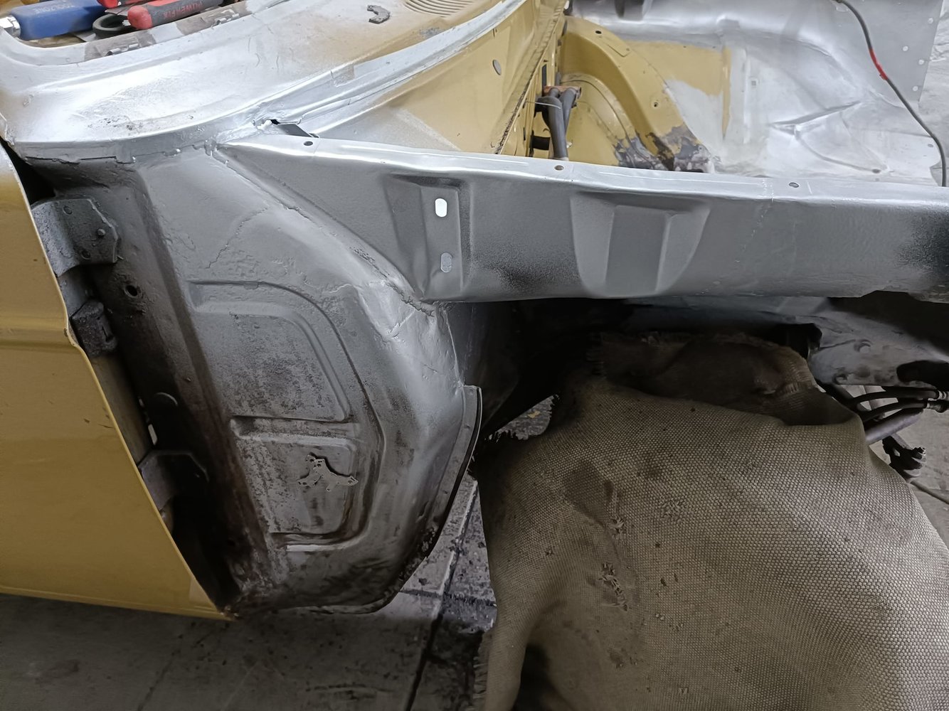

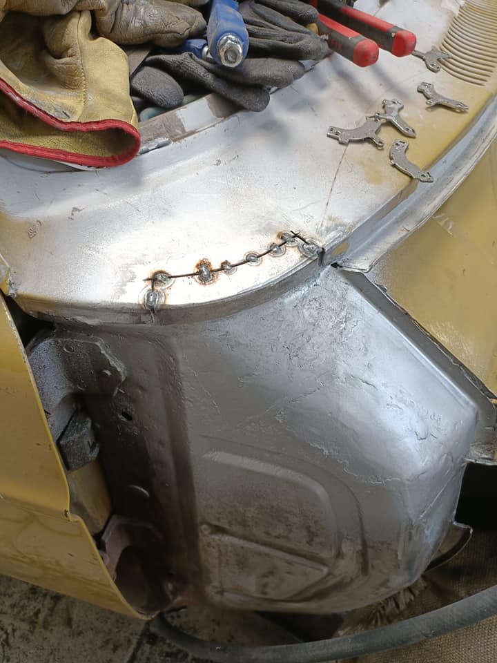

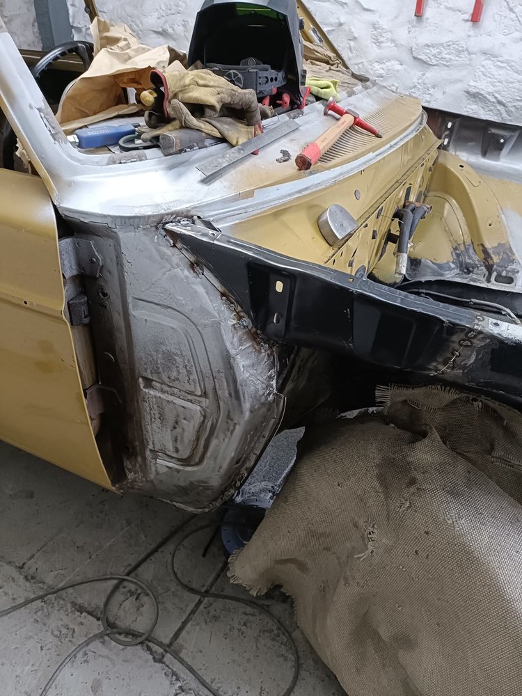

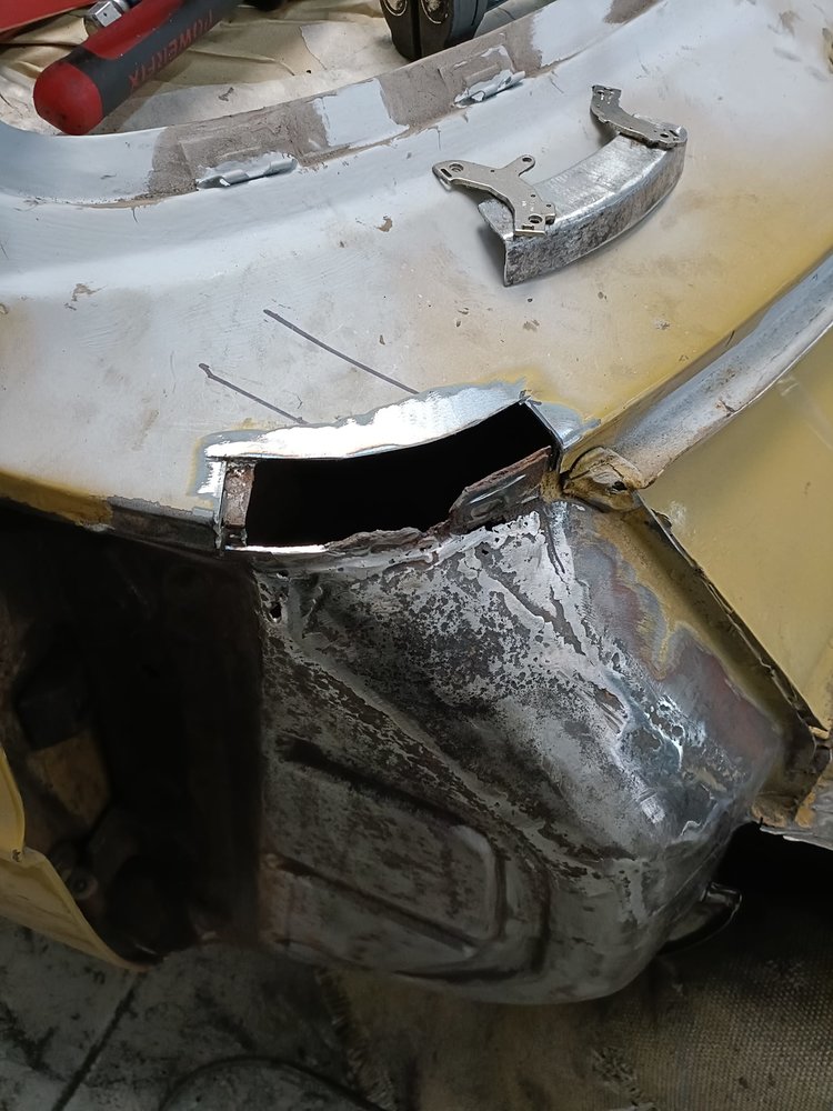

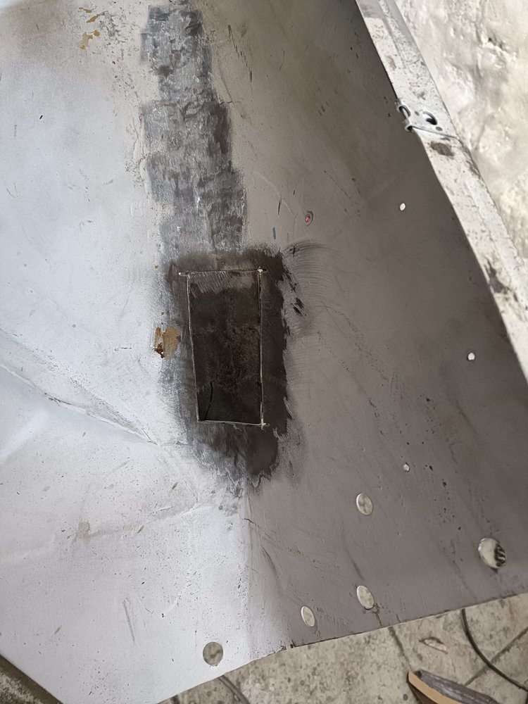

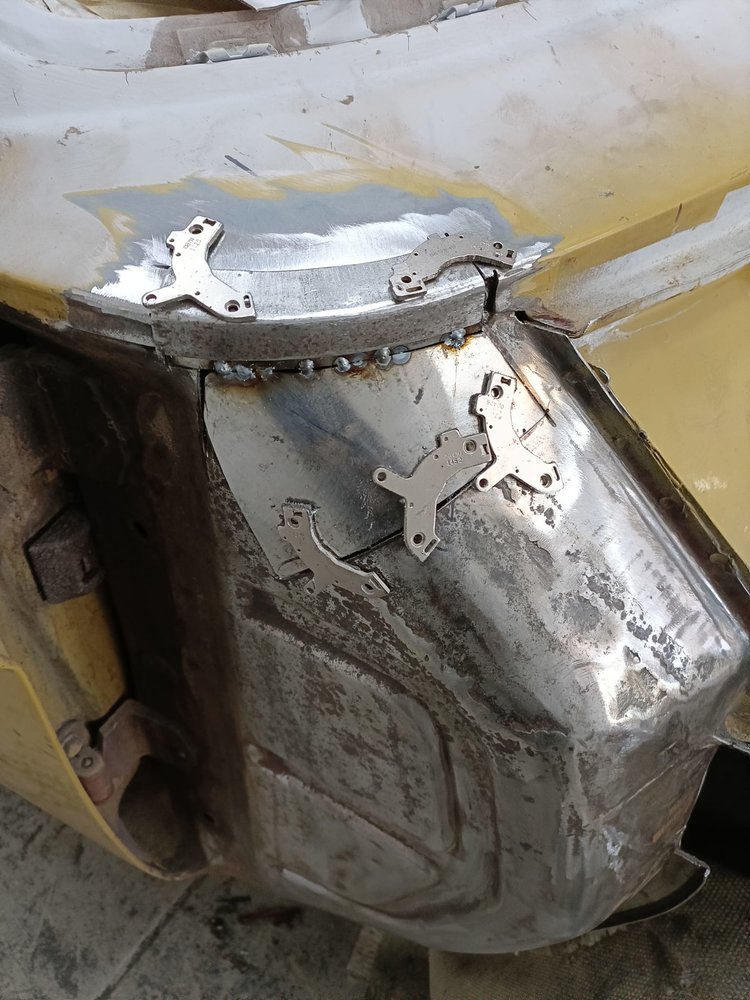

I only just took it off so I could do the inner wing repair. As long as the hinge bolt holes are okay she should be fine. I used the bolt holes in the top of the wing as locators for the repair section and got the height and distance out from a datum so she should be all okay. There's a reasonable amount of adjustment to get it right so fingers crossed. I'll finish the lower repairs and then mock everything back up again to check. The holes in the inner wing repairs are off though on both sides, rubbish QC from the manufacturers but they are quite a roughly made panel. I'll need to fix the hole locations as well by either slotting the holes or cutting out and drilling new holes.

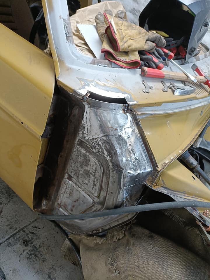

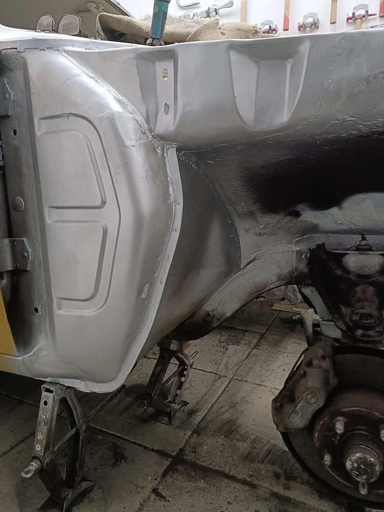

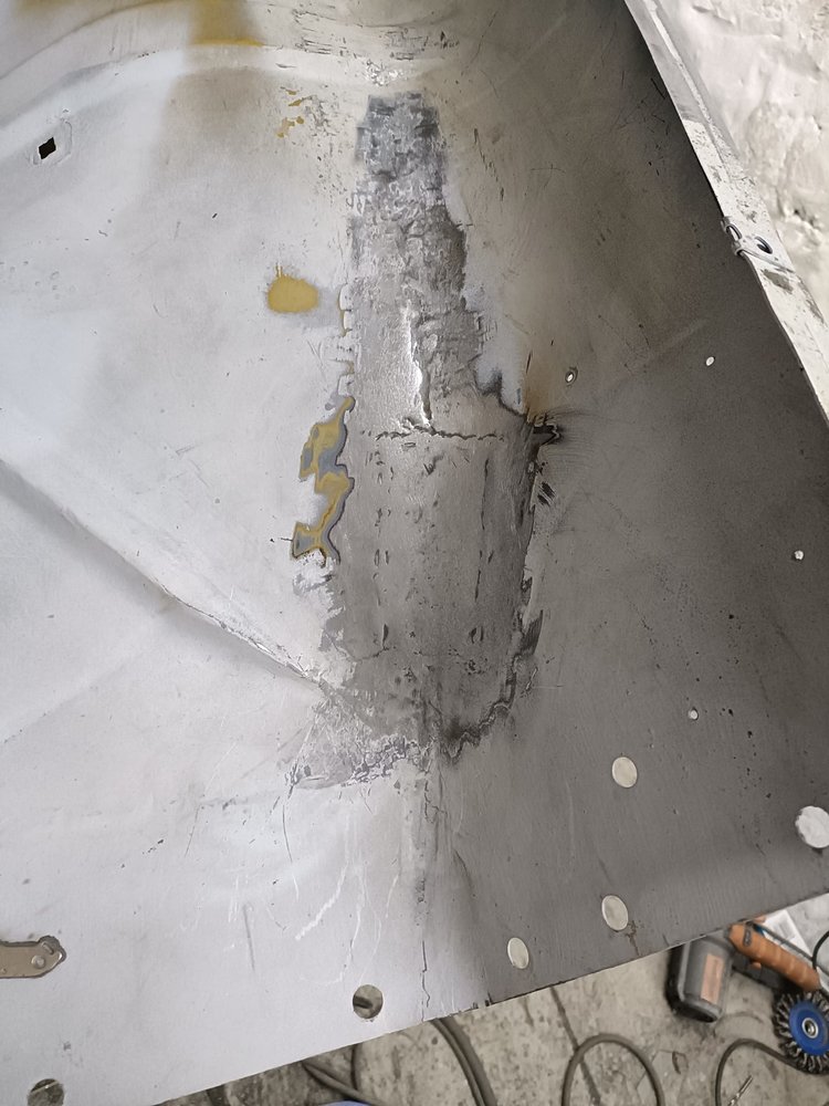

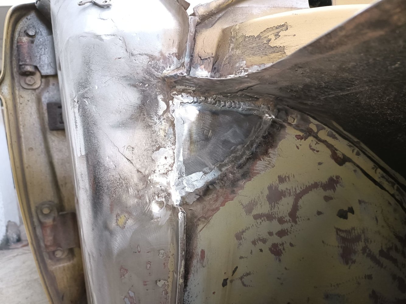

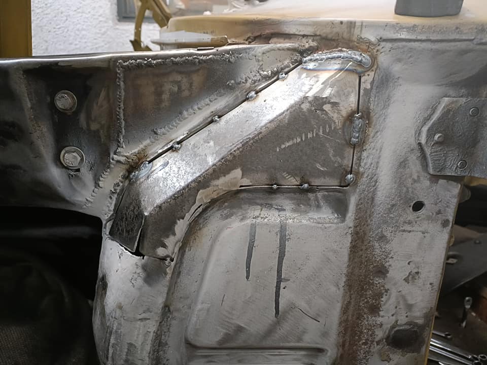

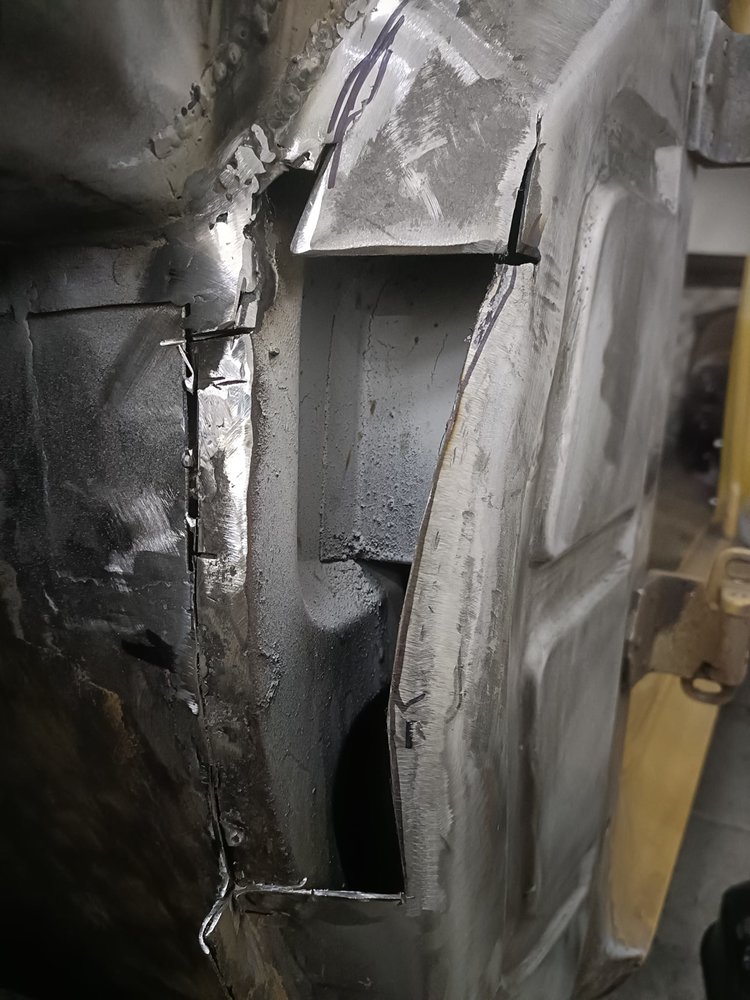

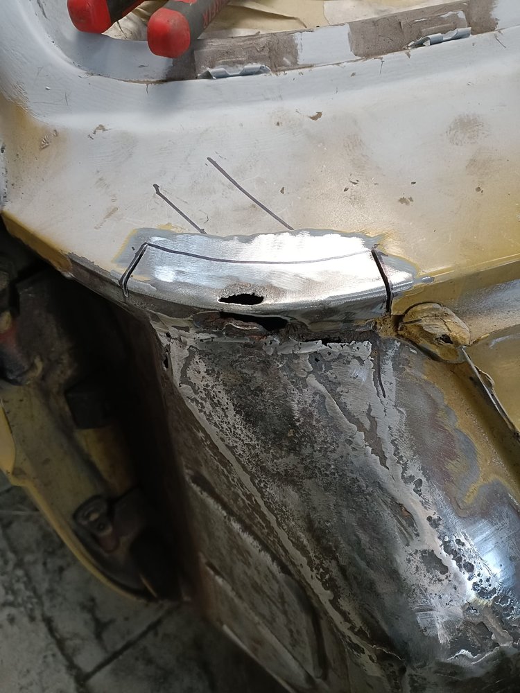

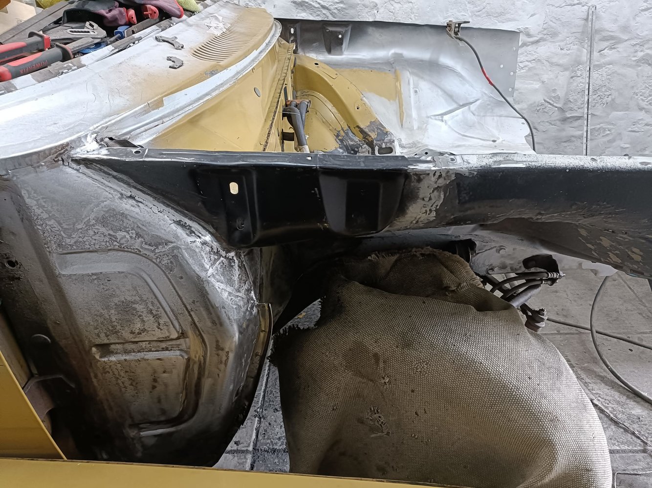

Some nice stretching/shrinking work by the look of it.Made a start on the right side inner wing. The old repairs are mostly good so just fixing the rusty bits. Ran out of mig gas so off to get some in the morning.

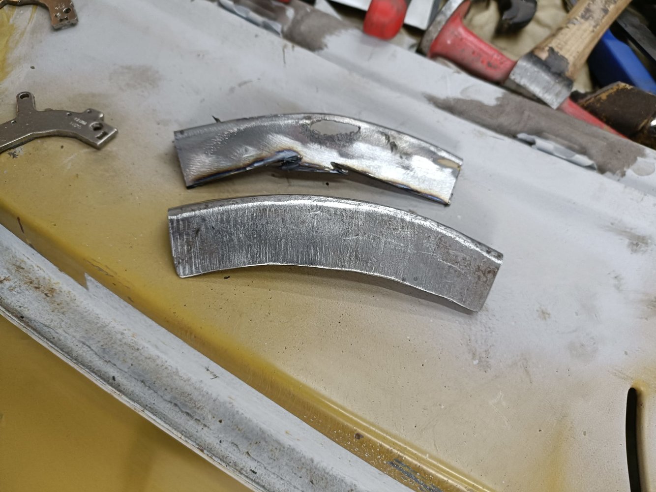

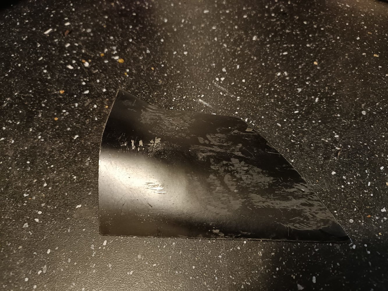

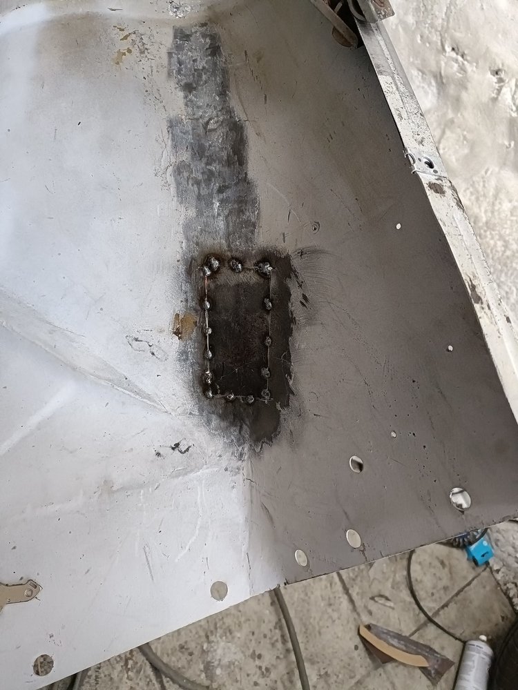

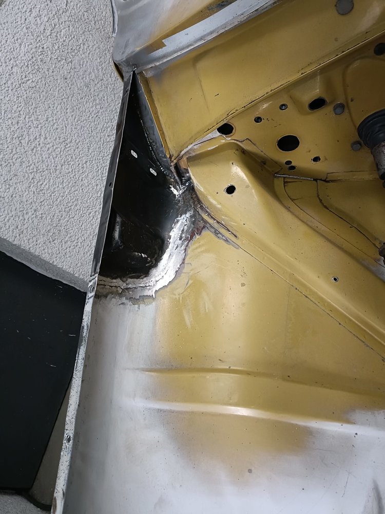

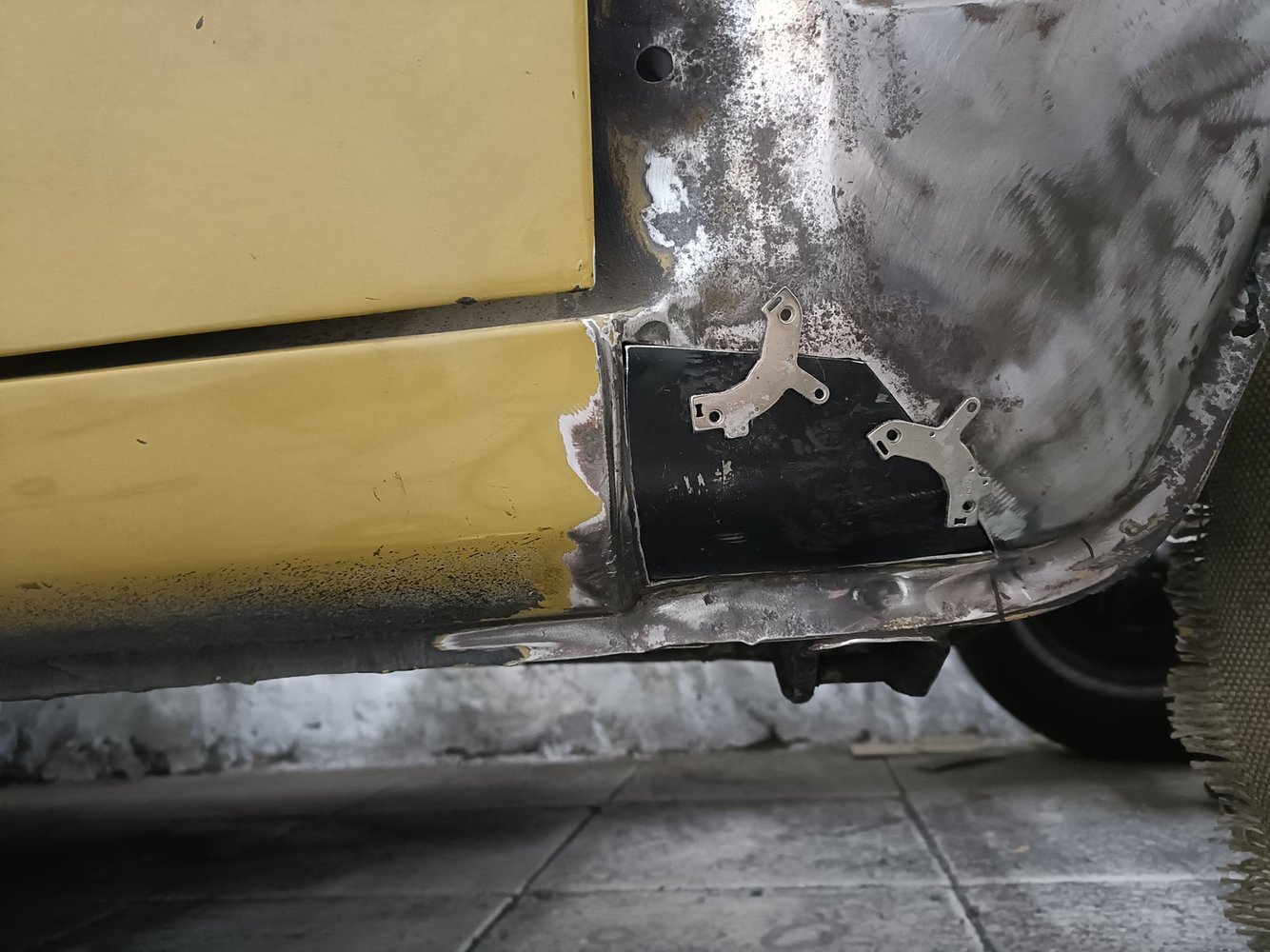

View attachment 402093 View attachment 402094 View attachment 402095 View attachment 402096 View attachment 402097 View attachment 402098 View attachment 402099 View attachment 402100 View attachment 402101 View attachment 402102
Thanks. Yep, I have a decent profile gauge and always have cardboard on hand for templates.Some nice stretching/shrinking work by the look of it.
I’d be happy if my work is as good as that!![]()

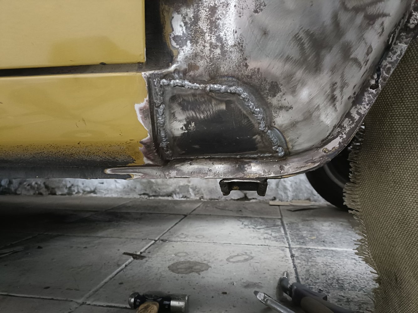

Sounds like a pain.Watching all this has reminded me of replacing a sill on a, I'm guessing, late 80's? 240 something estate. What a nightmare of a job. It wasn't due to corrosion, the car had been thrown off the road and into a ditch, so badly bent. The car should have gone to a blacksmith not a car repairer!

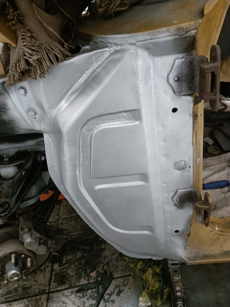

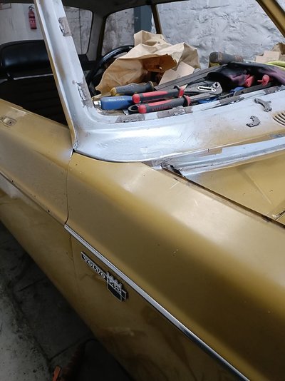

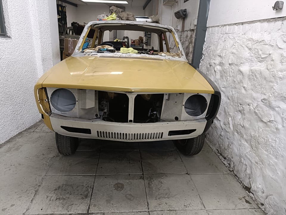

That colour match is shocking!!!Got her back together, still needs some tweaking. The NOS wing needed some tweaking and isn't great along the door edge. All in all not a million miles off.
