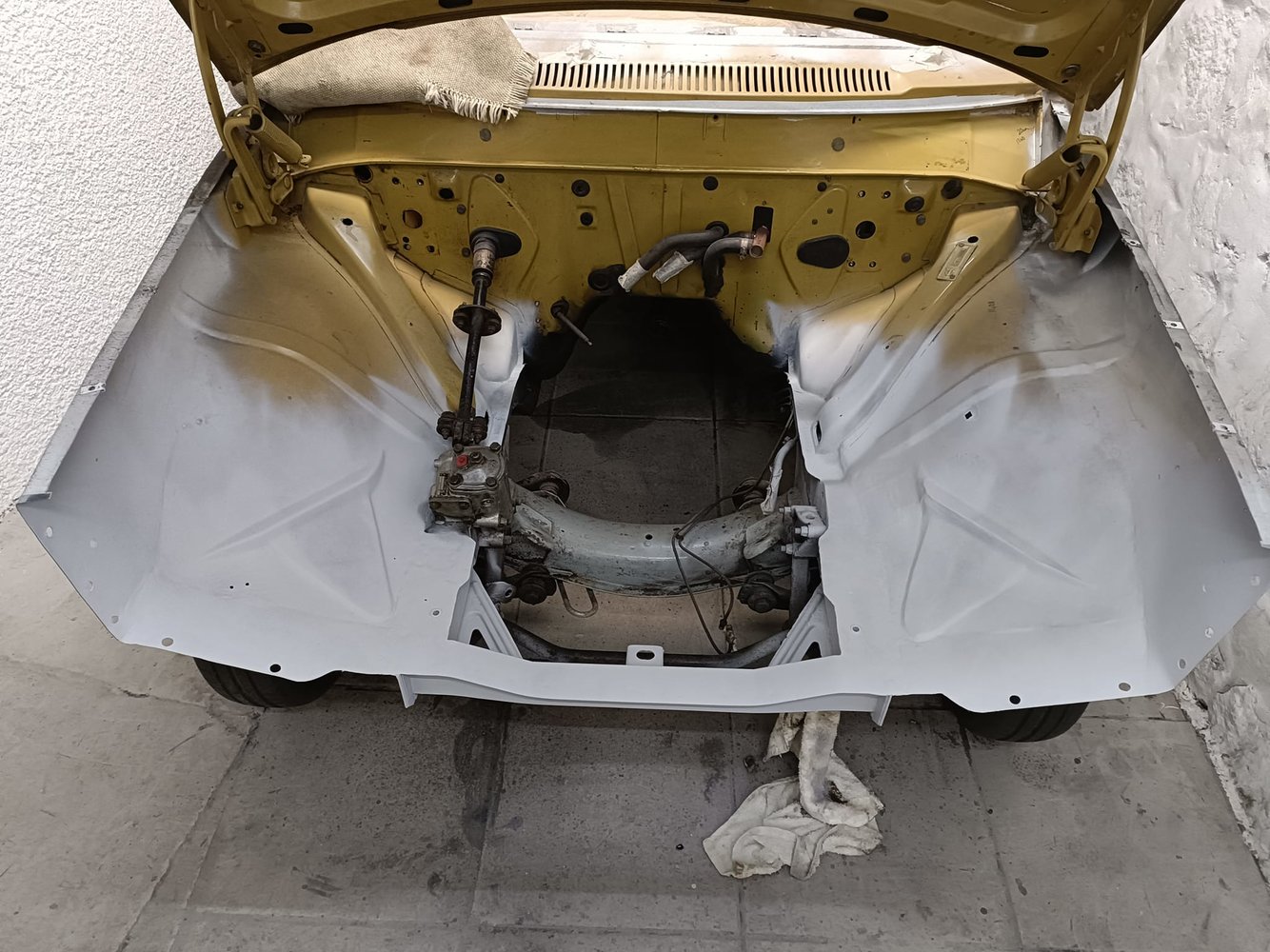

Thanks. Yeah can’t wait.Getting close to paint!
Nice job.

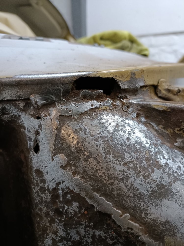

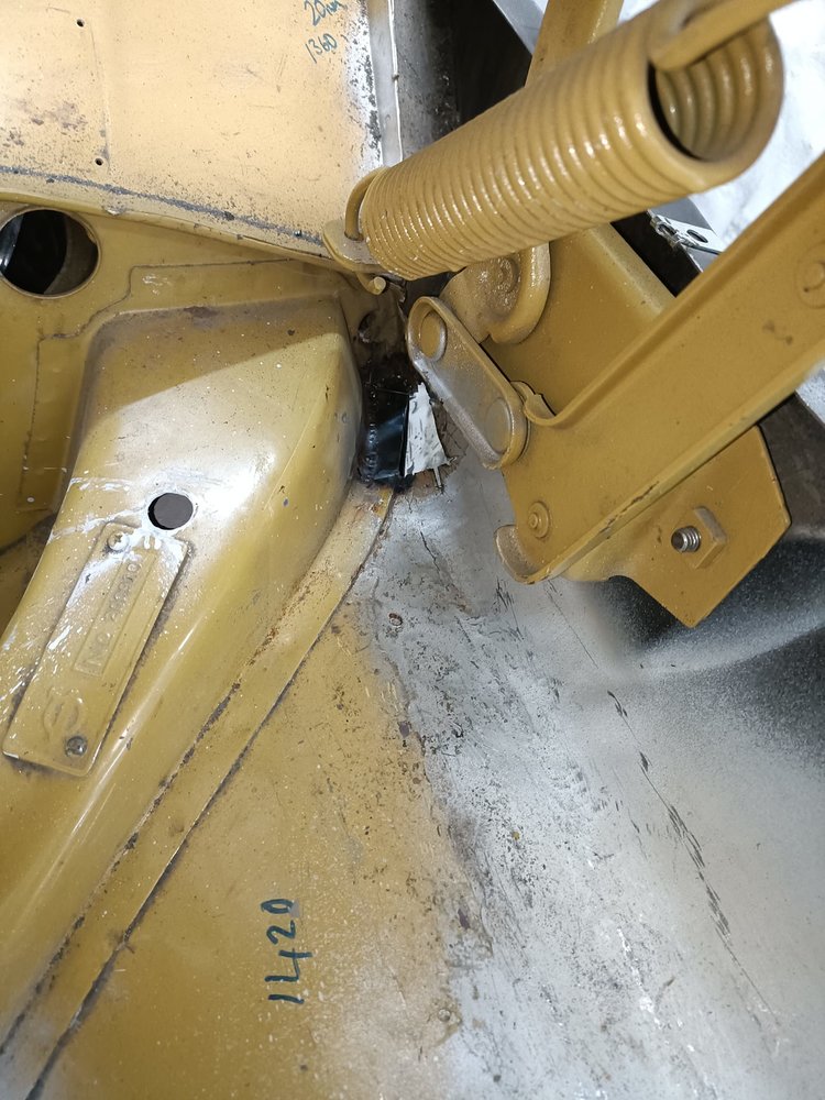

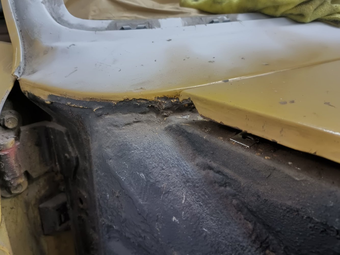

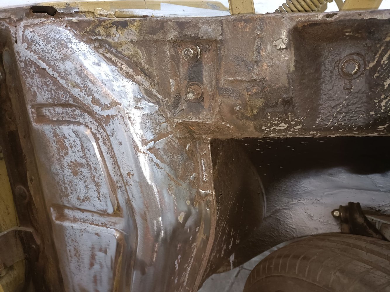

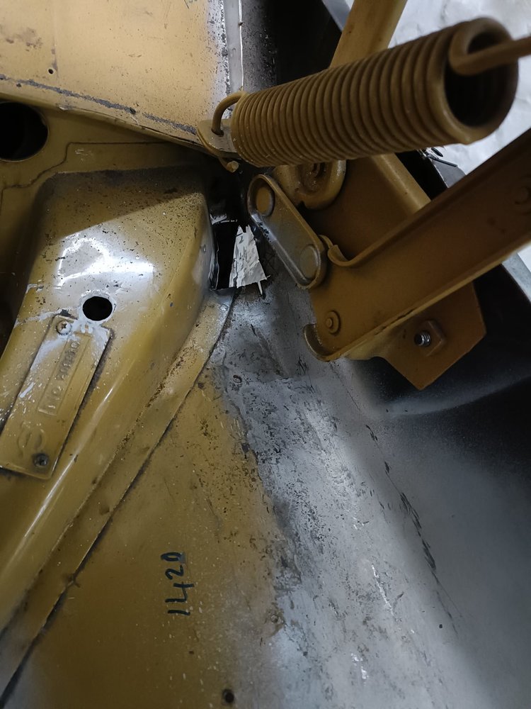

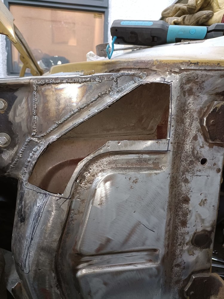

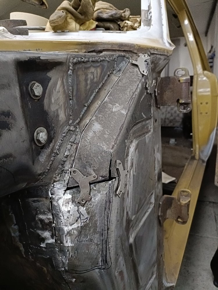

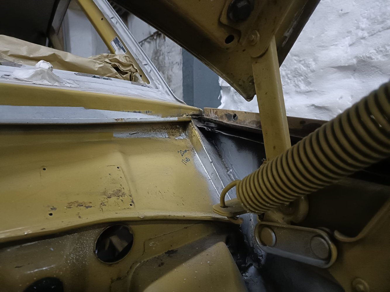

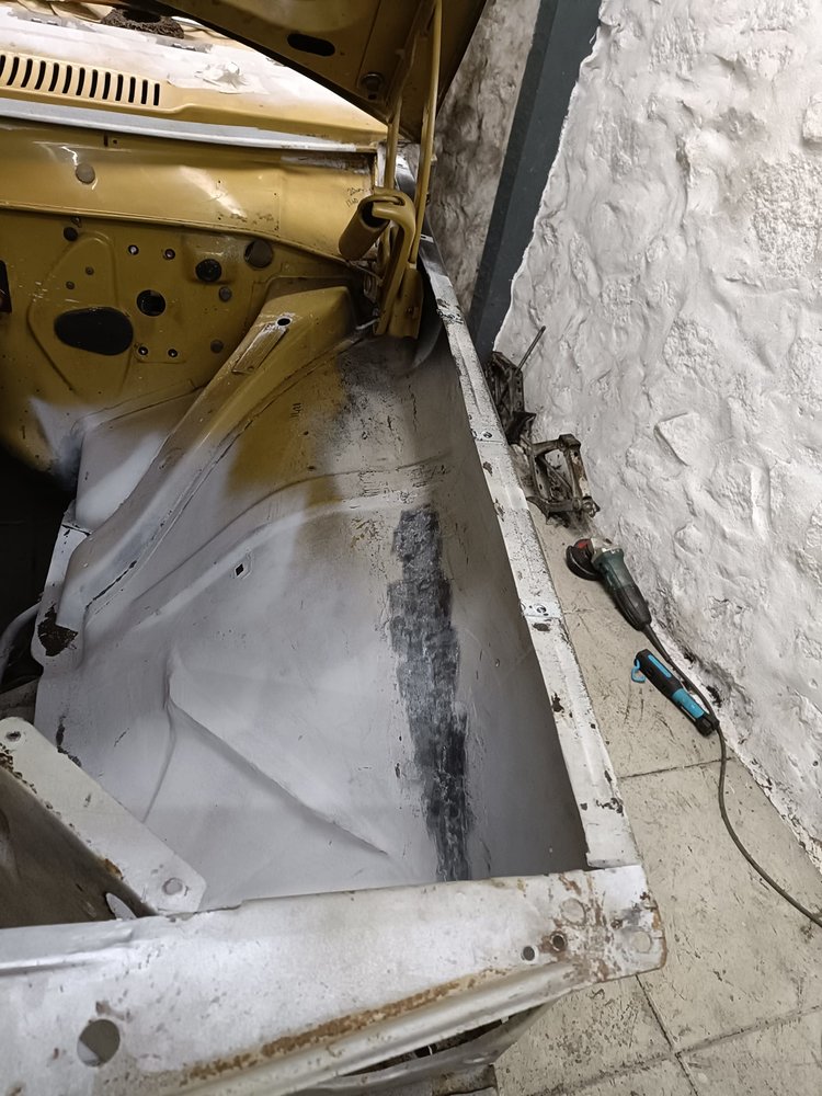

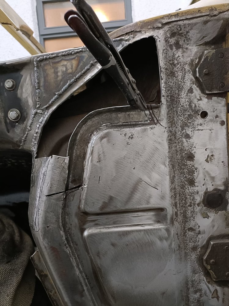

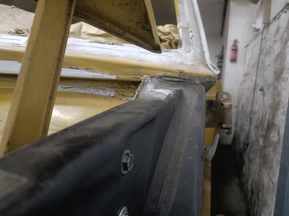

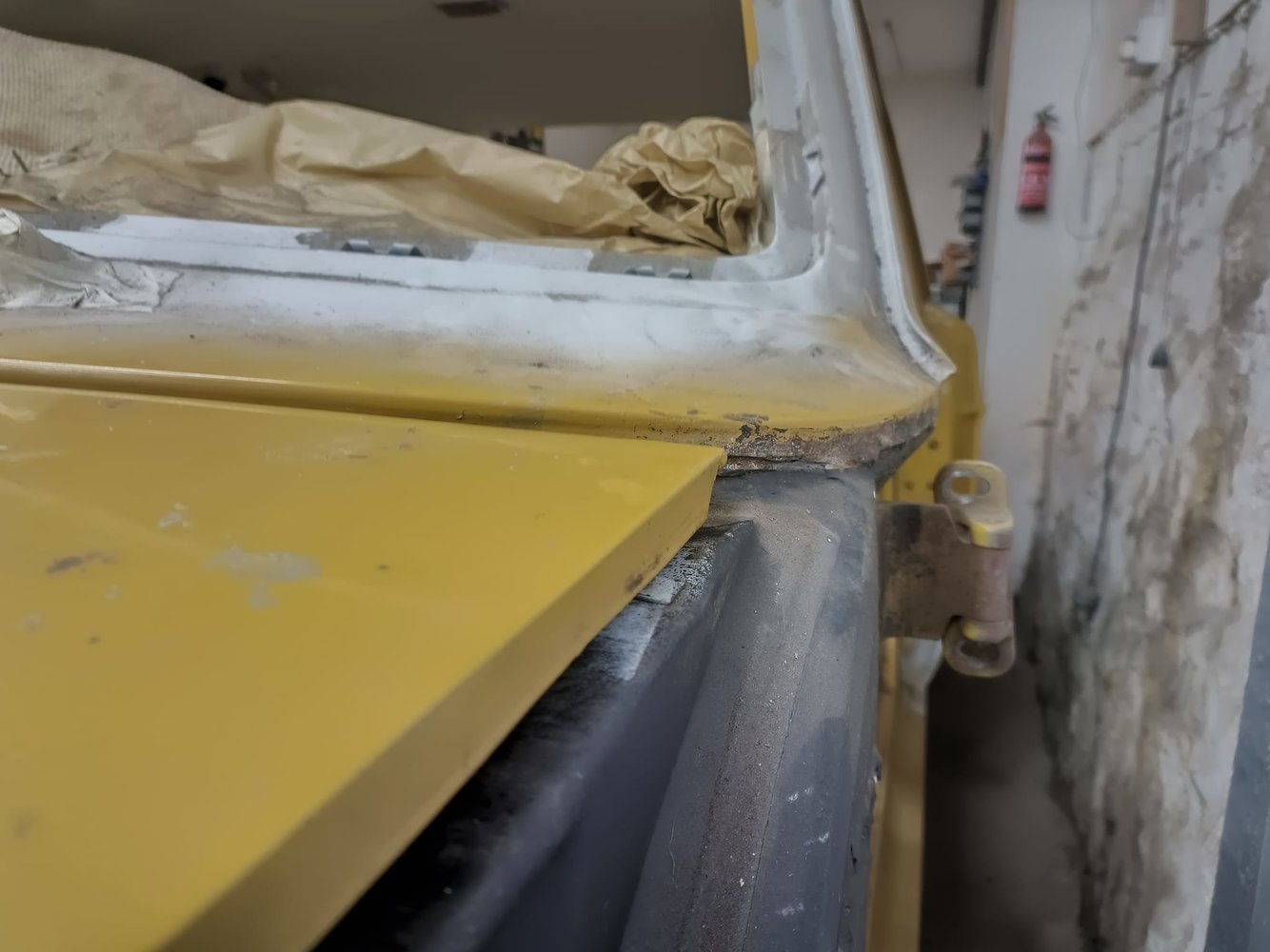

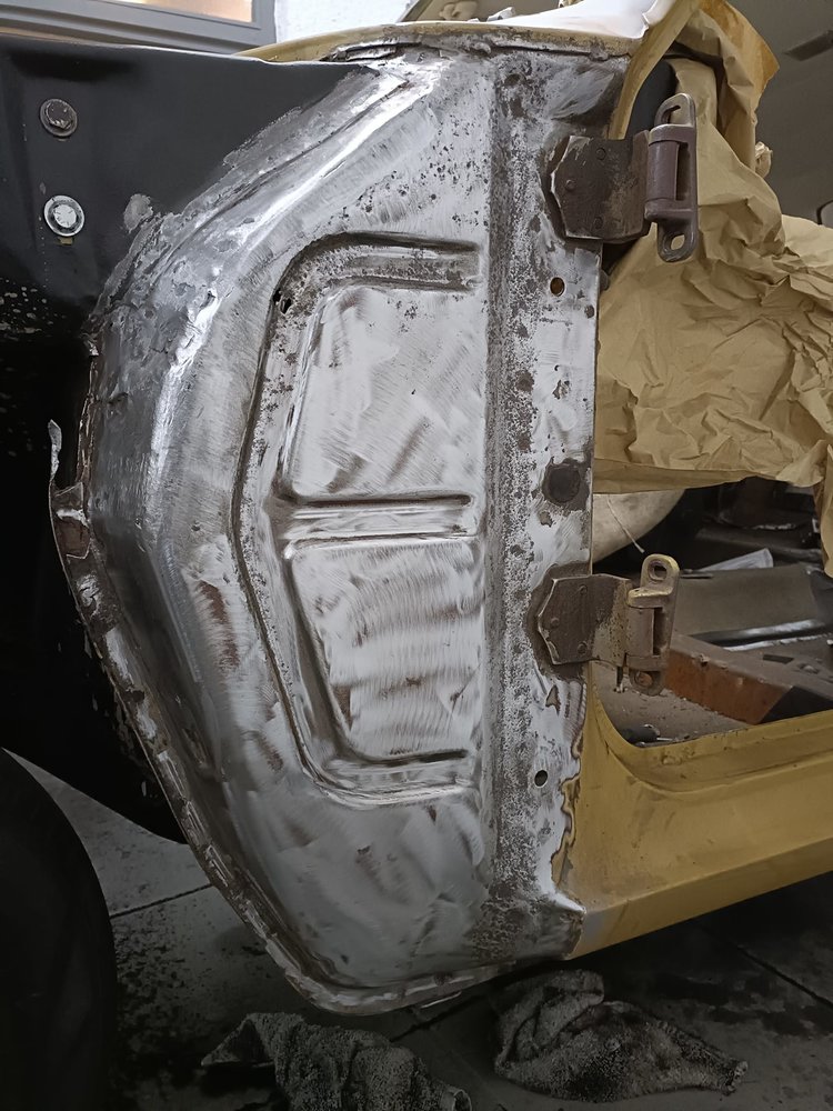

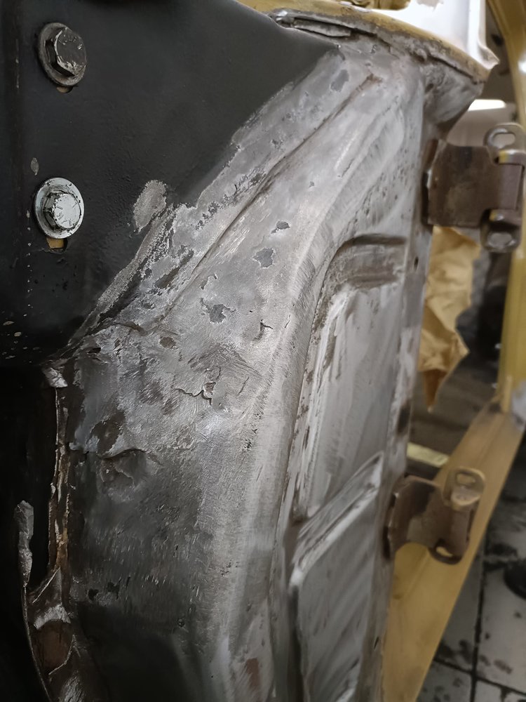

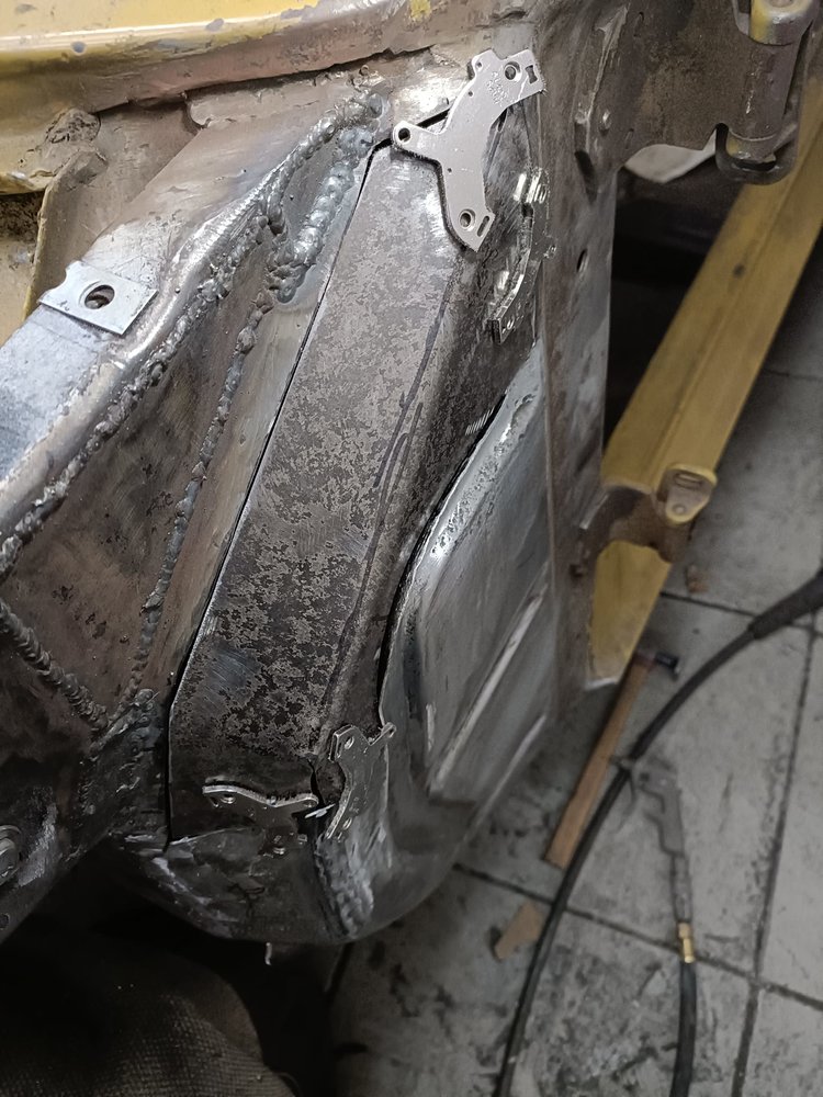

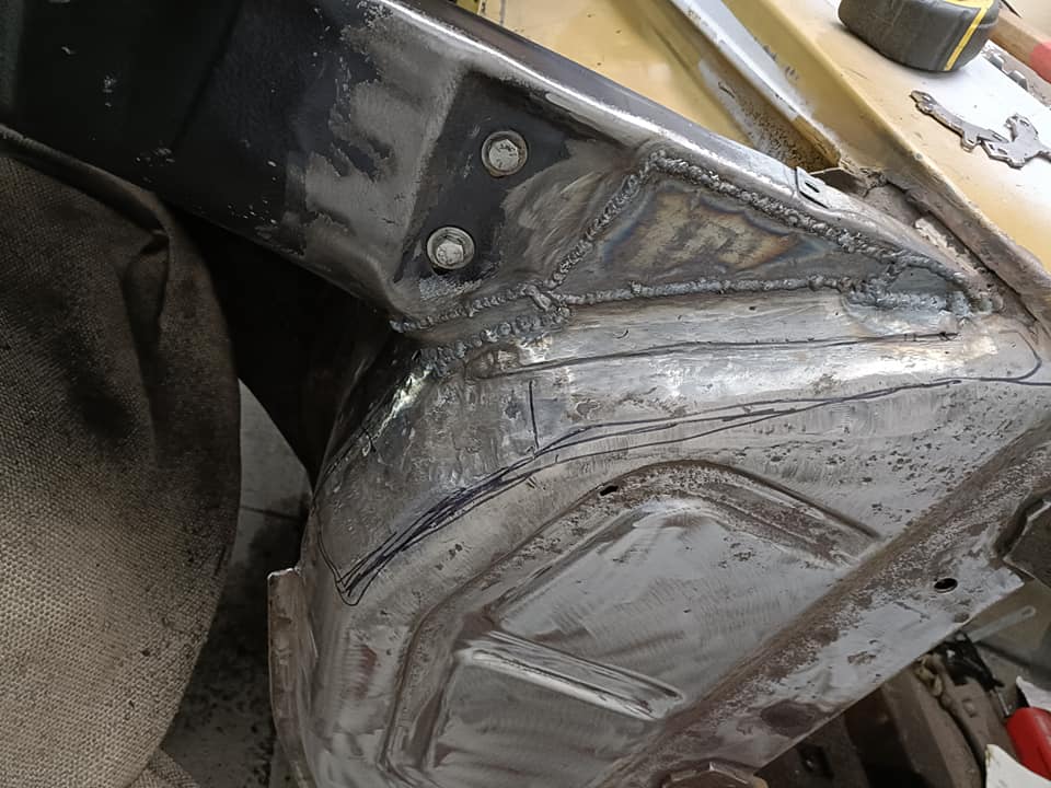

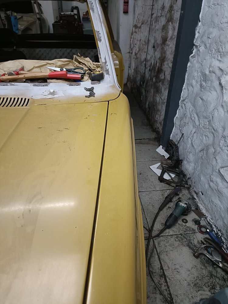

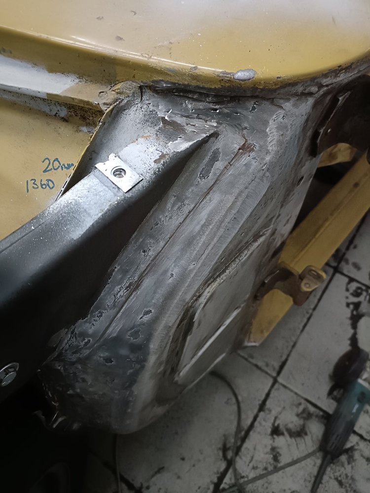

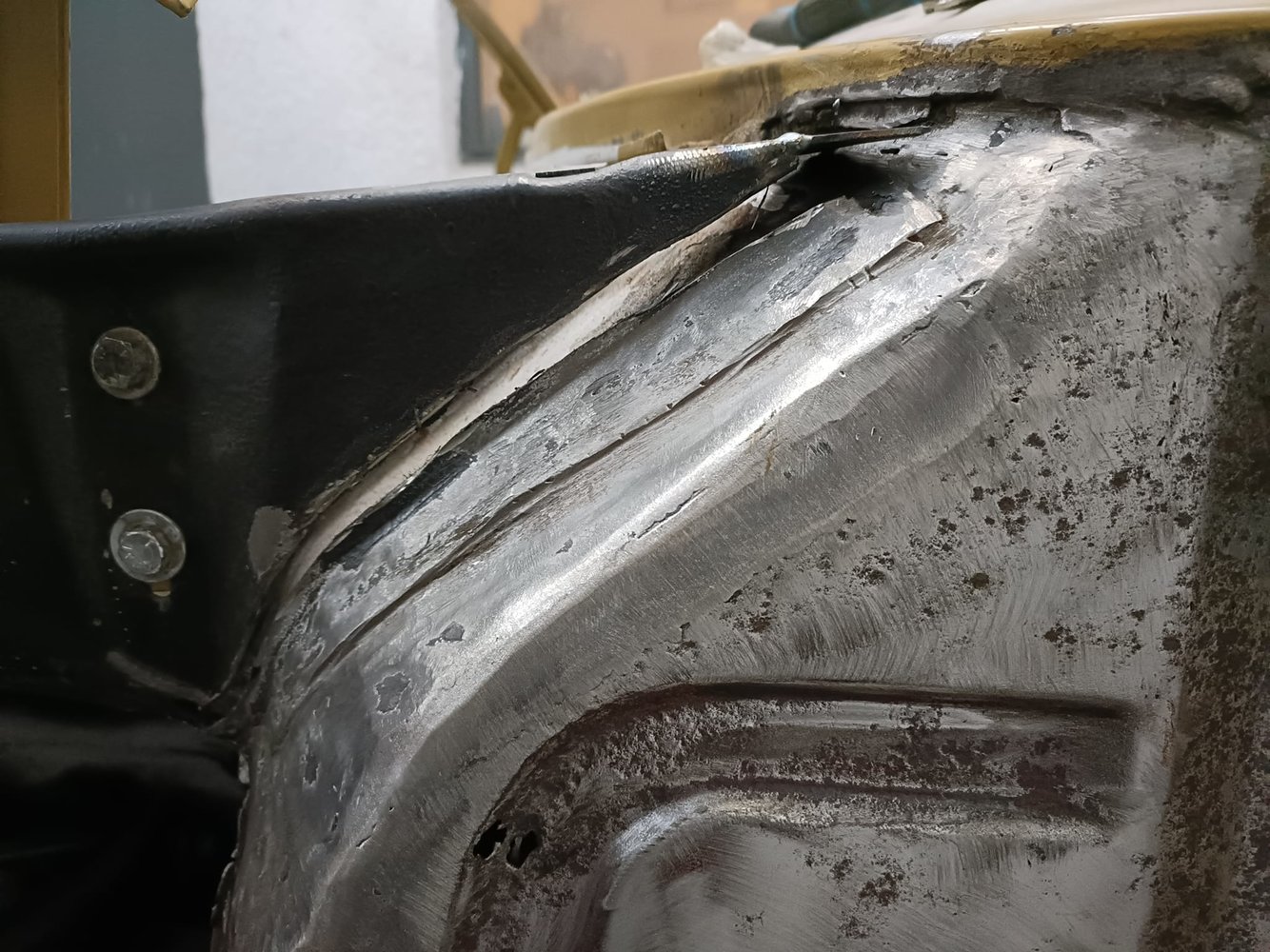

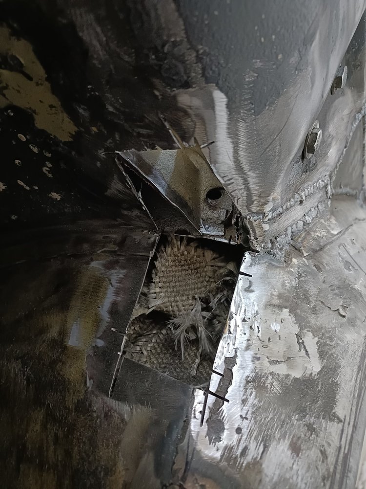

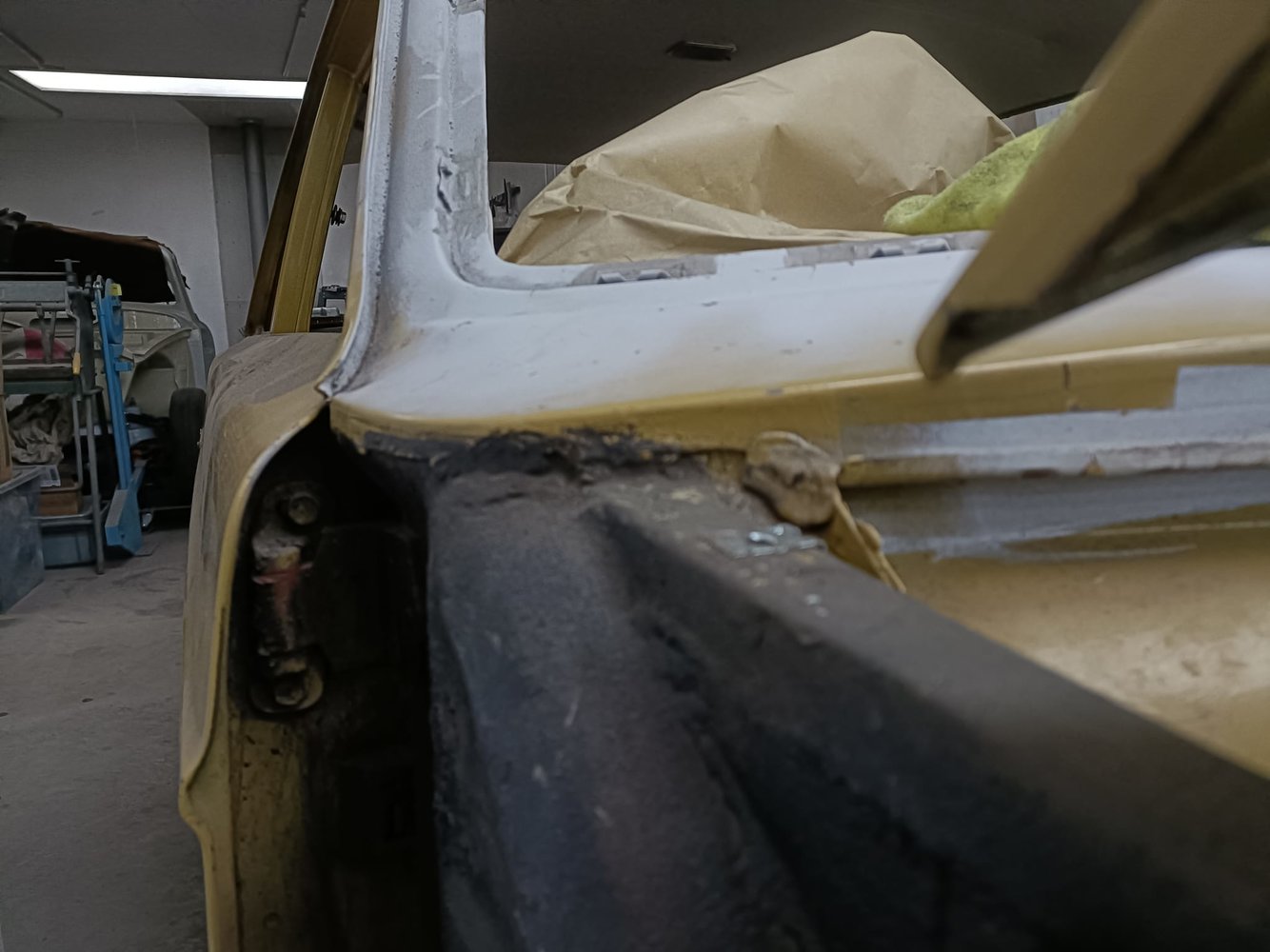

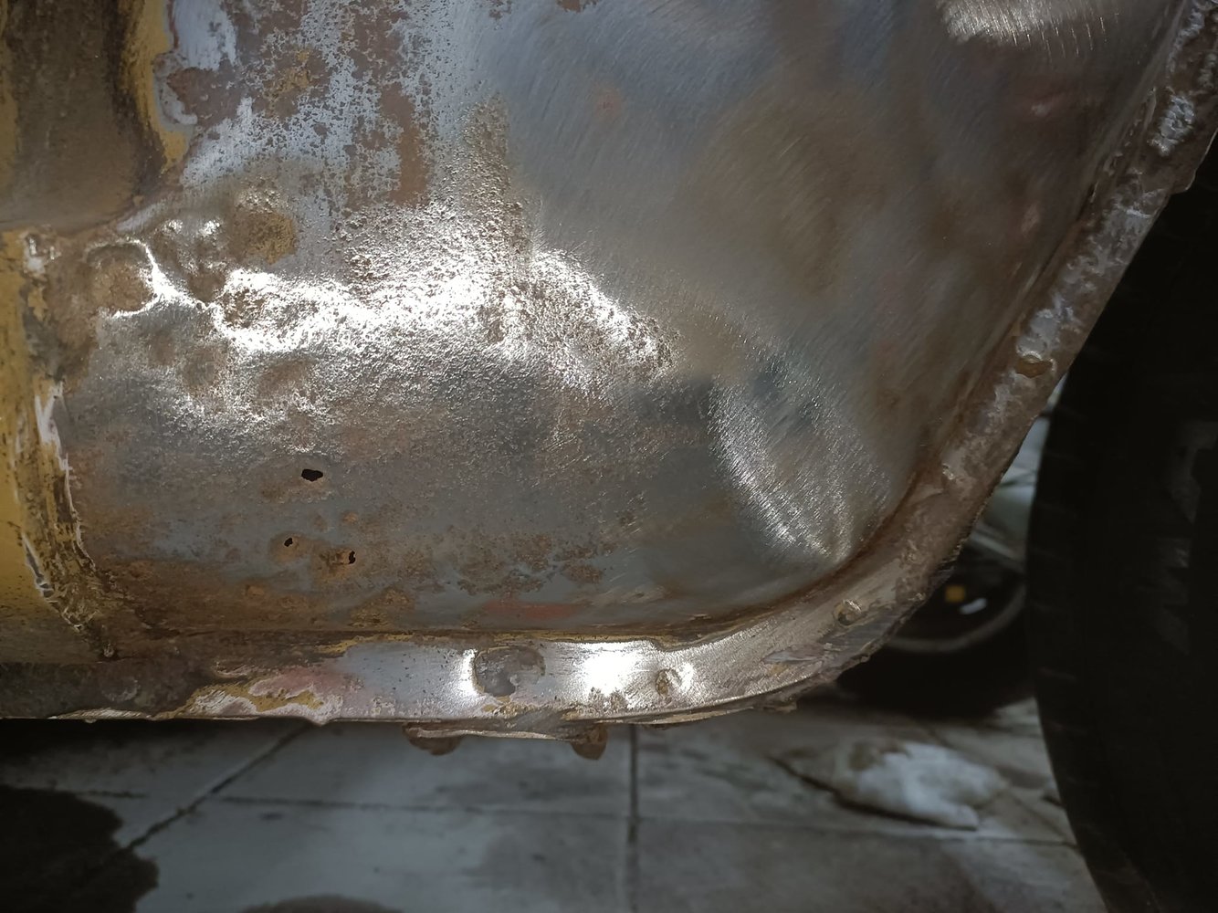

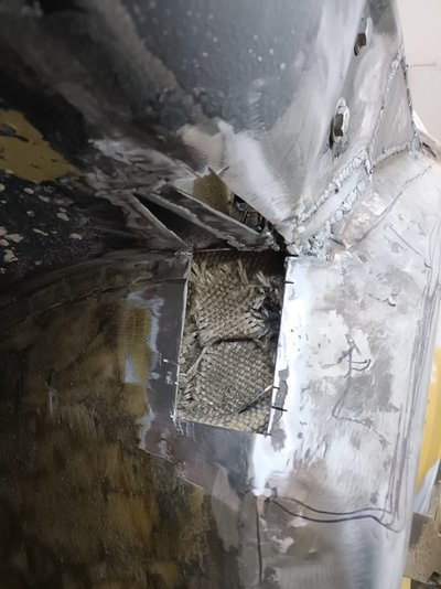

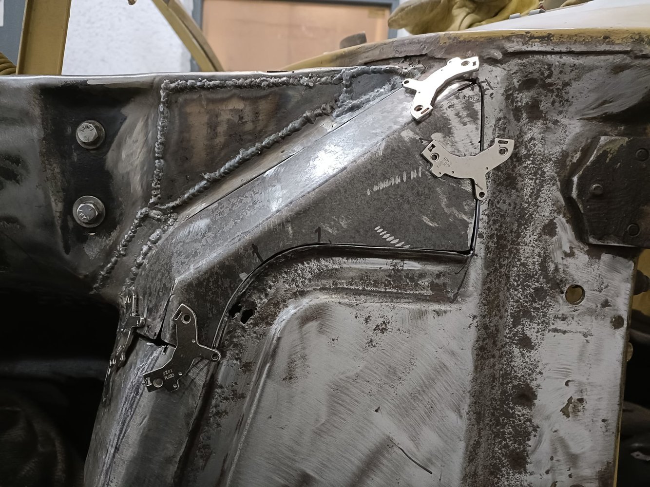

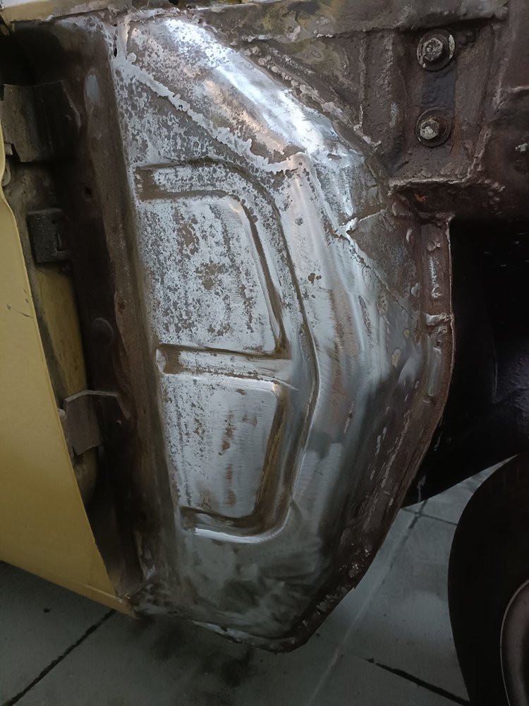

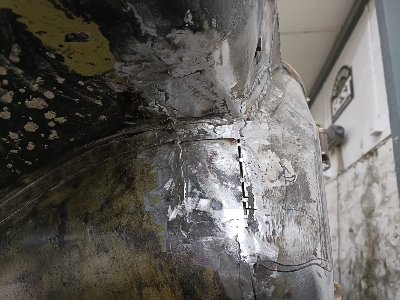

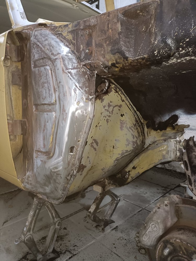

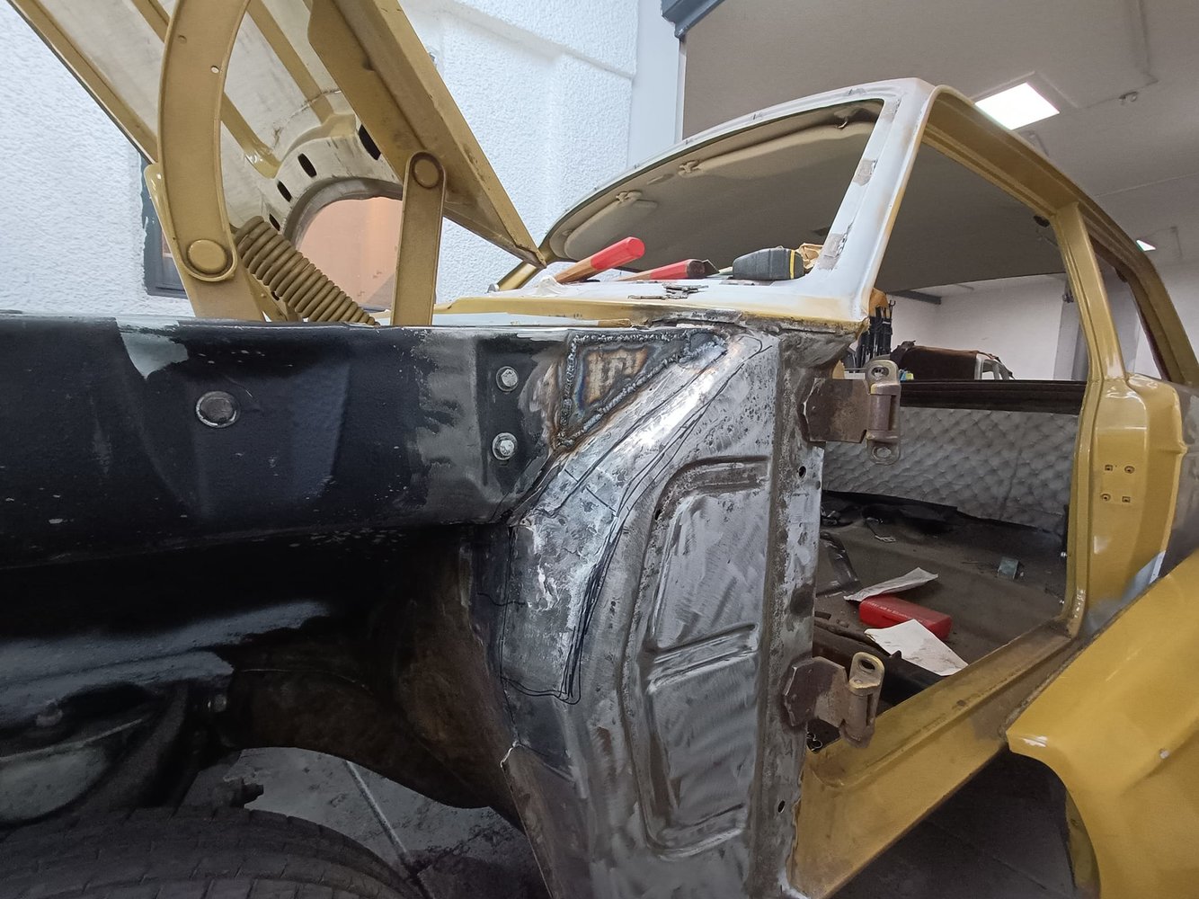

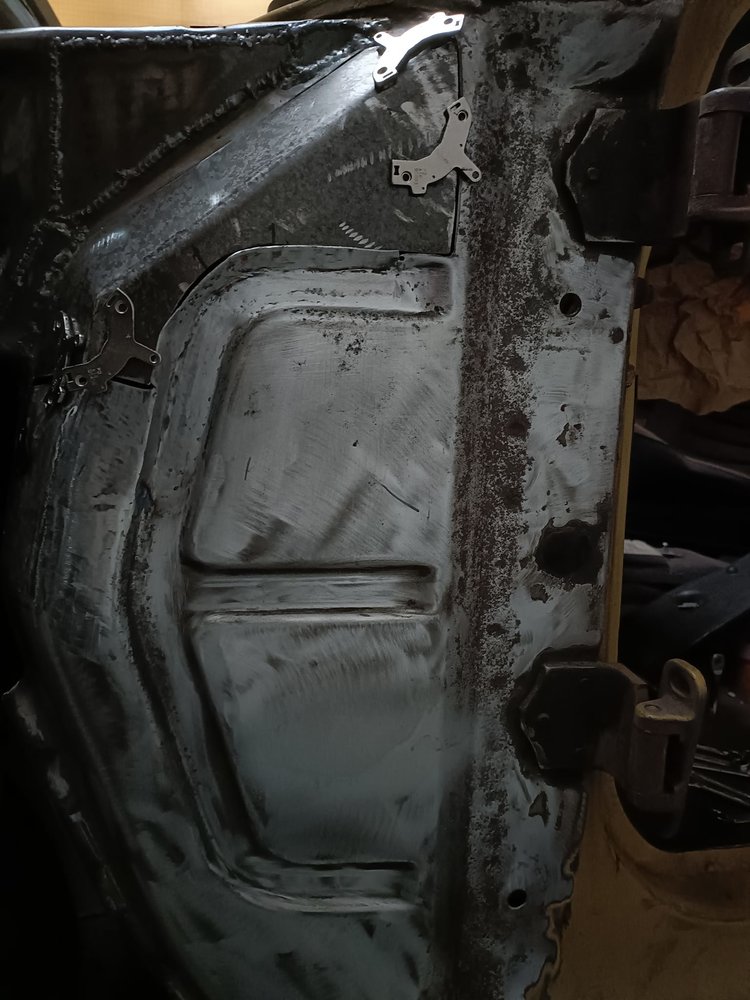

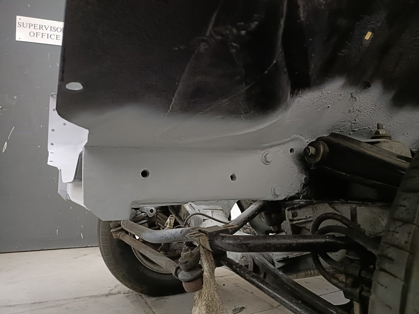

I didn't weld the inner wing repairs, I paid a guy to do them so I could crack on with my other project. Not sure how he got it wrong, the wing bolts onto the A pilar and the front panel as well so pretty easy to check its in the correct place. Anyhow I'm going to redo both sides and remove the underseal etc to make sure no other surprises.You must have been tired when you welded that. Still you have not gone too far along the refit before you noticed. I am sure you will make it look like new when you reweld it.
Yeah, I have the inner wing repairs but nothing else is available so I’ll need to make repairs. No really what I was hoping but just need to get on with it I suppose.That's disappointing, after all the work you've put in.
On the upside, you know it will be done right this time.Yeah, I have the inner wing repairs but nothing else is available so I’ll need to make repairs. No really what I was hoping but just need to get on with it I suppose.
Yeah no point stressing about it, it just needs fixing and will then be all good. I'm actually glad I went and checked it and didn't leave it or try a bodge.On the upside, you know it will be done right this time.

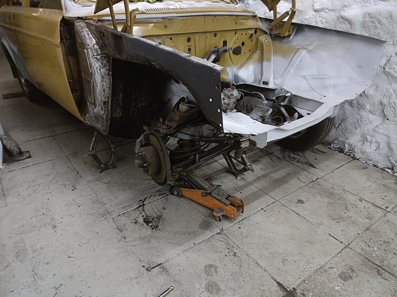

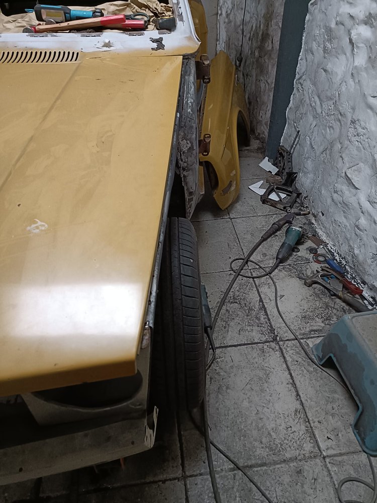

I have a couple of NOS wings to fit. The old ones are repairable but the new ones weren't expensive. I'll use the old wings as guides to make sure the new inner wings are welded in the correct location. There's a couple of datums I can use where they bolt to the A pillar and front panel.You mentioned the inner wing being the problem but from your pictures it looks like you decided to check the outer too and you dont like that as well! Still looking at your welding on the other panels these two will be done properly and so you will have peace of mind having done a proper job.
They're great, have a box of them.Those hard drive magnets are earning their keep![]()
