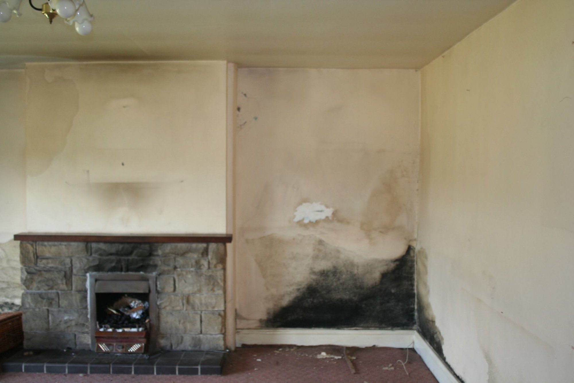

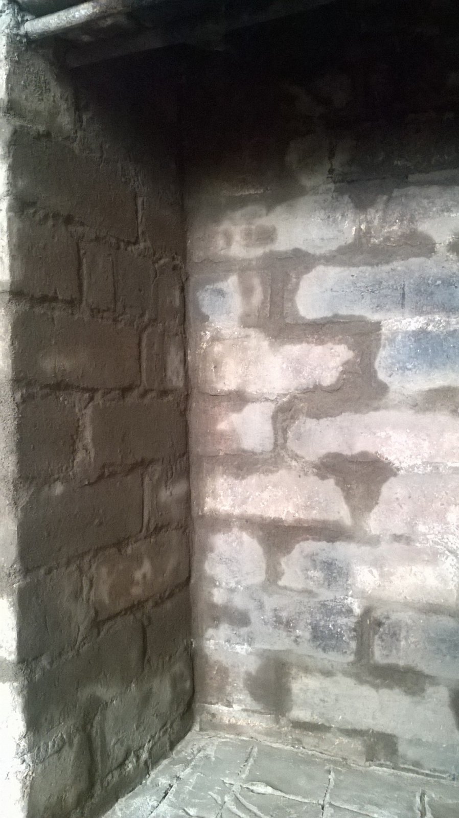

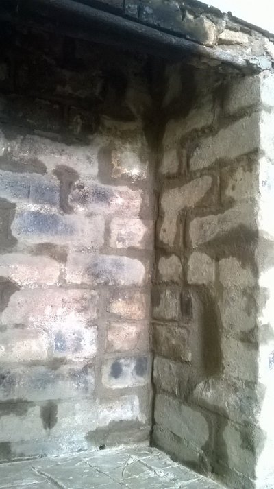

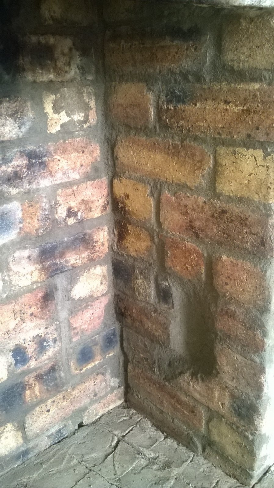

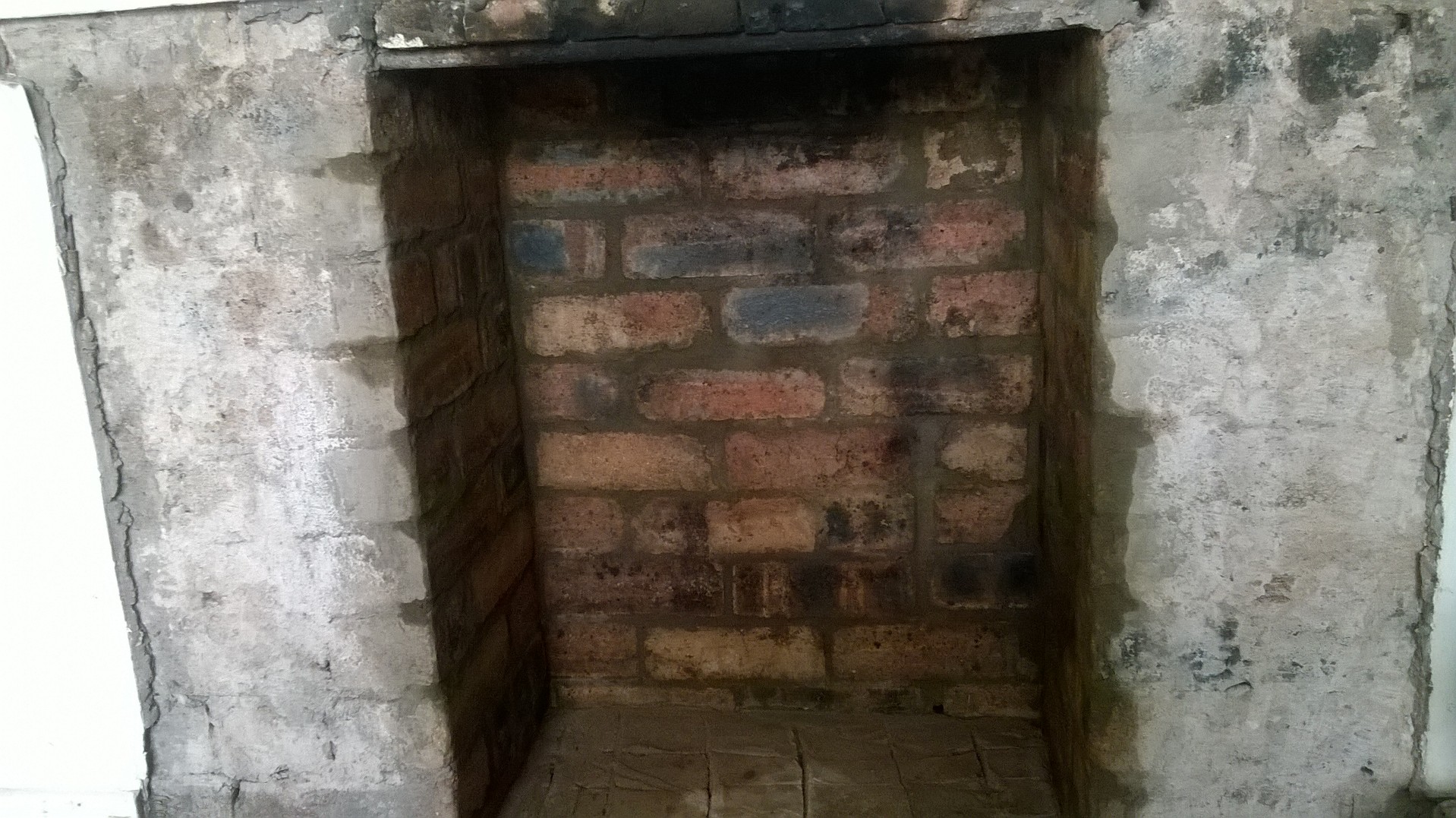

Well I've got the dross cleaned off, hole cavern from the removed back boiler filled up. Decided a quick repoint wouldn't take long and here's where it's at:
I'll clean off the bricks later with a wire brush when dry. Once it's totally dry we'll see what we have. For me that's a decent enough job. I'm sure you pros are aghast with disgust though :P

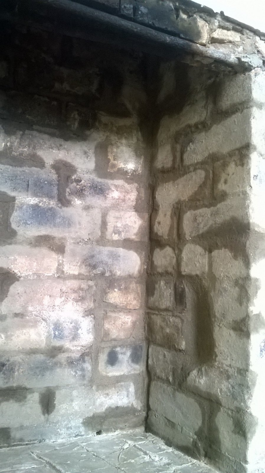

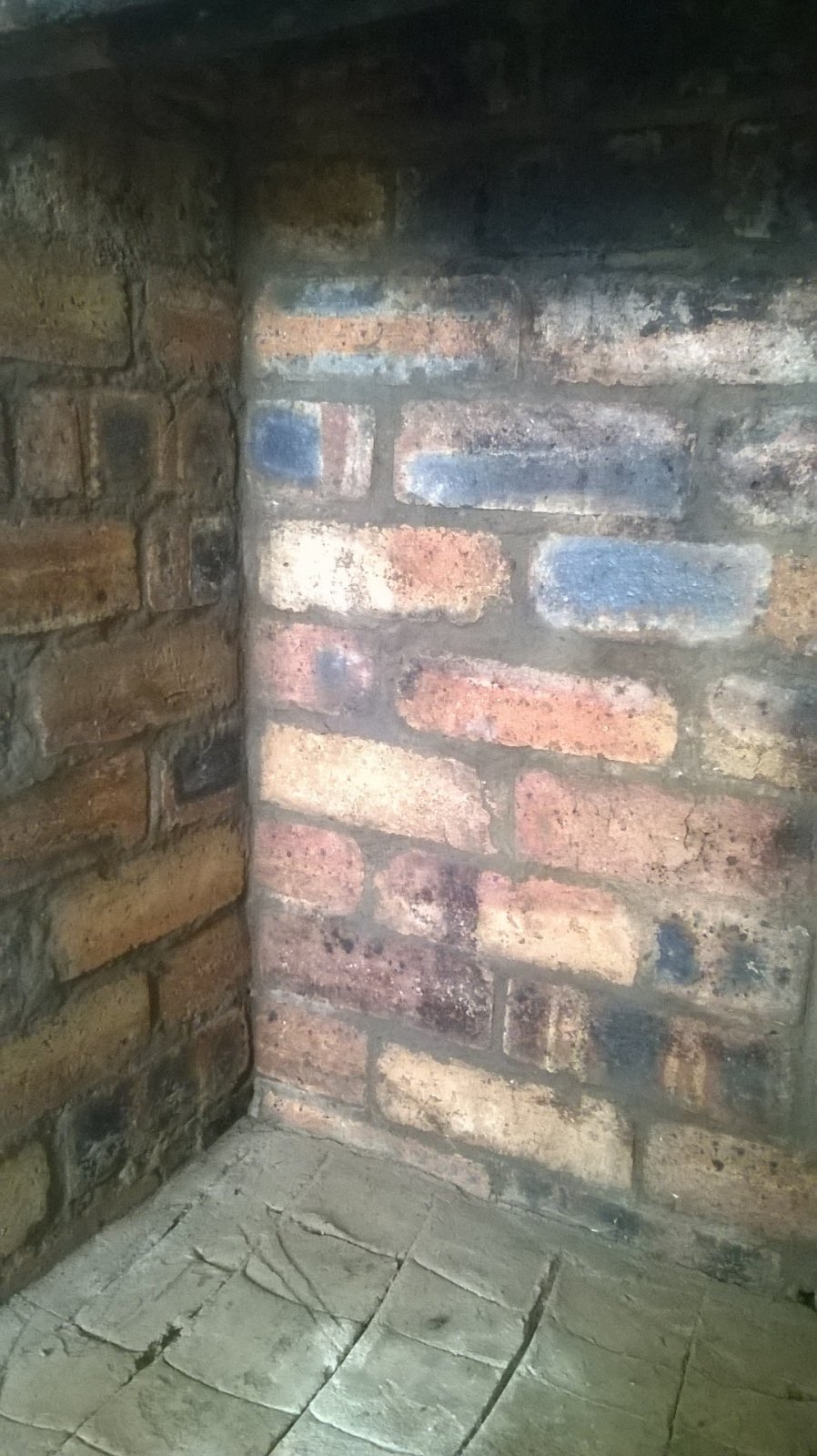

Well I looked at the repair I did and wasn't disgustipated by it like I normally am with my brickwork. I thought I'd point it for the practise but actually now I've washed the brickwork after the pointing I (and more importantly, she) am happy with it:
Still have to make a flue adaptor plate and lobsterback some 4" pipe but for me this stuff was the difficult bit so I'm pretty chuffed. Thank you all for the advice and I've filed the lime information away Julian and will be using it in the future
Thanks mate, I'm very happy with it as bricks and mortar are not my strong skill.
Final result will only be known when it's fully dry and the mortar's gone off so it could all look utterly crap yet!

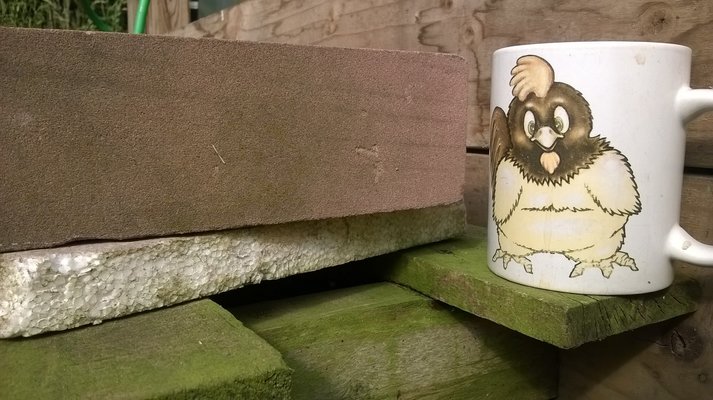

Wee stove is (I hope) getting painted in cream and green. Hearthstone will be 800 x 450 x 70 pieces of our finest dressed local red sandstone. Very nice indeed and I hope I don't screw that bit up either!
Providing it dries okay and the sealer isn't a pain I'll be done with it. Stove will take up the majority of it and the sandstone looks nice so will draw your eye away
If your stone is straight from the quary it may be damp inside, there is a chance it make crack if you heat it up too quickly. In an old house o lined the fire place with sandstone, about an inch thick, looked grat, loved it, sealed all the stone for the look.
Come winter put fire on, cooked the house, stone cracked, was the main back piece done in one piece...

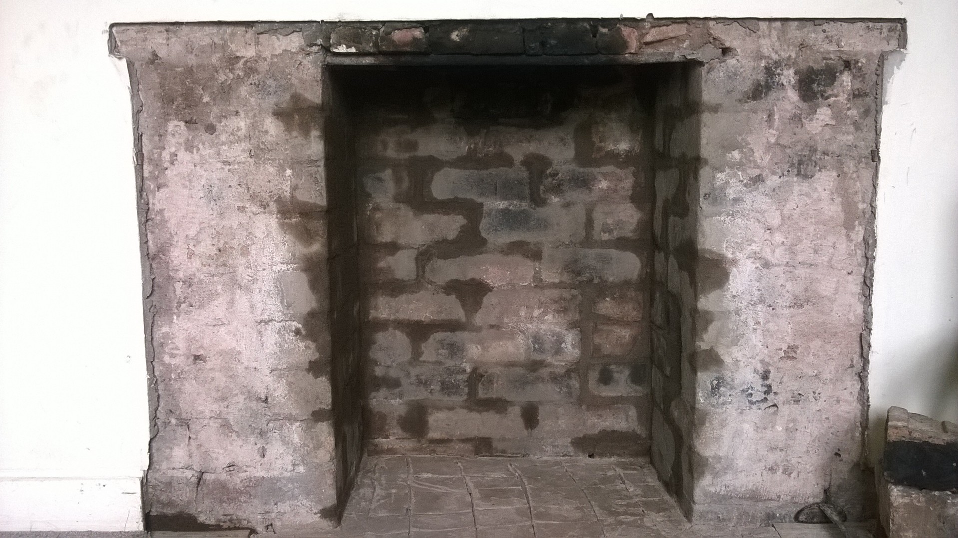

In this place we went from the ugly cow boy 70s, to the replaced rustic.

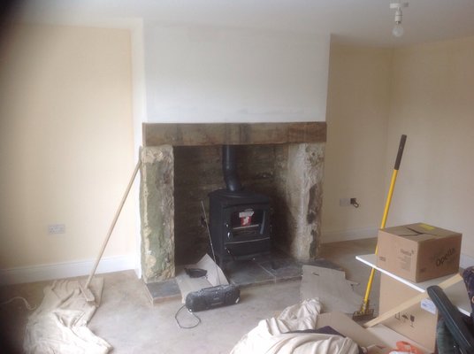

I had to do the same thing. The previous occupant had fitted a stove, but not very well at all. Put up with it for a long time, but it reached the end of its life, started cracking, became derelict, so i had to replace it. I got a stove from a friend for £50 and started from there. Pulled the old stove out, knocked the bricks out that were behind the old stove, repaired the damage they had caused by removing bricks from under the lintel (dont ask me why they did this) I rendered inside the aperture and where the render had came off from where the surround was removed and then plastered, cast a new hearth and tiled. I made a register plate from 1/8th inch sheet and lined the flue with 6" liner.

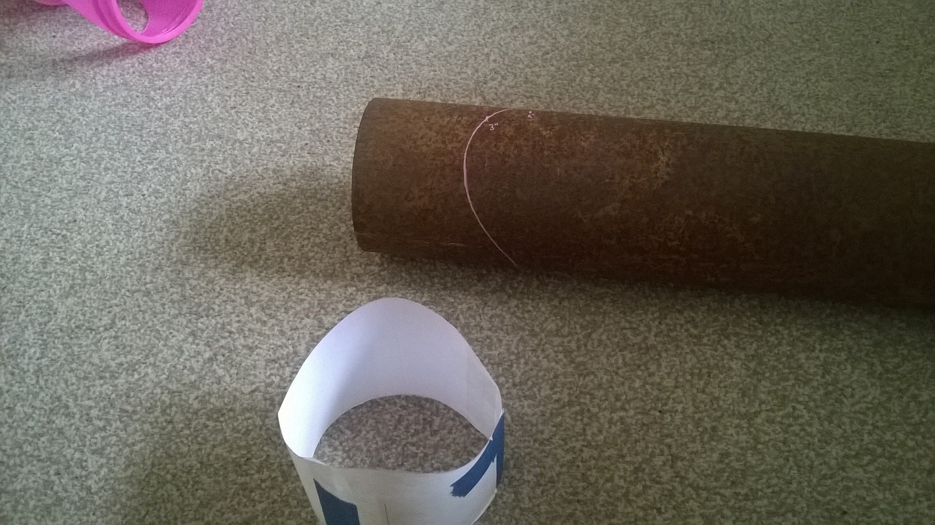

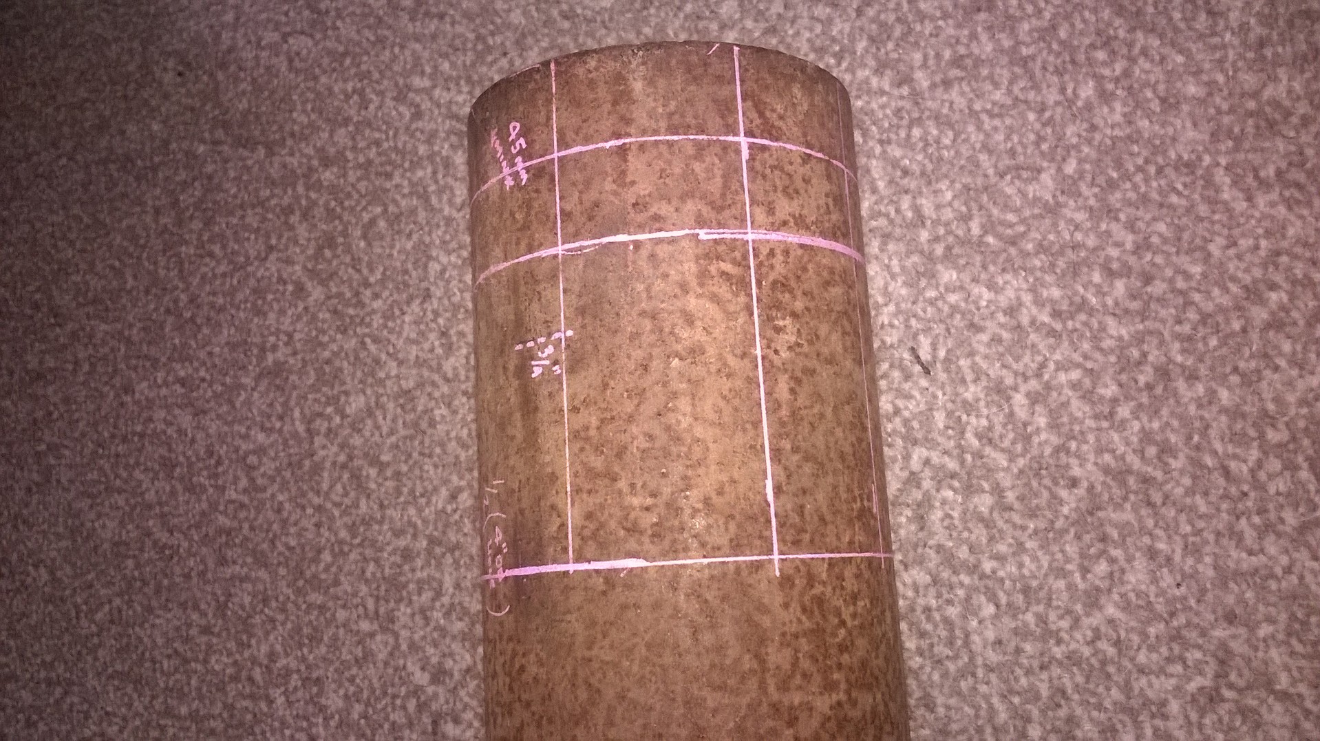

Flue pipe going together now. Gone for a saddle rather than a lobsterbacked bend as it was just plain easier to cut on the plasma and I could get a nice close fit.
All marked up ready to cut using my jig I designed myself

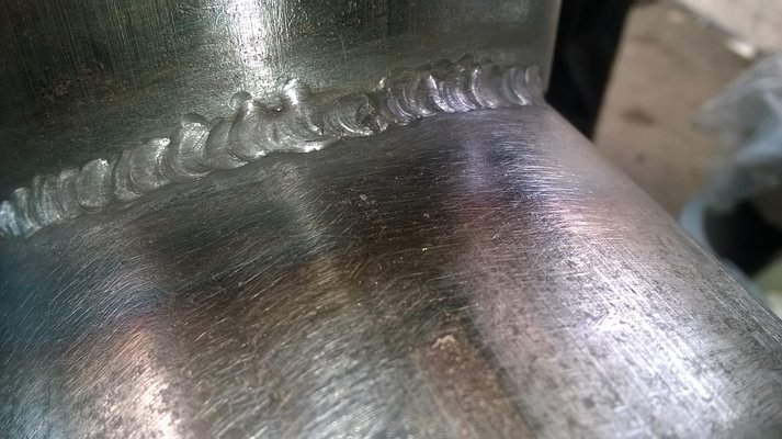

Next up I swapped to the posher mask and I think the results speak for themselves.
Okay I'm no uber pipe meister but I'm happy enough given all I did was change masks.
To be honest it's not a fair test as the Parweld is obviously faulty and needing a new outer. I'll pick one up when the pennies allow such a frippery and re-do this test
For technique (ha!) I just freehanded it with a 0.5mm stickout at 75A.
