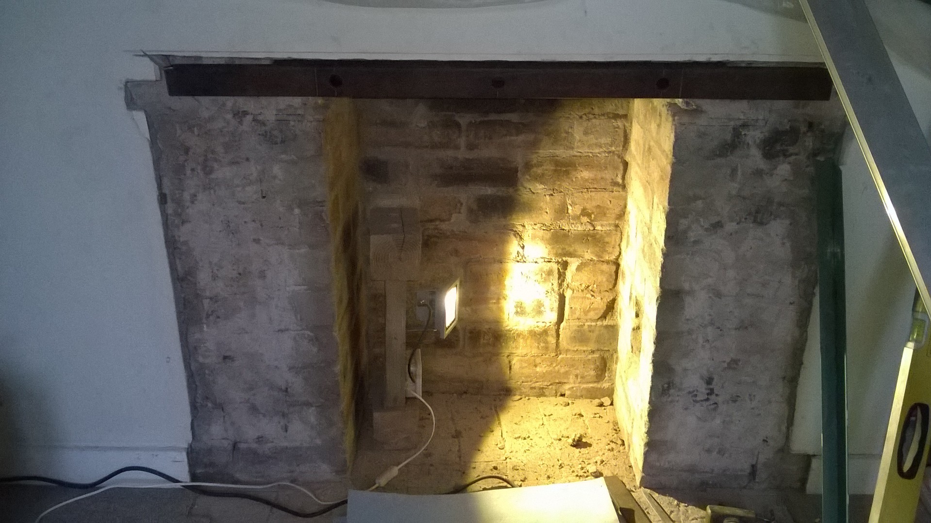

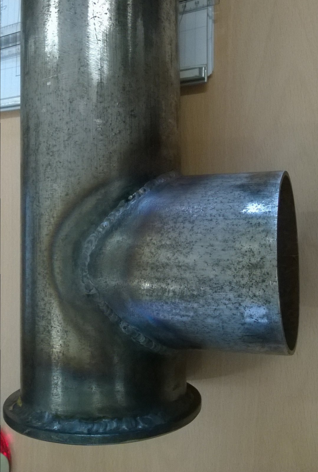

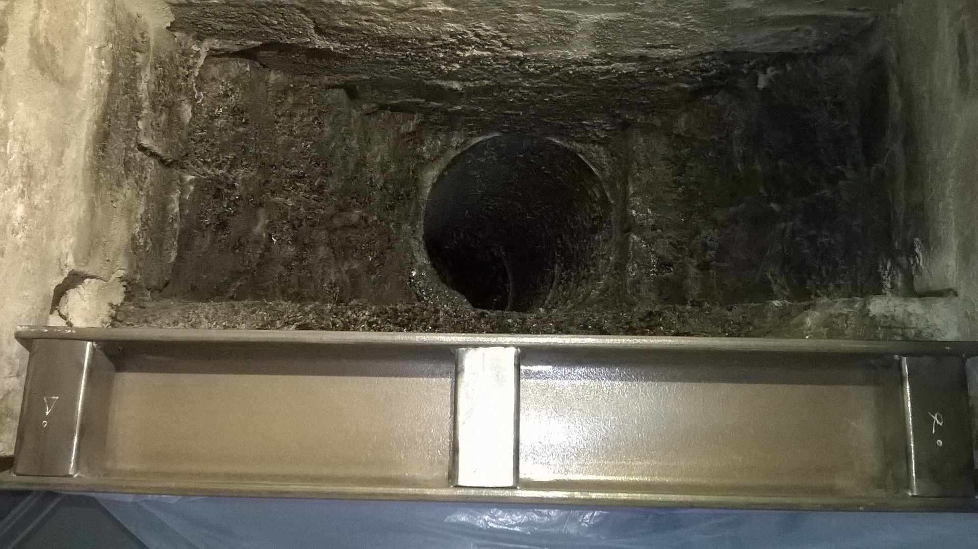

Nice job .... the brickwork cleaned up lovely ...that saddle flue pipe thing looks good . nice thick steel ..is it a bend or a T ? and can you get in with chimney brushes ?...jeff
Yeah 3mm wall so exactly the same as what I'd get from Crosslings but freeNice job .... the brickwork cleaned up lovely ...that saddle flue pipe thing looks good . nice thick steel ..is it a bend or a T ? and can you get in with chimney brushes ?...jeff

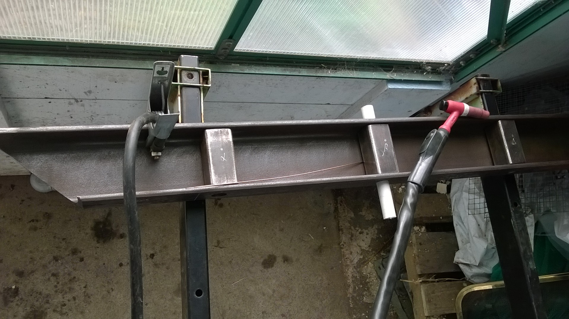

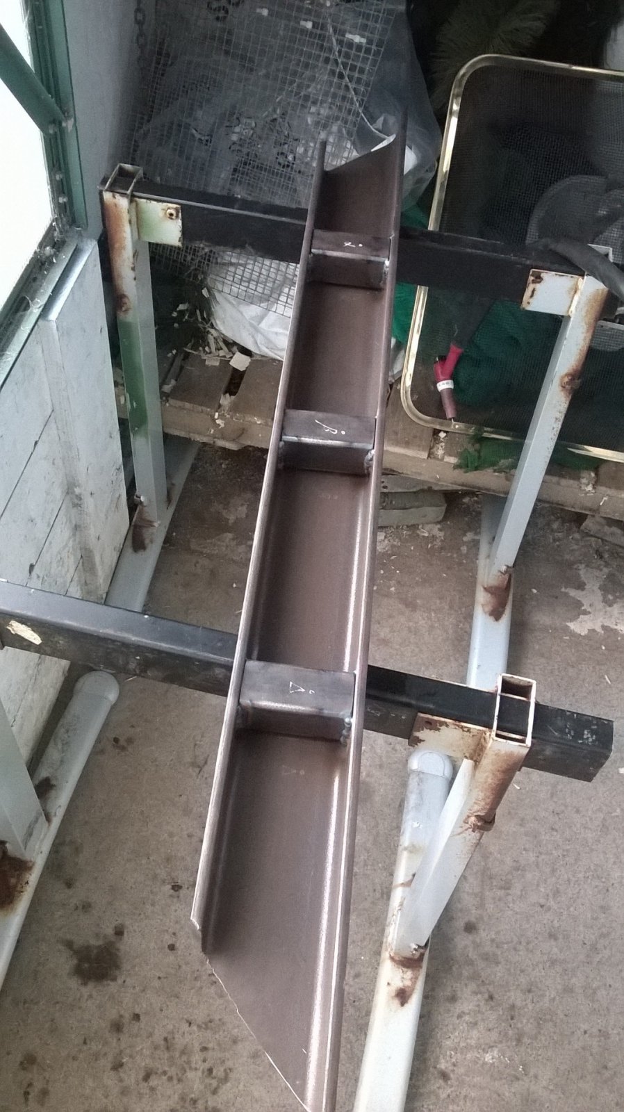

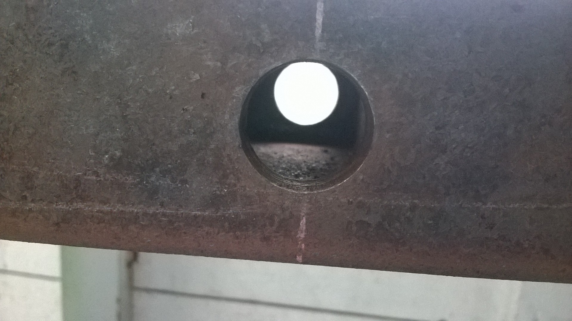

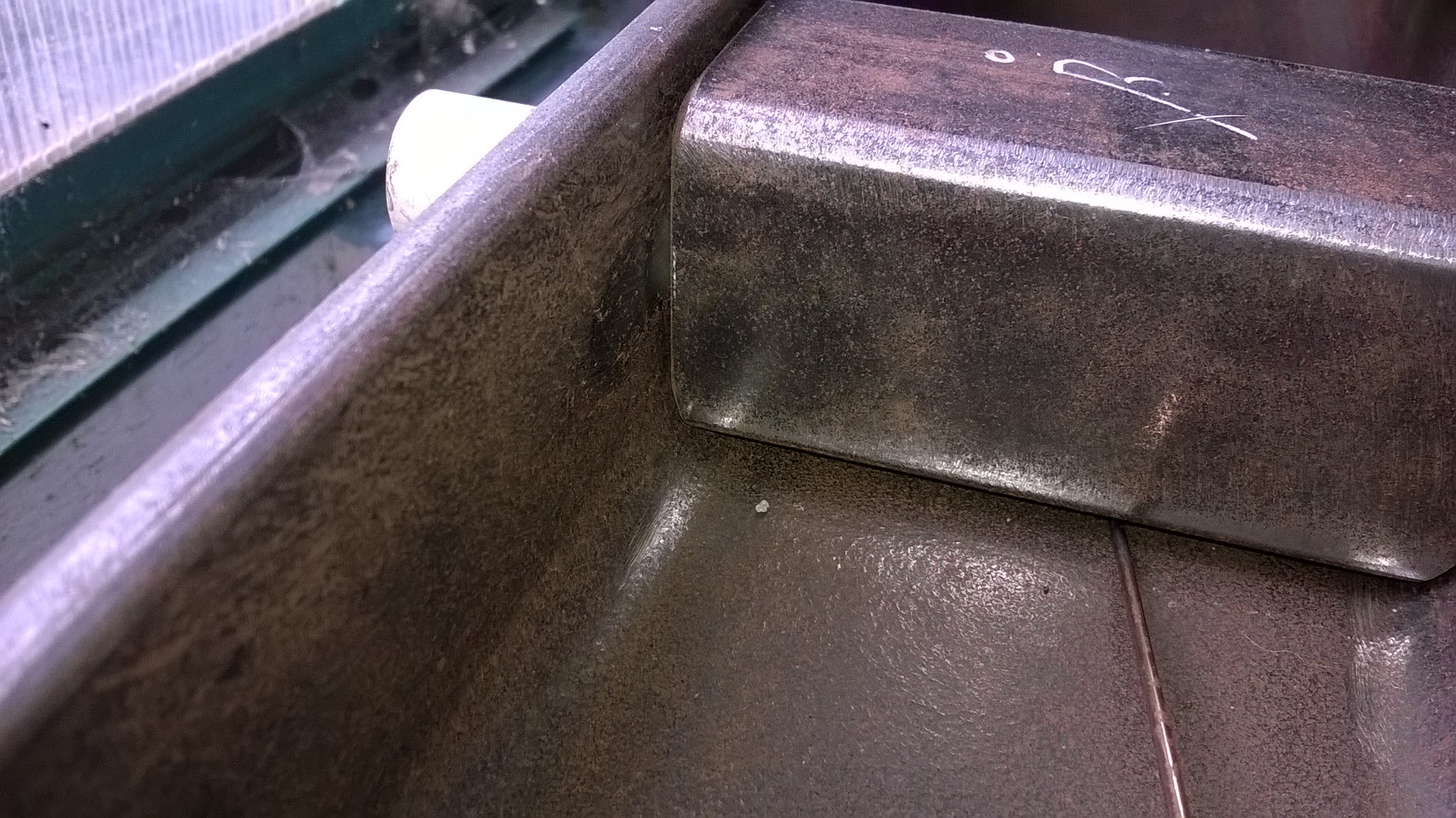

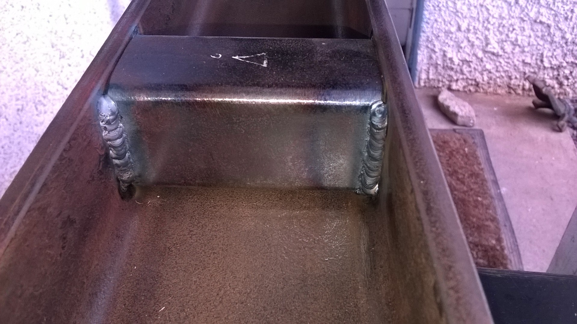

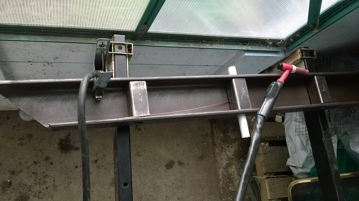

, I have a lovely UC that I'm going to bolt the mantle on to. 100 x 50 with 8mm thick flanges and 5mm webbing. I've cut six 20mm holes in the flanges and braced them with some 30 x 30 x 3 box.
