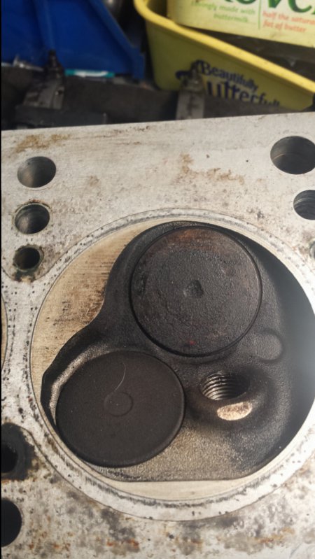

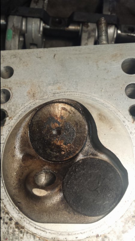

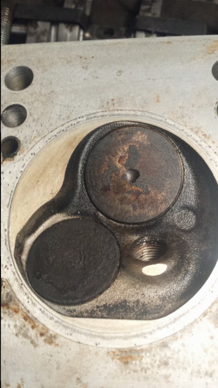

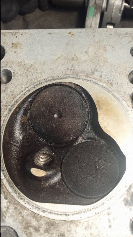

looks like your making progress in finding the running problemRight, another interesting evening! As suggested I dismantled my compression tester to create an easy method of putting pressure in the cylinder and I wound the pressure down to about 50psi. I started with #2 as that had the lowest compression. On TDC (compression), exhaust valve clearance was 0.3mm and when applying pressure there was a leak through the exhaust port (I've taken the exhaust manifold off). #1 was 0.45 and on applying pressure it moved the piston down, #4 was 0.2 (but no leakage and #3 was 0.5 and no leakage.
My regular engine re-conditioner in Westbury appears to have gone off line (telephone gives unobtainable), however a place in Bath with cut the seat, grind the valve and skim the head for £56. So I think That's the next step.
I'll let you know what happens next!
