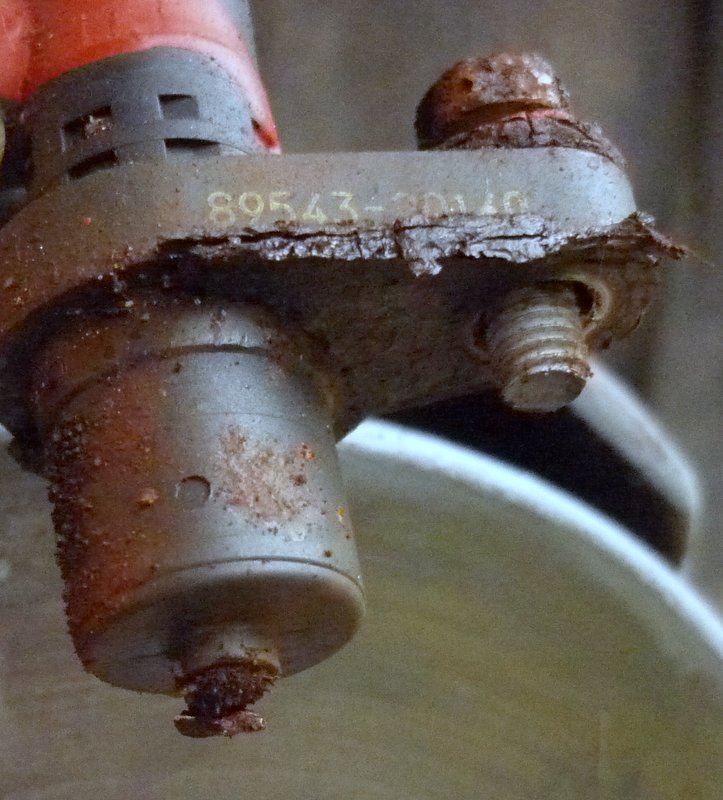

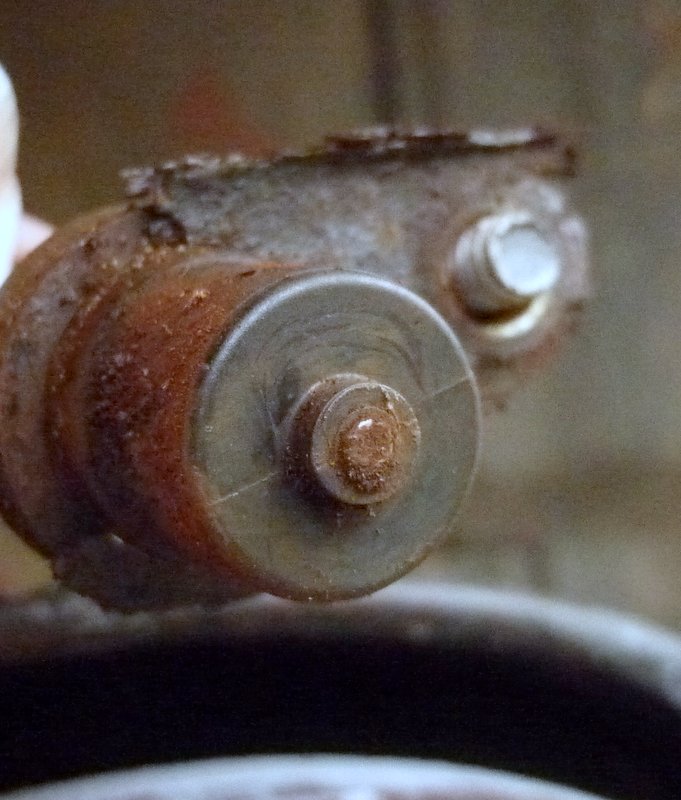

In Scandinavia the cars are well treated with rustproofing products.Yes, I suspect you are right. This is the first time I've ever seen this effect and the first person I discussed it with was 100% sure it was was a broken ABS ring, but I think it is more likely to be "crud". What I've just found out in the last hour is that the ABS sensor head is all-plastic; the 10mm screw "tightens" down on a plastic flange and I very much suspect that the body that inserts in to the hub is also plastic. This would go along way to explaining the Youtube vid!

Why’s that? The sensor itself is likely plastic so won’t heat directly. Or is it the transfer of heat you’d be worried about?Not very appropriate for around a sensor? Might be OK for heating the set screw when just minus its head.

Most sensors are held by a fixing to the side, if using a smaller induction coil you can get the heat really localised. Mine is used mostly for motorcycle repairs where naked flame is far too damaging to surrounding parts.Not very appropriate for around a sensor? Might be OK for heating the set screw when just minus its head.
Yes, the distance is important and the dimension should be listed in the workshop manual. Thin shims are used to adjust the distance.Now, is it the case that some kind of replacement gasket needs to be used to get the correct spacing between the sensor and the ring???
I've just looked in the official workshop manual and there is no mention of shims, but I am sure they needs to be some!Yes, the distance is important and the dimension should be listed in the workshop manual. Thin shims are used to adjust the distance.
