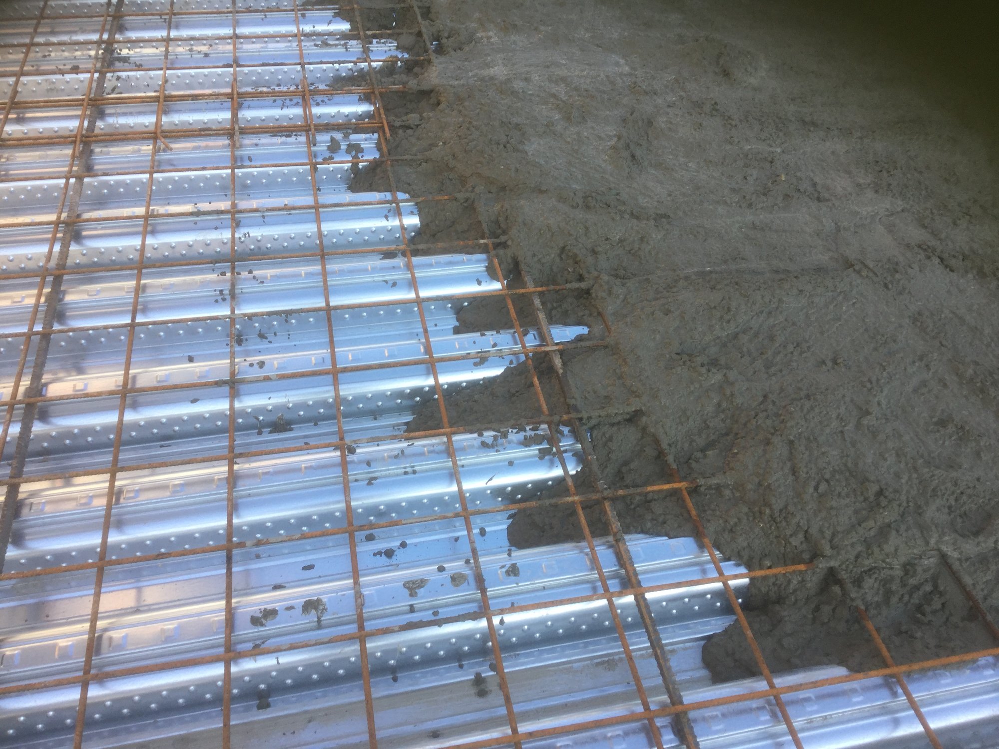

Plus, I have used the fibre glass strands in concrete, well mixed it, does work.....
but I'd just go with steel mesh.....just remember to have it of the base on little towers......
some walk it into wet conc but I dont like that idea....
