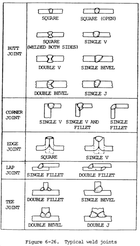

If that pipe was 5mm thick or more I would absolutely put a small prep on it. If I wanted to I could fill it flush with one run getting penetration right down and put the second run on top as you suggest only doing which will be a superior joint.
