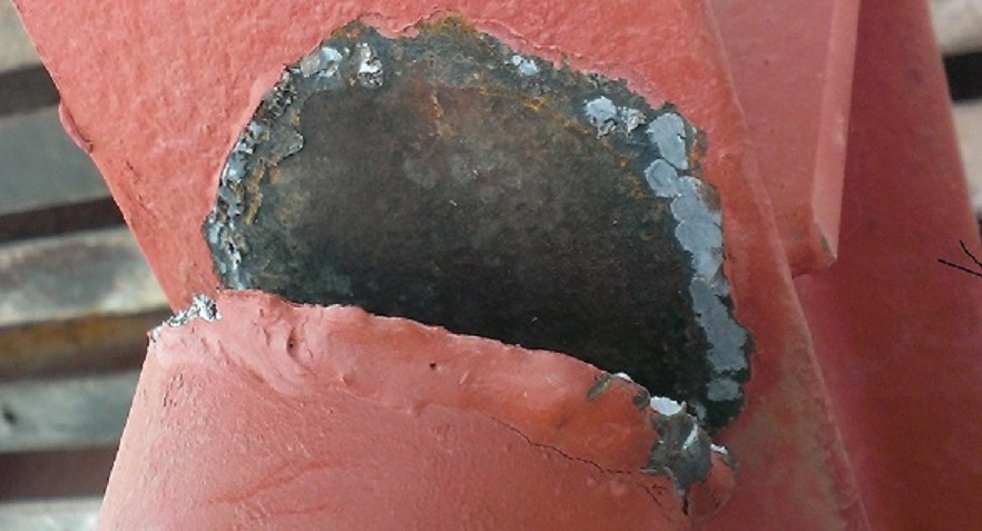

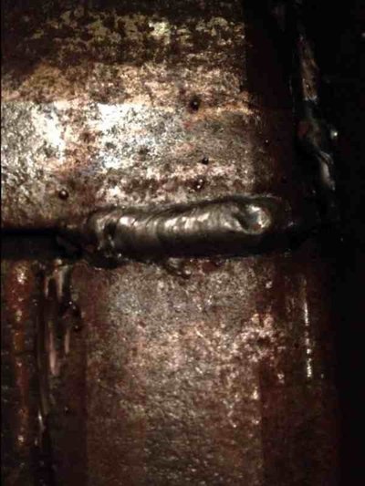

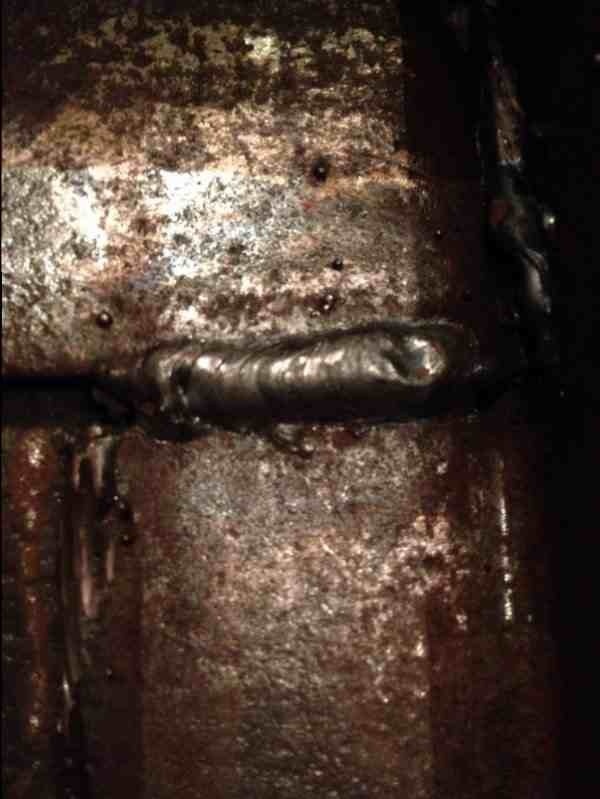

Assuming 6mm? or even 10mm plate thickness you would just blow big holes in the metal with that sort of raw power. Welds just become uncontrollable with two much power and you end up with a big slumped undercut bead.
Our sets are 400 amp, and one, I think, 500 amp. Rare we weld anywhere near the top end as even if you are welding an extreme of say 50mm plate, you can only lay a 10-12mm bead maximum before it starts to slump so you make the overall weld size up with a load of 10mm beads.
The benefit of the big machines is it will weld all day long without missing a beat.
I meant for his method of overlapping tacks, I wouldn't like to try a run at it
Well, I would, but at less amps and not messing about tacking...
Still, at least he's left plenty of areas and crevices for cracks and corrosion to start from, means it'll need doing again at some point, maybe he's planning ahead
