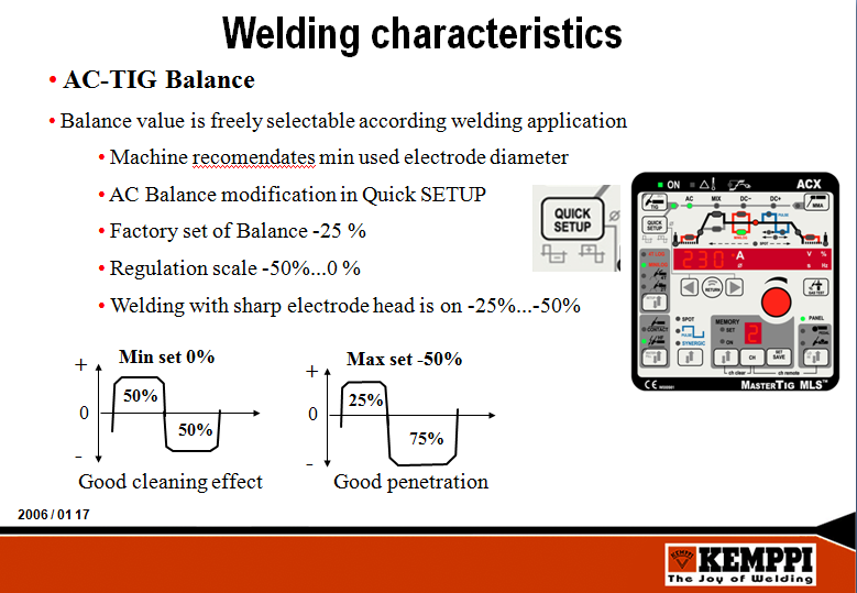

According to the units I have used the percentage value given is the percentage of time spent in DCEN (penitration) so if according to what your saying 30% is max DCEN on that machine then that tells me the other 70% is DCEP (cleaning). This is backwards in comparison to the units I have used. I don't suppose it matters really.But thats what the manual says........30% is max penetration. I need to fire mine up. lol
AH Ah I think I understand now. i will clarify it all tomorrow.View attachment 46475This is the balance setting on a typical ACDC machine . The 70 is 70% of the time spent in DC neg so you only see the figure DCEN the % remaining is DC pos. RTech case is the other way around from the sound of it. You would set the DCEP .

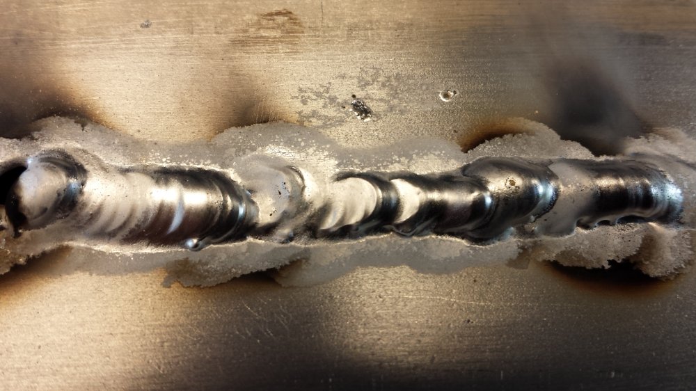

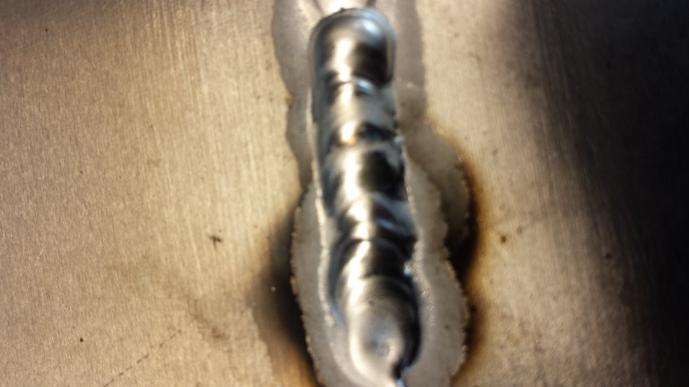

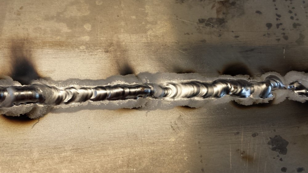

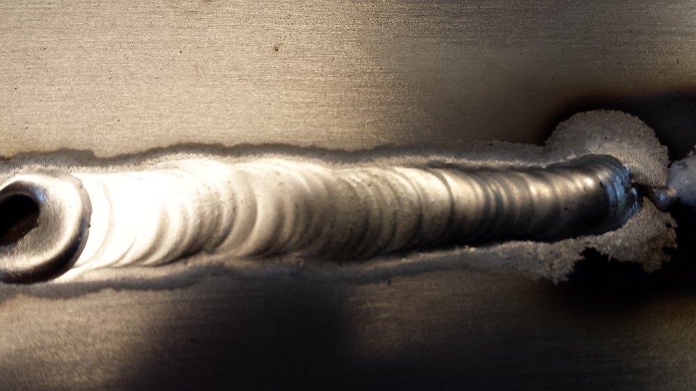

I scrounged some 1.5mm off-cuts from my local sheet metal place , and while it would be fair to say I should get better with time - today I did this......

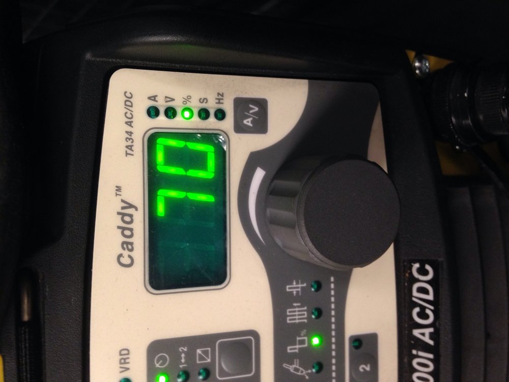

This was with a 2.4mm white tungsten , 2.4mm 4043 filler , a foot pedal , and these settings -
