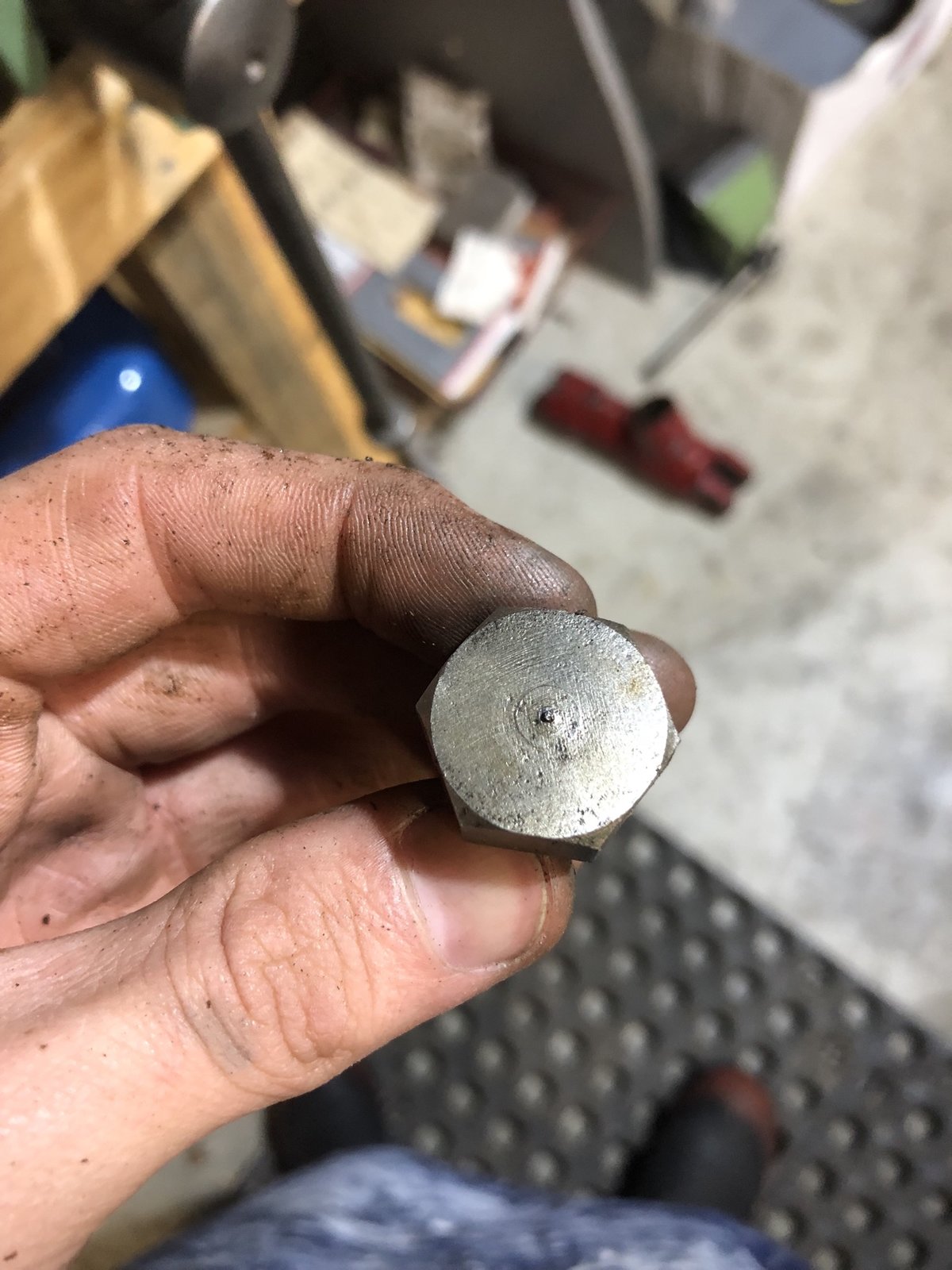

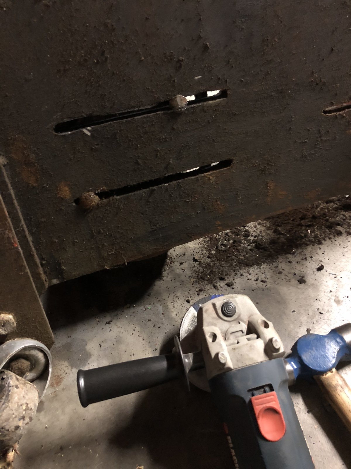

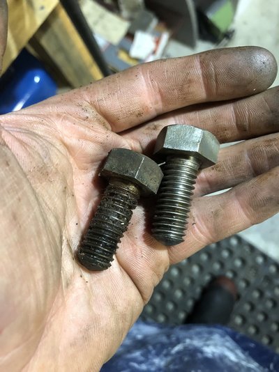

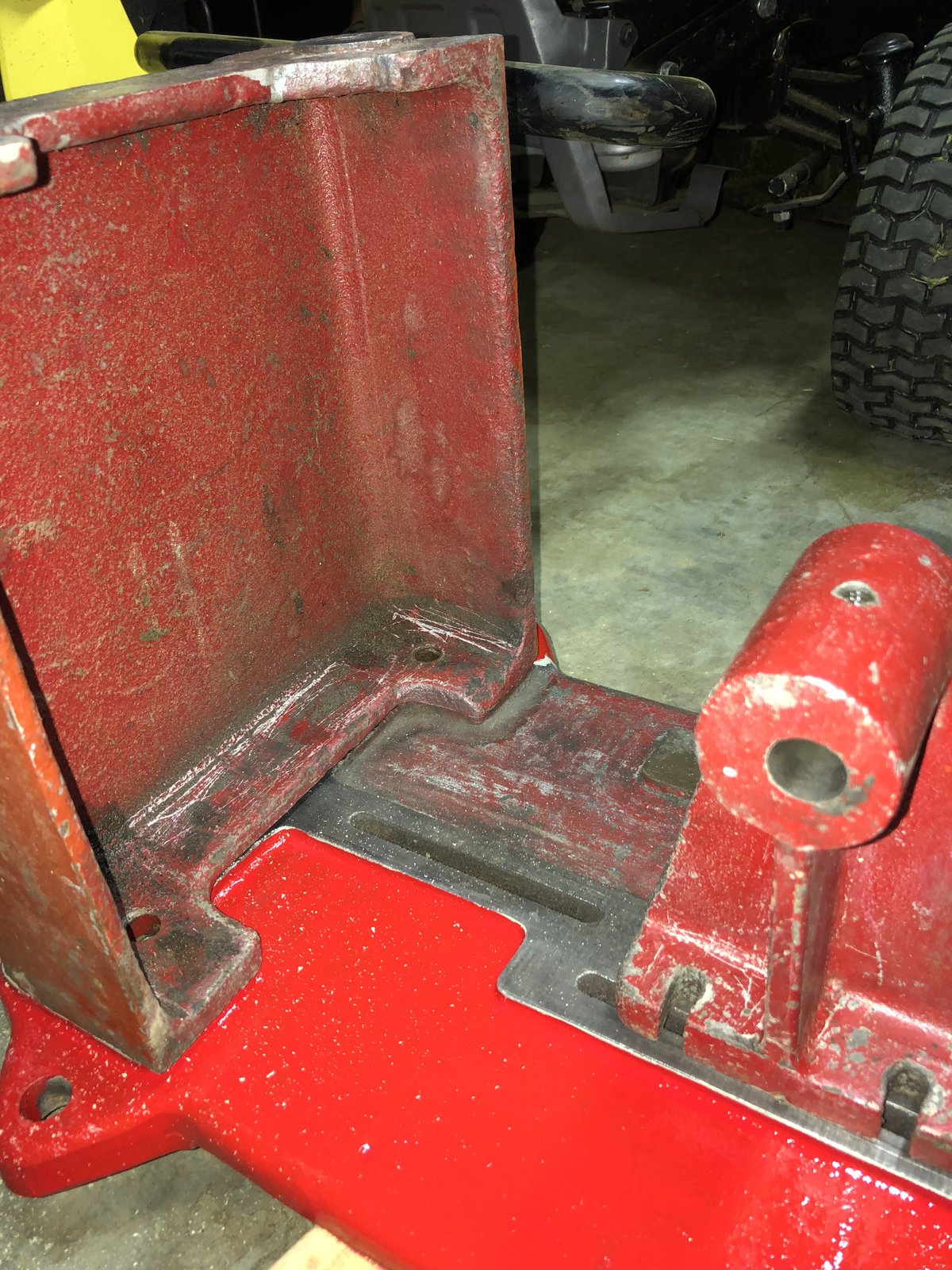

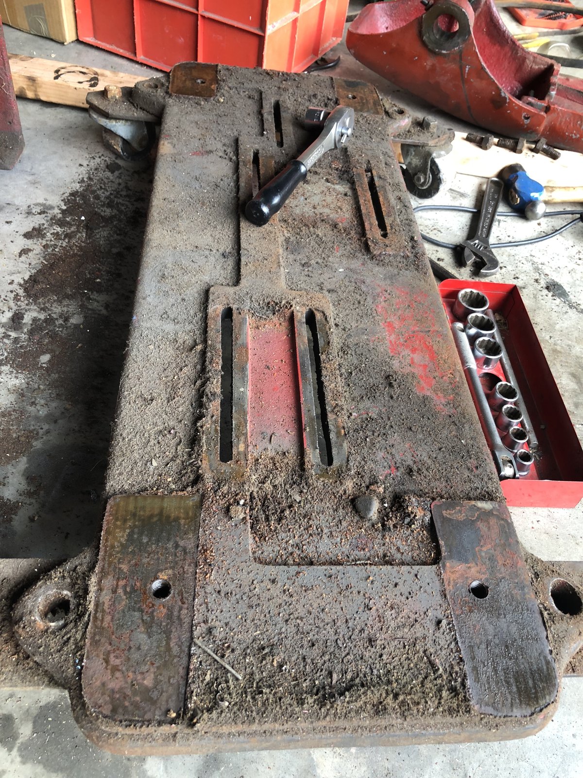

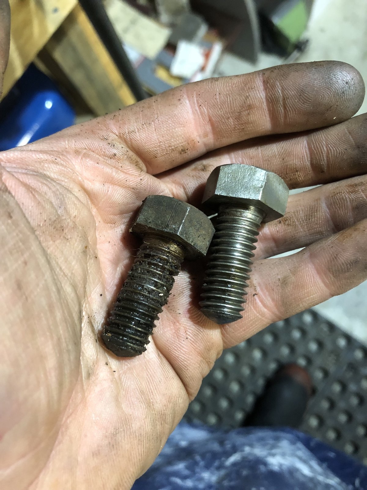

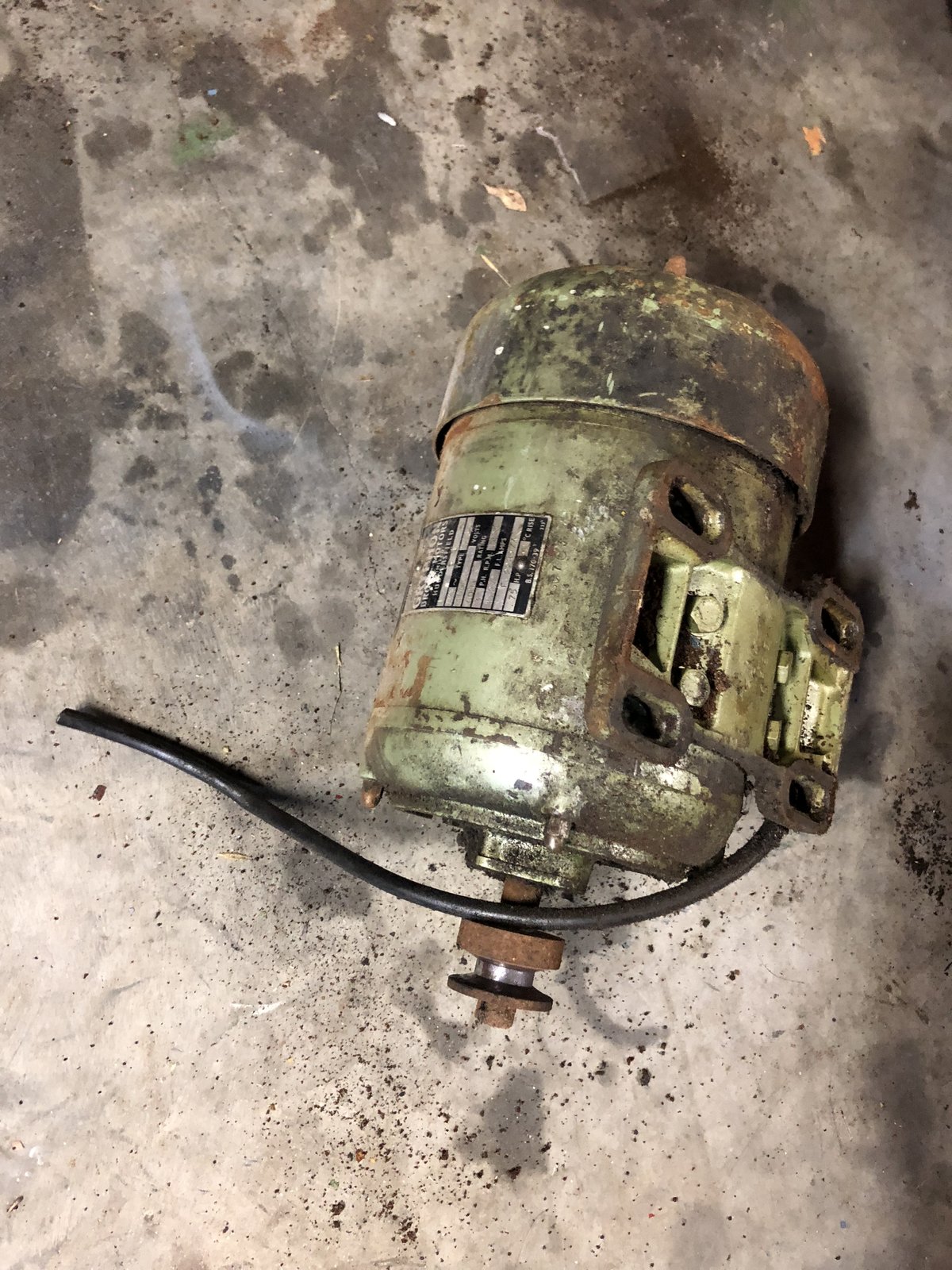

Getting the motor off was tricky as the bolts were rusted tight. Well, I could have left them overnight in penetrating oil and had a go today but... nah. Two grooves and a cold chisel to break the edges off the circles, and they slipped through along with the lump of motor which has either a bent shaft or a bent pulley, turns freely but definitely not true.

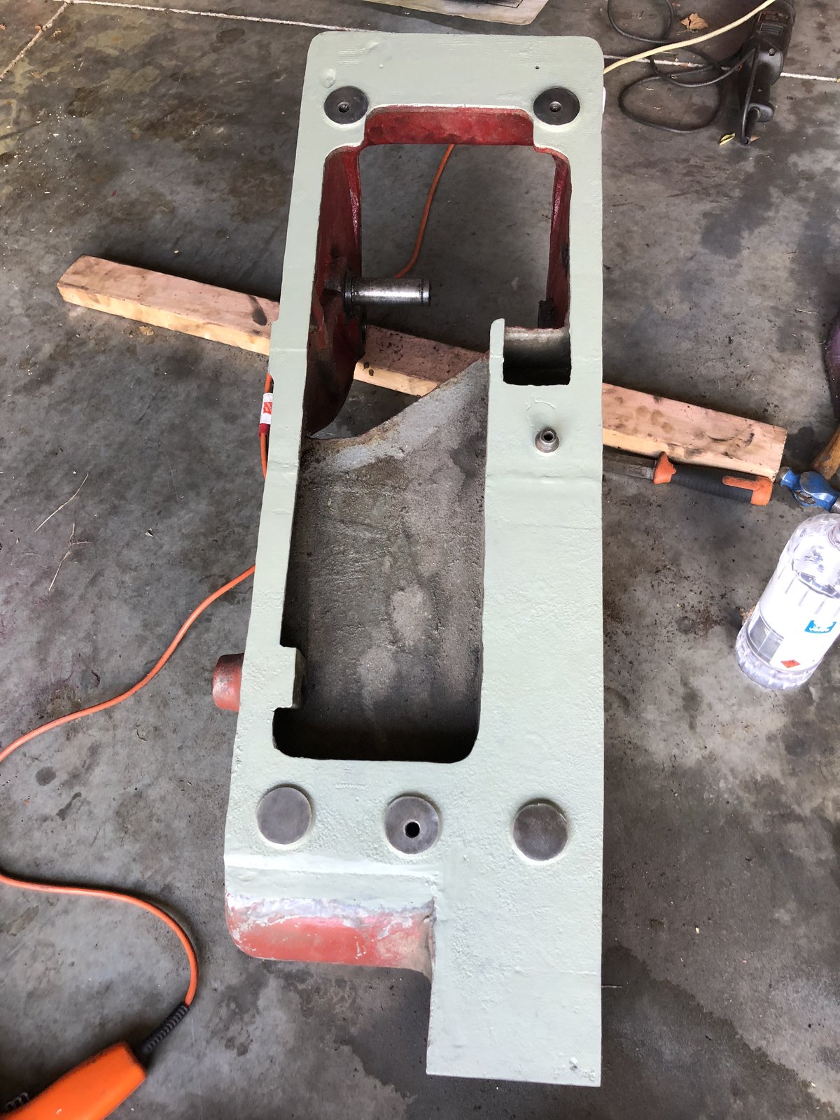

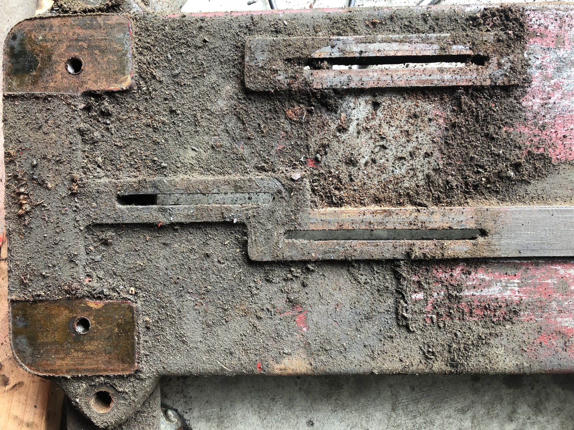

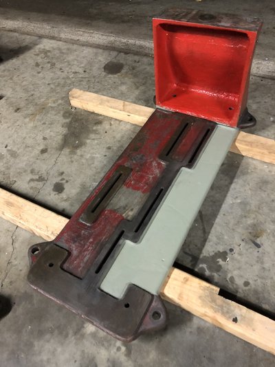

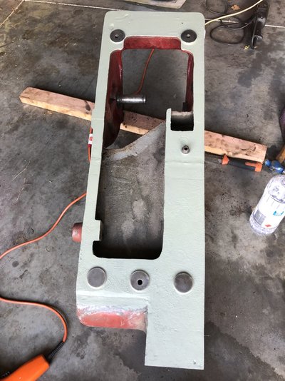

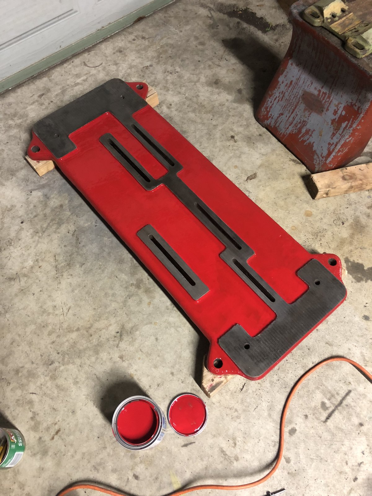

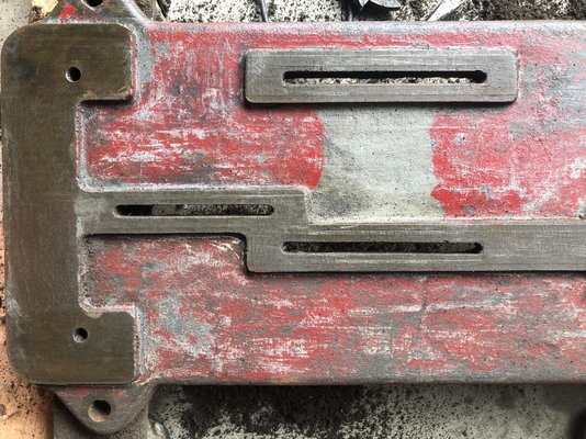

Jet blasting today, see what’s under the filth on this base... steel washers are buried all over this thing it’s mad, I find them everywhere just covered in filings
