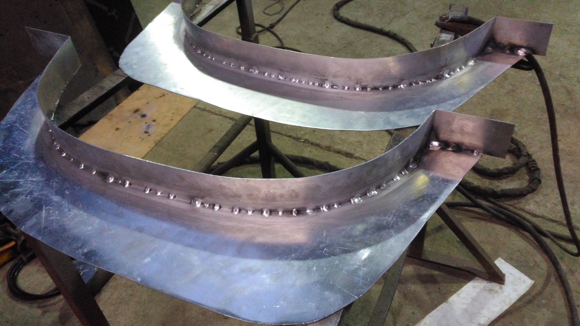

It would help a lot if we knew your intentions from the welder. Job types, material thicknesses, joint types etc.cheers...i need to do some research
200 amp ac/dc tigs range from £900 (and below even) to prices outwith my budget! not sure if the more expensive are OTT or will make life easier.
have been using the spool gun to do simple shs/rhs alu frames in the past, that's all 3mm (I'm just quoting details given by Service Metals here) 6063 T6 I believe, 6082 for thicker walled sections. That was ok once I got the hang of it with the spool gun and a 250a kemppi, so would need to do that job sometimes
The sheet <3mm is usually 1050A h14...I'd want to make wheel arch type things like in the first post, 1.5mm sheet...they worked ok but would rather be able to actually weld them rather than 100 tacks http://www.mig-welding.co.uk/forum/attachments/img_20161027_174854-jpg.105486/
tbh I just used the sheet i had lying...there could be better grades to use
as I say I don't do a lot of welding but now the spool gun is broken it's sorely missed! and since it can't do the thinner stuff thought should maybe explore other options
no intention of spending anything near £5k tho. between 1-2k is doable, the £900 Parweld looks like it would be fine but happy to spend a bit more if it makes things easier
Yeah your budget has decided this for you. Your no where near decent pulsed mig money.budget...ideal world £1k but could go up to nearer 2

@smashweld might be worth trying to find dealers near you where you could try out some of the machines you have listed above. The Parweld as I said is decent enough and the Thermal Arc is basically the same. I have tried the Sif and it was OK but the display contrast was bad, I think Tom said it was better now though. Out of the two I would still have gone with the Parweld personally. I was thinking about a Jasic but never tried one so can't say.
I used to have a Tec Arc 251 square wave but it was a big machine, pretty decent though. The one you listed though (wrong pic showing in the add) is an inverter so may be good or may not be, can't say![]()
