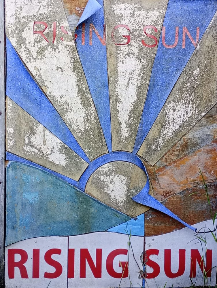

The original, knackered sign is 40mm wide. I've cut some 40mm strips and cut a channel 20mm wide by 3mm deep.
Thinking to stainless steel panel pin this on with some pu glue to create an outer frame. If will also serve to retain the ali/ply/ali sandwich.
This will give a 10mm deep recess. The sign can be painted or whatever onto the aluminium then the recess filled with resin...maybe.
The "white" is not a peelable film. Powder coat maybe? Whatever, it doesn't take much to sand off back to bare aluminium.
