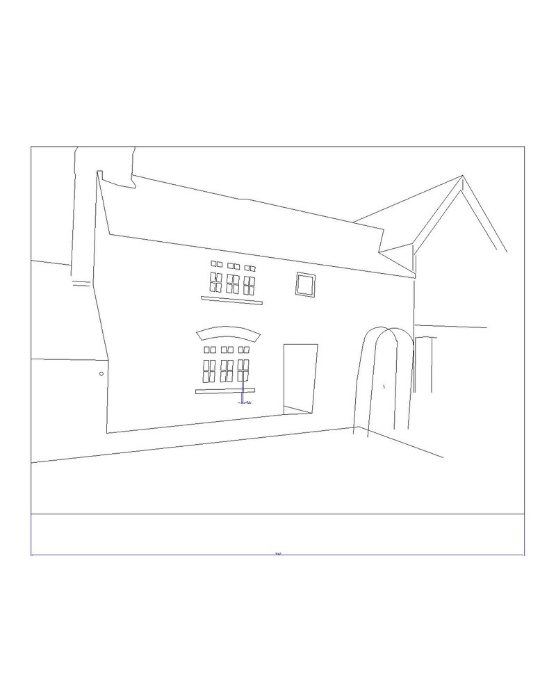

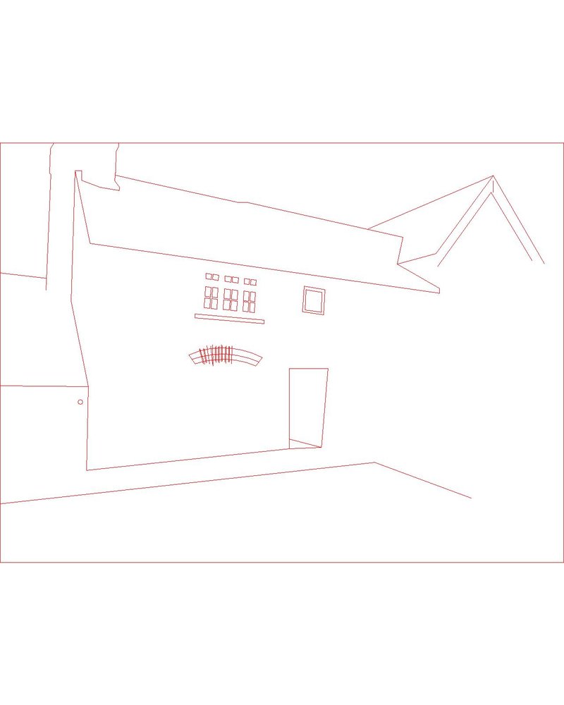

Imported to AutoCAD as it's own layer then started to draw over it in another layer. I then turned off the photo layer and am left with this:
Obviously far from finished. However, I'm not sure where I'm going with it. To look "anything" I'd have to start cutting holes in it say for the window panes and even window sills and individual bricks, finish the sign in one colour then set it against a contrasting background, maybe with a backlight for night time.
Do I treat it as a rectangular picture frame and remove the sky element?
Much more difficult than I thought!

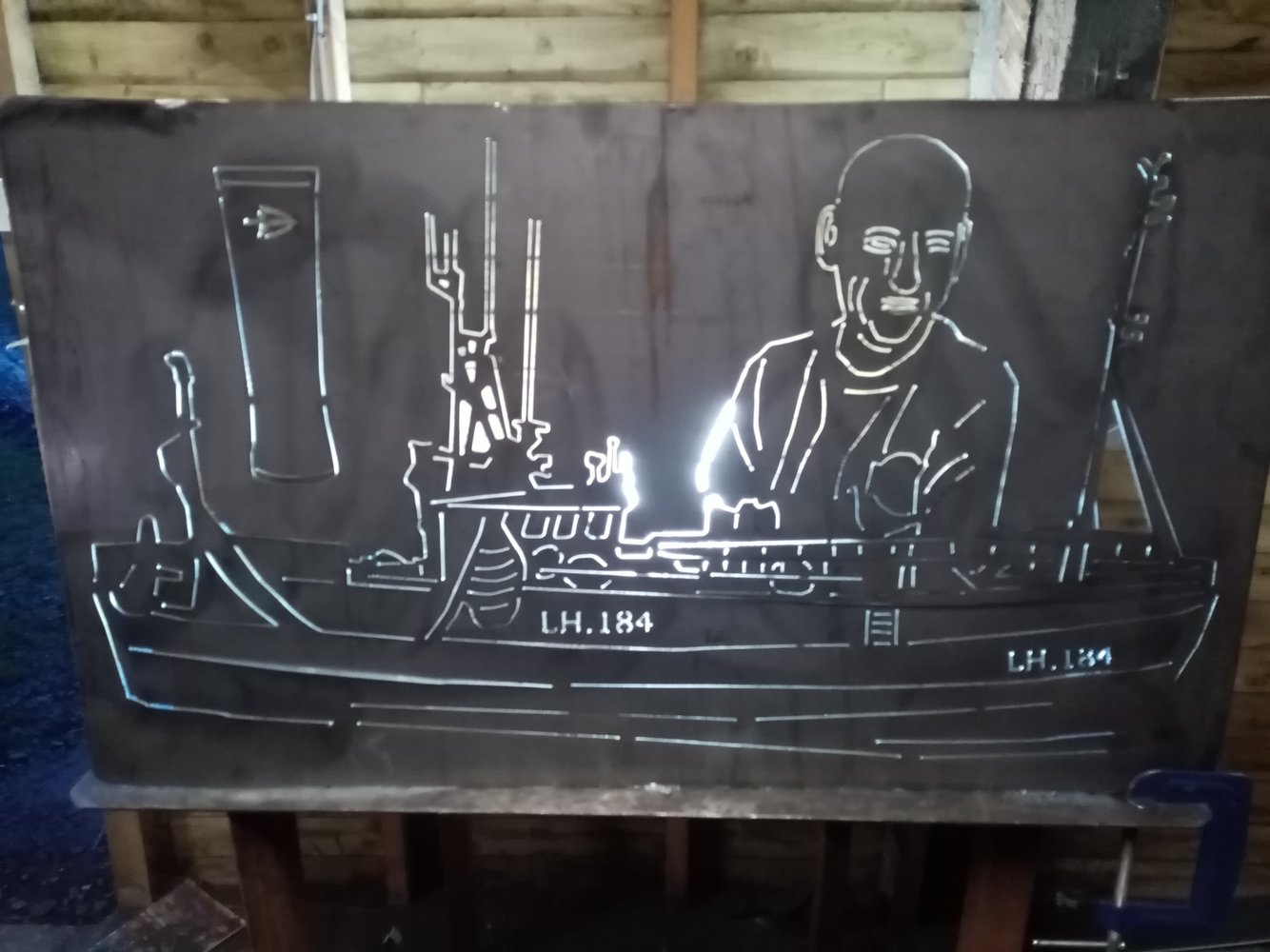

I'd probably cut out the windows, the rest of the detail just do cut lines instead of closed shapes, back lighting will work well. This looks better in real life as the lights more even than what the camera picks up.

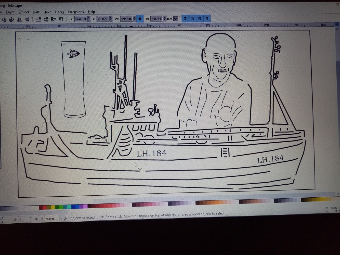

How wide do I make the cut lines?
Not trying to steal your thunder btw, I won't be investing thousands in cutting kit so still need someone to do it!
Edit: So is it that Inkscape can automatically do the cut lines for you?
Does he mind it always points North?
.In inkscape if I do an open line so just a single line then the plasma will cut it dead on, I draw at 1.5mm as that's what the plasma cut width is, if I draw a closed shape like a rectangle the plasma will cut either inside or outside the line depending on how you set it, if the shape is too small for the plasma it says do and won't cut it.
So in AutoCad I could set my line width at 1.5mm and that would be it? Stop them short as needs be to ensure things are supported etc.
I guess plate thickness is important as in too thick and you narrow the viewing angle?
I can draw them any width in inkscape and as long as it isn't a closed shape the plasma will cut a single line, reason I use 1.5mm is that's what the cut will finish up as and if you view your drawing at 1:1 scale it let's you see if bits are too close or such. Most of the stuff like that I do is 2mm thick tto get a decent angle as you say.
What if you paint or powder coat, does that narrow the gap any?
