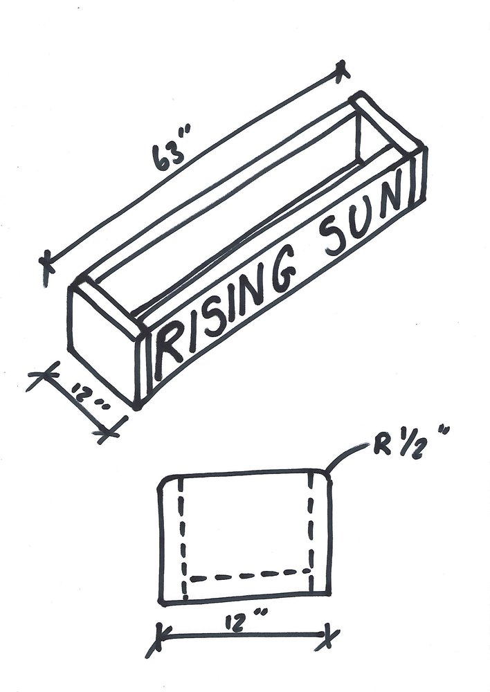

Western red cedar does not weather rod for 50 or more years line the boxes with modern artifical slate and silicone the edges, , put in a few plastic 3D printed inverted top hat drains in the bottom . Saw some WRC side wall cladding boards off a barn conversion last week , put there over 60 years ago .The planter will be roughly this size. Out of scaffold boards. Joined together with stainless screws and Gorilla glue. This is exactly the same size as the original, made by some old boy long since deceased. It'll be the same but different. The routed front, radiused corners in case some old drunk / kid decides to head butt it!
The original was just filled with soil and she grew flowers in it. Obvioulsy wet soil in there will rot it out. First though creosote (the real stuff) inside and out. Second option, black bitumen paint inside, creosote outside. Third thought was to line with DPM plastic but I only have blue. then there's how to fold it in etc. Even then I reckon water would get between the DPM and timber. I'll drill drainage holes in the base whatever though not sure how many / how big.
The corners might have some builders band or similar tacked on and possibly rope handles at the end.
Any suggestions welcome!
I have most of a roll of black DPM if you like some…The planter will be roughly this size. Out of scaffold boards. Joined together with stainless screws and Gorilla glue. This is exactly the same size as the original, made by some old boy long since deceased. It'll be the same but different. The routed front, radiused corners in case some old drunk / kid decides to head butt it!
I used doubled up 1000 gauge poly in my homemade planters. Have the sheet massively oversize, fold n staple the inside corners. Same at the top, then finish with a capping trim
Whatever you do don’t cut the corners, I’ve learnt this lesson the hard way
How about some sort of coating or CT1 on the poly joints?I'm trying to avoid a capping trim tbh.
Go for it, nothing to looseI did think that. Neat cuts then a bead.
Tbh I have black bituminous paint already so think I'll go with that. She's only growing flowers in there, not stuff to be eaten.
Maybe embellish with some printed drains like @DAPPH suggested.
