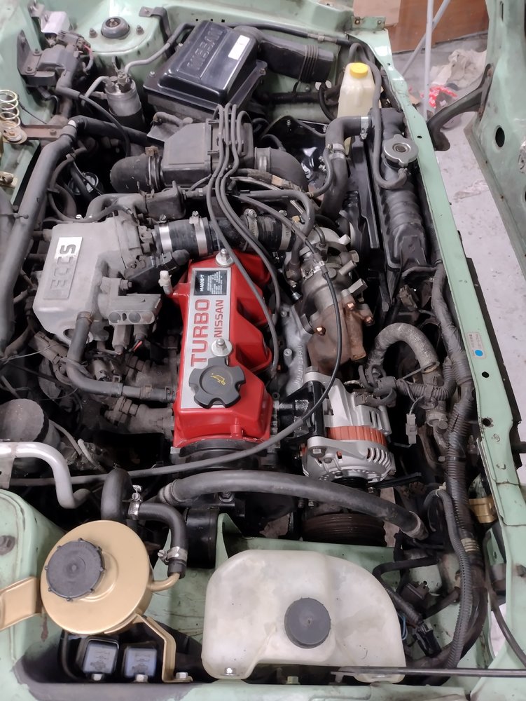

You paid for it?So decided to pull the turbo air pipes. For some reason one was wrapped in electrical tape...strange as electrical tape works well for....errr....electrics...I'm not convinced it's a good choice for a turbo air pipe!! I imagine the torn inlet pipe would have really been messing up the running. I guess the loss of pressure might result in rich running...just a guess.
I looked up the turbo end float...it should be 0.1mm. let's just say I didn't need a dial gauge...the shaft has huge play plus the pipes were soaked in oil.
New turbos are £500+.....I may have paid £1,000 too much for this car!!!
Decided to order a used unit...fingers crossed it works out. I happen to have seen the car it's coming from which was mint until someone crashed it - I met the guy when I was sourcing parts for Project #2....lucky he still had the turbo!!
I'll have to recheck the paperwork...I believe the car has had at least 2 new turbos so I'm thinking I really need to get down to the root cause of the failures otherwise the next one will just end up going the same way. I'll probably start by removing the water and air supplies and go from there....that braided hose is an upgraded turbo oil supply line so I'm thinking someone at least tried to do it properly as the oil supply line is a common failure point.

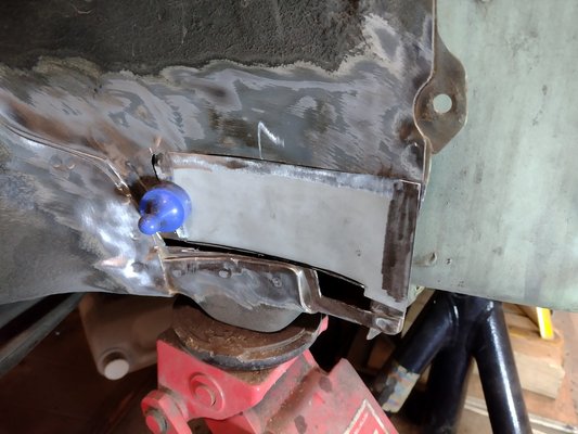

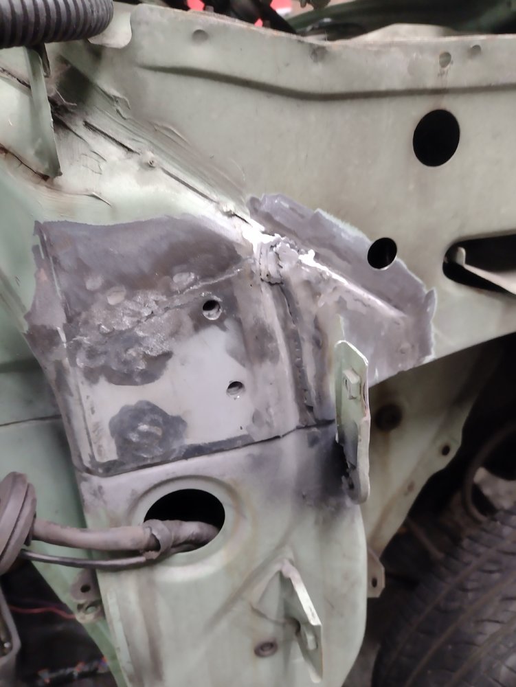

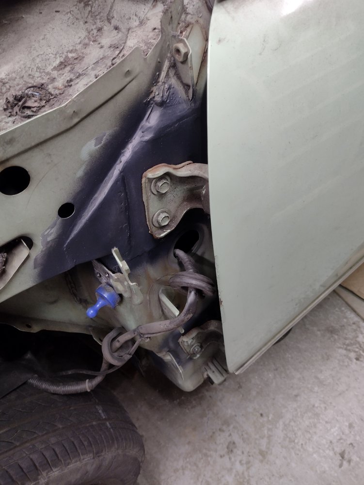

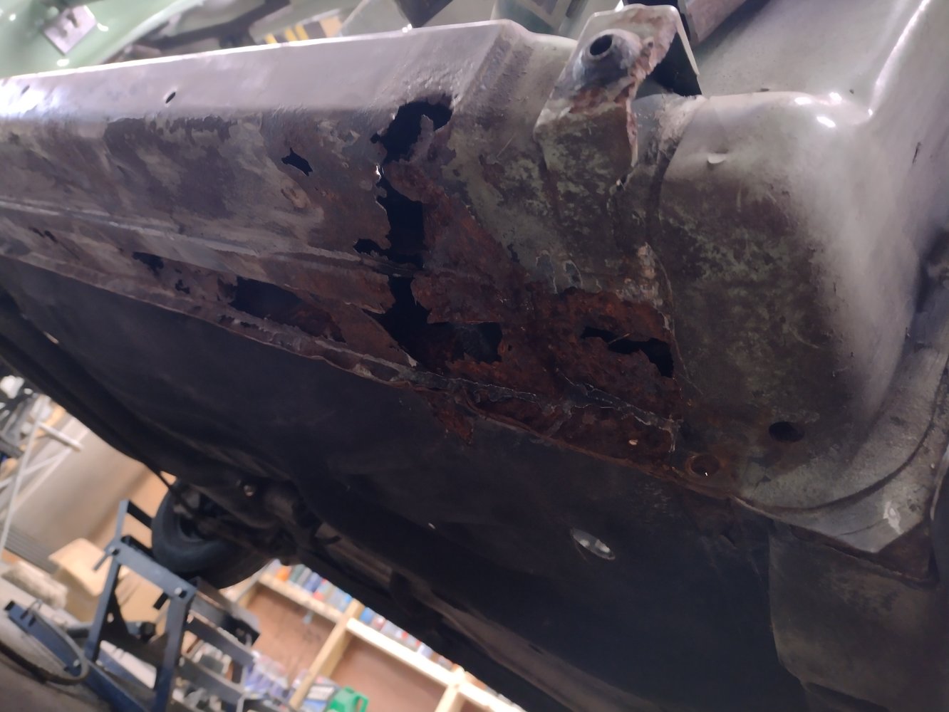

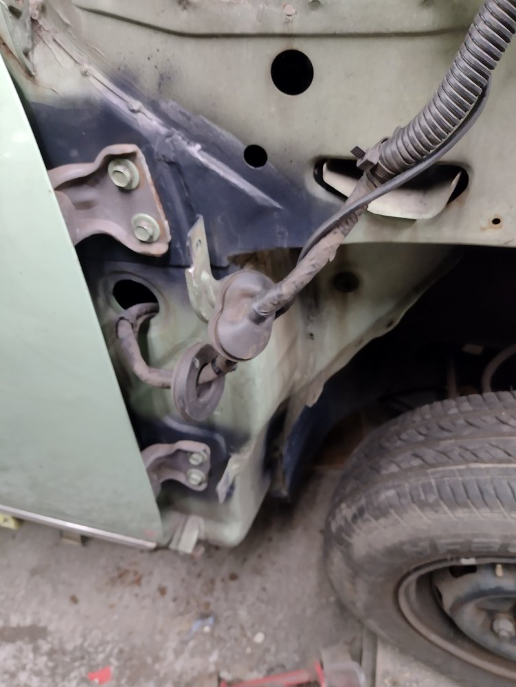

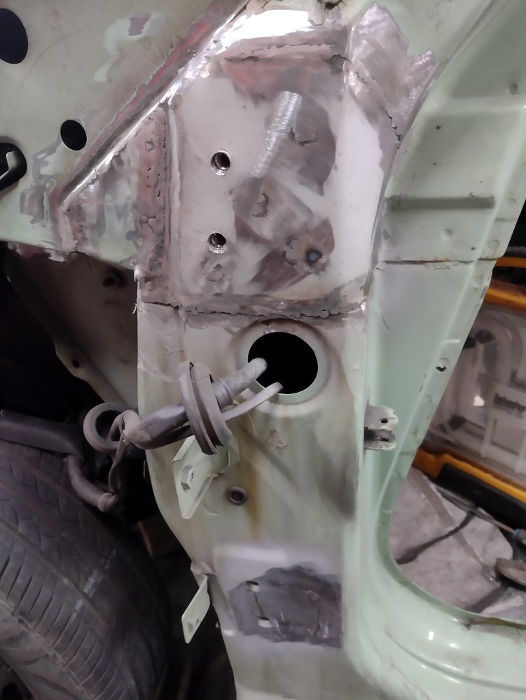

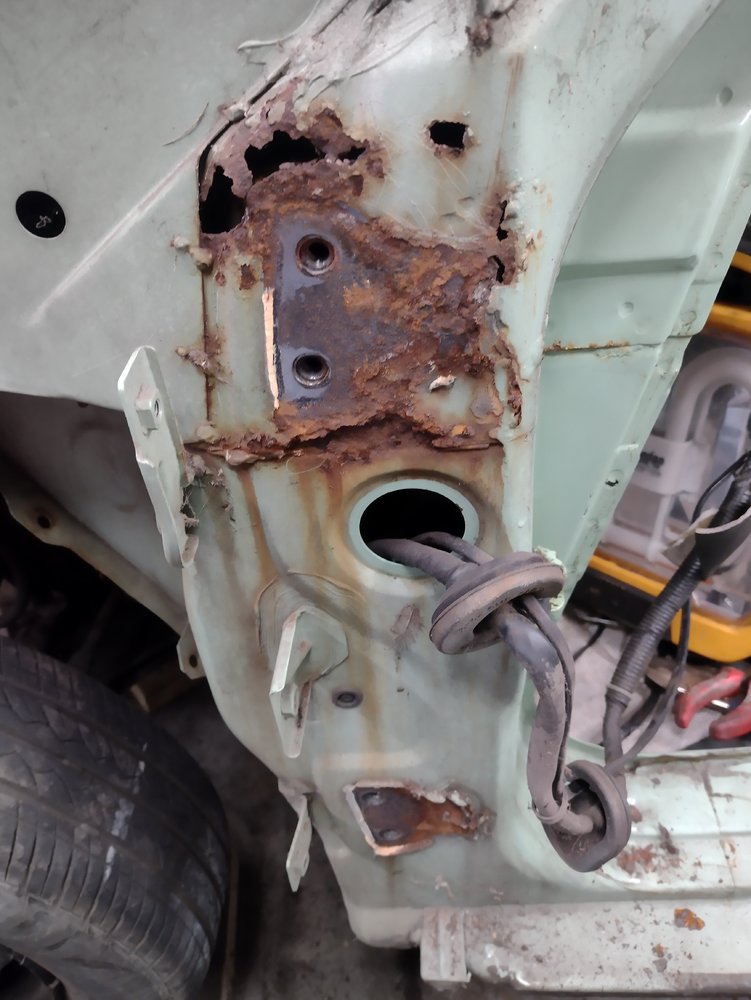

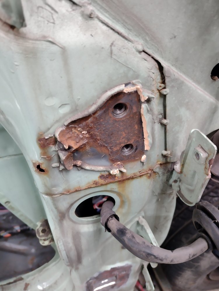

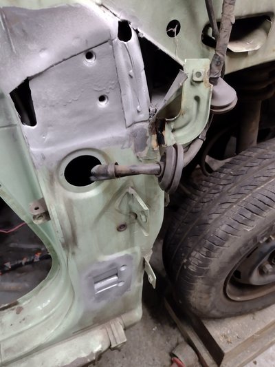

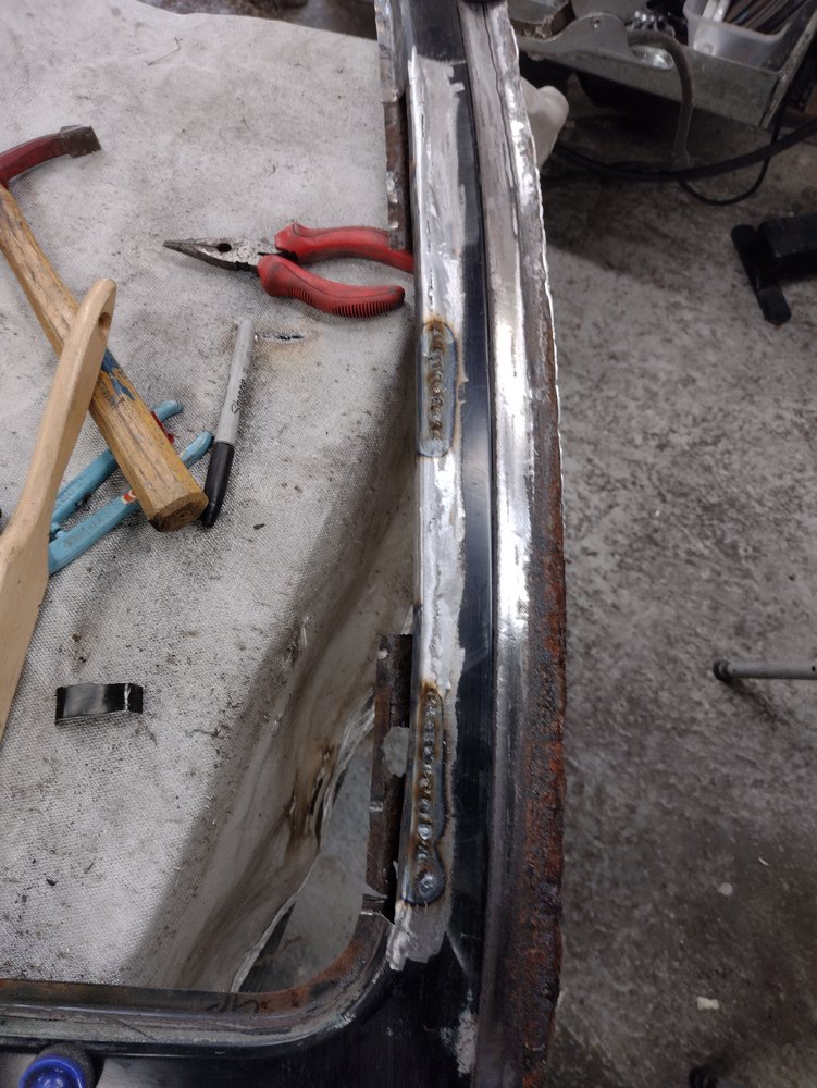

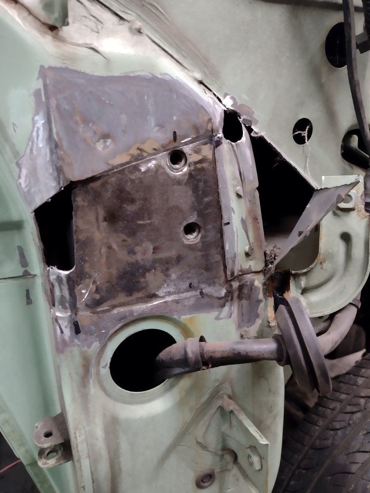

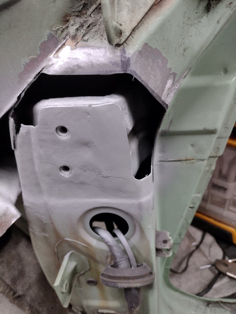

The market for these cars is a bit crazy....especially in the spring/summer months. I can't believe how much they rot...this was made in 1991....it isn't really that old and it's new enough to last better than it has I think. Those door hinges were just bolted straight onto the bare shell I think!You paid for it?
