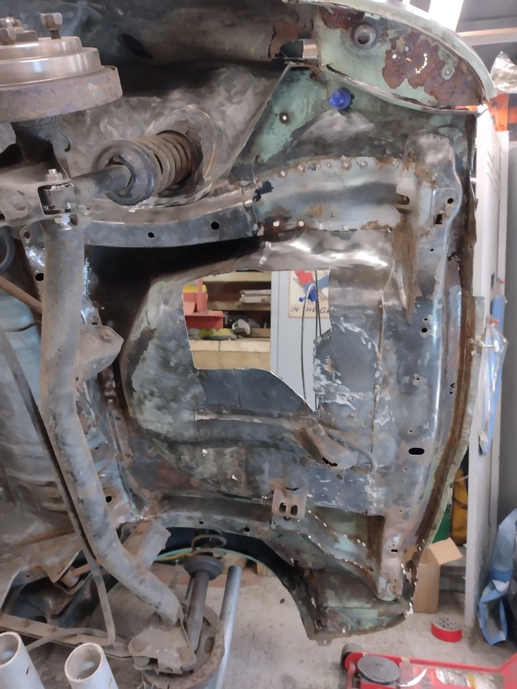

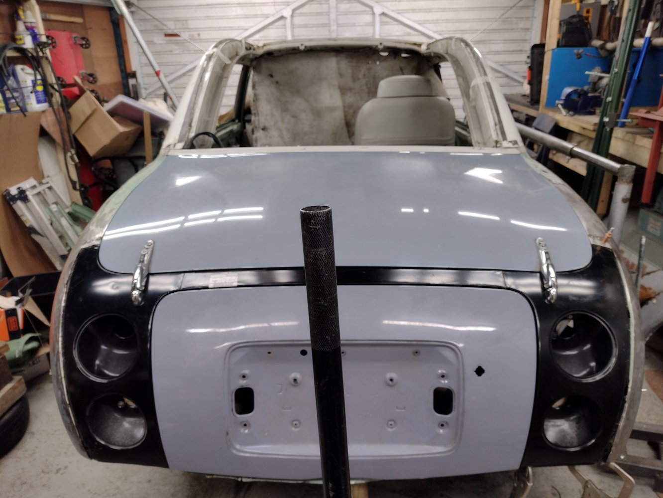

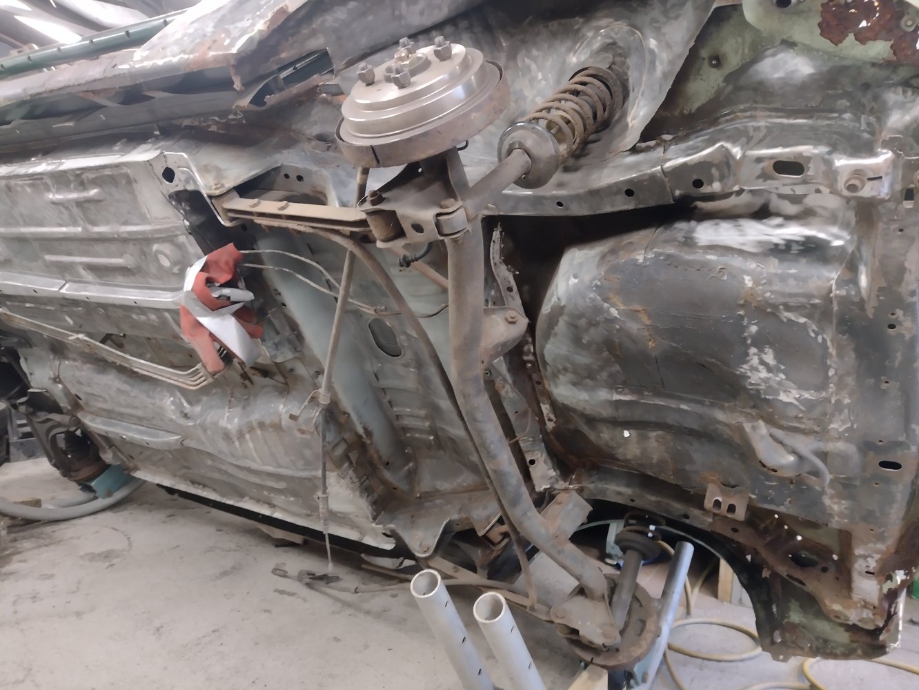

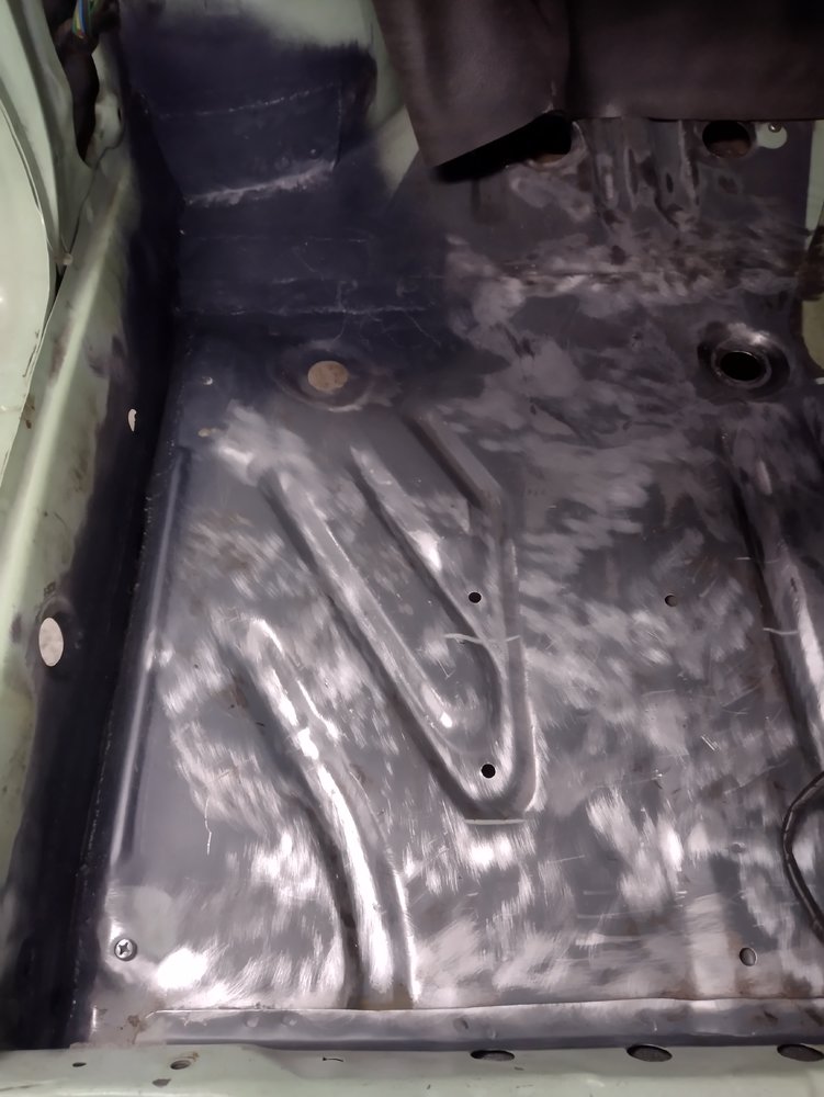

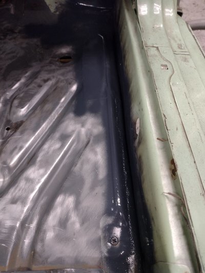

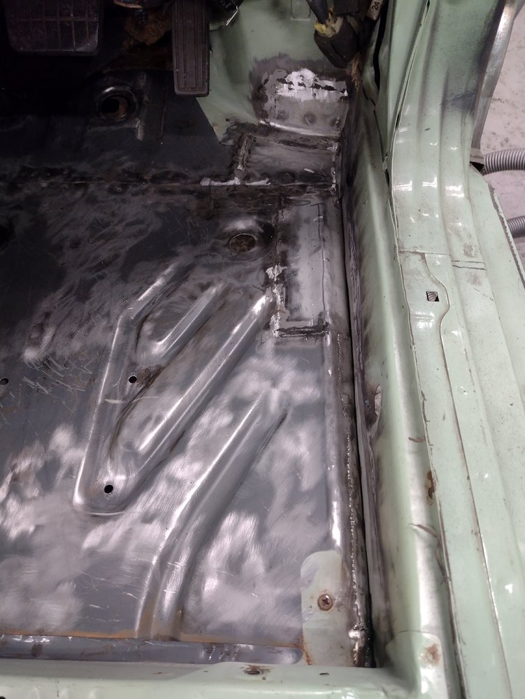

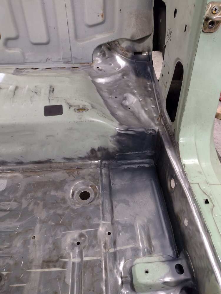

Got the first round on wire wheel work done on the underside...usually takes a couple of rounds but I need to see where the problems are at the rear. Floors are now looking good and most of the structural bits on the rear are sound...the end of the drivers side chassis rail is a bit of a tea bag but I already knew about that so no real surprises. The chassis leg rot was caused by a previous chassis repair...if only they'd have added some rust proofing after they pulled it out

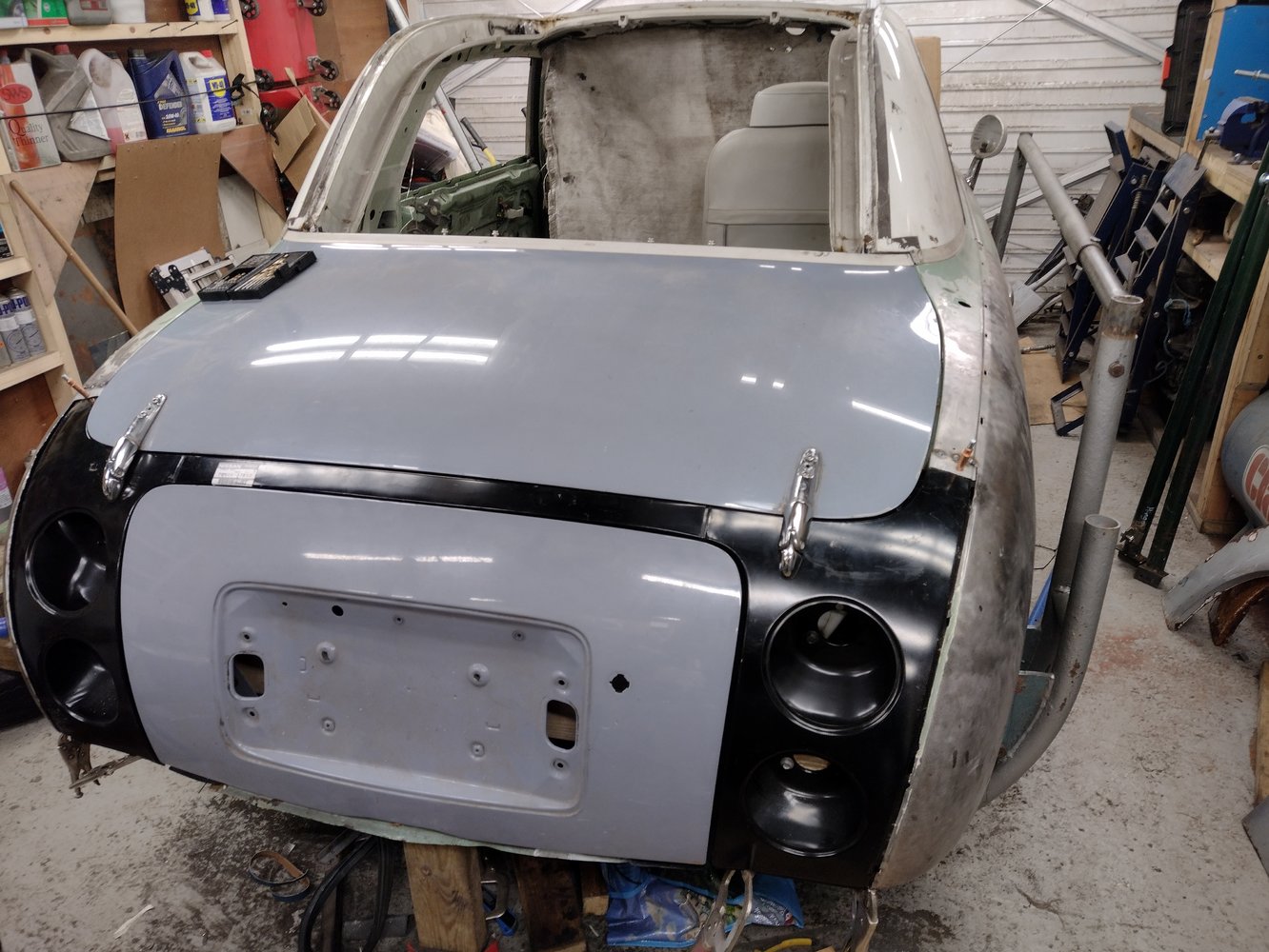

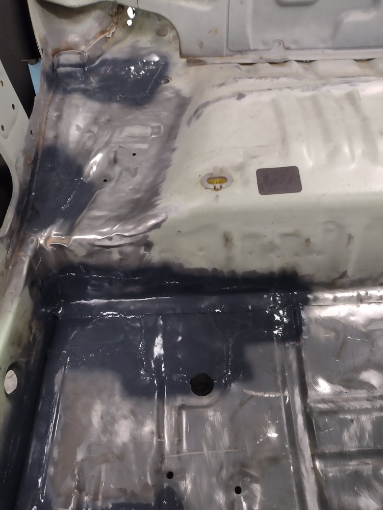

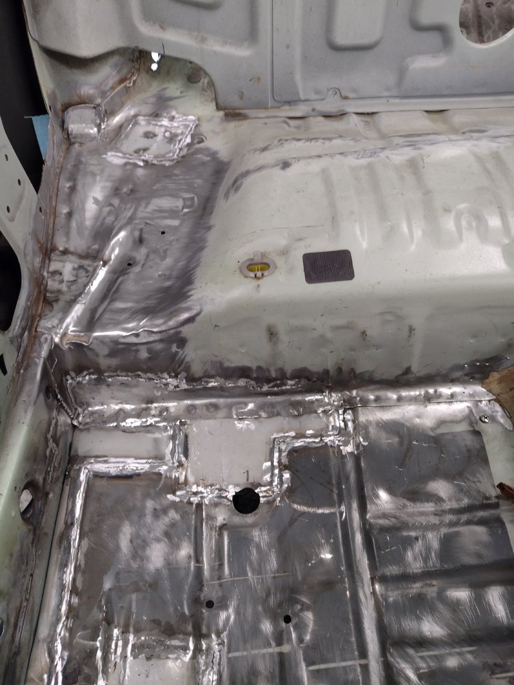

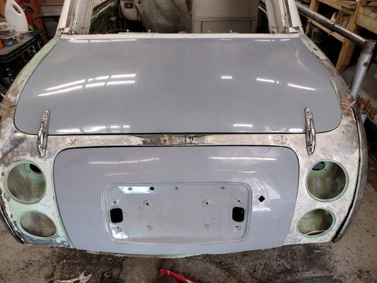

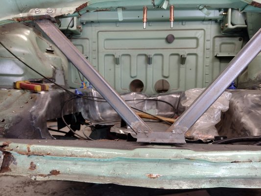

Attention will now be on the rear end...the spare wheel well has quite a bit of "MOT standard" patch repairing which makes doing it properly all the more difficult! I'm going it see if I can find a better boot floor which will save some time but chances are slim I feel as they all rot in the same places from what I can tell.
"luckily" the floor patch was just tacked in and covered in filler so hopefully should be simple to get out.
