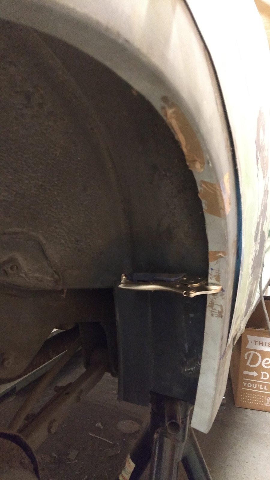

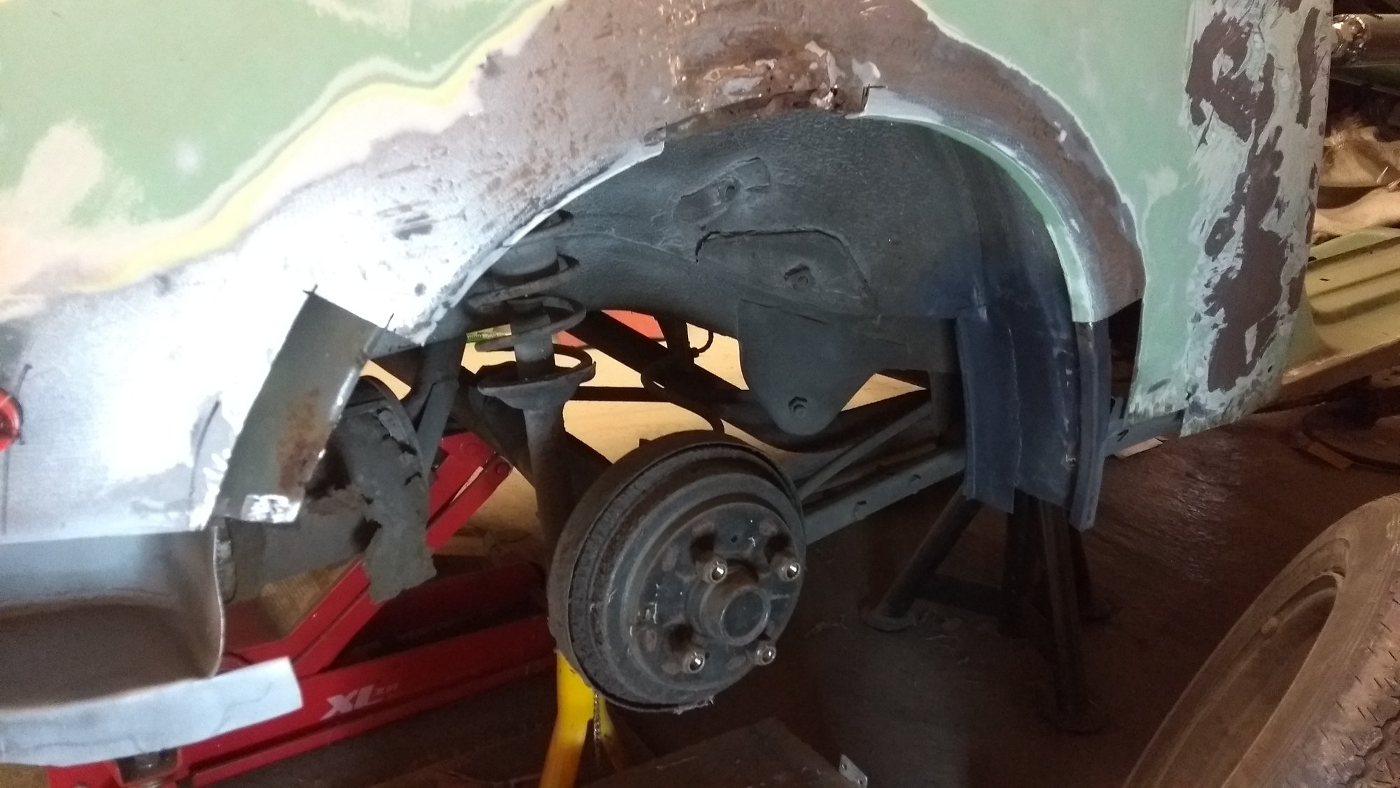

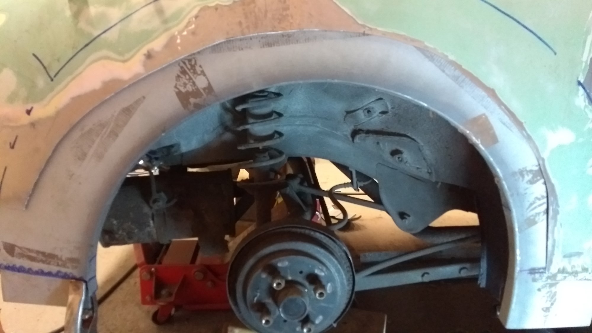

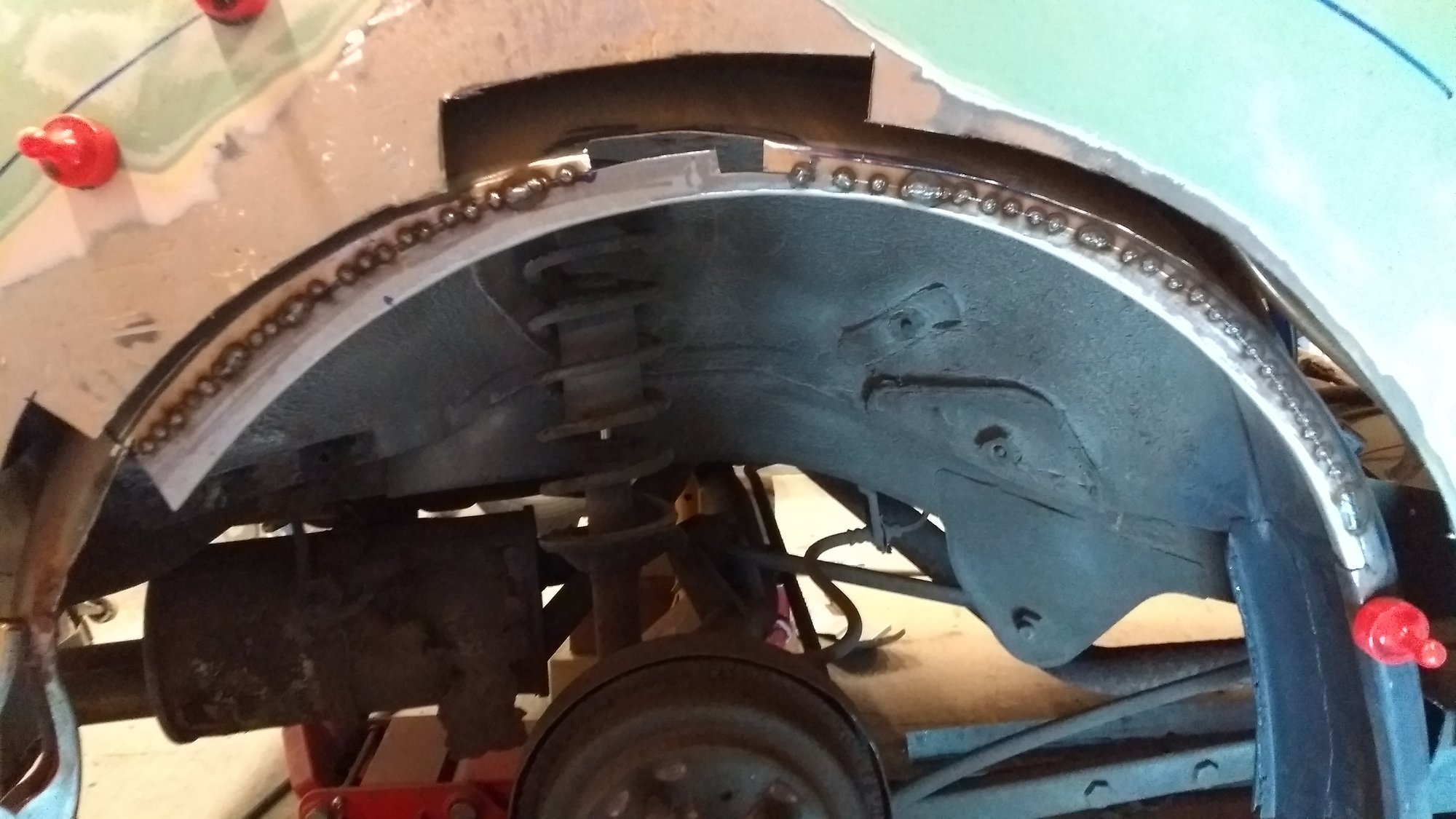

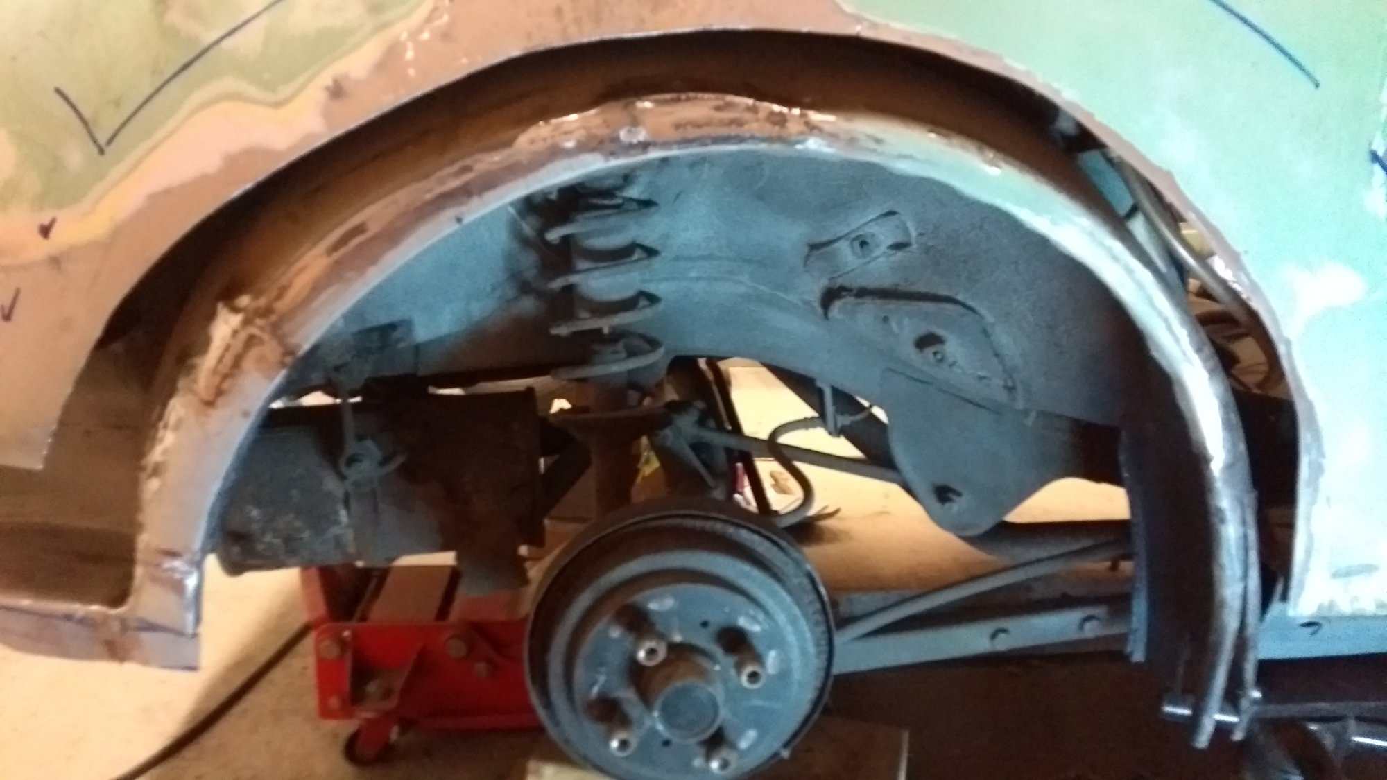

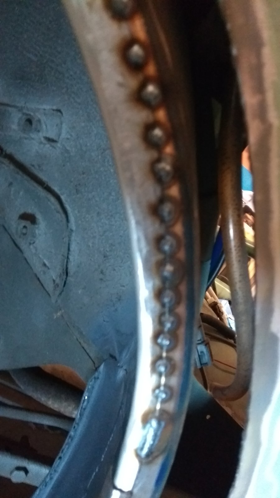

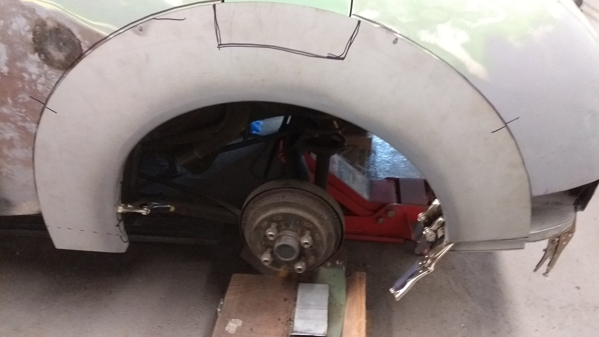

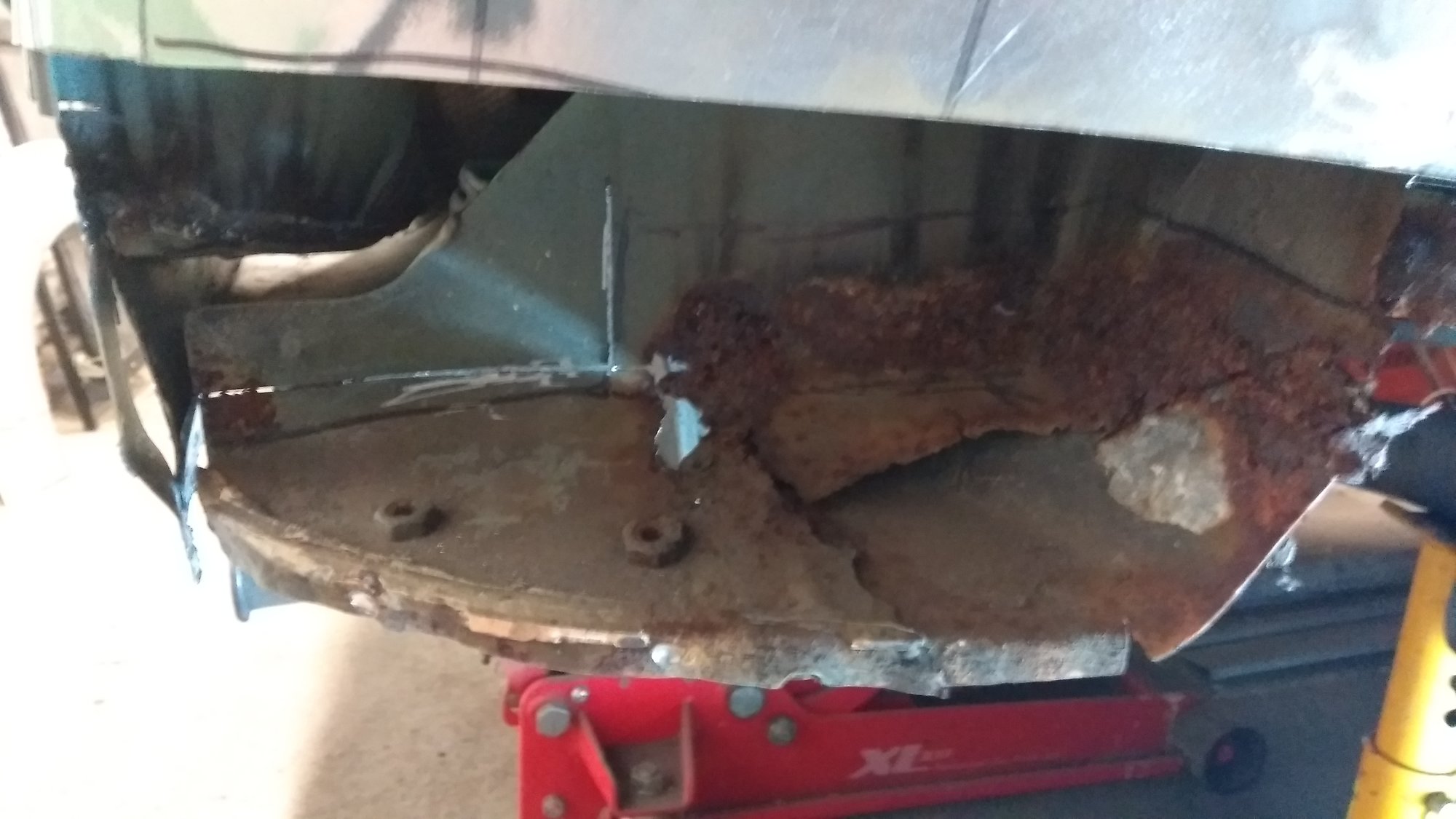

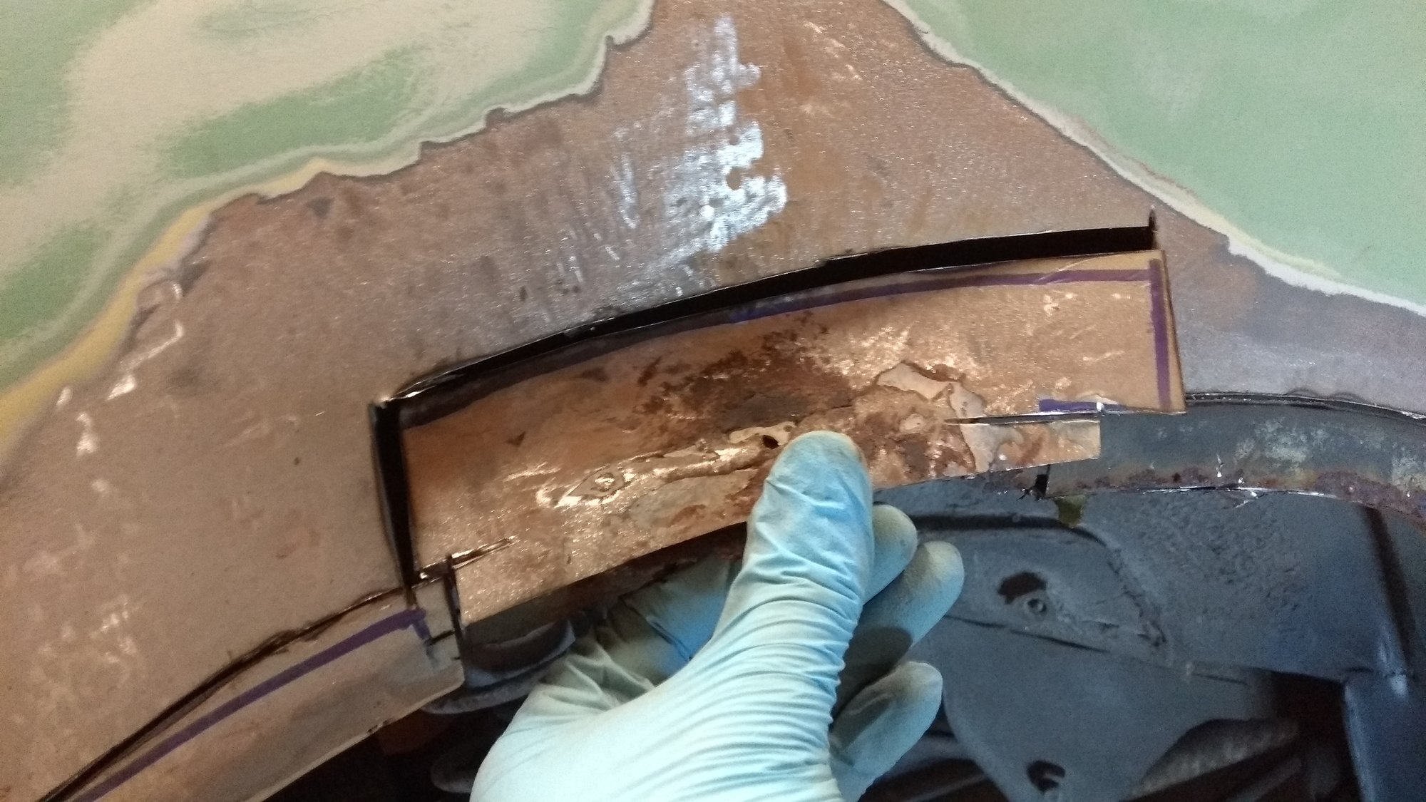

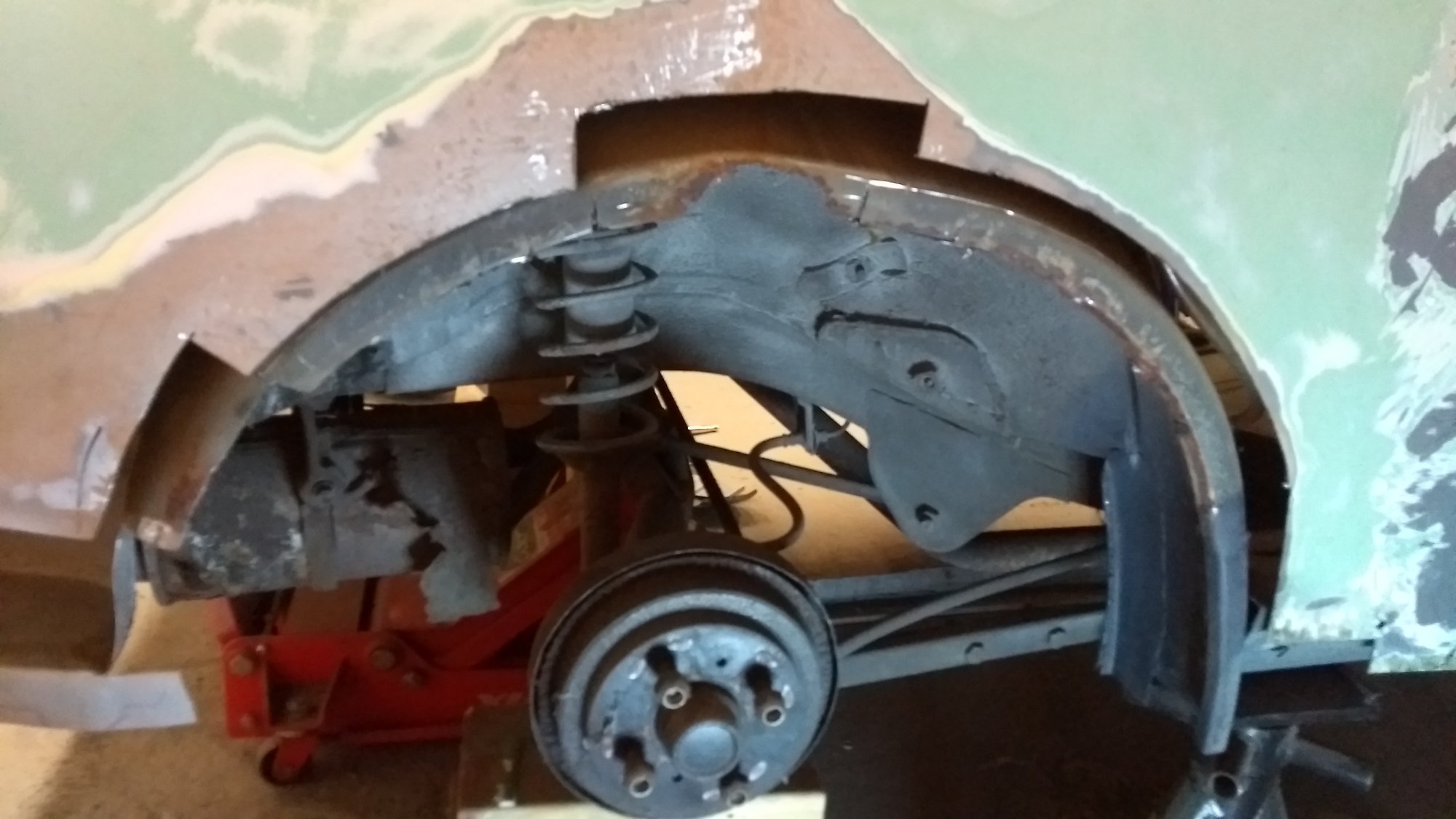

I think this is as far as I can get on the passenger side arch....I managed to sort out the lower corner so it's more original. I can't really go any further without fitting the rear bumper. If anything needs tweaking it needs to be done at this stage as the rear bumper sits quite snug along that recess by the lower flange so it's critical this bit is correct otherwise I'll have a nightmare getting the bumper to fit.
I've therefore decided to leave the arch for now and to work on getting the drivers side to the same stage. Then I can refit the rear bumper (if I can find it!!) and get any tweaks out of the way.
I will also need to work on the area where the sills meet the arch to make sure it all comes together nicely before I start any welding.....it would be a shame to weld the arch in only to realise it needs a bit of work with the shrinker!
