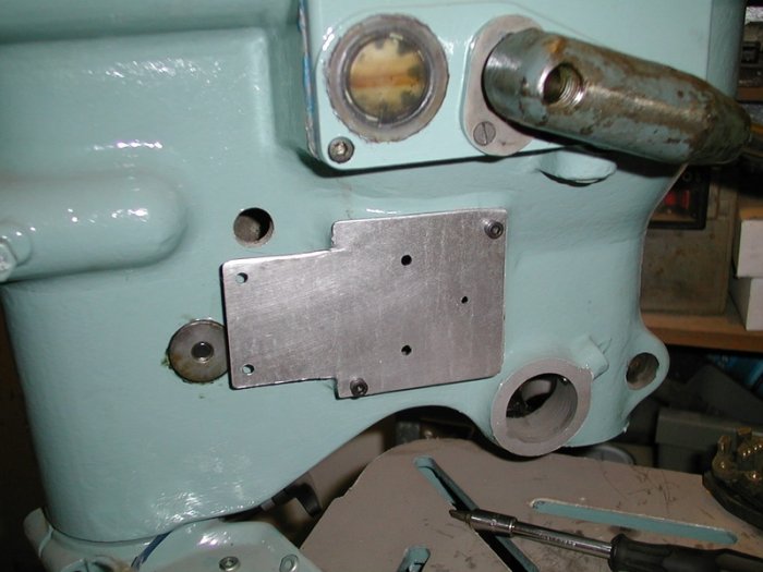

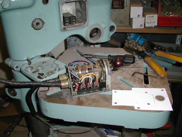

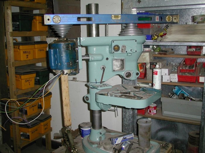

Still too busy at work. Got the motor bracket, a few odds & sods and gearbox side blasted ready for painting.
Can't get near to it at the moment, there's a pile of blasted (in two senses of the word) scooter bits piled up in front of it.

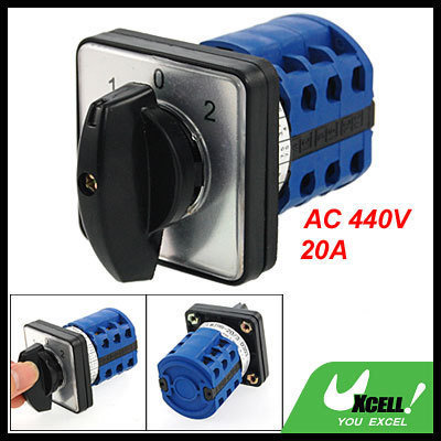

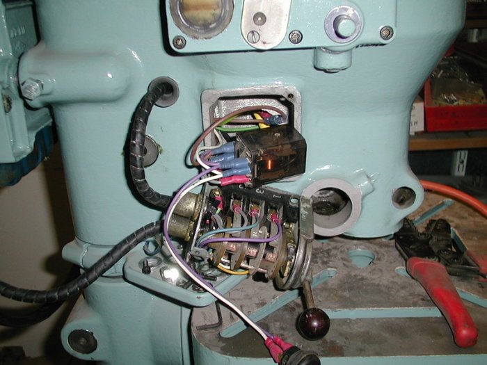

The drum switch won't fit in the hole, it's one of These, or at least an older model.

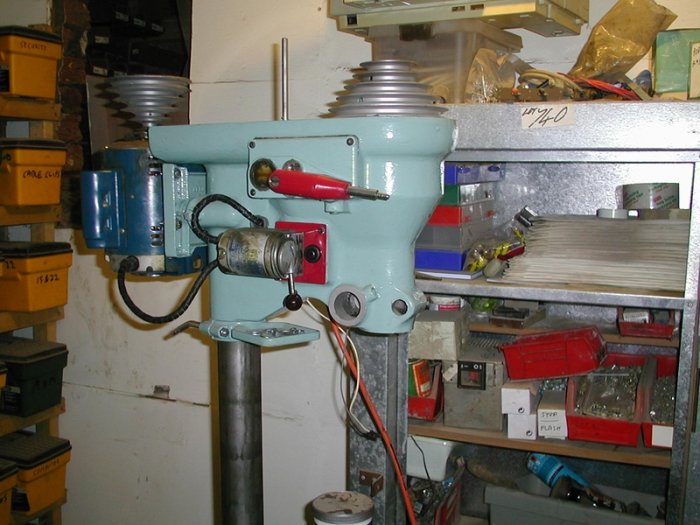

.Been looking at buying a pillar drill and have been advised off a few people to buy an older one and recon it,looking at the work thats gone into this im not too sure now.
