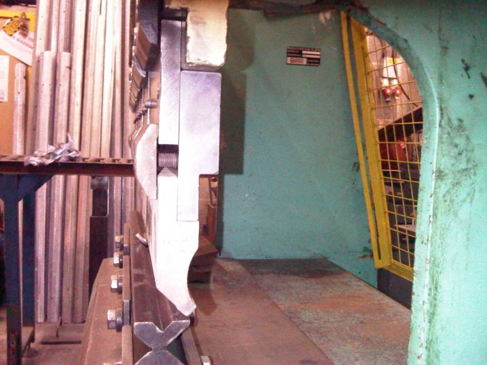

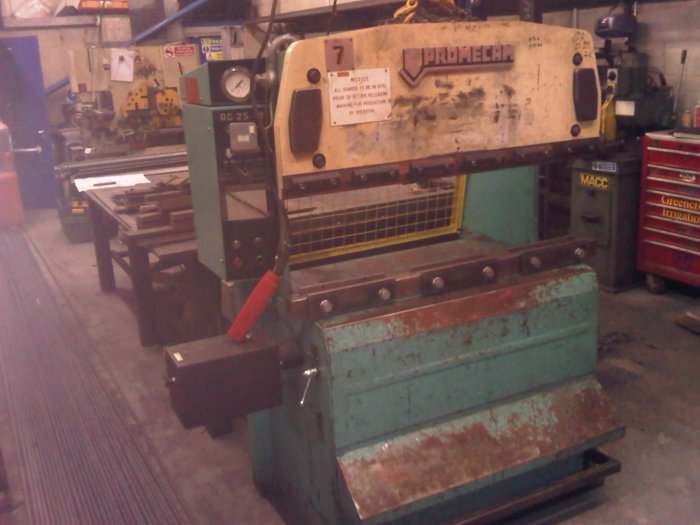

Got a couple, nothing Promecam, same principles apply though.
One think you need to remember is the centre line of 99% of tooling will be the same. The force is applied by the back of the tool holders. If you just clamp flat between the finger and clamp, you will deflect it, bad for the fingers, and youll bend the bolts.

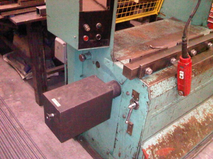

The remains of the windy handle is fitted to the lhs of the box. Whats occuring here? Looks like there has been a box around the other handle as discussed previously, looks like it needs reinstating!
