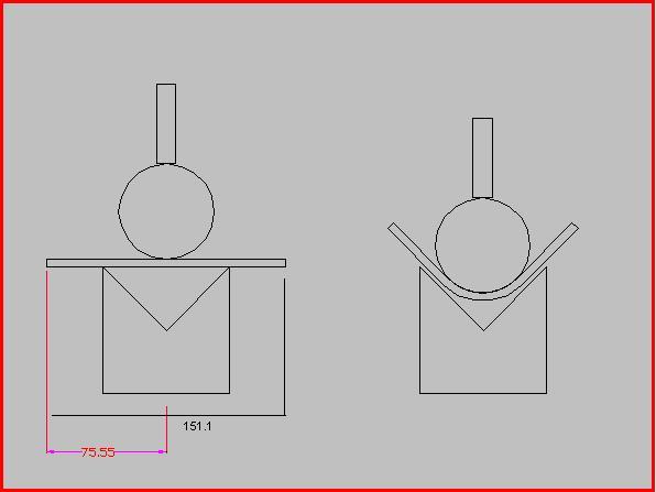

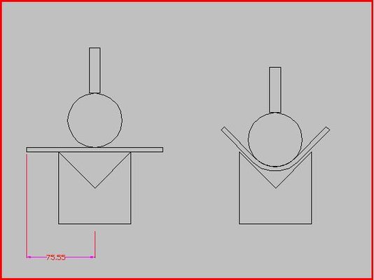

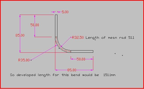

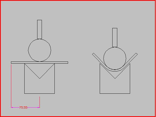

How do you work out how much material you need to make a box say, allowing for the bend radii?
