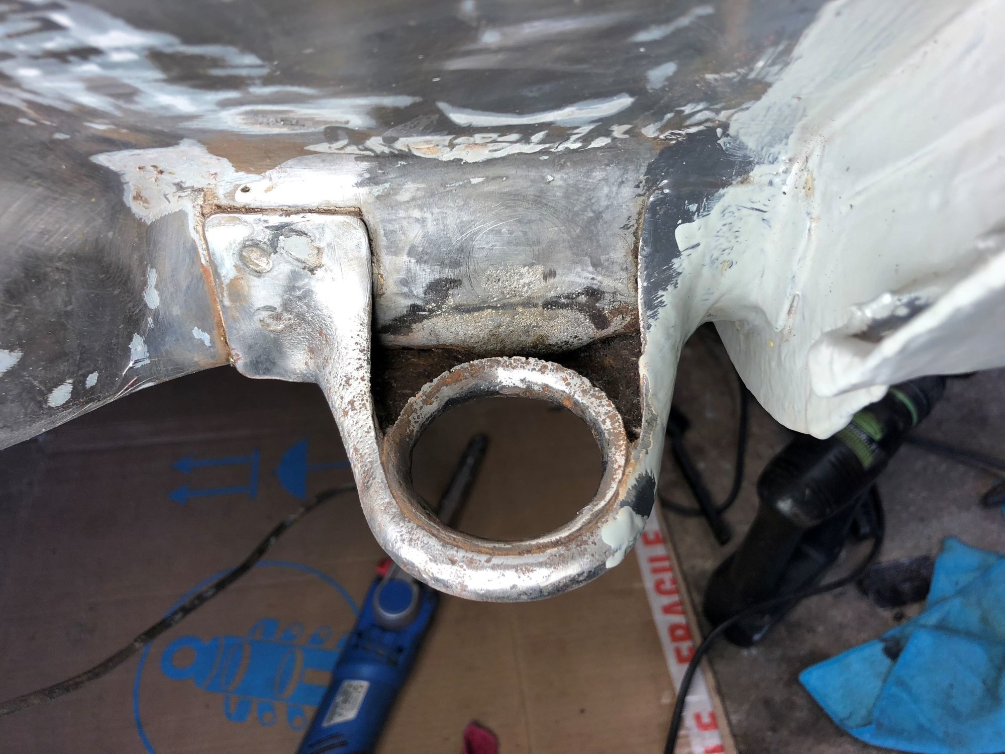

What one sticks best? Considering its an old car I am not going to get a perfect totaly rust free prep. Best I can do is good but not 100% see sample pic. I still have more to do to this but it wont get much better.
