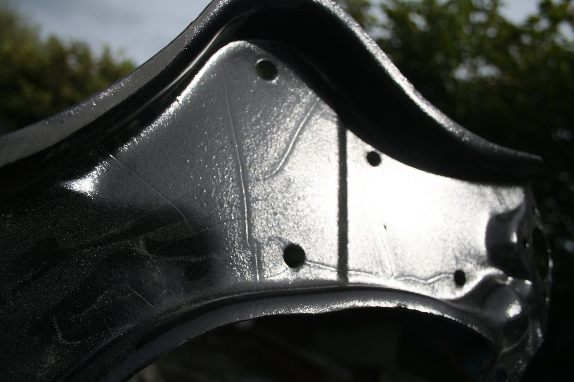

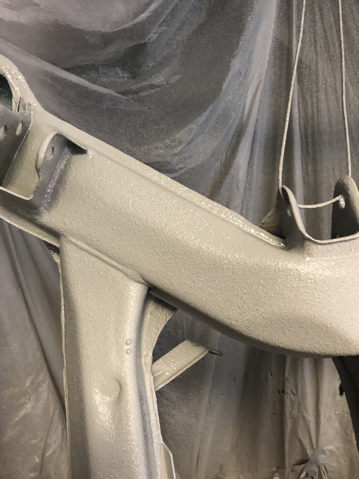

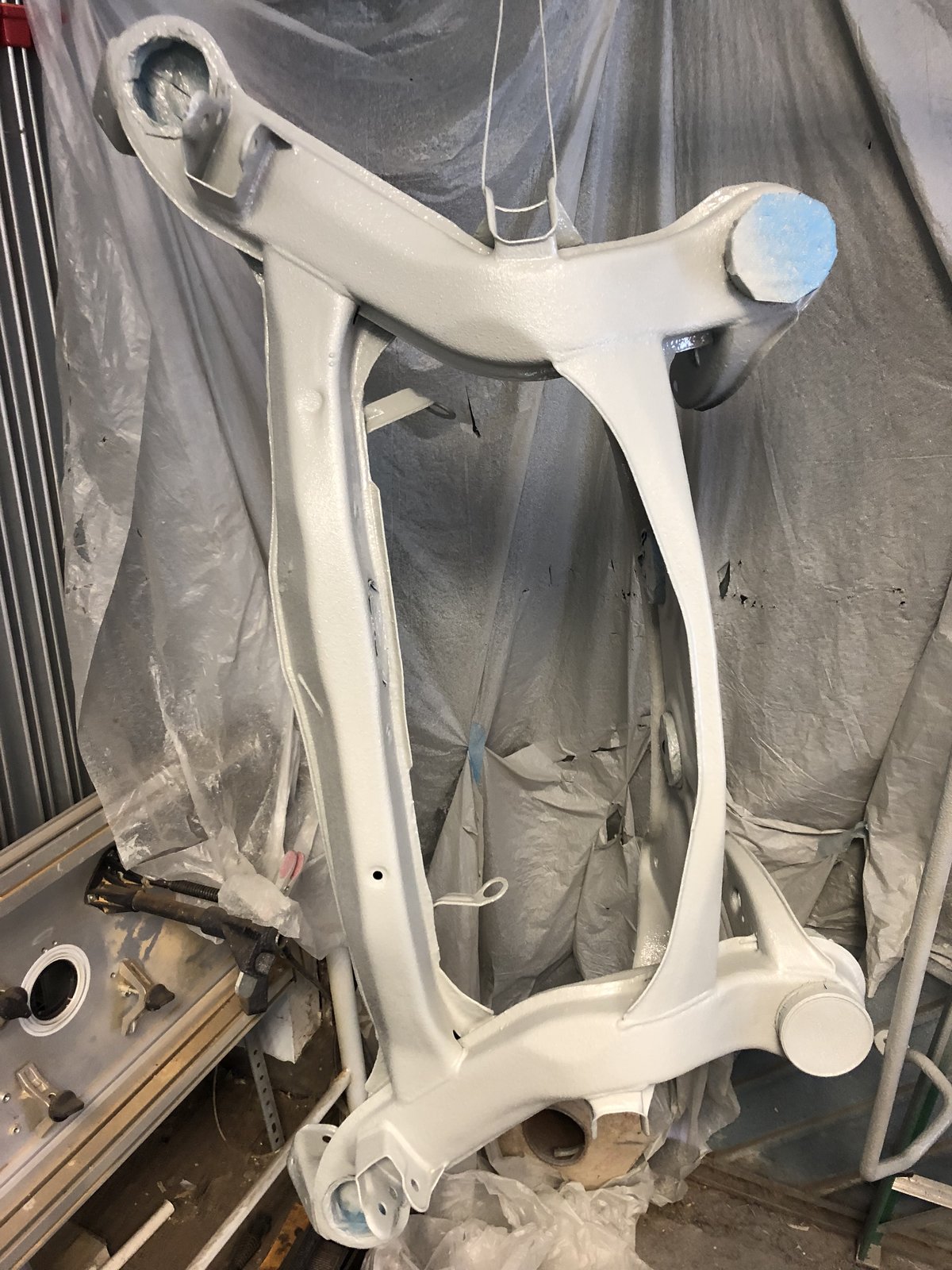

Got my Jotun 87 and wow its so much thinner than the em121 (yes I did stir it) Applied it to my subframe with my earlex spray station thing and it went on fab with no thinning. I unfortunately didn't make up enough to complete it but got most of it.
Happy man
I'm gonna do another coat this time with some thinners 20%. My main concern was getting loads on and I think I did.Should be well protected. I got some 2k aerosol 40% gloss and i'll lash that on top. Probably won't fit back on the car due to being 10% bigger lol.
Keyed it with 320 for the final black coat. Not between Jotun coats but was within the window. So that's 2 of em121 then 3 of 87 then 2 of 2k satin. Might take it rallying.
Don't know if anybodys interested but I had 2 pucks of Jotun sitting for about 6 days. The neat Jotun has a little flex but is very tough. No impression with a hammer. The 20% thinned Jotun tore when I tried to bend it and is a bit crumbly when twisted maybe 20% is too much. I'll try to keep it neat in future tho.
