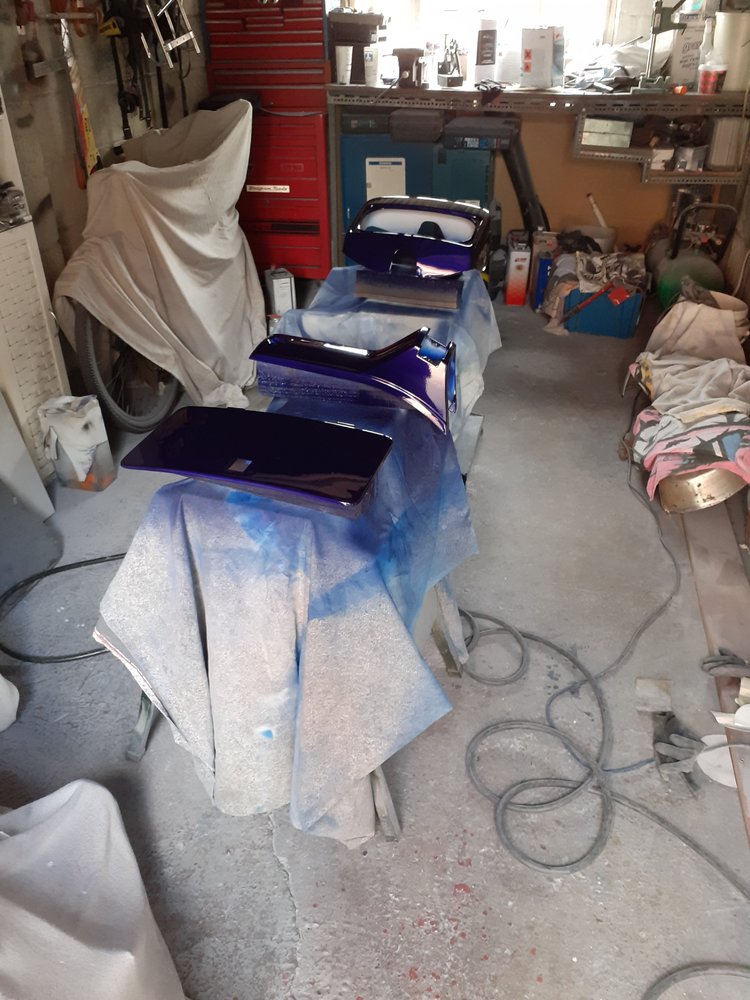

have you got some panel stands? ...alot of folk like to paint parts in the same position as they lay on the car , or laying them flat can help as less chance of runs but more chance of dirt landing in it
If you're spraying in a proper filtered, clean booth then you will probably avoid much wet sanding although it's normal for nibs to still occur. In the old shed where I painted it's inevitable but I found that painting under a gazebo resulted in the job not looking like it was covered in crud as long as you didn't look really closely.
