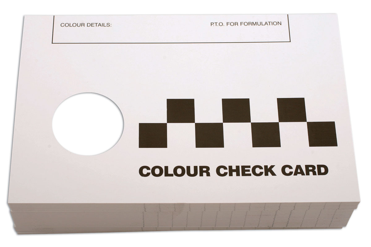

I would say that’s reasonable logic.I've never sprayed, but logic would dictate that a lighter colour (white?) would show coverage better? Happy to beif I'm talking rubbish.
you need a striped test card to check for coverage...white & black , single colour wont show if its covered or not
Approximately 150x100 mm (6x4) inches. Although I am not an expert or professional spay painter I do often spray gelcoat, I use the brown paper as a test, just to ensure the spray pattern and coverage from the gun is correct. I have never used the cards as shown by steveo3002, but am interested to understand why they are better.Thanks, but what size would those cards be? Big enough for the OP to get a feel of 'large area' coverage?

So if I understand you correctly the cards give a better indication of the finish from the gun, not just to check spray pattern.
would you not agree that its not really for practice /learning...as in you wouldnt spray some paper then take it outside and admire what a great finish it is and that you can now paint ? more for confirming 'yes the gun sprays well'The masking paper is quite good for paint, if it was absorbent, it wouldn't be fit for the purpose. That is why we don't use newspaper.

once I’ve gained some of the techniques I’ll feel a little less apprehensive about a quality resultI dare say white probably would’ve been a better option although I wasn’t aware it existed. The brown masking paper is now purchased, hopefully it’ll work outI've never sprayed, but logic would dictate that a lighter colour (white?) would show coverage better? Happy to beif I'm talking rubbish.
I might purchase some of those, inexpensive to say the least and if they help in the learning processyou need a striped test card to check for coverage...white & black , single colour wont show if its covered or not
Yeah, I figured the masking paper will advise on the fan pattern and deliveryApproximately 150x100 mm (6x4) inches. Although I am not an expert or professional spay painter I do often spray gelcoat, I use the brown paper as a test, just to ensure the spray pattern and coverage from the gun is correct. I have never used the cards as shown by steveo3002, but am interested to understand why they are better.

i would not buy them to practice on , only for colour comparison /matching
typicly ...load up the gun , spray onto some masking paper to check the gun is operating as it should then go onto the job , sounds like the o.p needs to practice on some items before painting his car
