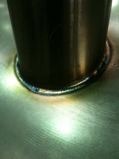

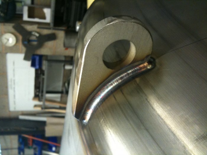

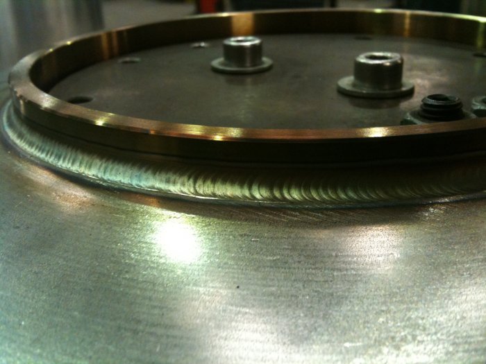

The weave pattern in those pics is from 'walking the cup'. The ceramic is rested on the work and the torch moved along kinda like how you'd 'walk' a large heavy barrel in that it's rolled slightly one way and then t'other. Several threads on the subject floating around the forum this one has a few vids in it. Technique is of limited use in that you need more room to be able to walk the cup, weaves and thin material don't really go together and soft materials like ally will be badly marred by the ceramic.
