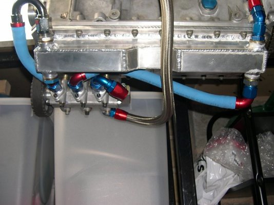

How do you guys keep your welds so straight and neat??
Do you use some kind of guide?

thats some nice fab work :-)
whats the trick for getting the welds to look like that people ? every stainless thing ive done has gone a gray colour except for about an inch when i was having a practice once but cant think of any thing differnt that i could be doing ?
phil
"You need more gas coverage, the gray colour is because the weld was still hot when the gas was removed from it.
Gas type is also a contributing factor, if you're welding austenitic stainless an argon/hydrogen gas and for all other materials argon/helium mixes will give generally you far "cleaner" welds
Argon/Hydrogen? Was that a typo![]()
