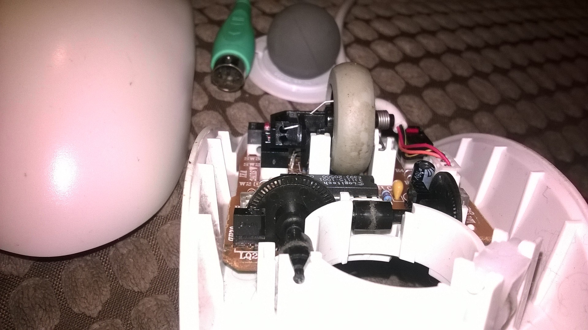

Sealed Chinese optical shaft encoders are cheap as chips on eBay. The late John Stevenson used to swear by them. OK too many counts to use directly, but easily divided down in software.
Sealed is important in your application I reckon

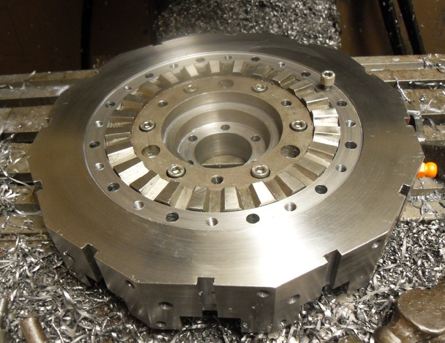

The reflective option that I seem to be heading in will be housed inside the body of the turret so should be relatively safe.

I don't think it will really matter in this application as there is a large angle between positions and thus a large angle between on/off states. Also the signals are only required whilst the turret is clamped and the clamped positions will be exact due to the clamping being done via a Hirth coupling.

It is not very likely to happen as if a belt snaps or the coupling breaks then the likelyhood is the turret would not clamp as the teeth on the Hirth would not mesh but there is a slight chance they would. If I had still been using the Curvic coupling I had on the previous turret I made then there would be very little chance of the turret clamping if the belt or coupling broke.
