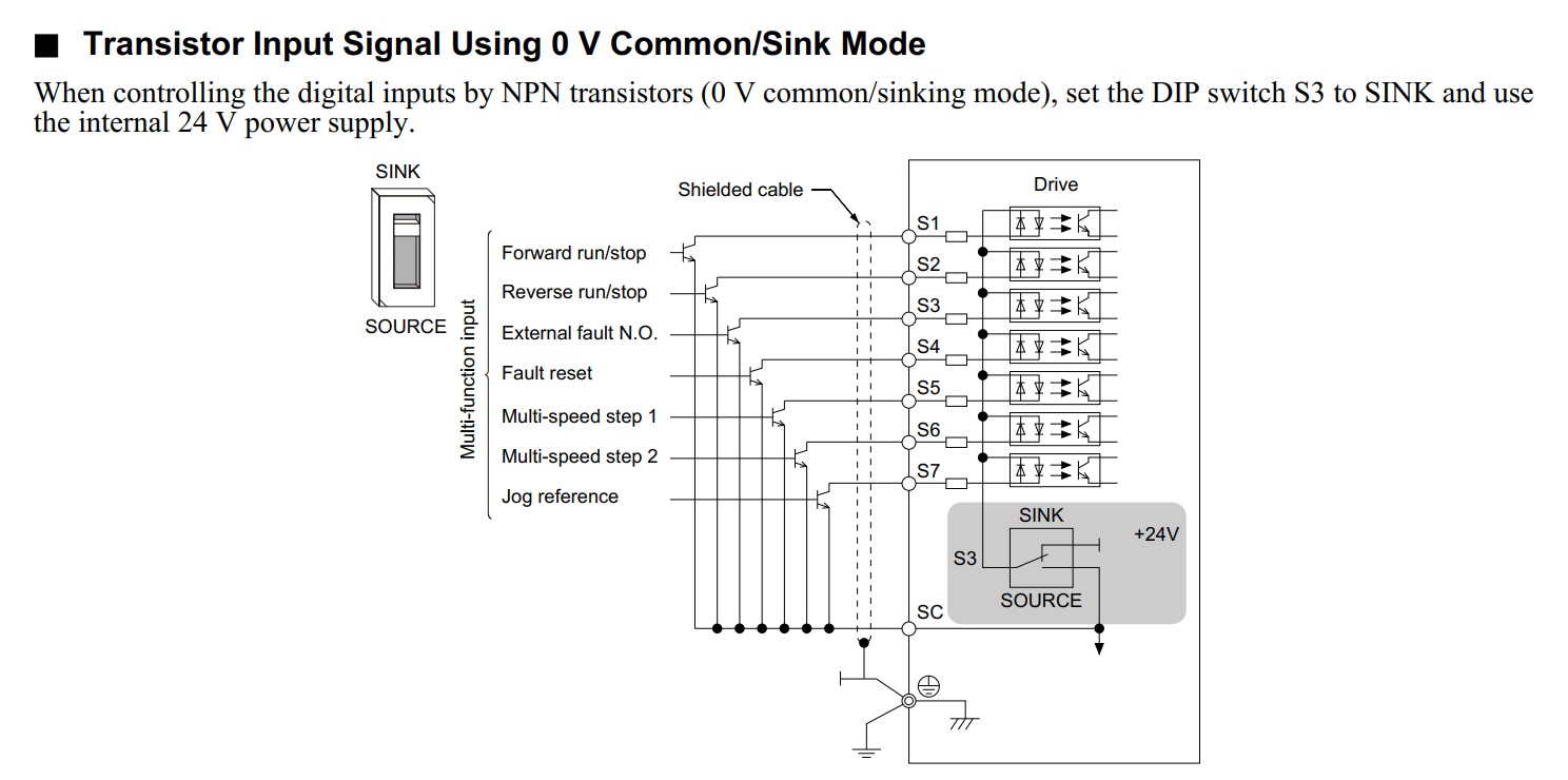

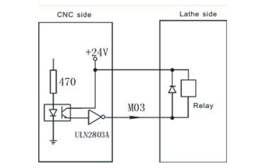

As can be seen I know very little about electronics but I think that as long as the Gnds are tied it should be fine but if not then please let me know.With the drive from the CNC being 24v or zero, putting it to the 12volt relay card might be causing some issues
