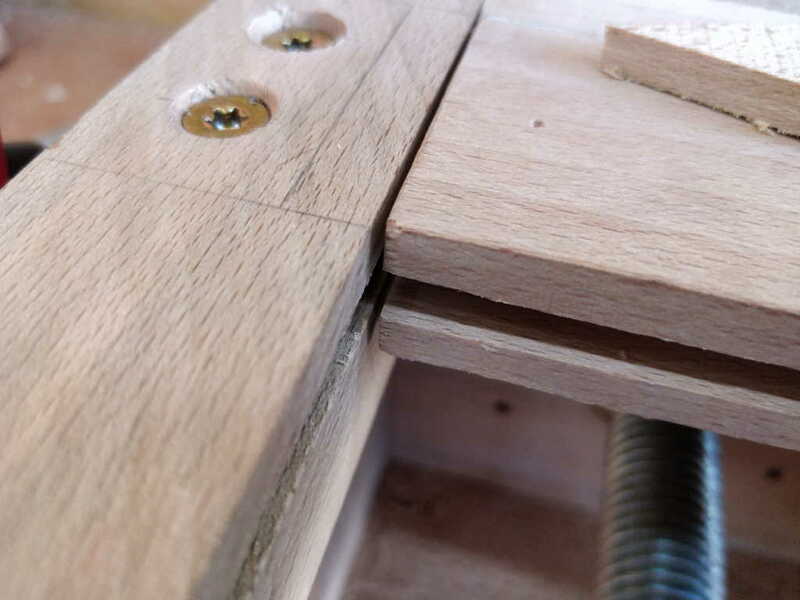

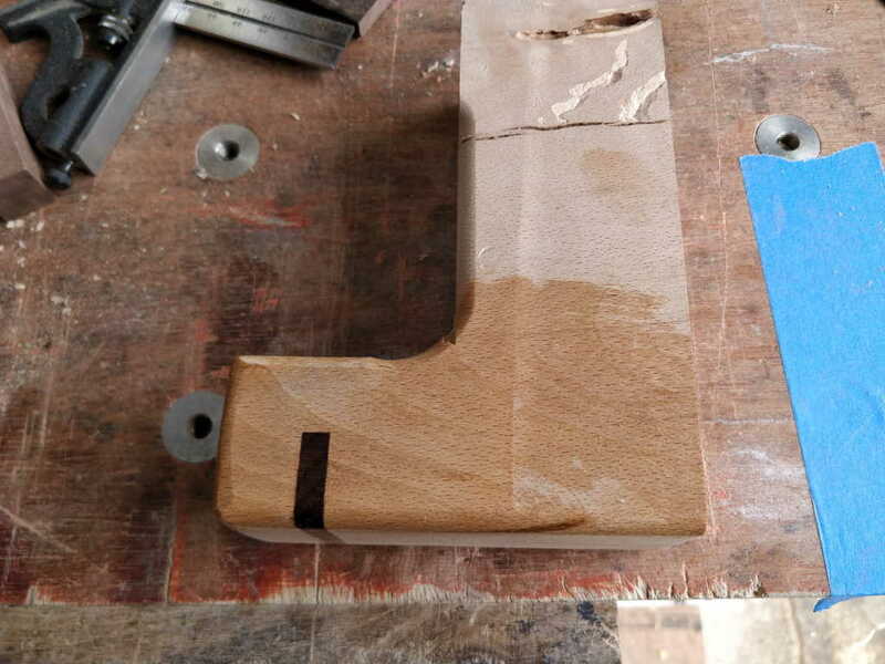

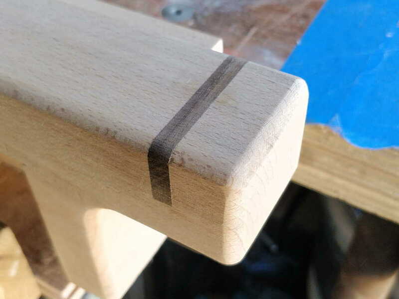

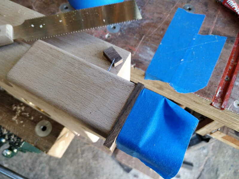

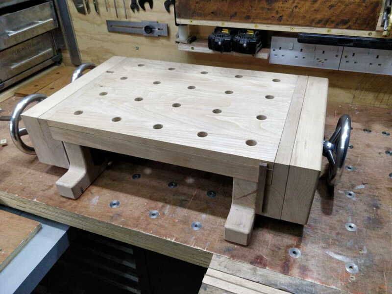

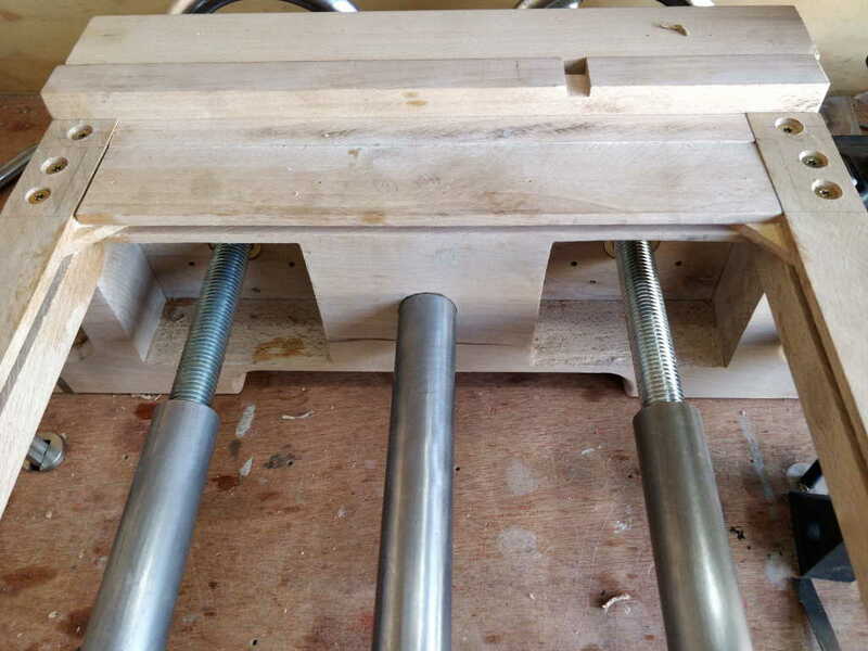

Open it out to dovetail section , then make contrasting dovetail filler , slide it in with glue then flush it off , sign your name on itfill in with your sawdust and glue from your cuts push it in deep
you should be fine when sanded
but you will need to fine sawdust to fill that cut line
either that or use addons in a different colour on all 4 feet
