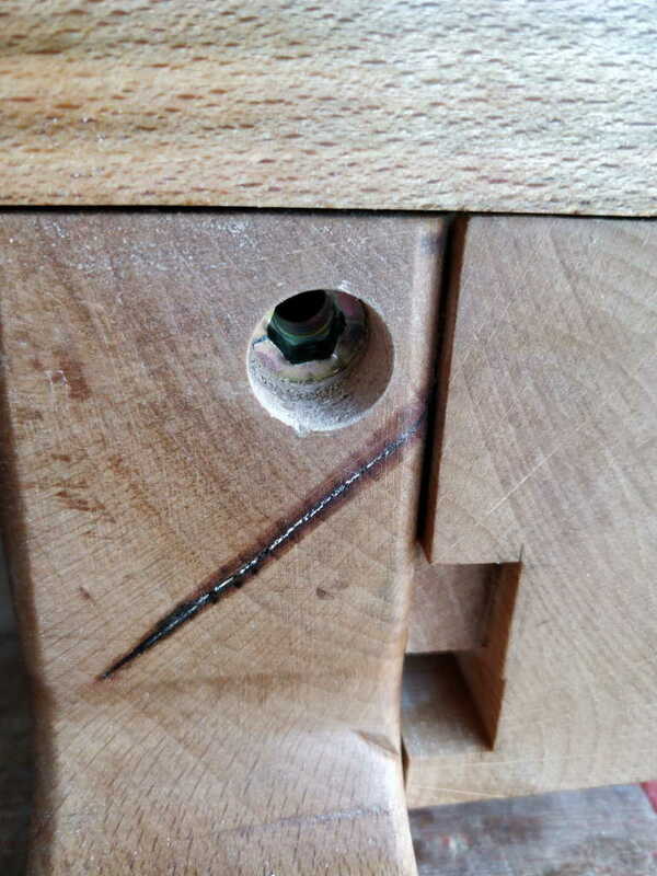

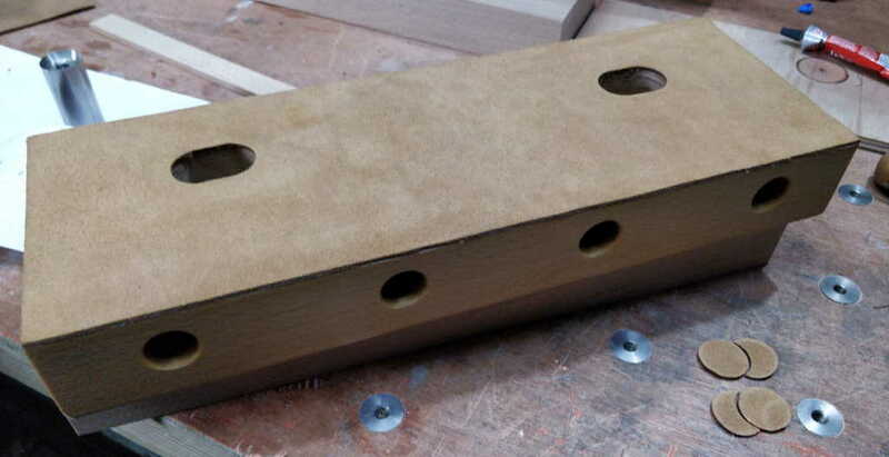

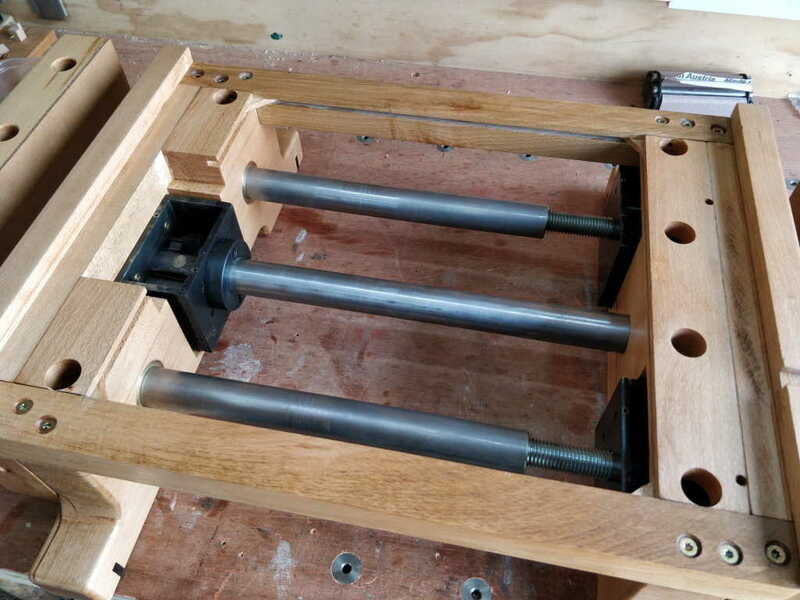

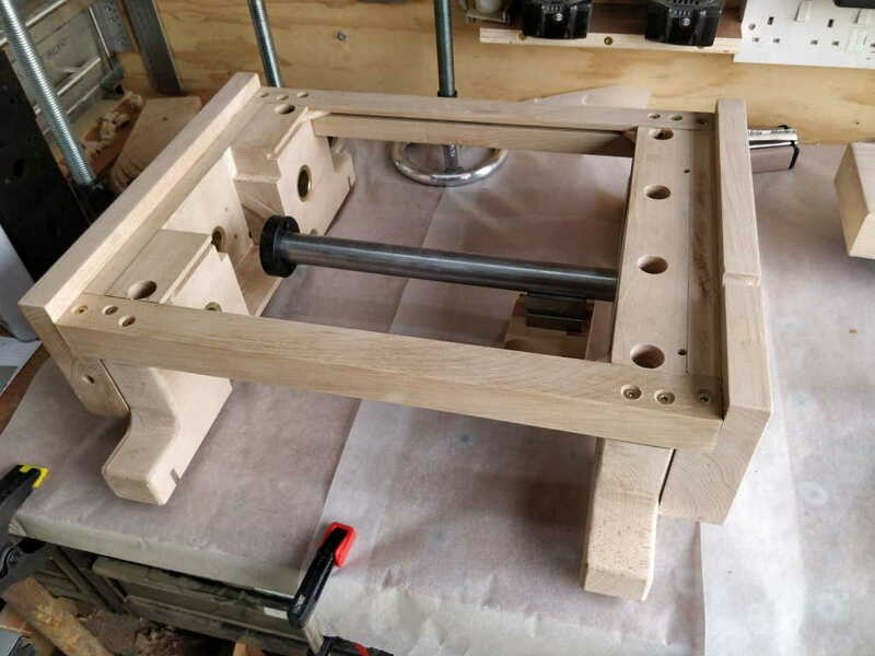

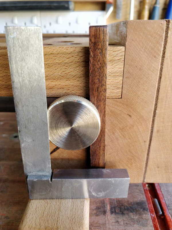

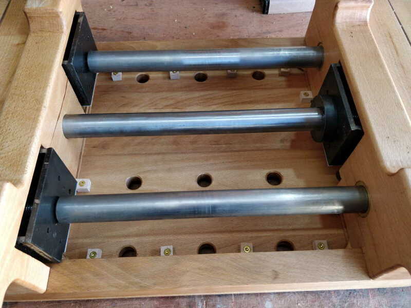

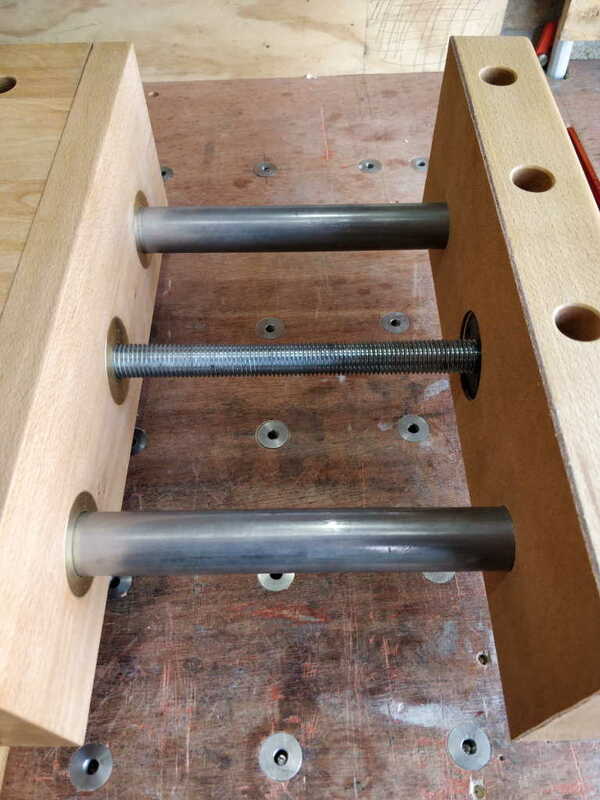

This afternoon I got on with the last few jobs before oiling. I thought it best to take everything apart (that will come apart) before oiling and to make re-assembly easier, I decided to drill two more small (6 mm to suit the head of an M3 cap screw) holes in the body:
These were carefully positioned over the screws for the lids of the vice mechanisms. When I'm re-fitting the vice mechanisms after oiling, I will be able to do so with the lids removed and then fit the lids afterwards by offering the screw up with some tweezers and putting the Allen key through the new hole:
That should make it much easier to fit the mechanism as I'll be able to see what's going on!

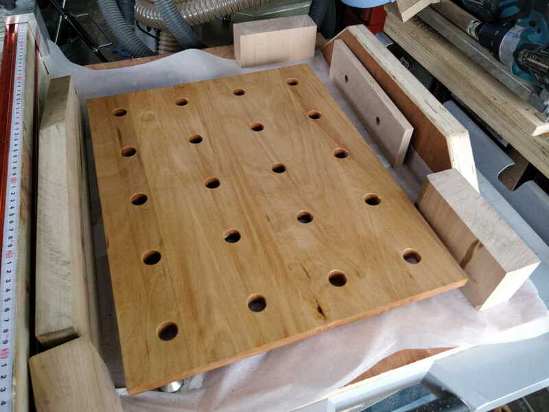

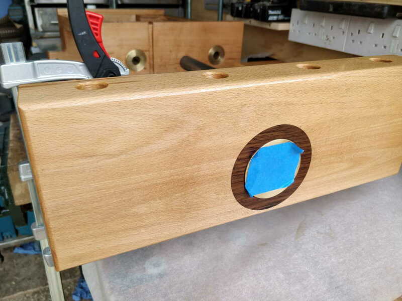

I also decided to fill a knot in the top surface with some five minute epoxy. This is the knot before:
This is it daubed with epoxy:
This is it after chiselling off the excess and then sanding flat:
