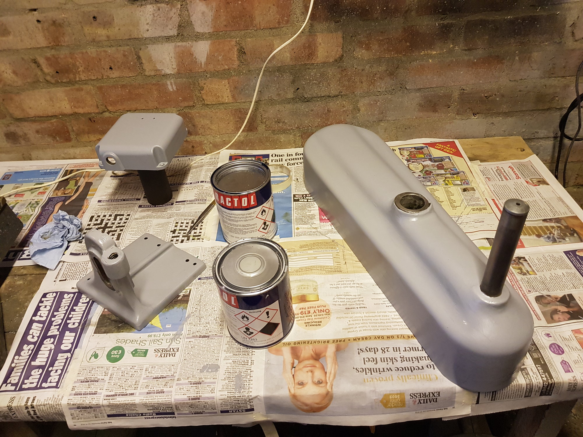

) and the new paint has been delivered.

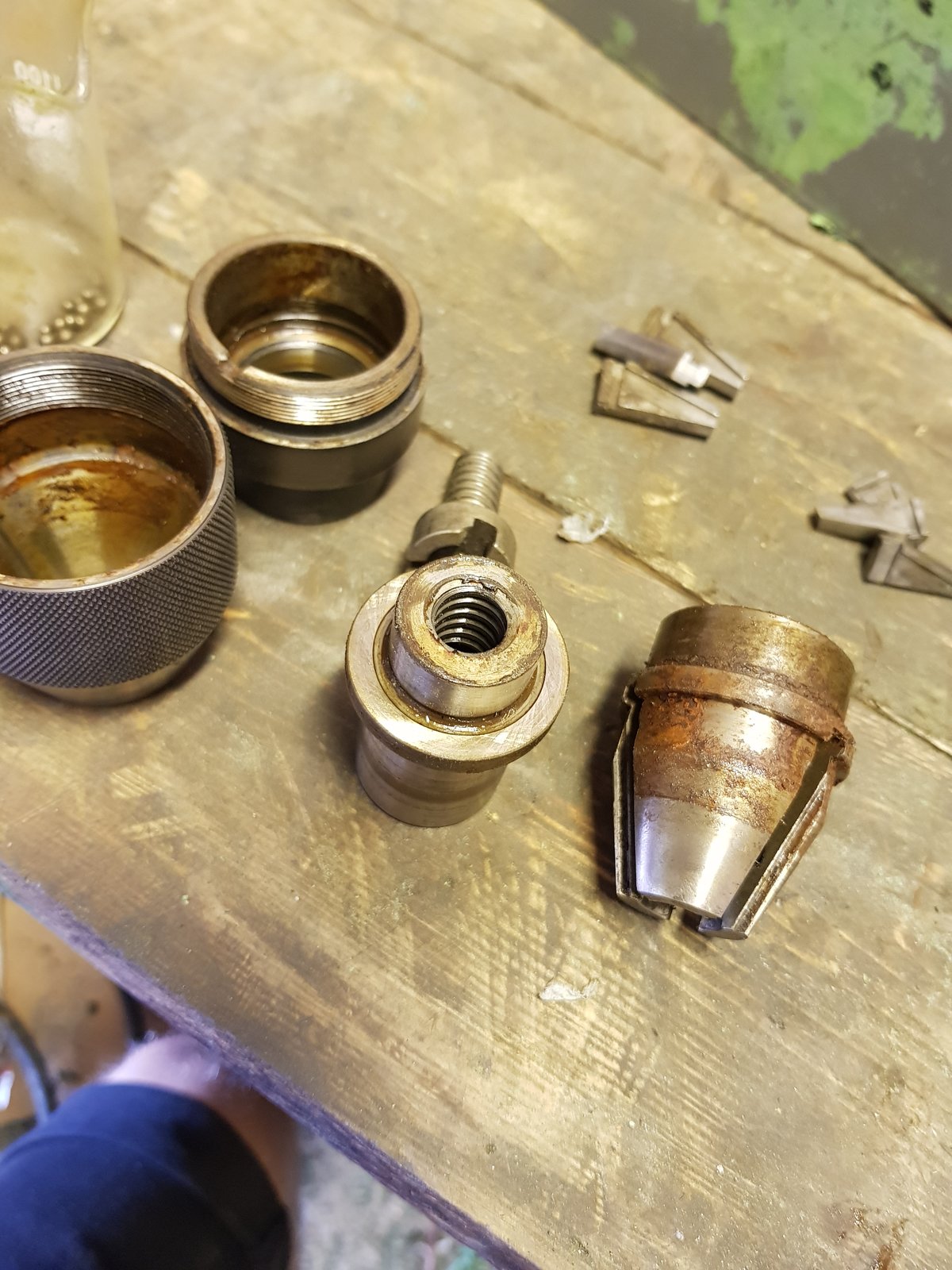

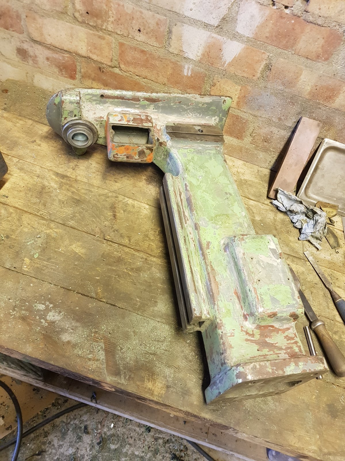

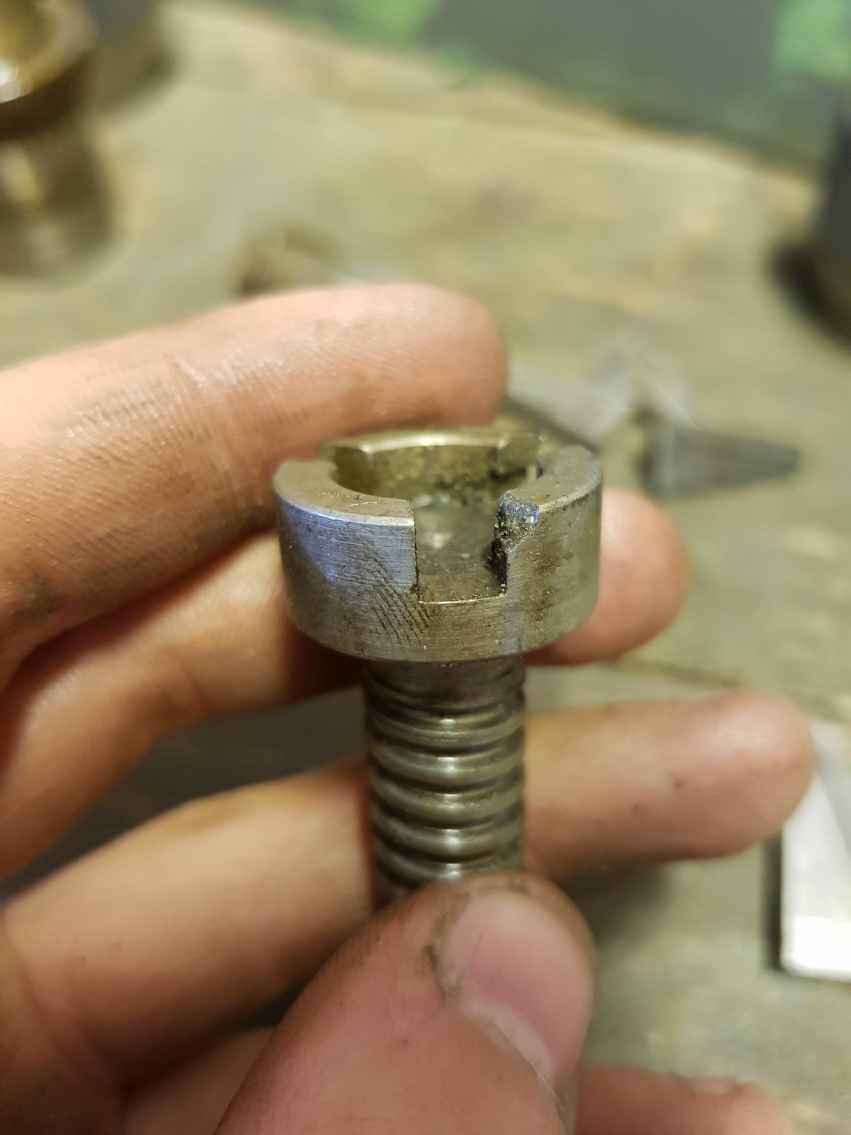

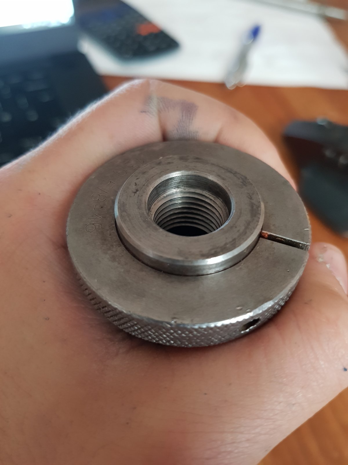

I think I'm just going to ask for a refund, even if I replace the screw the whole thing is in a bit of a bad way, there's a lot of surface rust in it, all the critical ground surfaces seem okay though. There's a lot of stiff dried grease in there too.
I suspect the original loose one was lost and someone just dropped a spare (But heavily used) one in to sell it looking complete. The person I bought it from says he got it in a job lot of engineering tools and doesn't really know a lot about them, I don't think he's tried to rip me off but whoever he got it from possibly was.

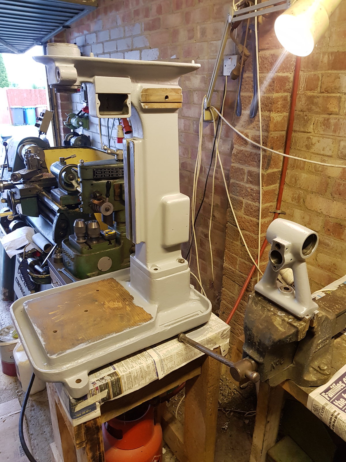

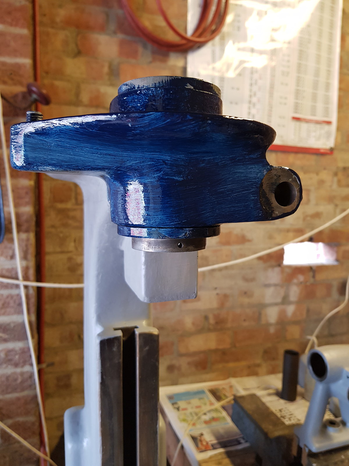

and with that, it was just about ready for paint:

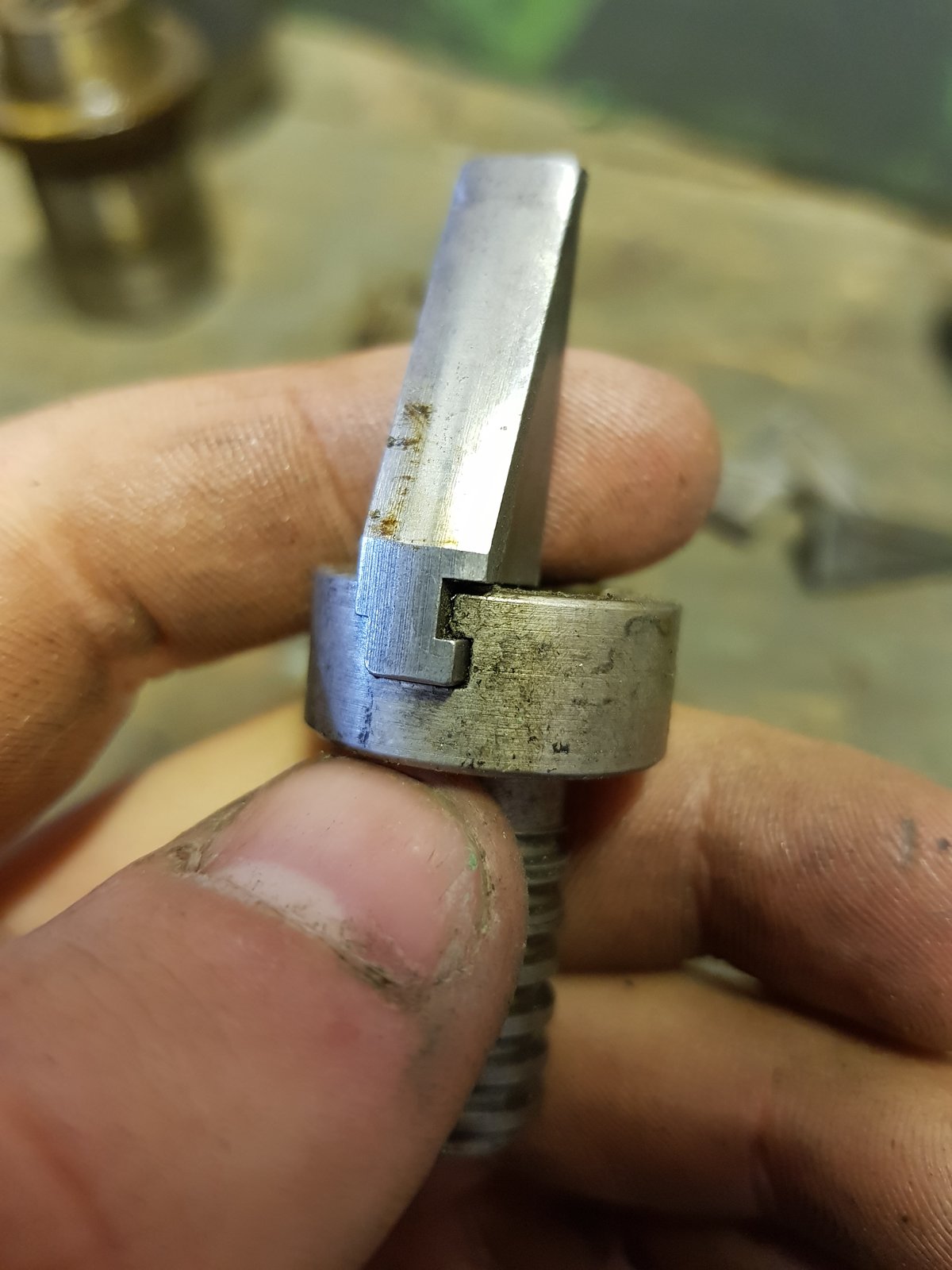

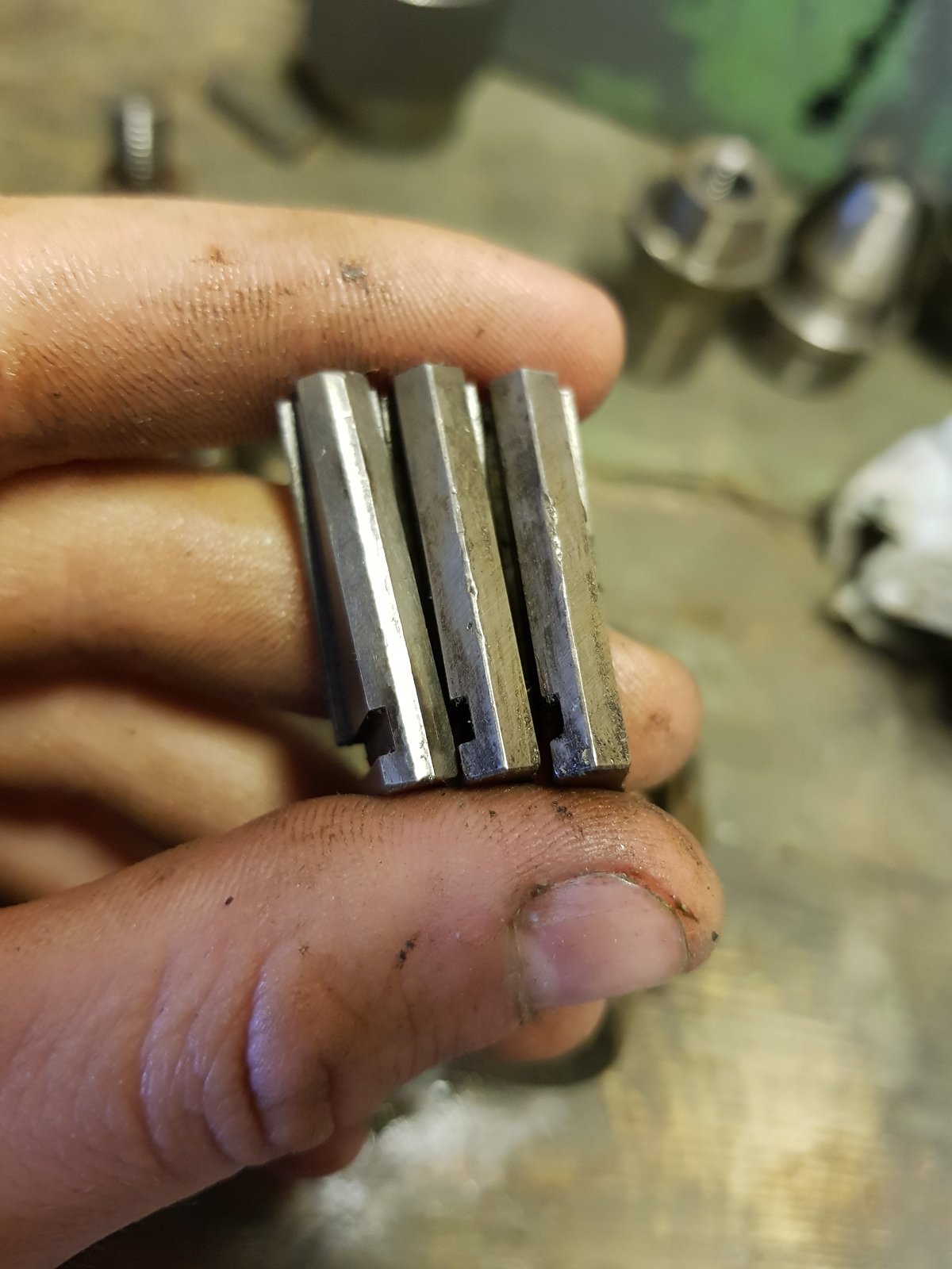

Time to drag out my big grinder and grind a new tool.
