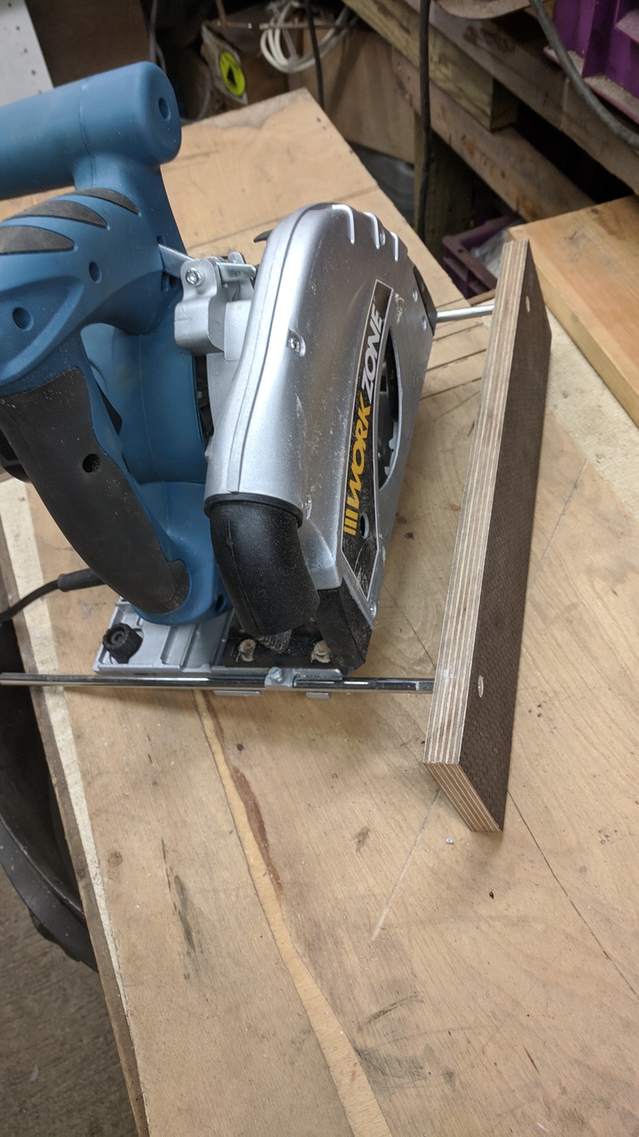

Ok I am missing something, it looks like you have just re invented the Skil saw ?!visited 6 different aldis today - no returns

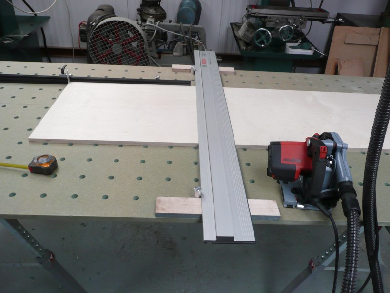

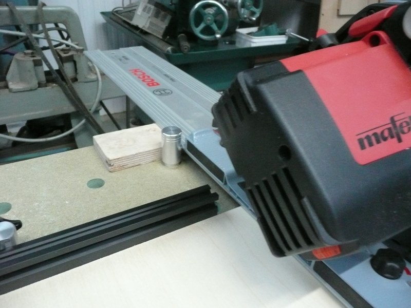

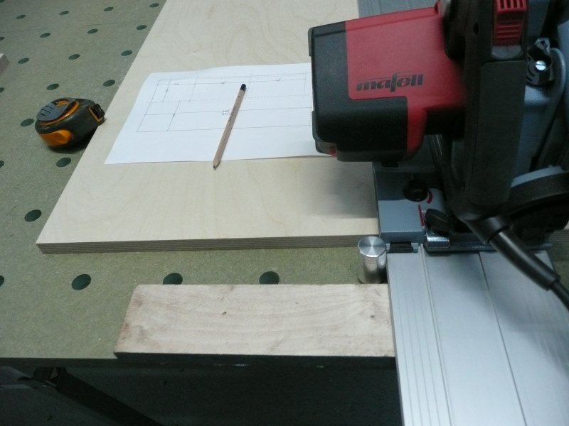

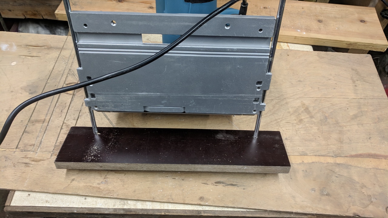

also made this:
parallel fence for ripping.
View attachment 170114 View attachment 170115
pair of 8mm guide bars from a router fence+ a piece of 18mm buffalo board

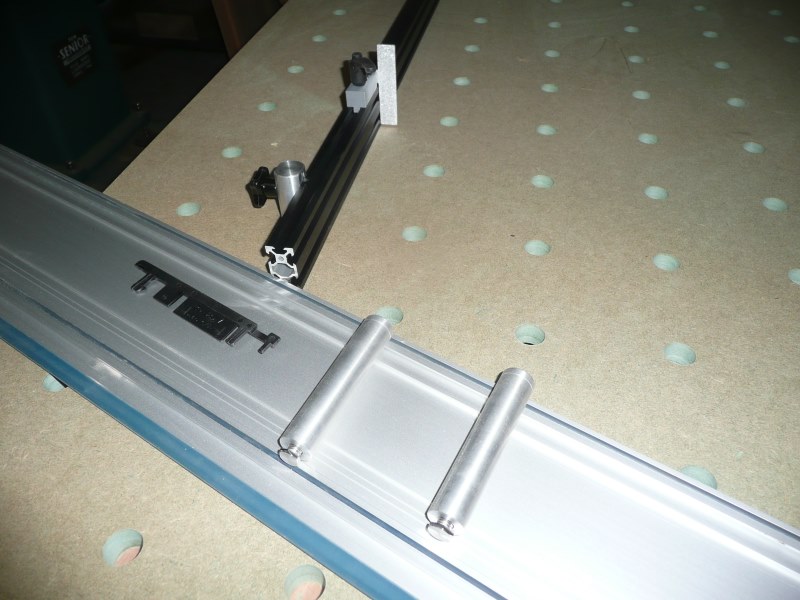

The other way is to use the t-slots under the track with t-bolts in the top of dogs. I have some from benchdogs.co.uk for 20 quid, but the t-bolt heads were too deep to fit the 1.7mm deep slot under the Mafell/Bosch track but they are sending some new ones out to me. Again, relatively easy to make and I'll grind the original ones to fit too. Here they are on the upturned track.
