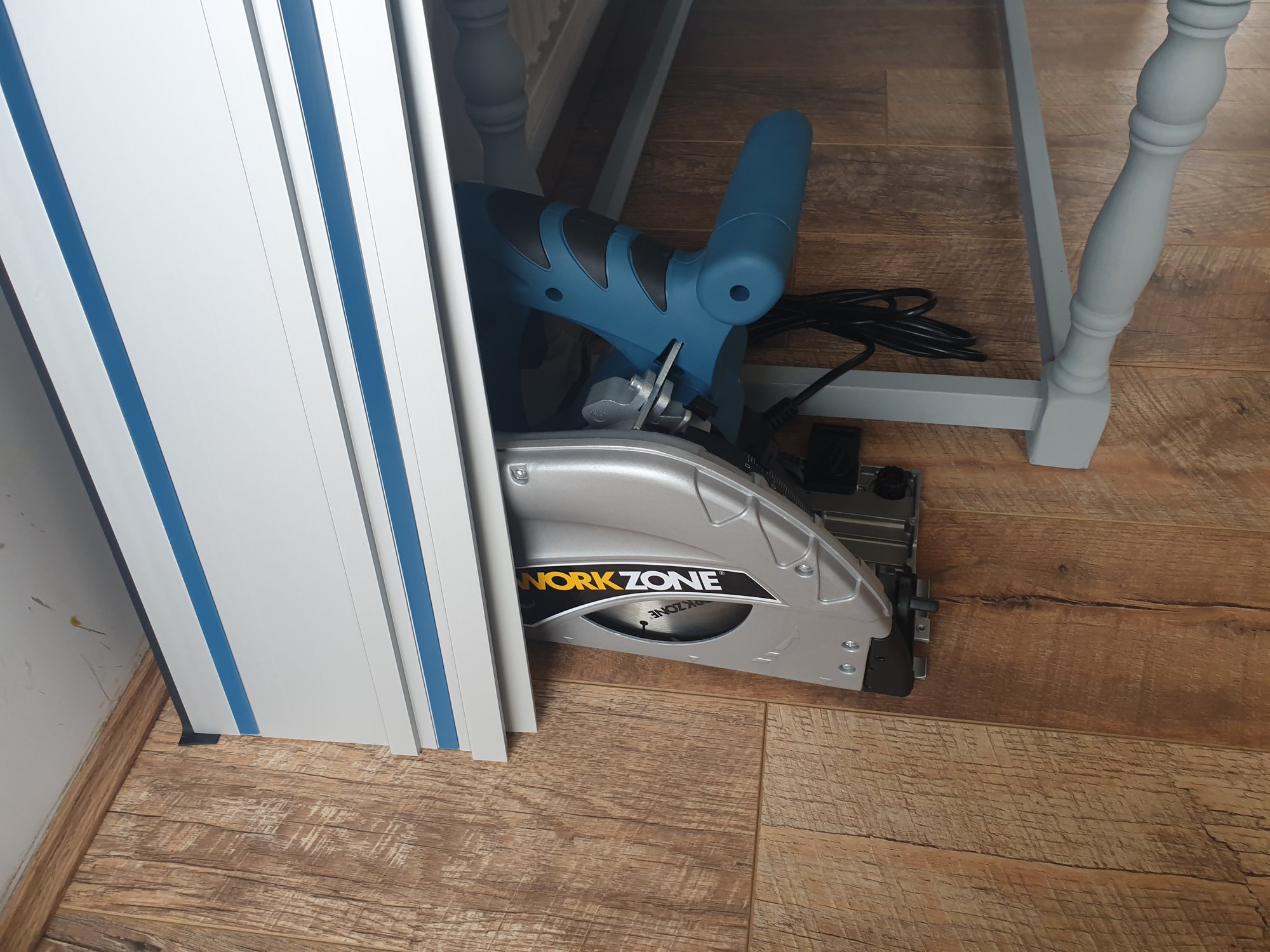

jointing piece on mine (workzone) is 12mm x 5.5mm.
looks like nearest standard size is 13x6, so im going to call to my local metalsupermarket and get a length.
there might be some filing in my near future.![]()

12x5mm bright steel from metalsupermarkets is a perfect fit.
£12(minimum charge) for about 10ft.
homebargains dont do the cheap f-clamps any more, so off to screwfix for their 150mm f-clamps (2 for a fiver).
to convert to track clamps.
Just need the foot grinding down to fit the t slot I assume.Are they easy to convert?
